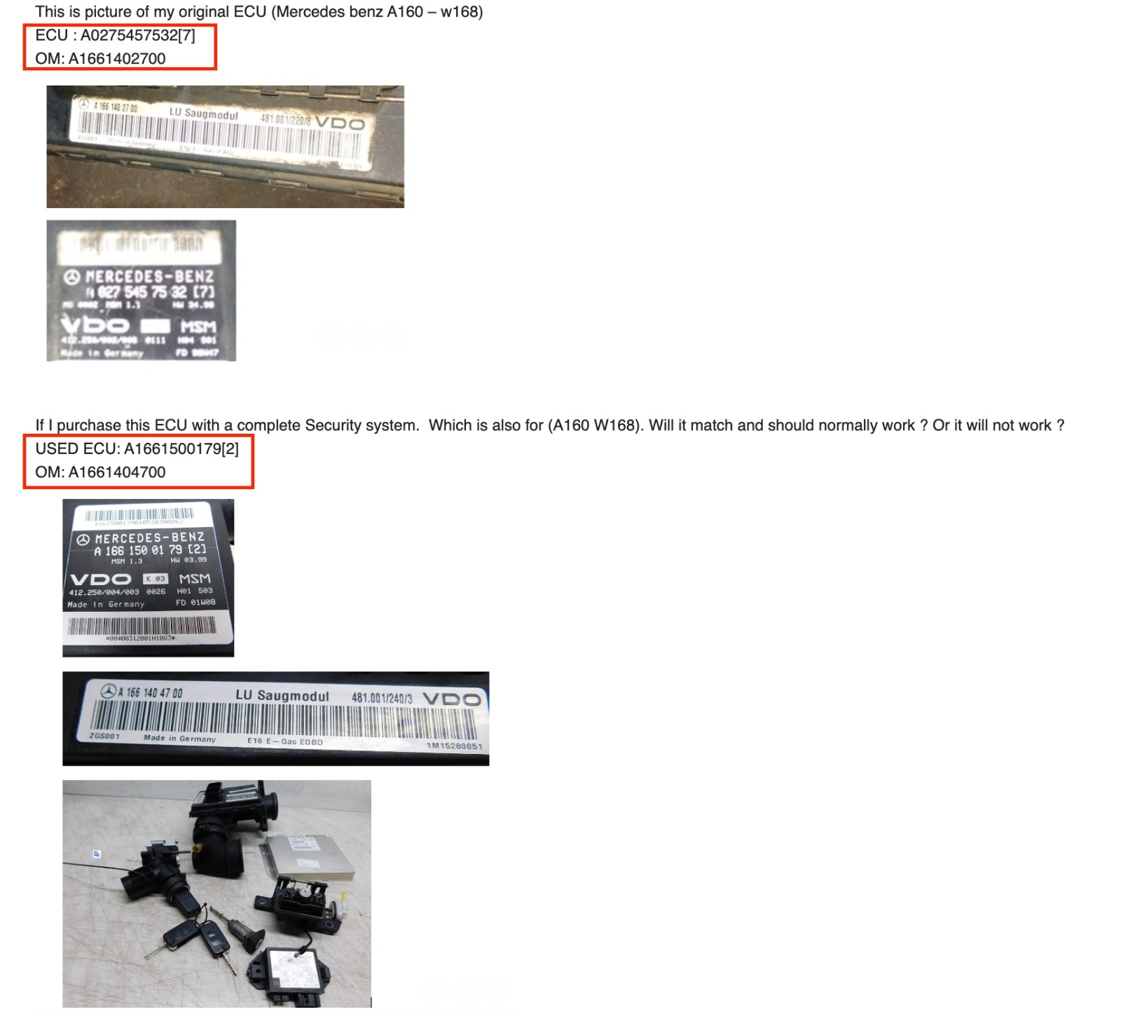

Our local mechanic suggested removing the ECU, key, sensor, and immobilizer and bringing them to him all these part of another car. I've already collected these parts from a junkyard.
Now, after sending the parts, the "start error" is gone, but the car still won't start. Maybe the used ECU we got doesn't fit our A160 W168 (BENZIN) and does not have our VIN number or engine number, or it has issues. Do we need to reset or personalize the ECU?

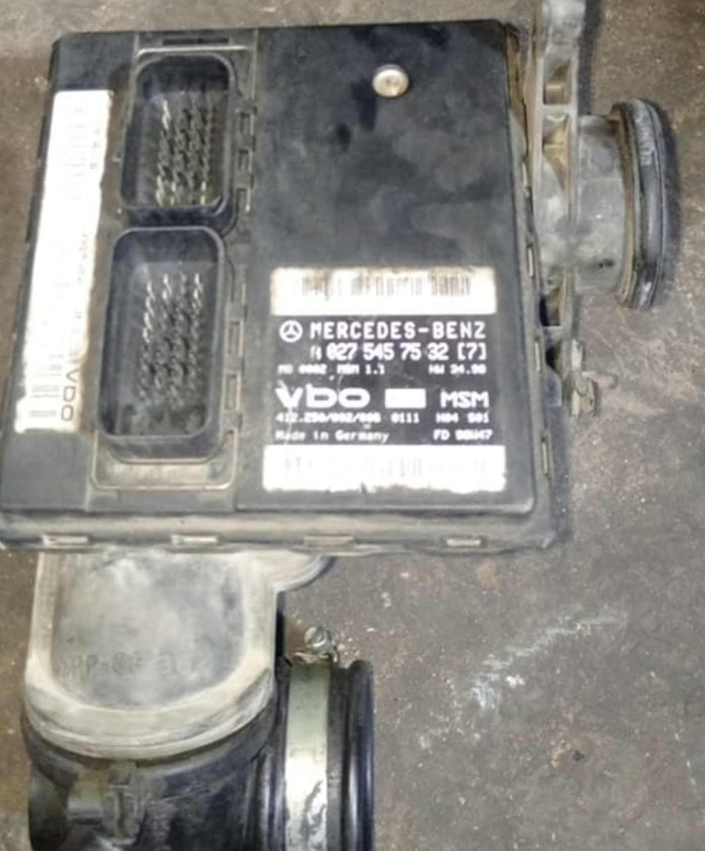

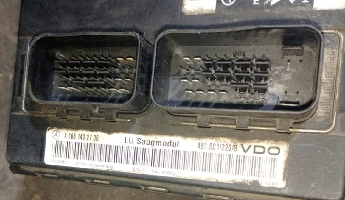

ECU Picture

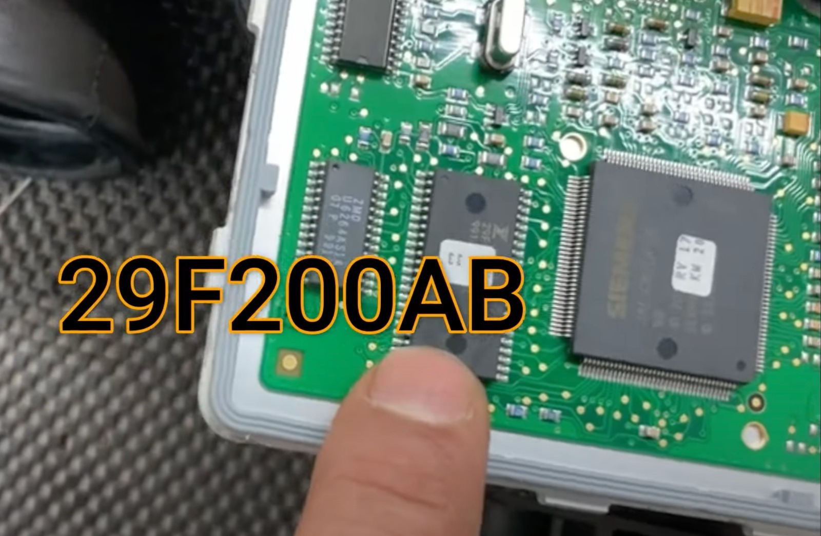

This is the memory chip used by this ECU. Picture takeing from internet my ECU is sealed no one opened it
