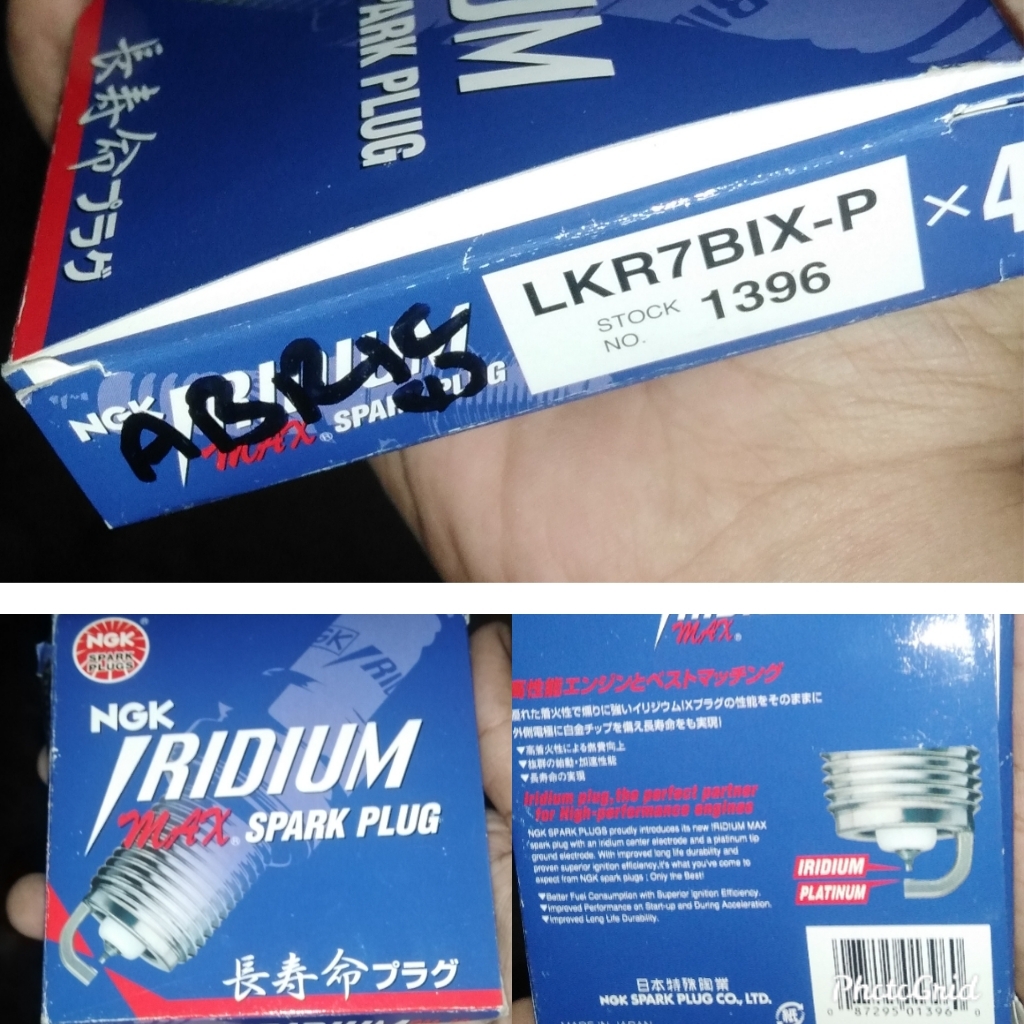

FOR U: Spark plugs: NGK SILKR6D10G (Iridium)

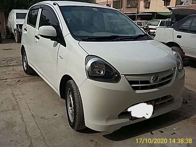

Ever since I've purchased my Mira e : S (2012, DBA-LA300S-GBPF, ~30,000km on clock), I've been scouring the internet and calling Daihatsu Service Centers in Japan for information that would help me understand my car better.
I translated the Quick Start Guide from Japanese, and since I haven't been able to find a manual for the car through both official channels and the internet, I thought I'd compile a knowledgebase that I could refer to for information on my car, when I need it ? helping the community out in the process.
Feel free to contribute any information you find, or share your experience regarding the cars, to help make someone else's life easier. I'll update this thread accordingly.
I'll link facts that end up here to the author of the post highlighting that information.
--- OWNER'S MANUAL DOWNLOAD ---
Link to Daihatsu Support Website
--- DAIHATSU MIRA E : S 2012 DBA-LA300S-GBPF ---
Introduced: 2011
OEM: ダイハツ (da-i-ha-tsu)
Model: ミラ (mi-rah)
Variants: Toyota Pixis Epoch, Subaro Pleo Plus
Vehicle Assembly: Osaka, Japan
Type: 5-door hatchback
Engine: Daihatsu KF-VE3 658cc I3 (DOHC 12-valve, D-VVT, naturally aspirated)
Bore x Stroke: 63.0 x 70.4 mm
Maximum power output: 52 ps / 51.3 bhp / 38.25 kW @ 6800rpm
Maximum torque output: 5.8 kgm / 41.95 lb-ft / 56.88 Nm @ 5200rpm
Compression ratio: 11.3
Transmission: Continuously Variable Transmission (CVT), 1-speed belt driven + creeper ratio
Drivetrain: FWD
Dimensions (l x w x h): 3,395mm x 1,475mm x 1,500mm
Wheelbase: 2,455mm
Curb weight (unloaded, dry): 730kg
Rear suspension: McPherson Strut
Front suspension: Torsion Beam
Fuel tank capacity: 30L (2WD), 34L (4WD)
Windshield washer tank capacity: 1.5L
