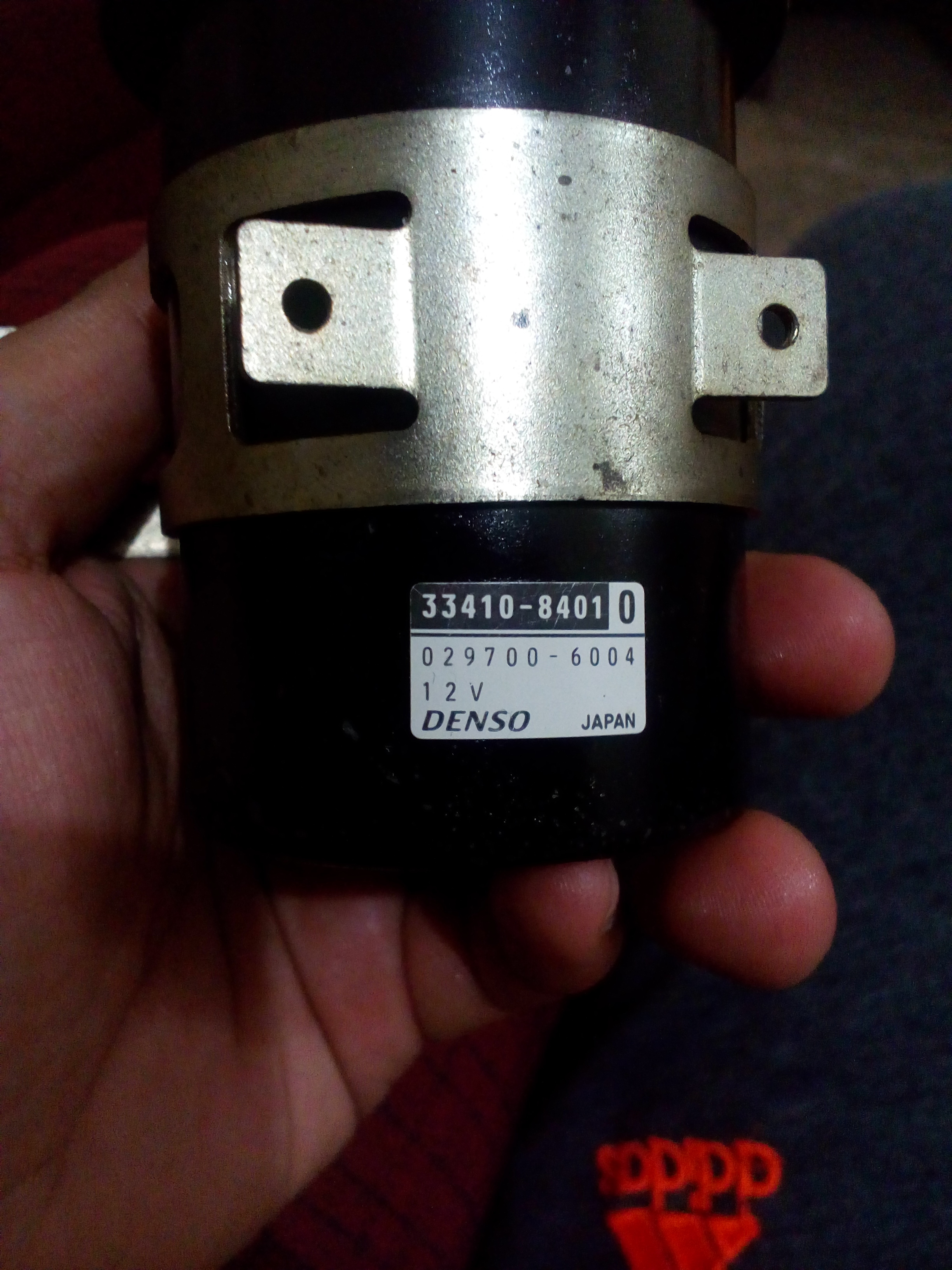

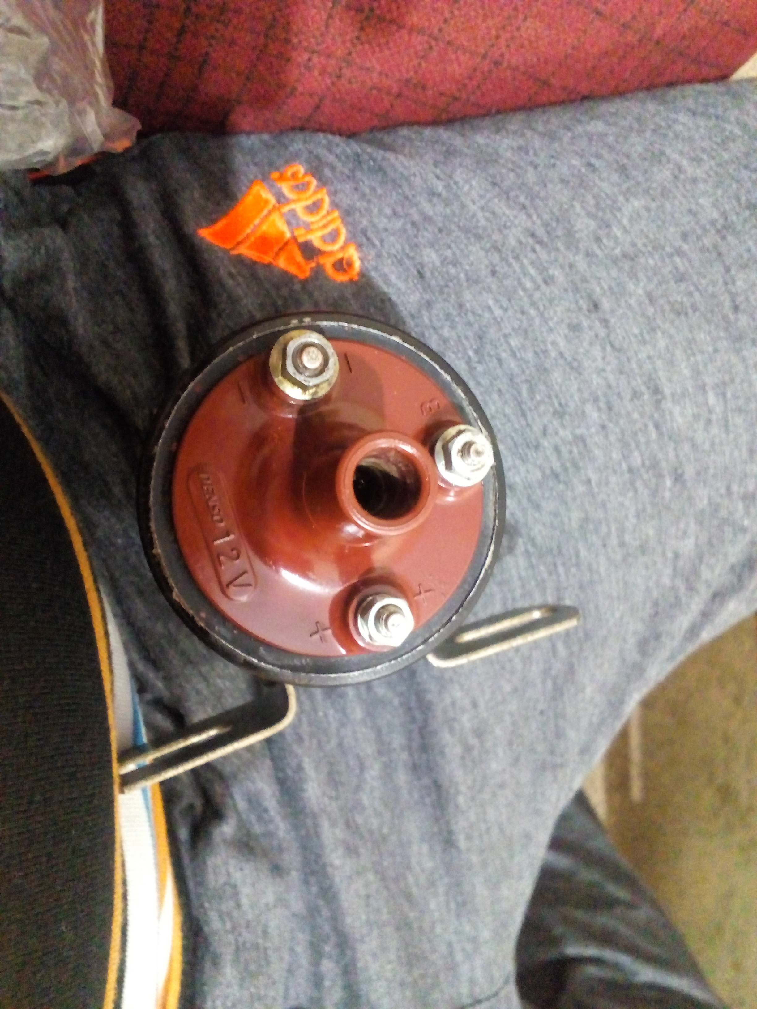

Coil replace (borrowed from somebody for a while but jhatka returned after 4 days)
Now mechanic says replace coil cables and cup. But i doubt the issue is due to cables.
