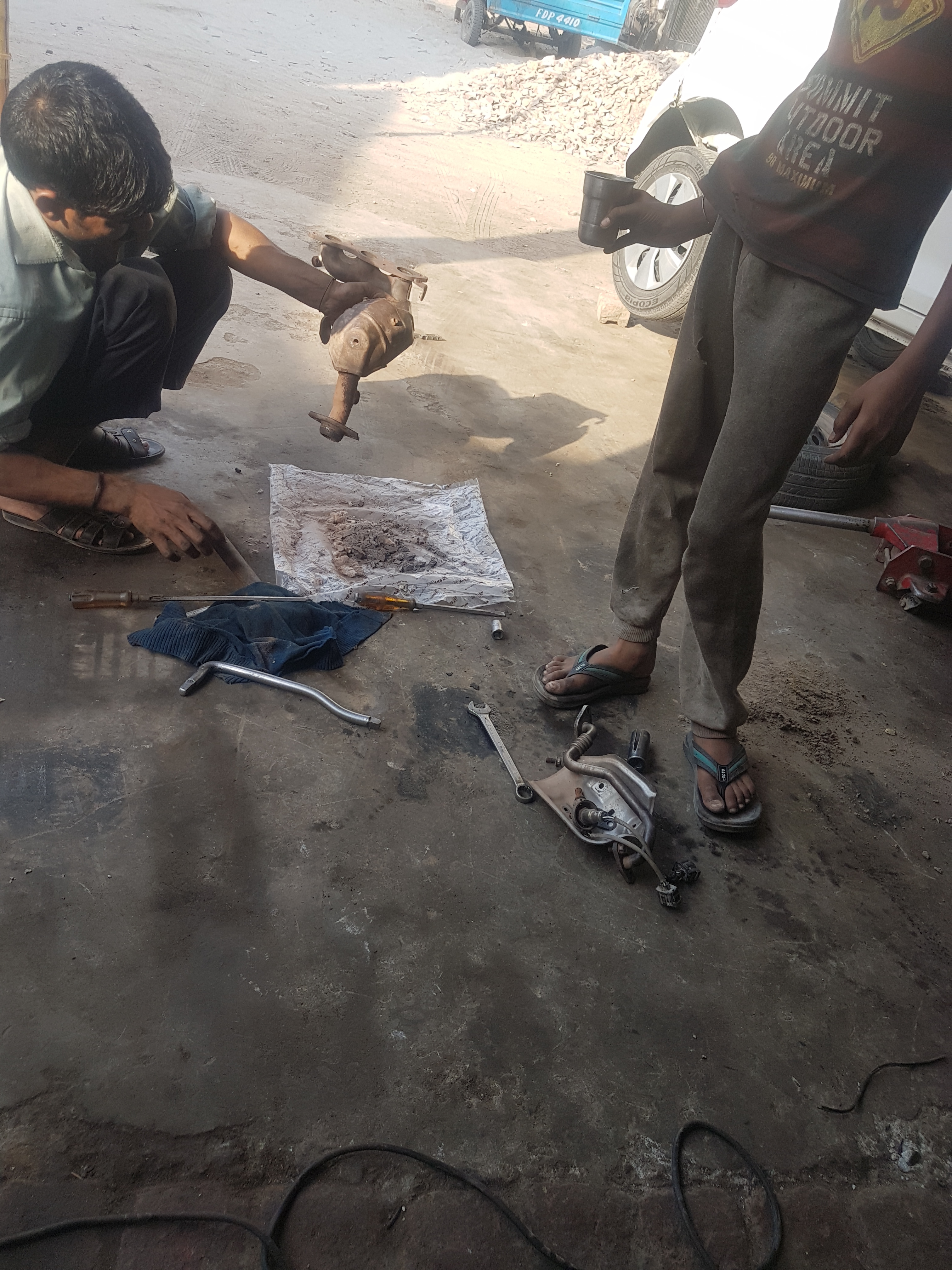

So tht error wasnt much of a problem my cars AC started doing problem whenever car is nt moving Or slow Ac would give warm air so I get it checked to 5 or 6 "Mistriis" nd all 6 said its compressor needs changing I even told them my finding that whenever I showet water on condensar it works fine fr 10 20 mints or if the weather is like 38 39 degrees it works awesome but they all said compressor is faulty so as summer was on peek I went to a good looking workshop and asked them to do wht was needed change the compressor, so here is wht I did tht day :
1. Changed compressor (8000 rs.) Gas etc. (But not even a slight change)
Then the "Mistri" asked me to change the fuel pump tht computer is saying chng it . So
2. Changed the Fuel pump ( 3500 rs.) 20% improvement in acceleration but Ac still same whenever its idle car still start shivering nd knocking nd warm air .
So "Mistri" asked me to clean its "pathi" I think the engine out take so wht should I have said soo
3. "Pathi" cleaning (1500 rs.)
0 difference
So the "mistri" asked me to add a fan to its condensor as my car was still at the point where showering the water at condensar will run AC smoothly fr 5 to 10 mints even in idle state .so
4. Added a fan on condensar (2000 rs.) 0 difference nd the car now shuts the engine down whenever I stops it on signal or speed braker if Ac is on
. So went back again he did much but car still shuts down on every brake then he asked to change the gas again with some expensive one dont remember the name of gas.
5. Changed the gas again (800 rs.) Spcl discount on gas
But still car shuts down on every brake but the difference is Ac do soo much cool in runing state that headache might start soo chill ac in runing state but as soon as i apply brakes nd speed goes below 10 the engine turns off.
