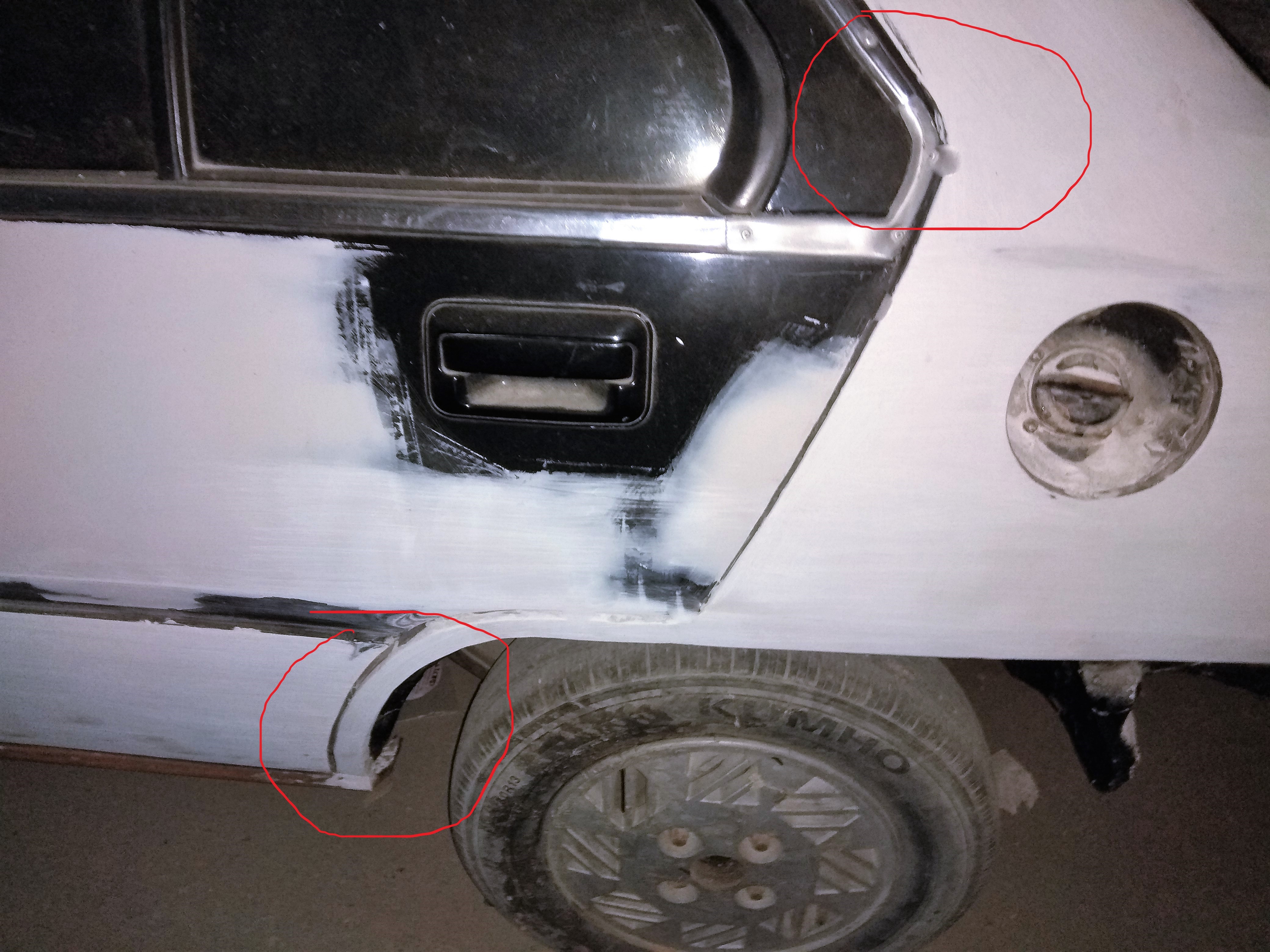

The sequence of the work is:
1)Denting the Whole car and make base for the paint
2) taking out then engine and cleaning and painting the engine bay, the fir what ever little moldings which is required in the engine bay.
3) complete all the mechanical work related to engine / suspensions and electrical making it perfectly fit
4) Completely overhaul the wiring of the car and repairing & servicing the power windows and locks then
installing the repaired seats. do all the thoka peete and soorakh marney waley kaam before the paint job.
5) Also planning to install that hydraulic type hood support so i don't the use of the hood prop. (not
recommended as u will not find anything or it would be too costly in my opinion)
6) one more important step before doing paint and fitting the dashboard is that get the car under washer and see if there is any leakages or water seeping inside the compartment through, firewall, windscreen seals, corners or any hidden holes leftover. this will help avoid future rust issues.
The painting the whole car but not finishing it up.
Finishing the car up by final polishing and installing exterior garnish.
then changing the tyres cause after standing for about a year they are also considerably damaged.
normally as per our routines, our mechanics and dentars behaviour a normal 3 months job automatically extends to 6 or more months.
