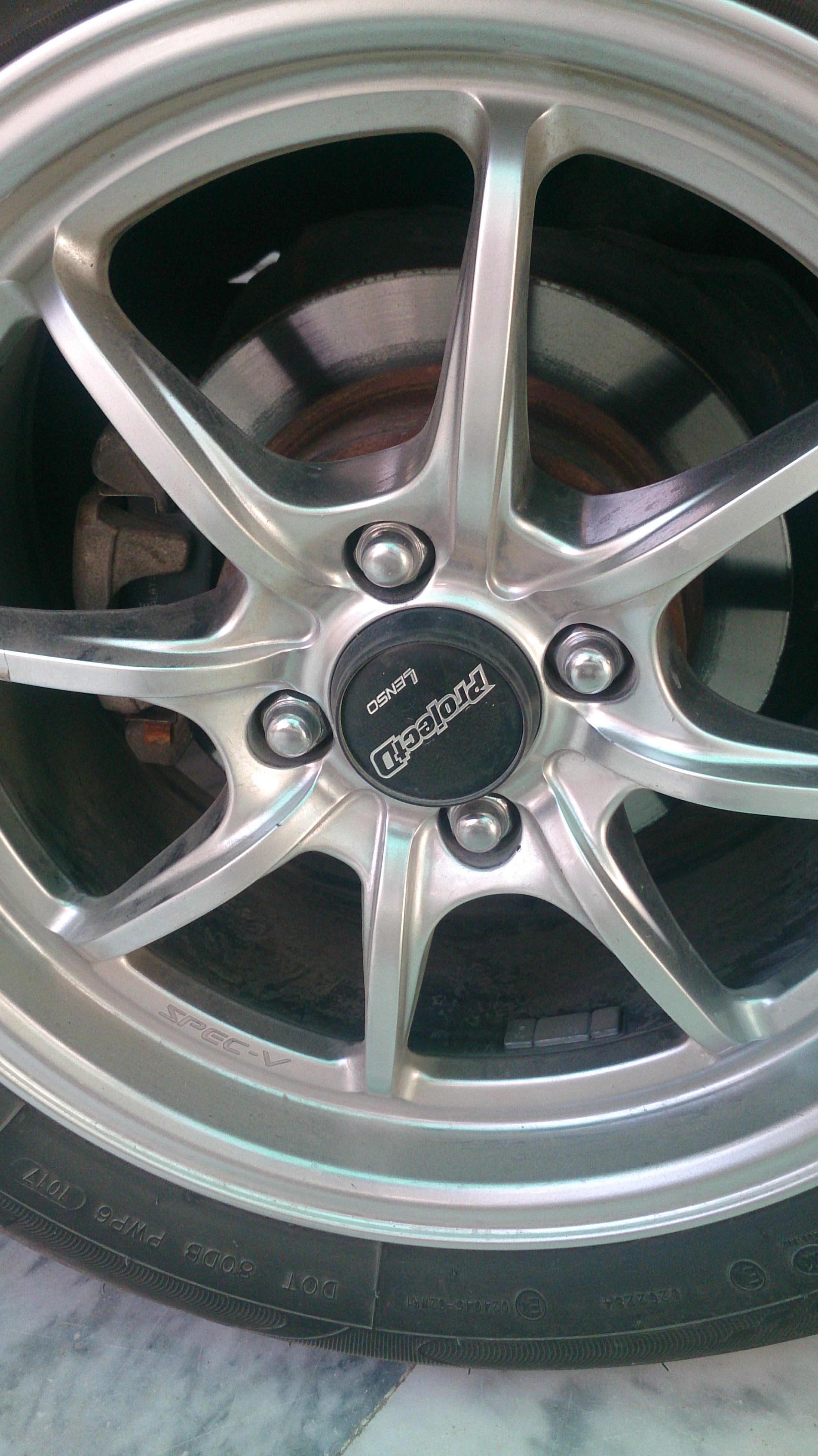

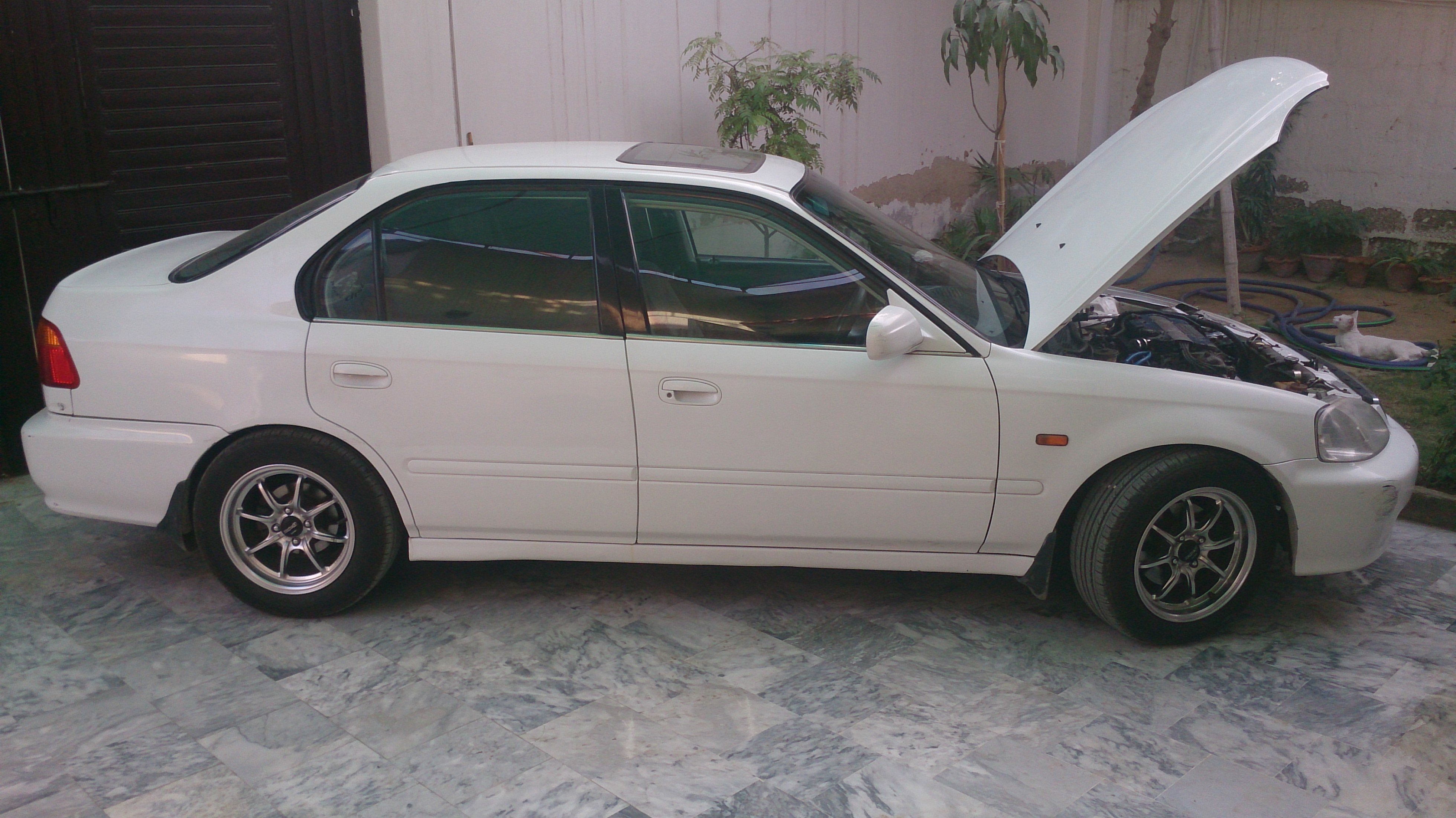

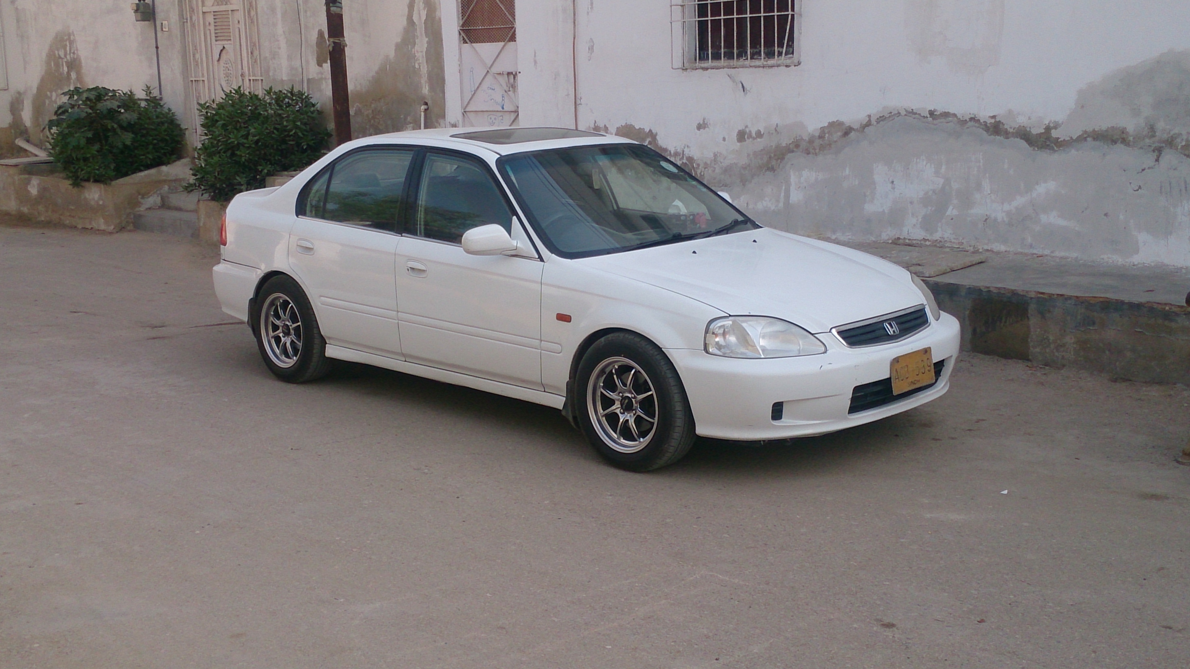

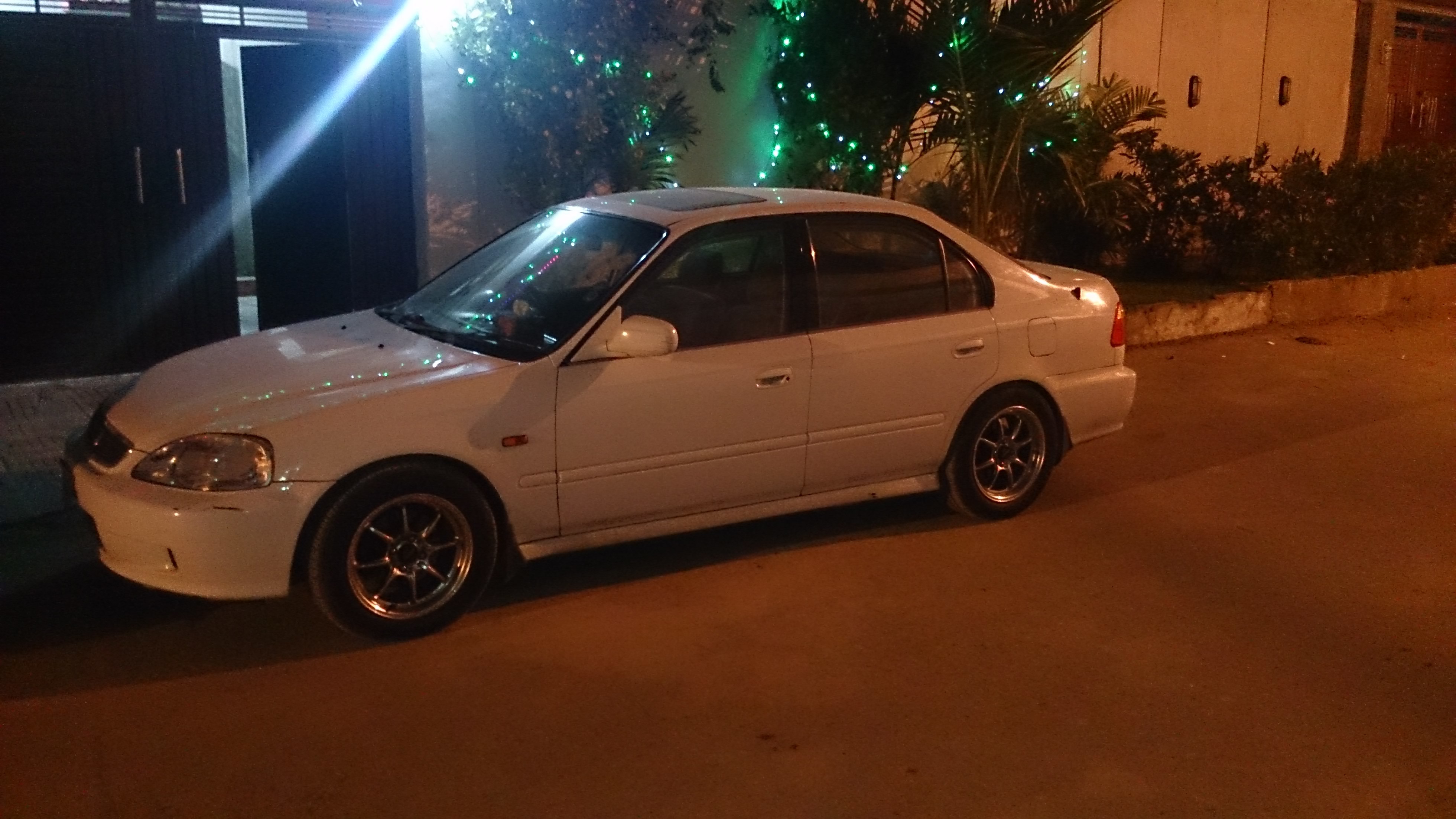

Hi PW's.I am Sharing my daily driven civic F20b Swaped. Some of the specs which i have done to my car are given below.SPECS:F20B with T2C5 (non lsd)P28 Chipped EcuNgk Iridiums PlugsHeadlights,Fenders,Bumpers,Bonnet are replaced by Kabli ones.Installed 195-60R15 Winda tyres (Got it for free from father's friend )Lenso Spec V 15 inchBlitz Coilovers (Almost New ) installedWhole Suspension Overhaul with new Rbi Bushings and Trailing arm polyurithine bush installed.

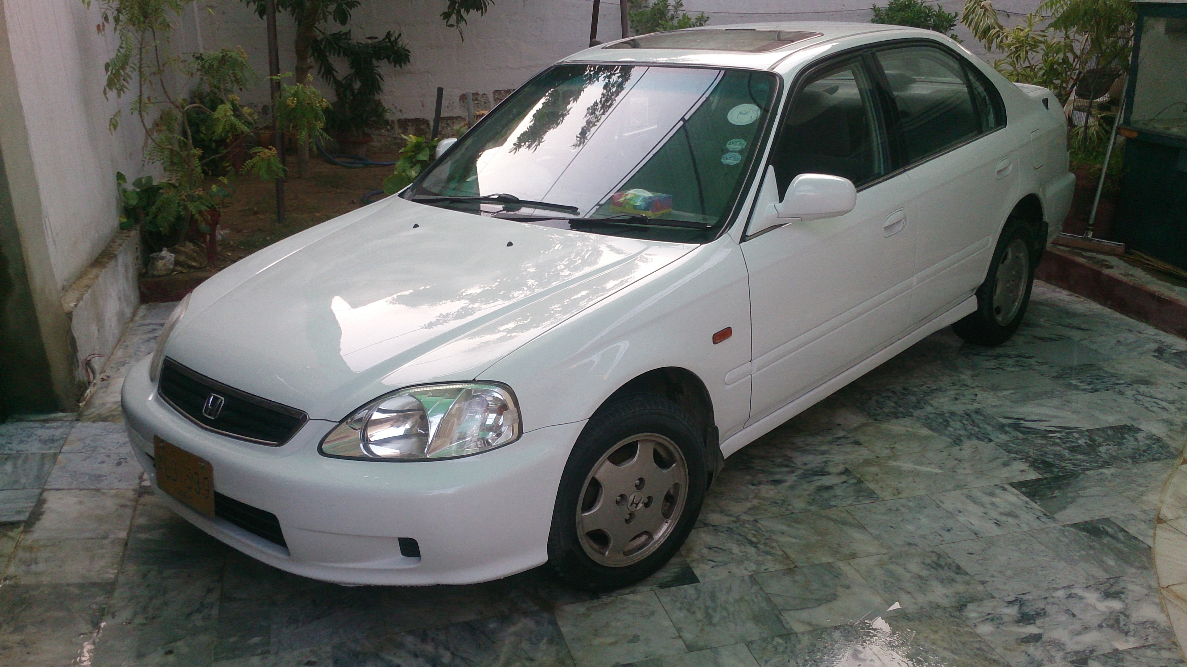

PICS:When i bought this car in 2016

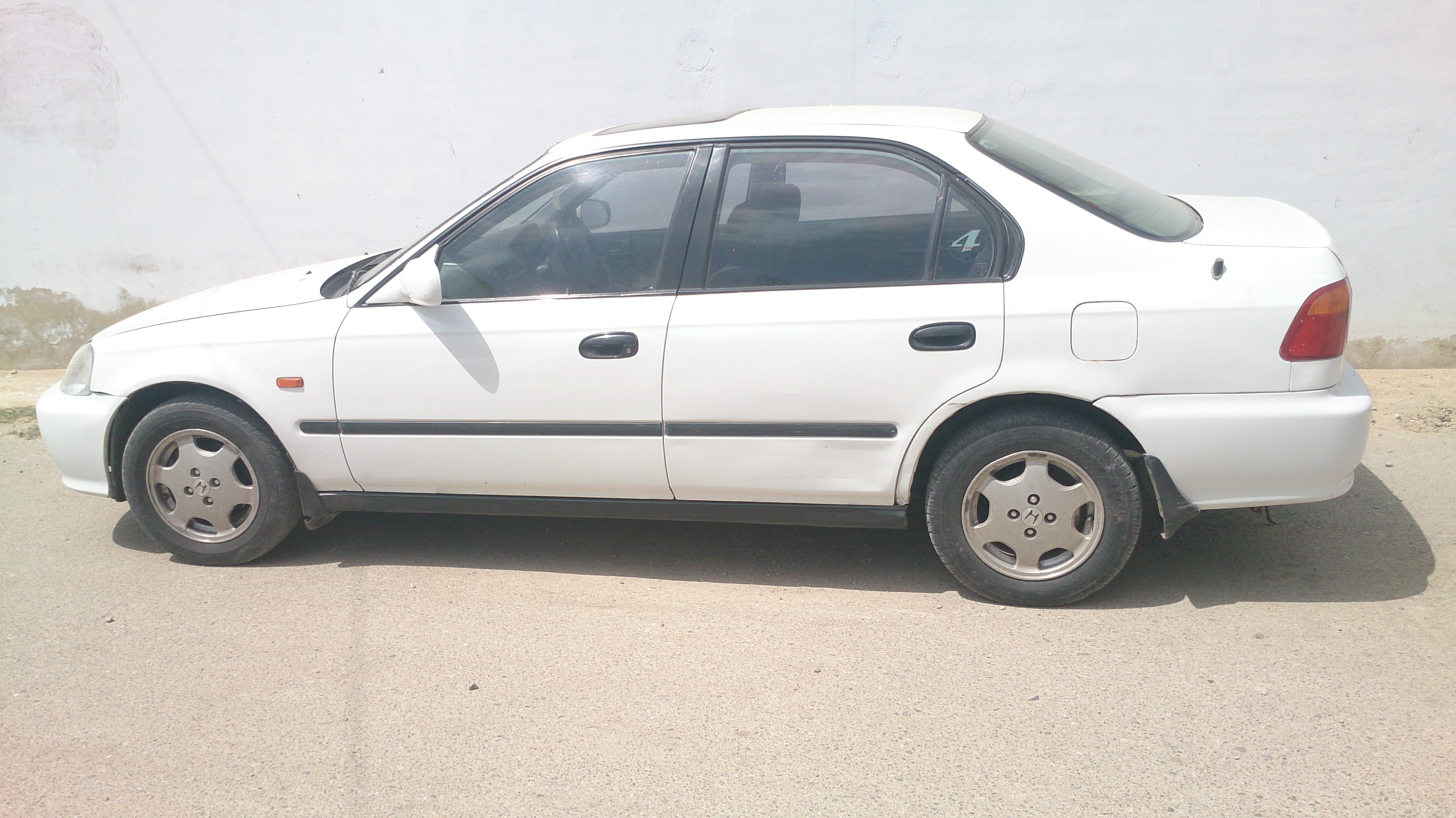

After Newly Paint done in Febuary 2017 with all tha kabli parts to give more perfection in the body work.

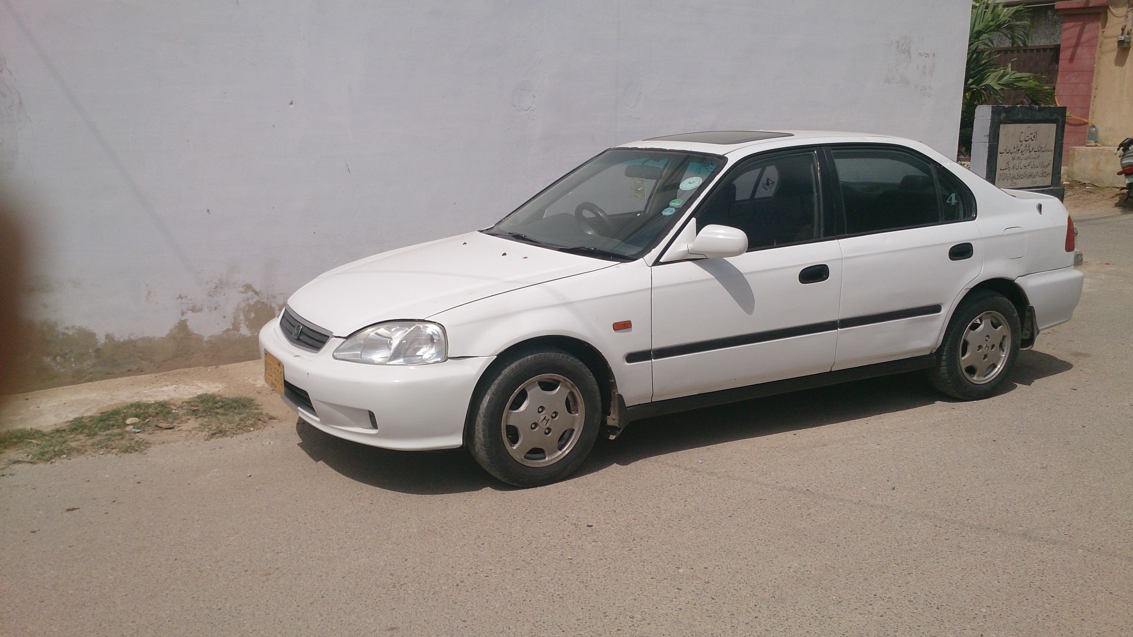

In 2018
Awesome work done.these car's look finest in stock exterior with drop suspension and rims.Love it.

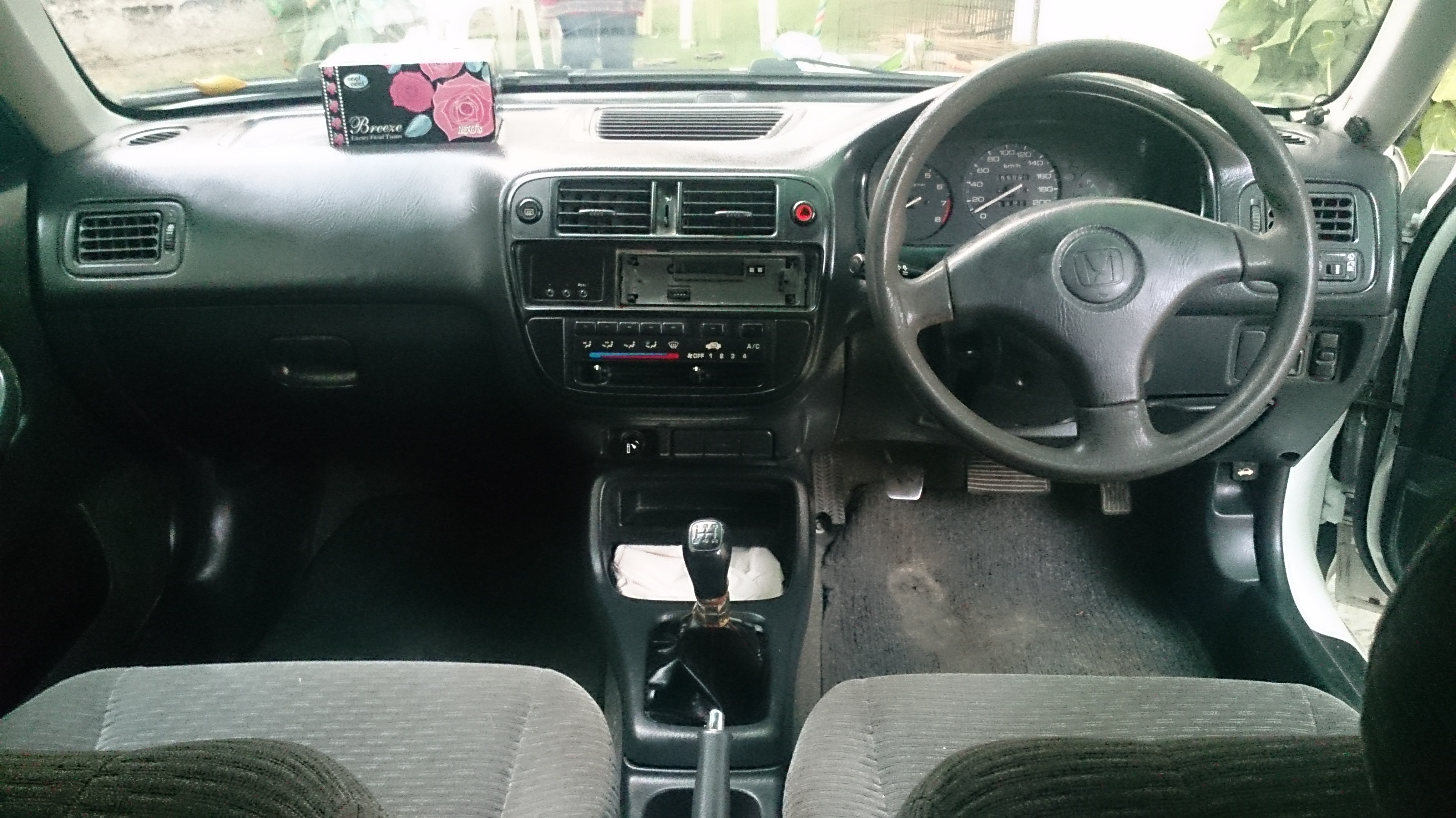

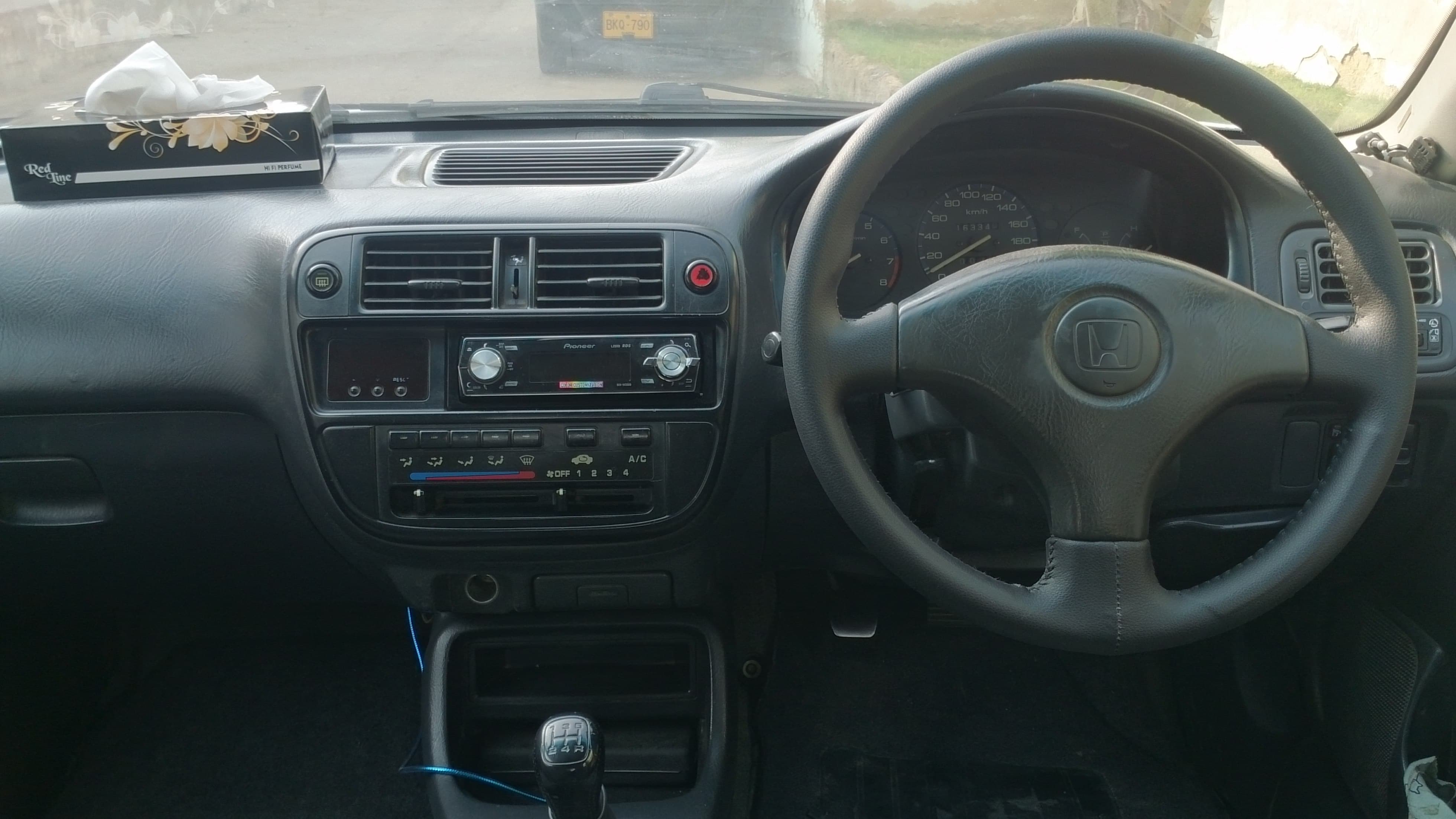

Some new updates. Artificial leather stitching in Steering wheel & Pionner 9450ub installed..
