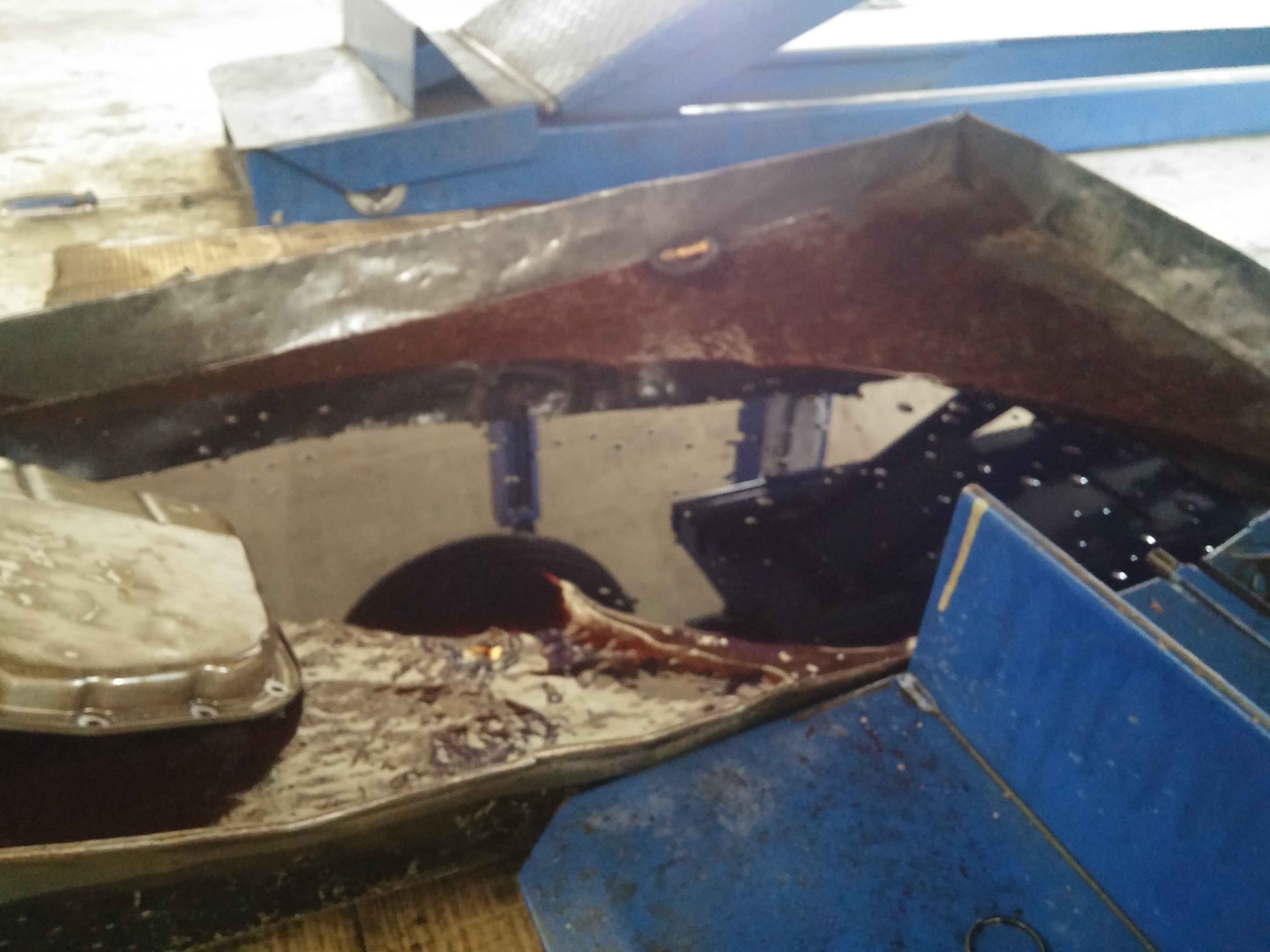

After opening up the whole chamber, including multiple screws, this much of oil came out:

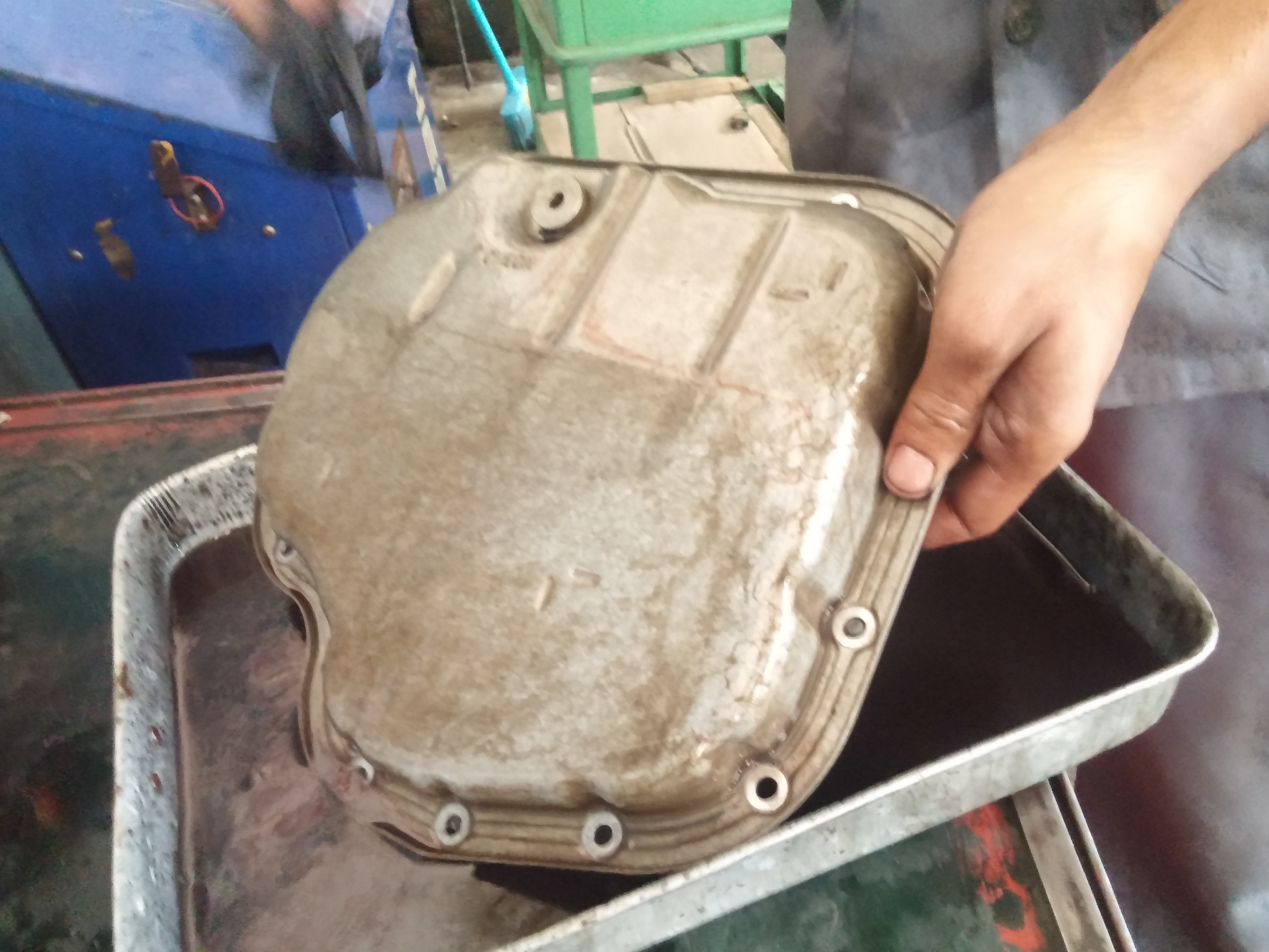

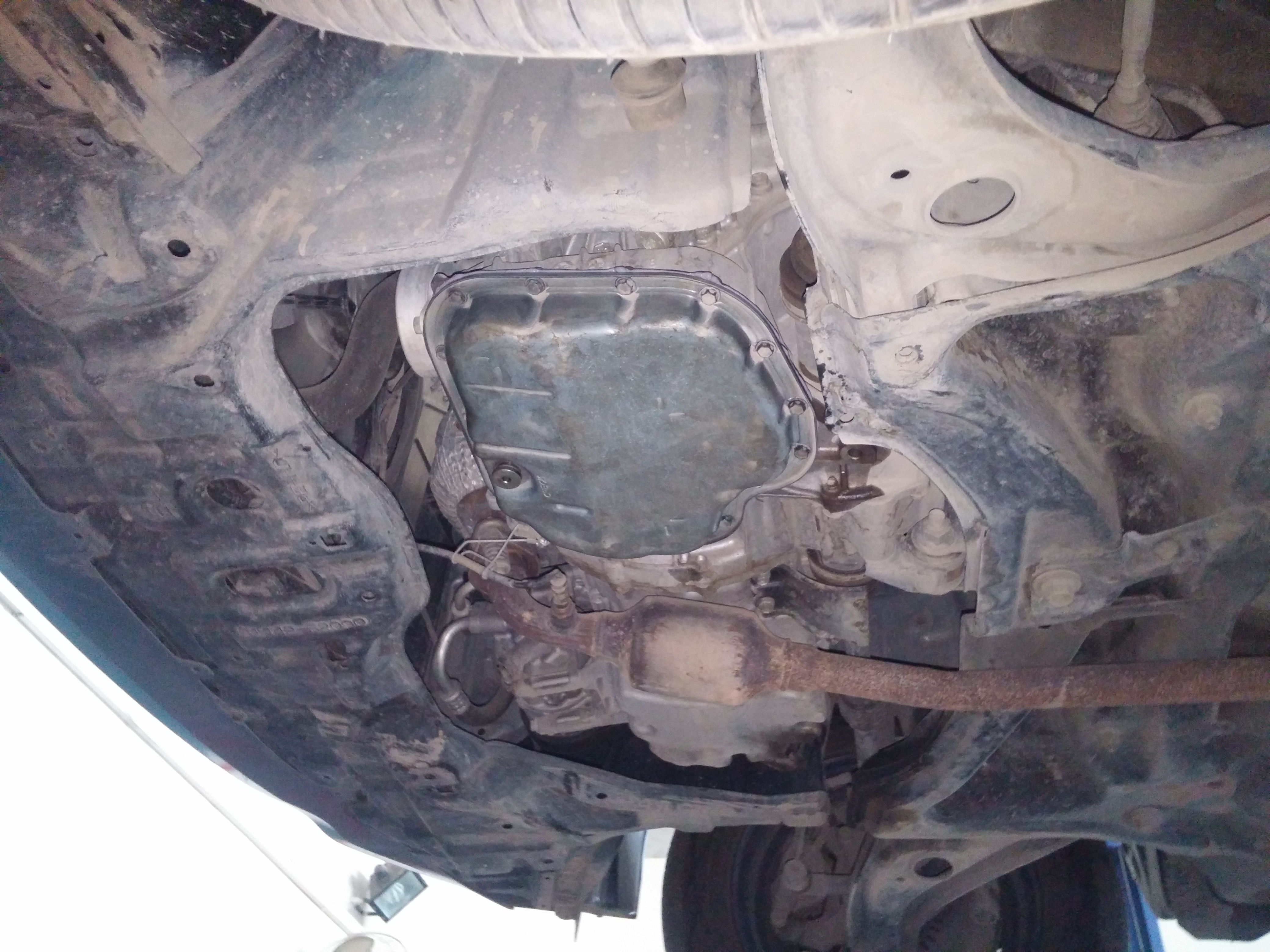

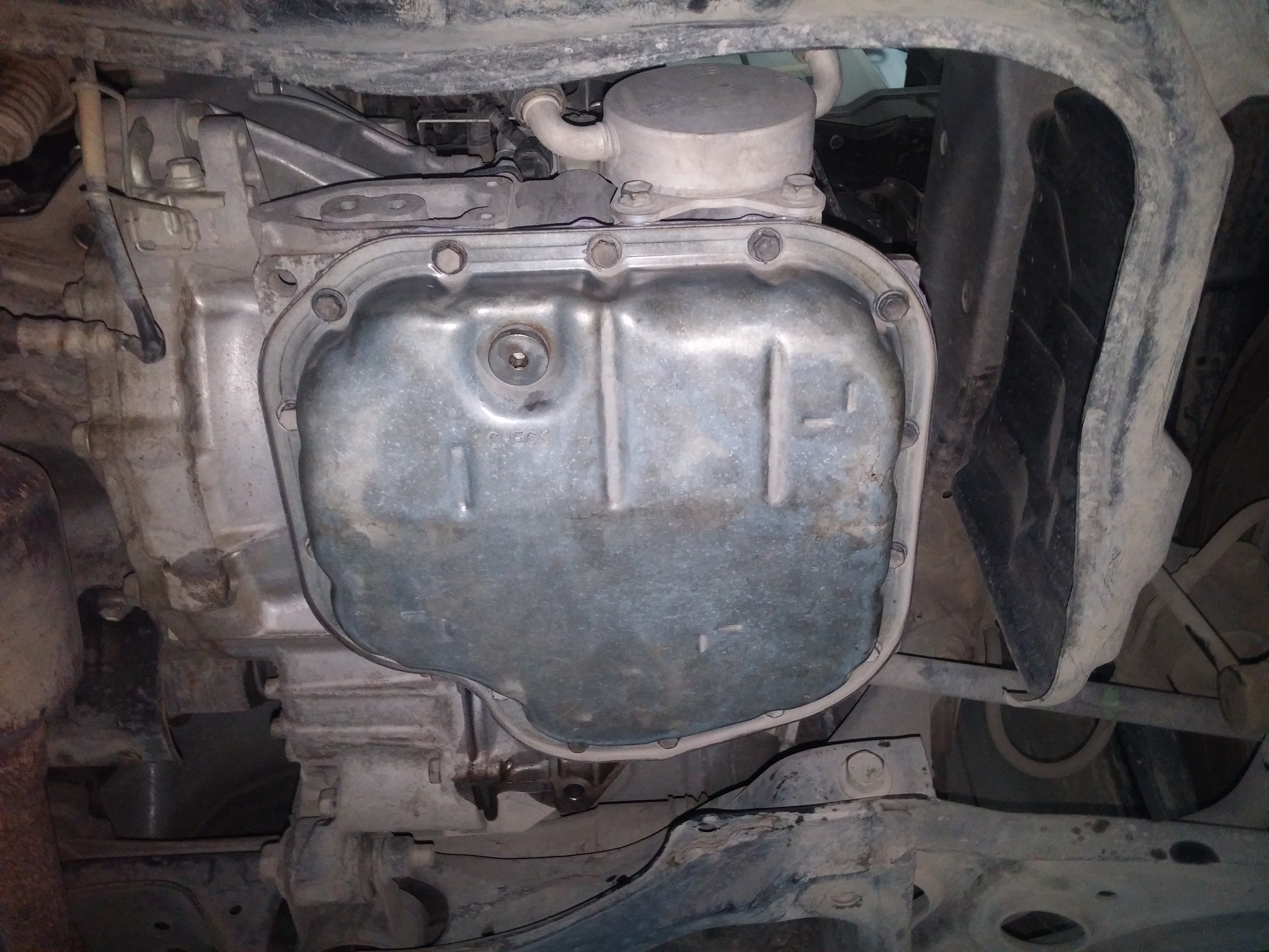

Note that this is no the whole amount of oil, prior to this about 1.5L had already been drained. A few screenshots from the bottom:
Slightly better bottom view:

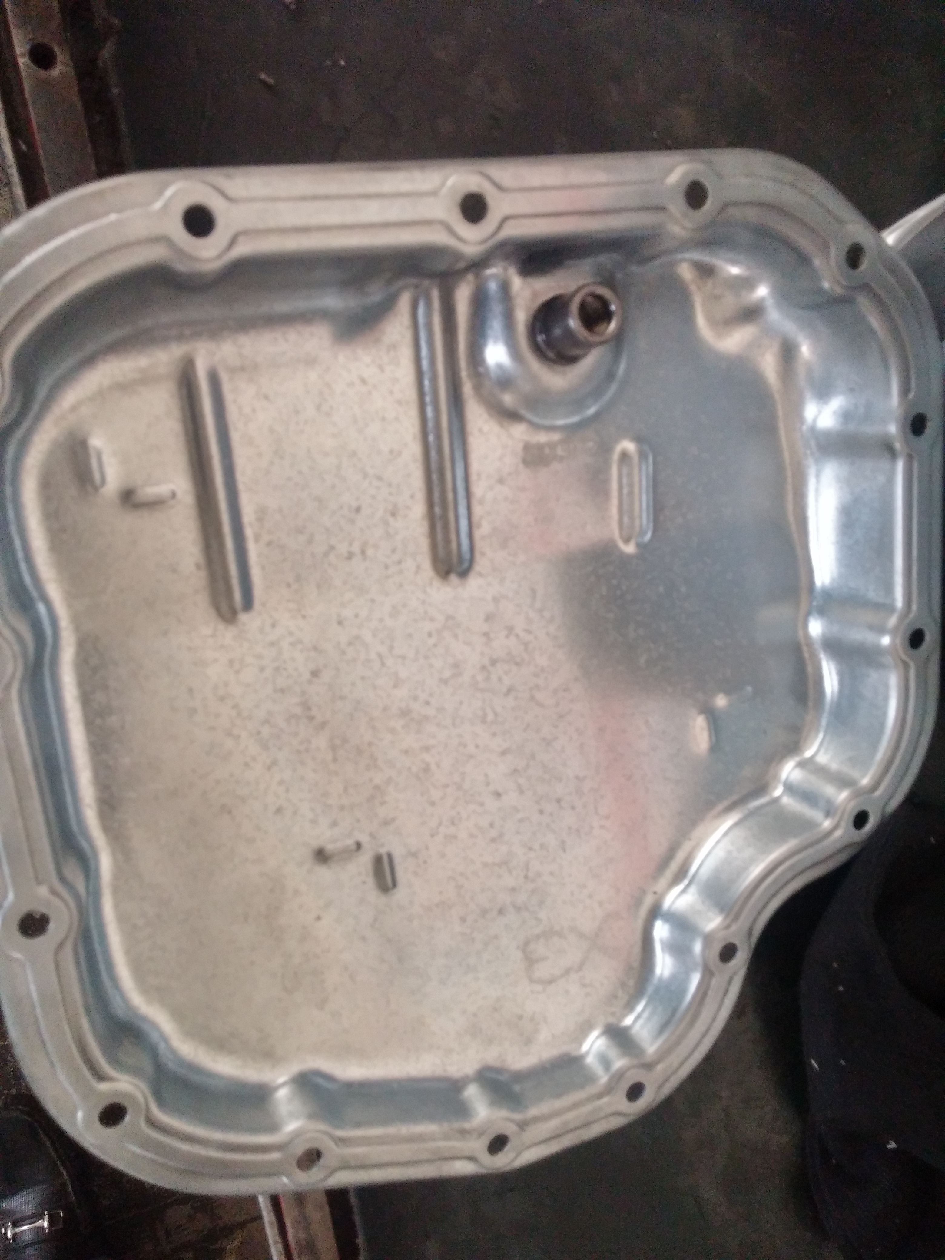

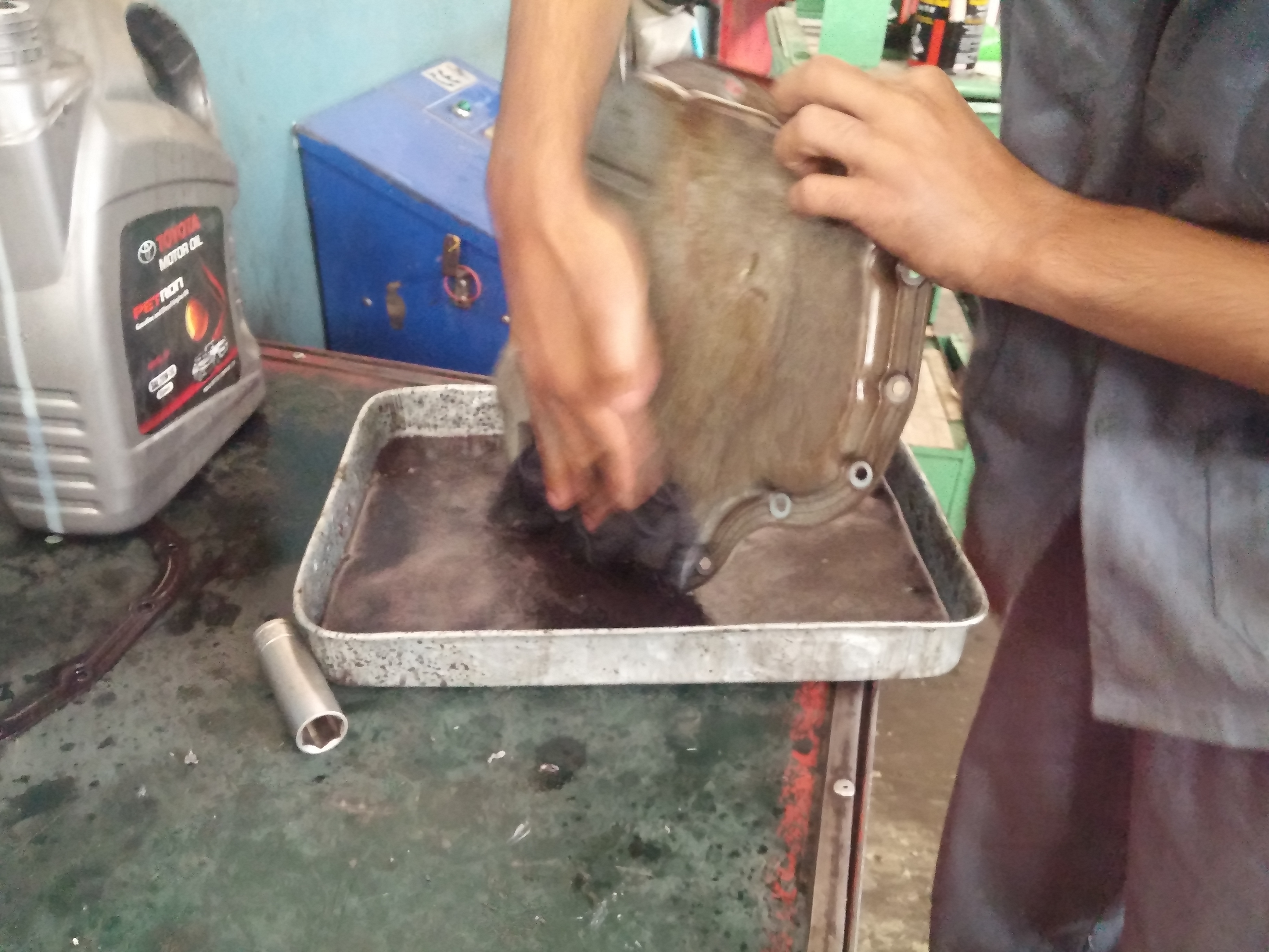

This was removed from the bottom and washed multiple times with petrol. The guy was very thorough with his method, and kept rinsing and repeating:

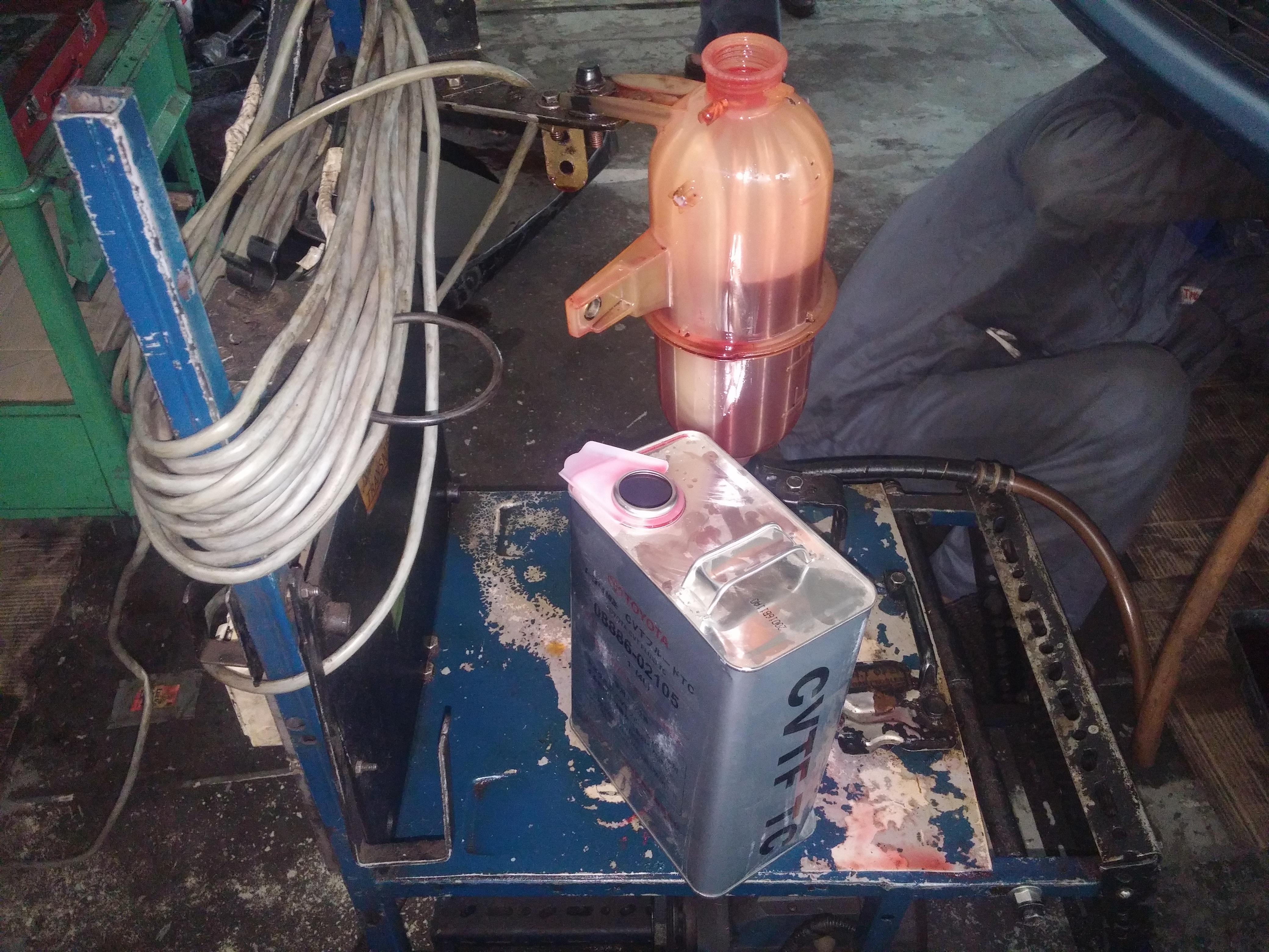

They weren't really sure about which oil to use, but I had done my research and knew that only Toyota's CVT-TC Fluid should be used for these transmissions. After opening the big nut from the bottom, it read "TC", after which they confirmed that the same oil should be used to refill. Part number for the oil is "08886-02105":

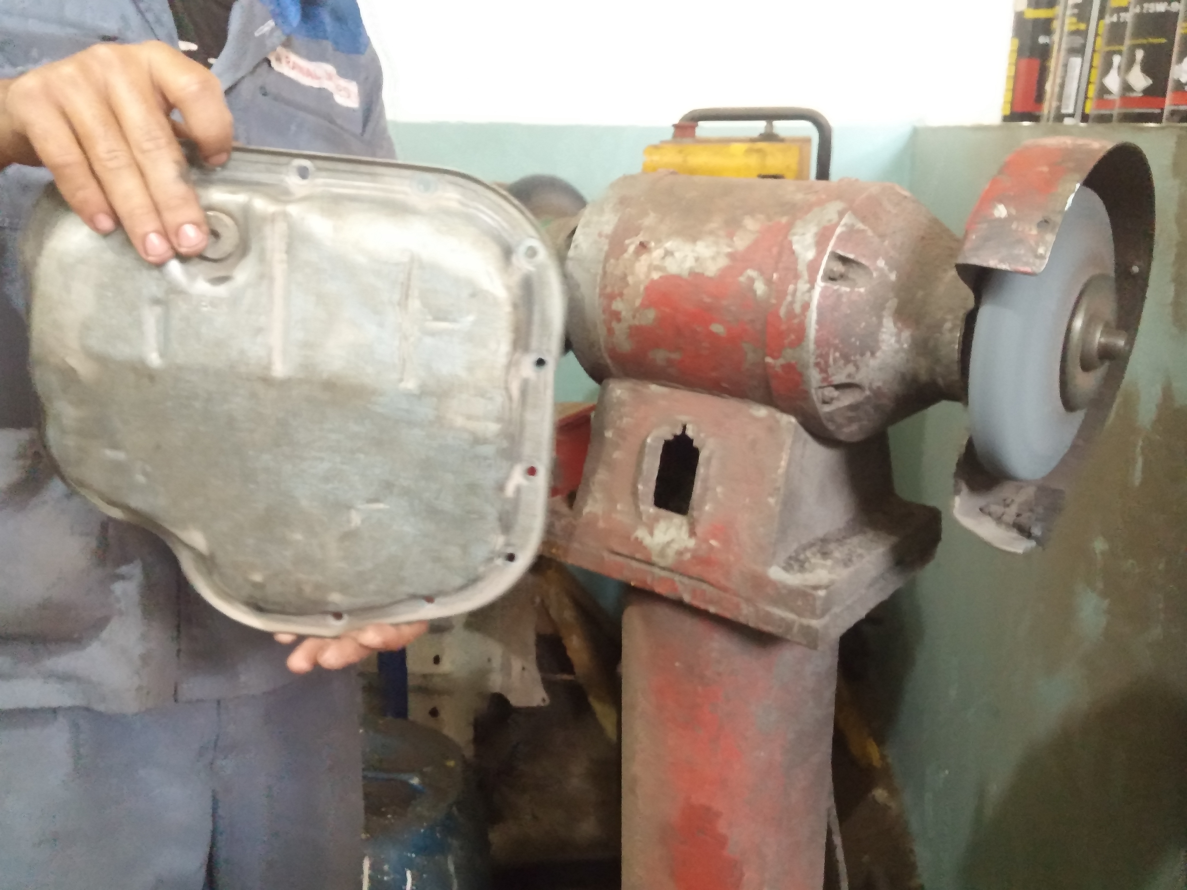

After thoroughly washing, a grinder was used to probably shape the edges and clean the outsides:
Shiny, isn't it?:
