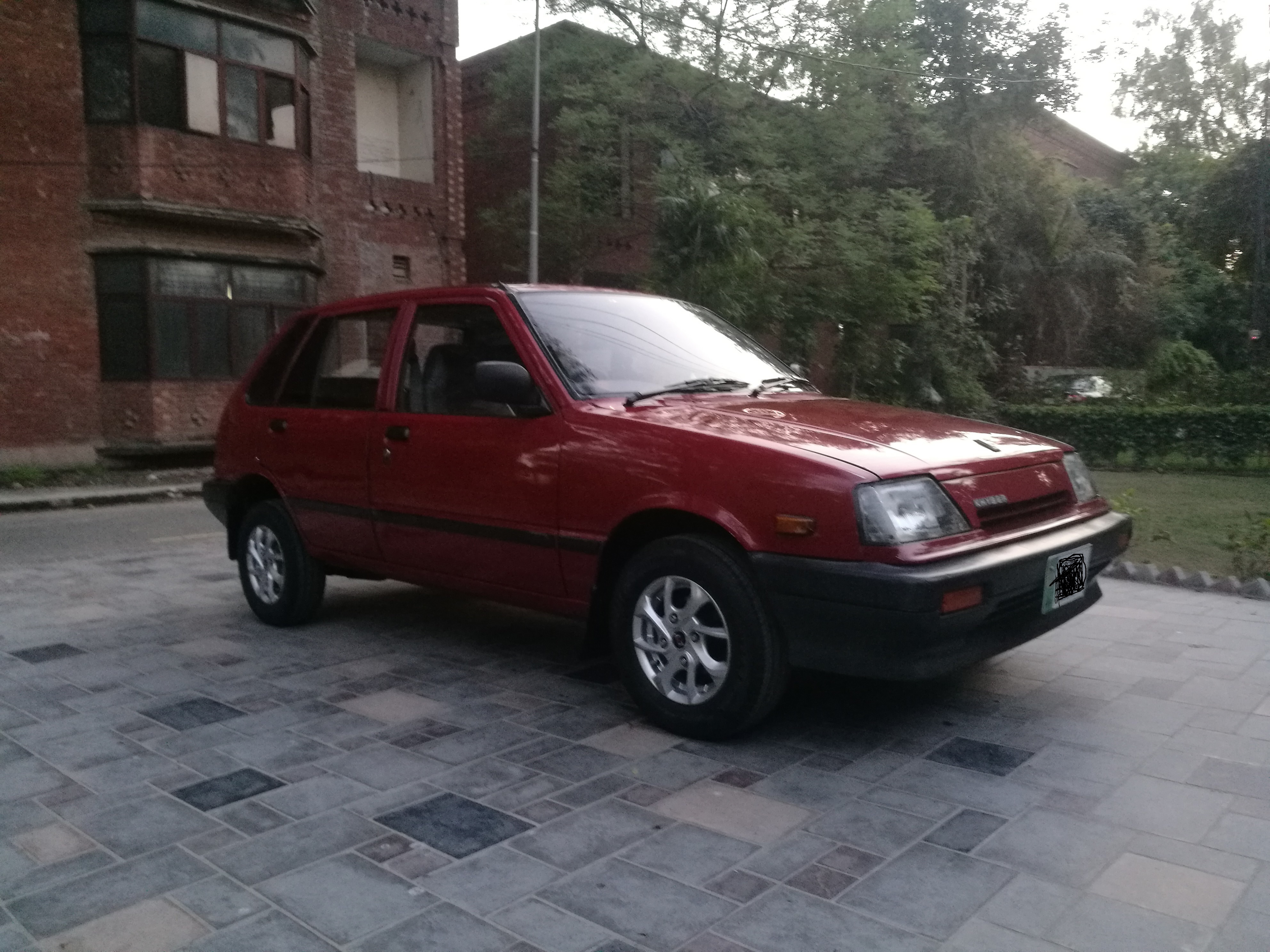

As for engine oil, 20w50 oil is okay for Khyber. But if the engine allows use the lightest viscosity, it will help improve performance and mileage, the difference won't be much but the car will feel lighter on it's feet. Here you can see the recommended engine oil viscosity and more information regarding your car's engine.
https://www.carrepairdata.com/service/repair/manual/eng/suzuki/swift/1_0/1985-1989/g10/993/37/
Yes I recommended someone to use LiquiMoly MoS2 in their car, because their car's engine was noisy. If yours is too, purchase LiquiMoly Ceratec, it is even better than MoS2 but more expensive. It will create a thin layer of ceramic on your engine's moving parts, reducing friction and making it smoother and reducing noise to an extent. Look it up, it has great reviews, much better than Mos2 but more expensive.
As for AC, everything along with the blower might set you back around 35 thousand give or take. For seatbelts you can go to any scrapyard near your city (sultan ka khoo pindi/shershah khi), you won't find them new but with alteration any seatbelts might be able to fit in your car, it will cost you around 2000.
