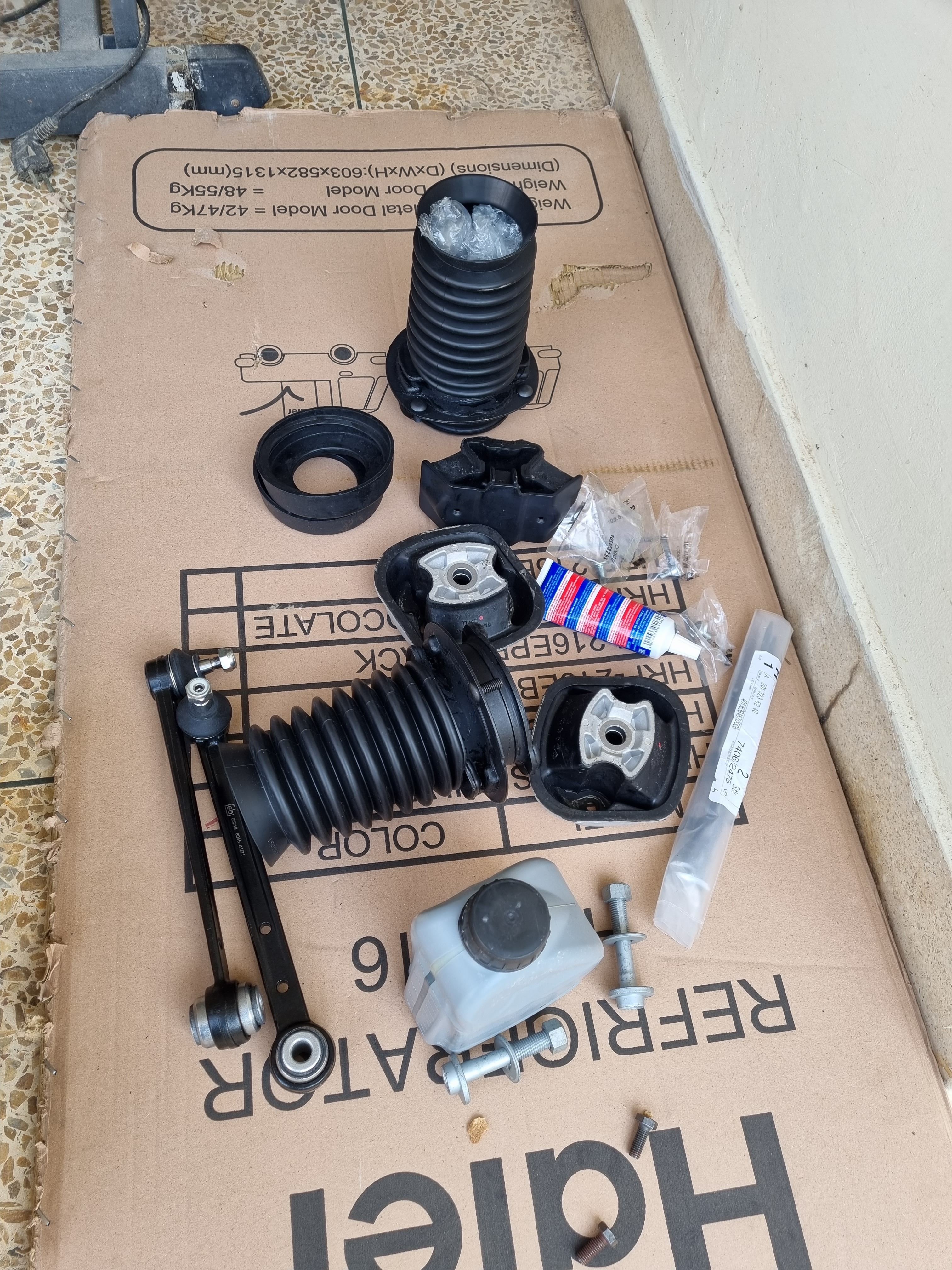

I also finally go around to swapping the remaining suspension and brake parts.
1) Swapped the front Damper struts + bumb stop + protective sleeve. The old damper struts had some hidden cracks on the underside, and one of them even had a crack on the top section. The old bump stops were destroyed and so were the protective sleeves.
2) New rear spring rubber mounts
3) New rear track rods. Decided to use the original eccentric bolts after marking them and simply swapping the new washer + hex bolts. The new eccentric bolts had a different head and I decided to stay with the original
4) Both engine mounts had been previously swapped with genuine MB mounts. I bought a No 6 & 8 hex key for the job. Parked the car on the ramp. lifter the front ends and put the car on jackstands. Next, I removed the engine fan housing so the fan wouldn't scratch it as the engine was lifted, removed the two lower bolts holding the engine shock to the frame and then the two hex screws holding the engine mountings to the engine. I slowly lifted the engine by using a large piece of wood between the ramps, a jack and a piece of soft wood under the oil pan. Once the engine clears the mounts, just go in with a 90* hex 6 key and undo the bolts. I found it easier doing this while being under the car. Installation is the opposite.

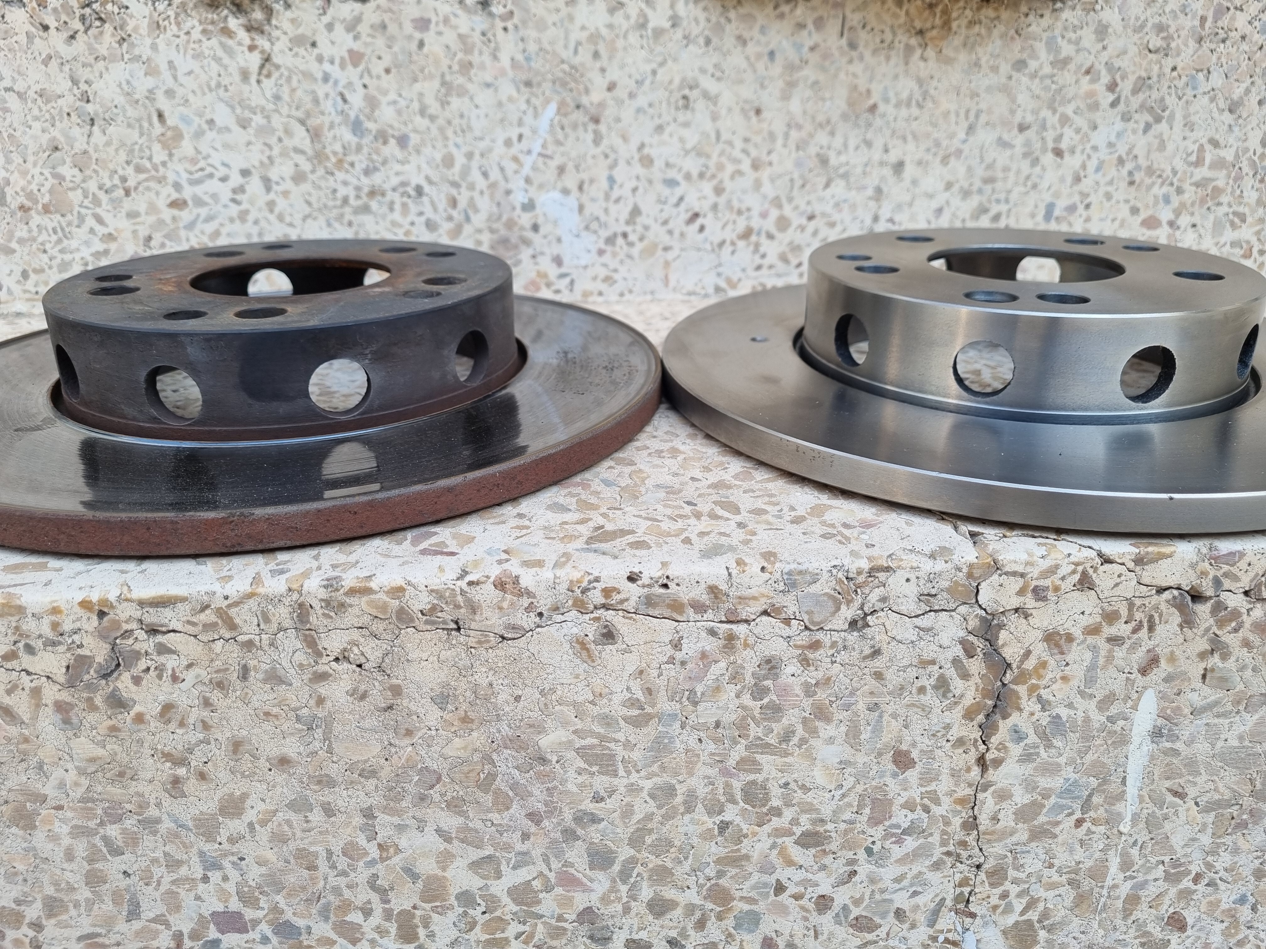

5) Next, swapped all the brake roters and pads with the Brembo kit
The rotors have an indentation indicating the depth of the rotor for a quick way to know your rotors health
