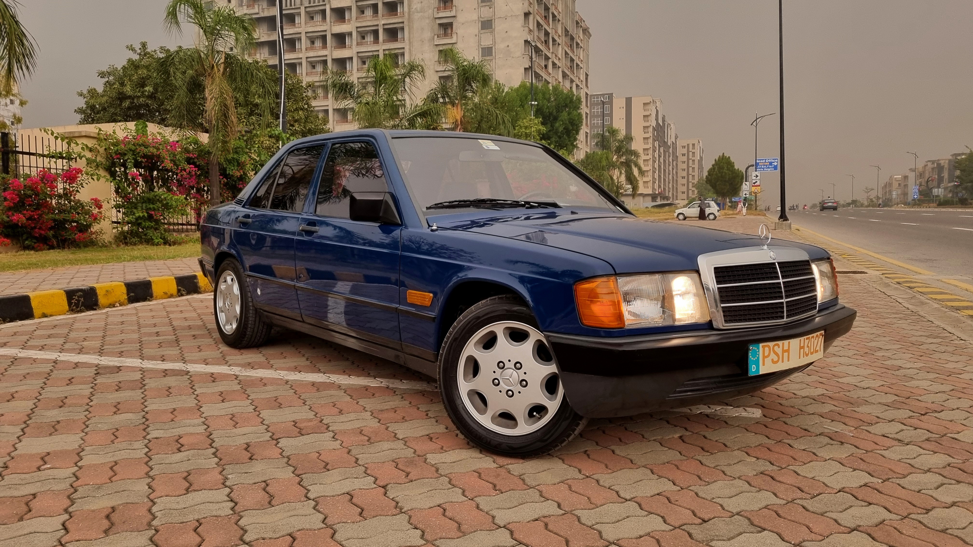

Since i've replaced all the steering/suspension components, I also decided to experiment with the springs. Since I have the pre facelift w201, these tend to ride higher than the facelift models. The absence of the body panel cladding doesn't help either.
Car originally came with 4 nub pads ( 23mm ) on the front springs and 2 nub pads ( 15mm ) on the rears. I swapped these to 1 nub pads ( 8mm ). However, I always found the rear end to be riding a tad bit higher. So I've now ordered a set of the 2 and 3 nub pads from MB to swap around and see what works best
The Eibach prokit 40mm springs are what I will be installing in the car. The springs will be arriving via cargo hopefully by May. I had the chance to opt for the H&R 40/40 but from what I read, these tend to ride harder. The Eibach prokits are more forgiving if a tad bit firmer.
The aim isnt to become a low rider of any sort. My front ground clearance with the stock spring + 1 nub pad is perfect. So the eibachs will be set and adjusted with the correct nub pad to get the same clearance at the front. The rears however will be adjusted to the point where the car sits flat. I'll see which pad will work best to get that height
