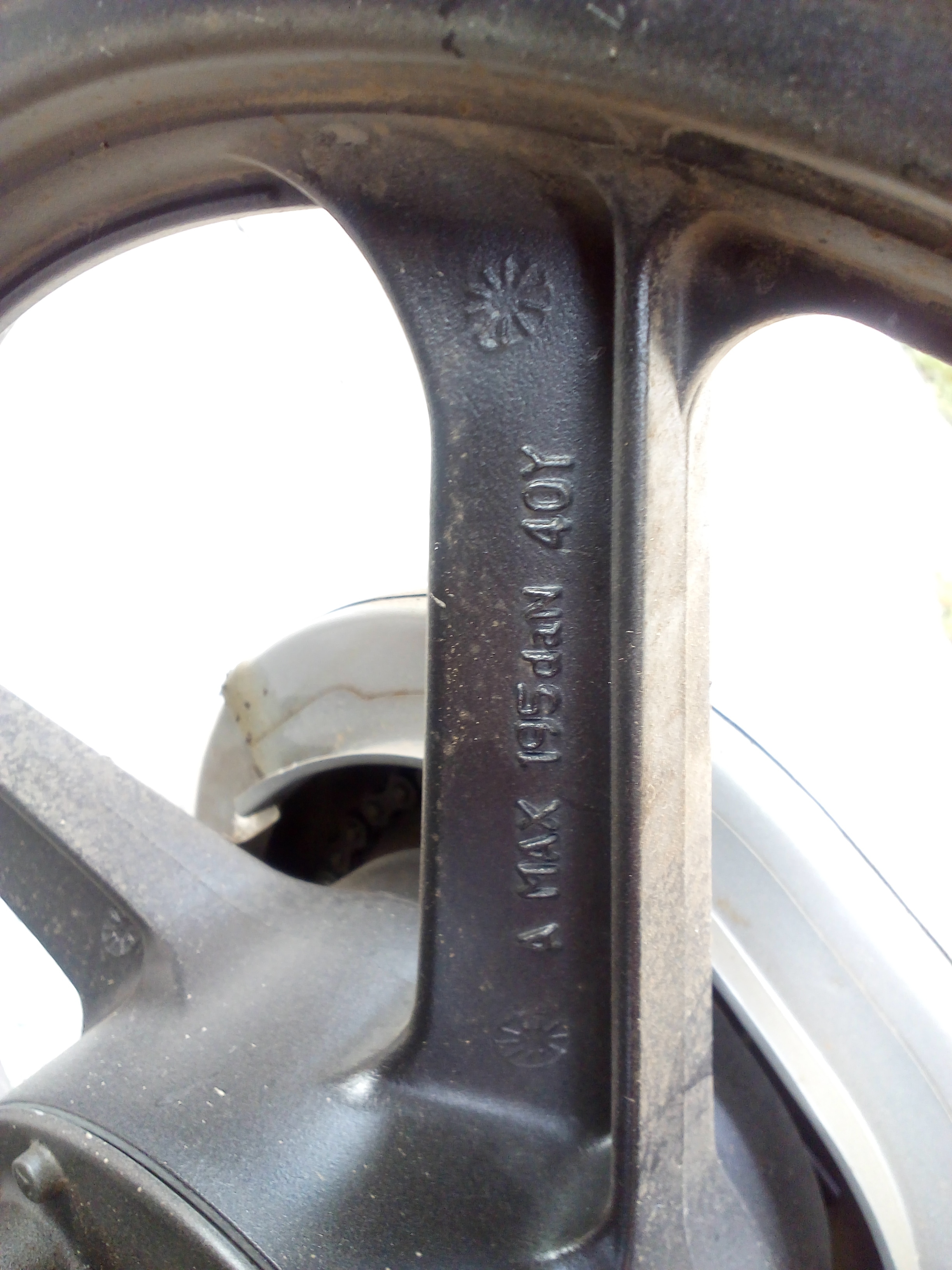

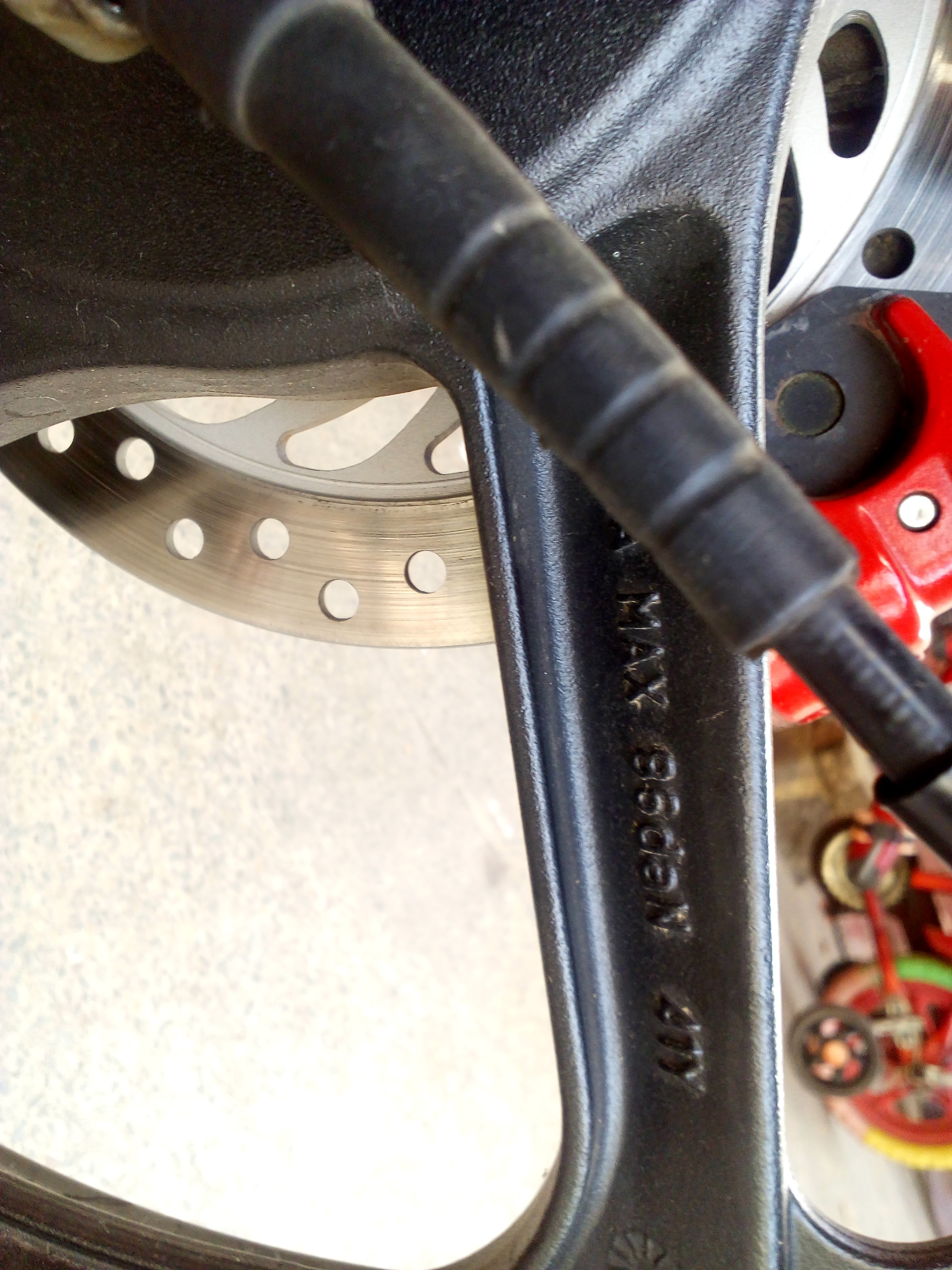

CB125F-SE Rim size

I am planning to install Panther Traker instead of stock tyres:Front: 3.00 x 18 (Rim Size is 1.6")Rear: 100/90-18 (Rim Size is 1.85")

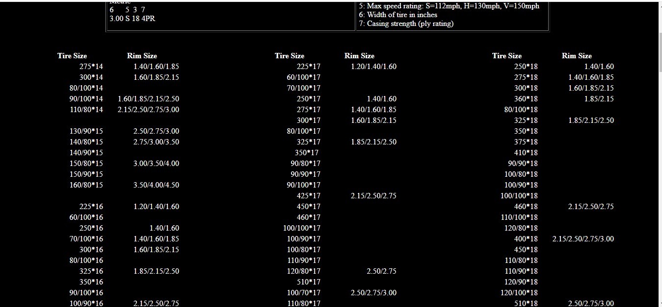

as per rim to tyre size on following link this is okhttp://kawatriple.com/tire_rim.htm
kindly tell is it ok for the front tyre size as well which seems ok as per attached pic on above link
same front and rear tyre size is used by Ahmad bro in deluxe on following link however Deluxe Rim as told in following video is wider than the CB125F rim
