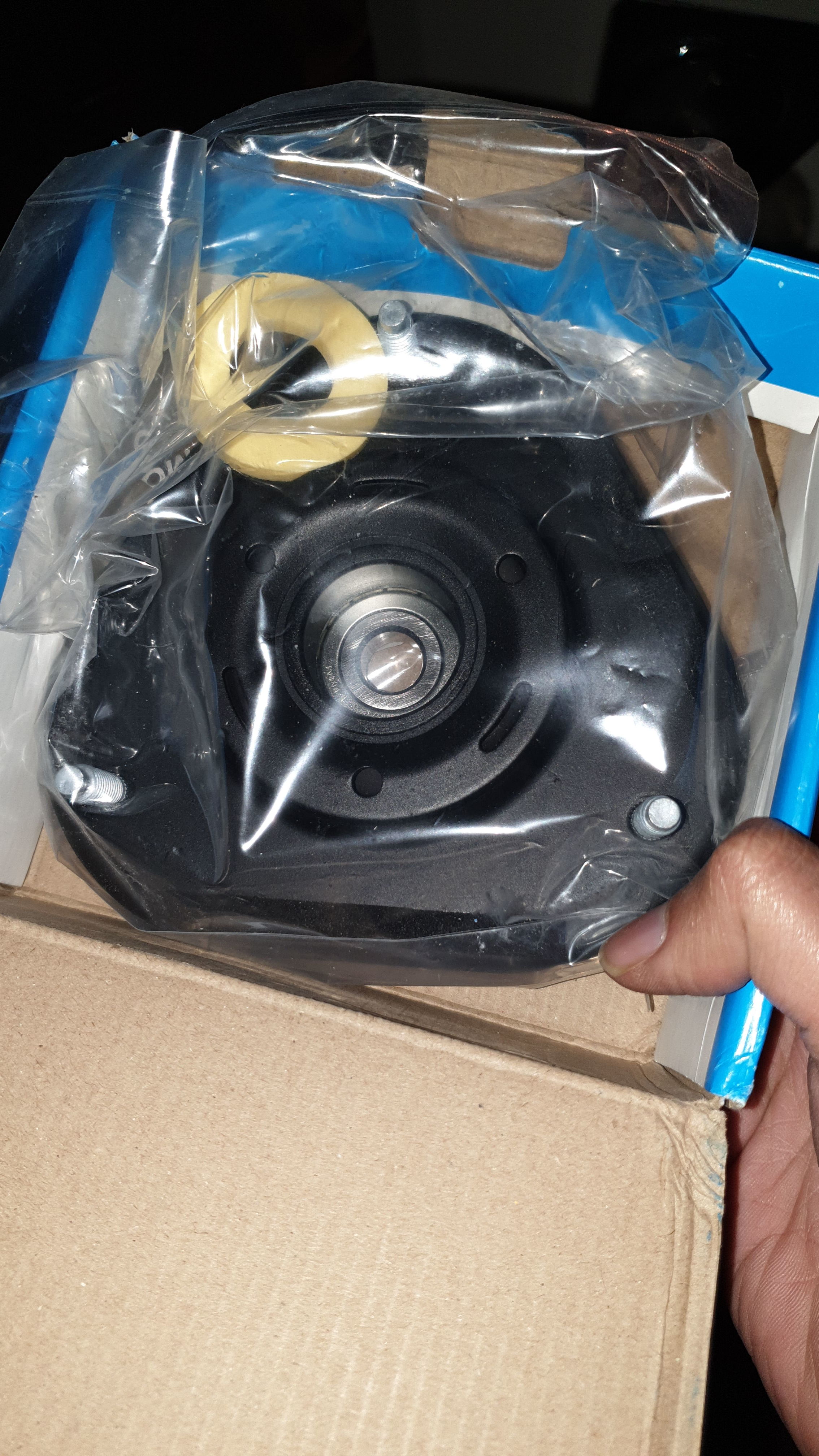

Also changed shock mounts to rbi thailand.

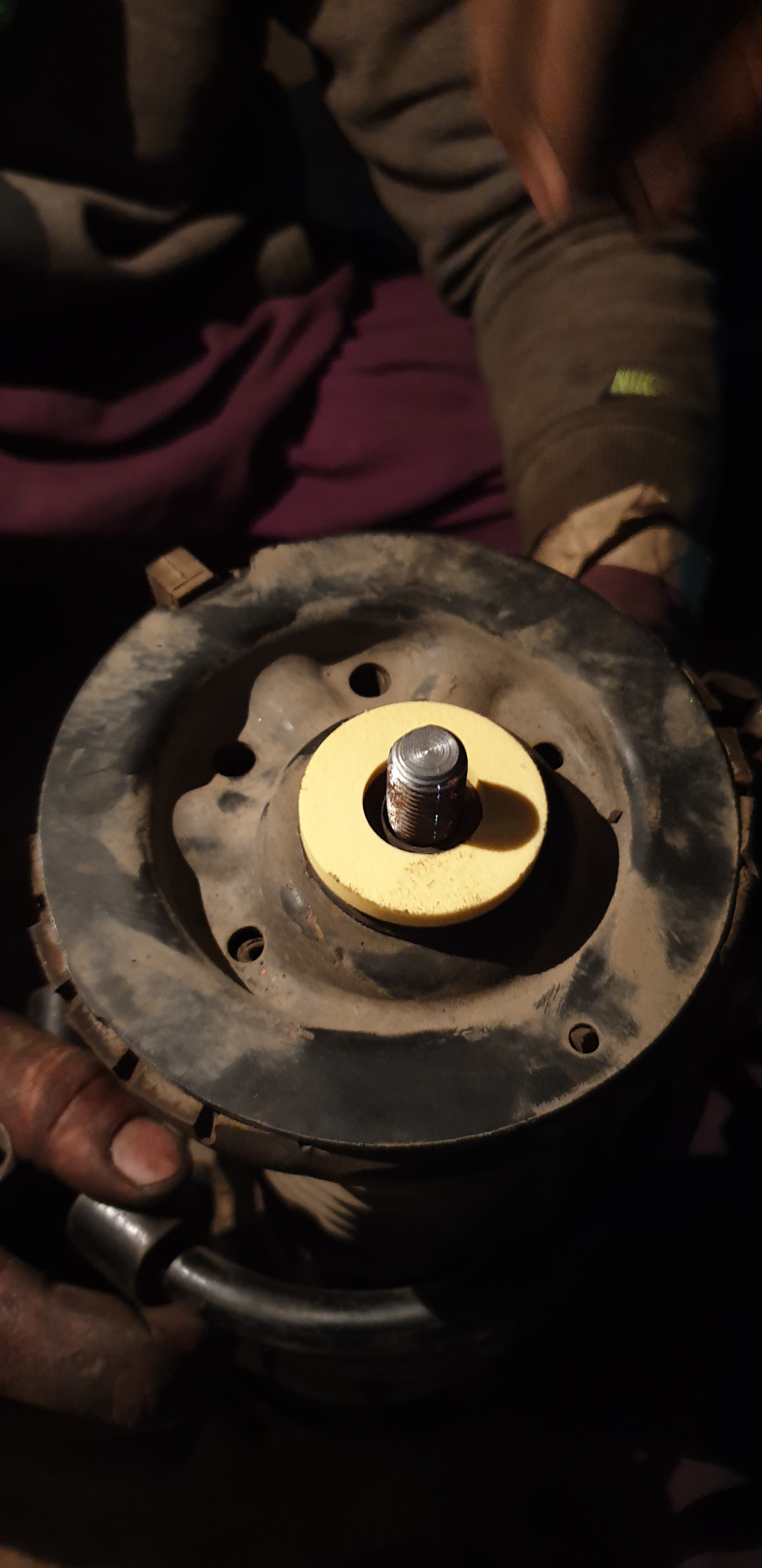

Well this is shocking to know. Do not forget to change shock mounts as well. Genuine ones do not have this piece while rbi have it. This sits in between shock and mount.
