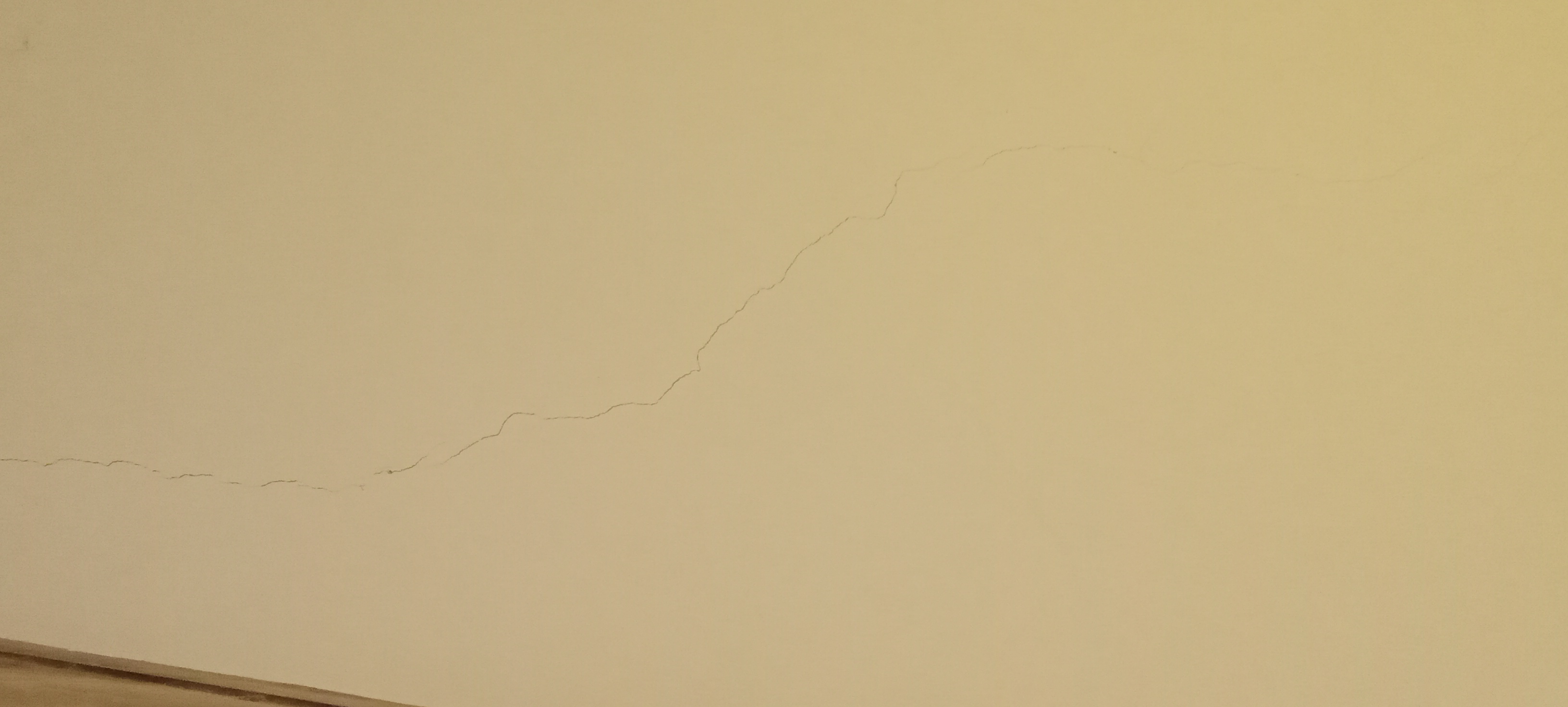

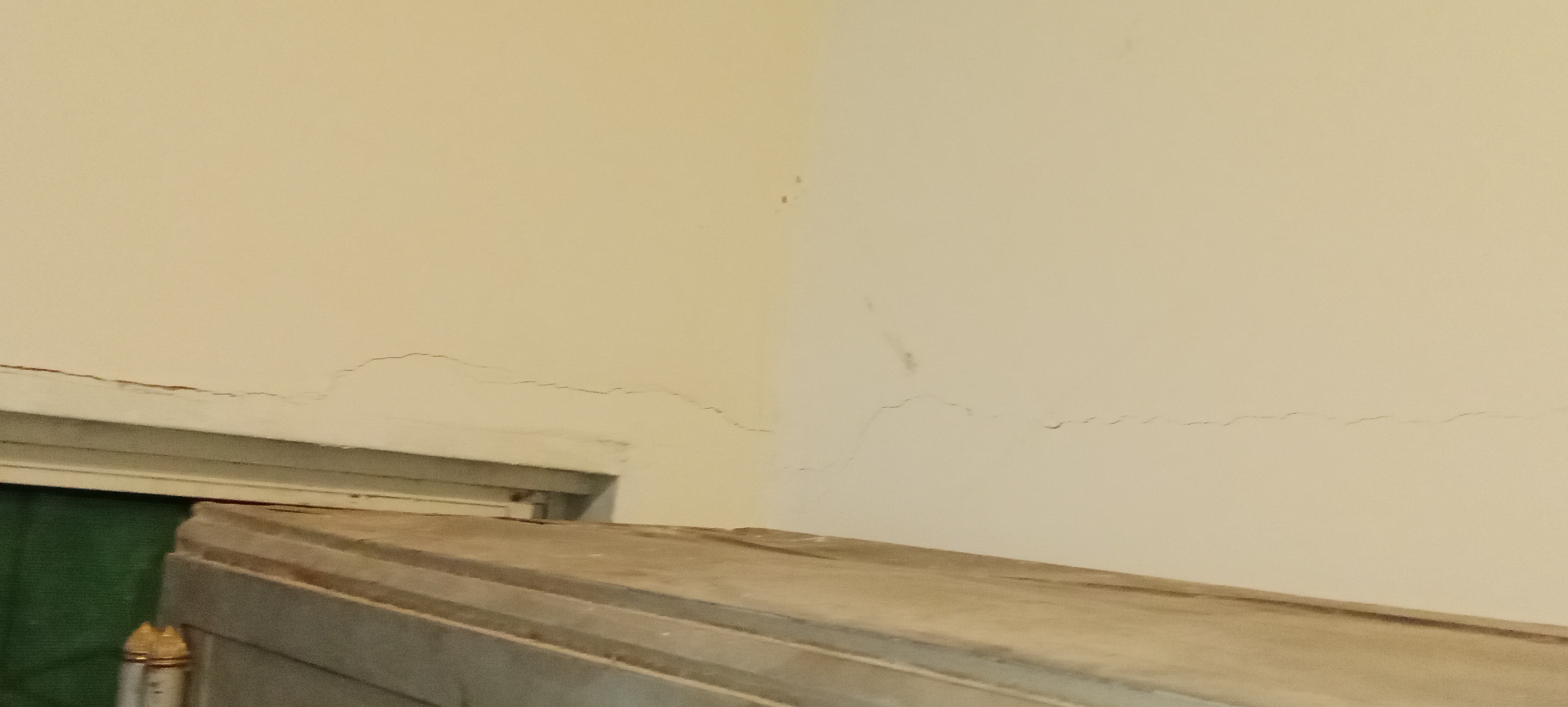

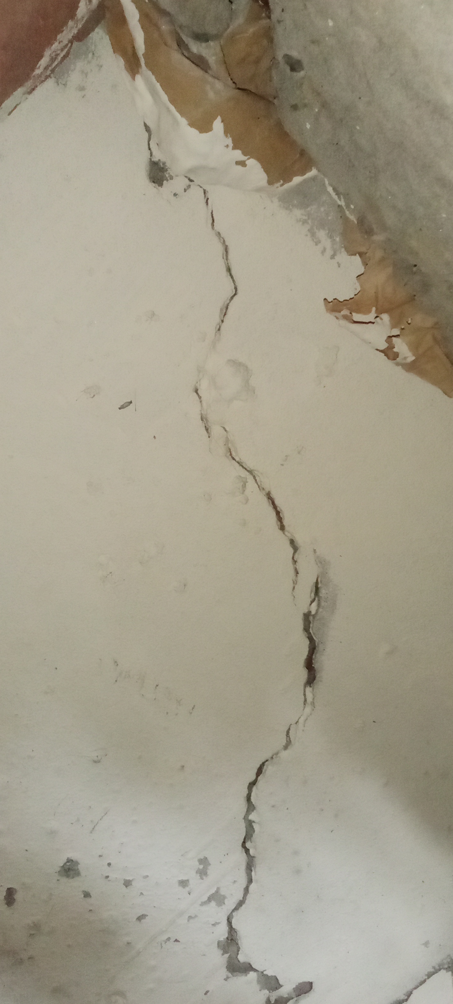

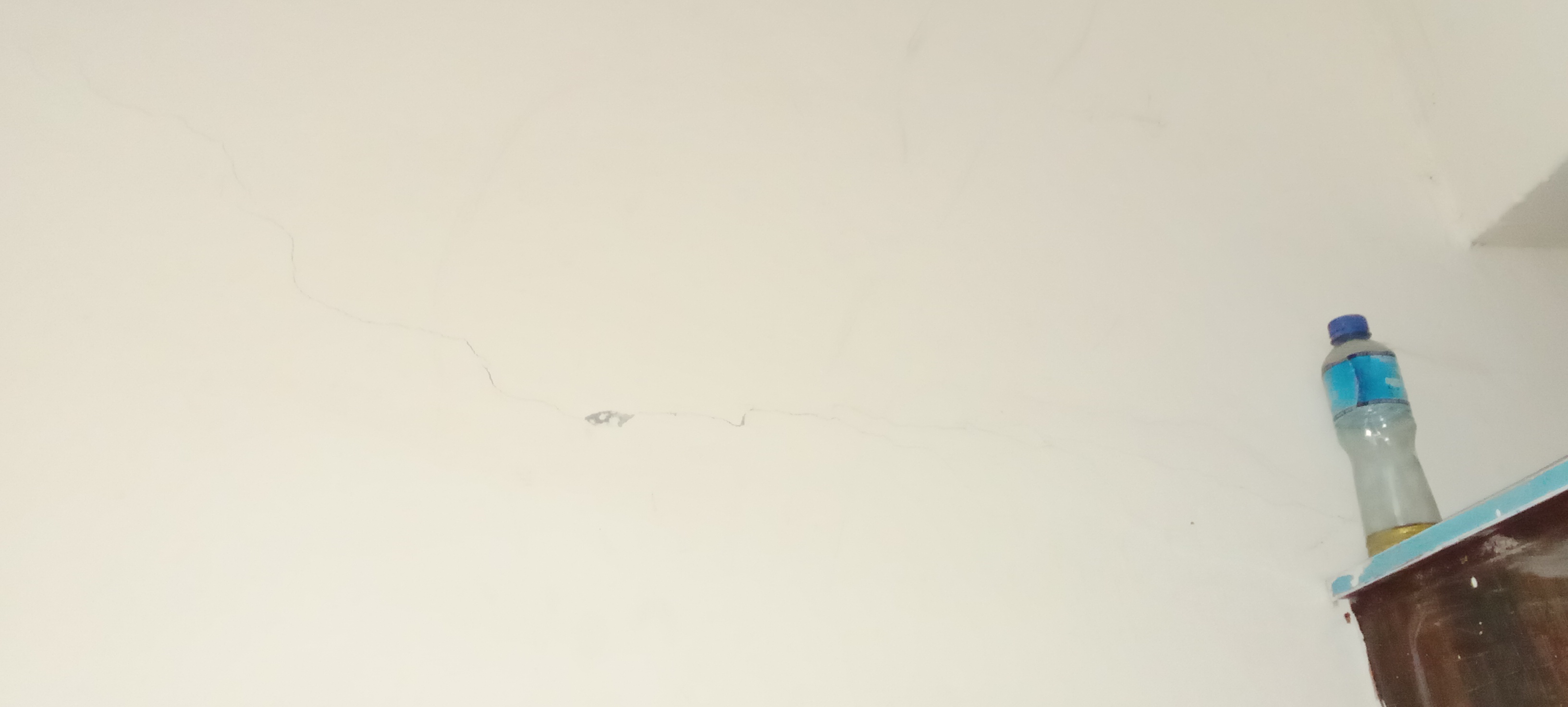

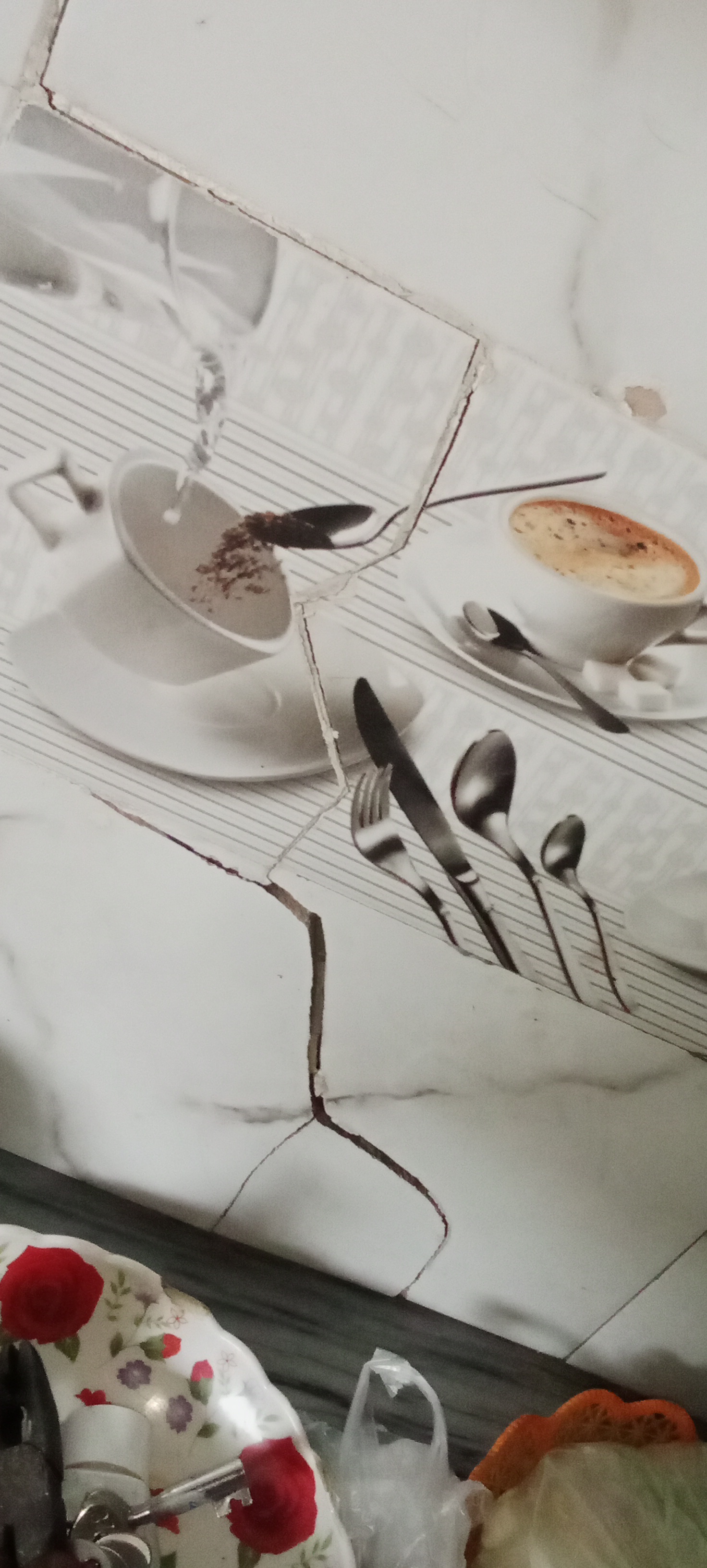

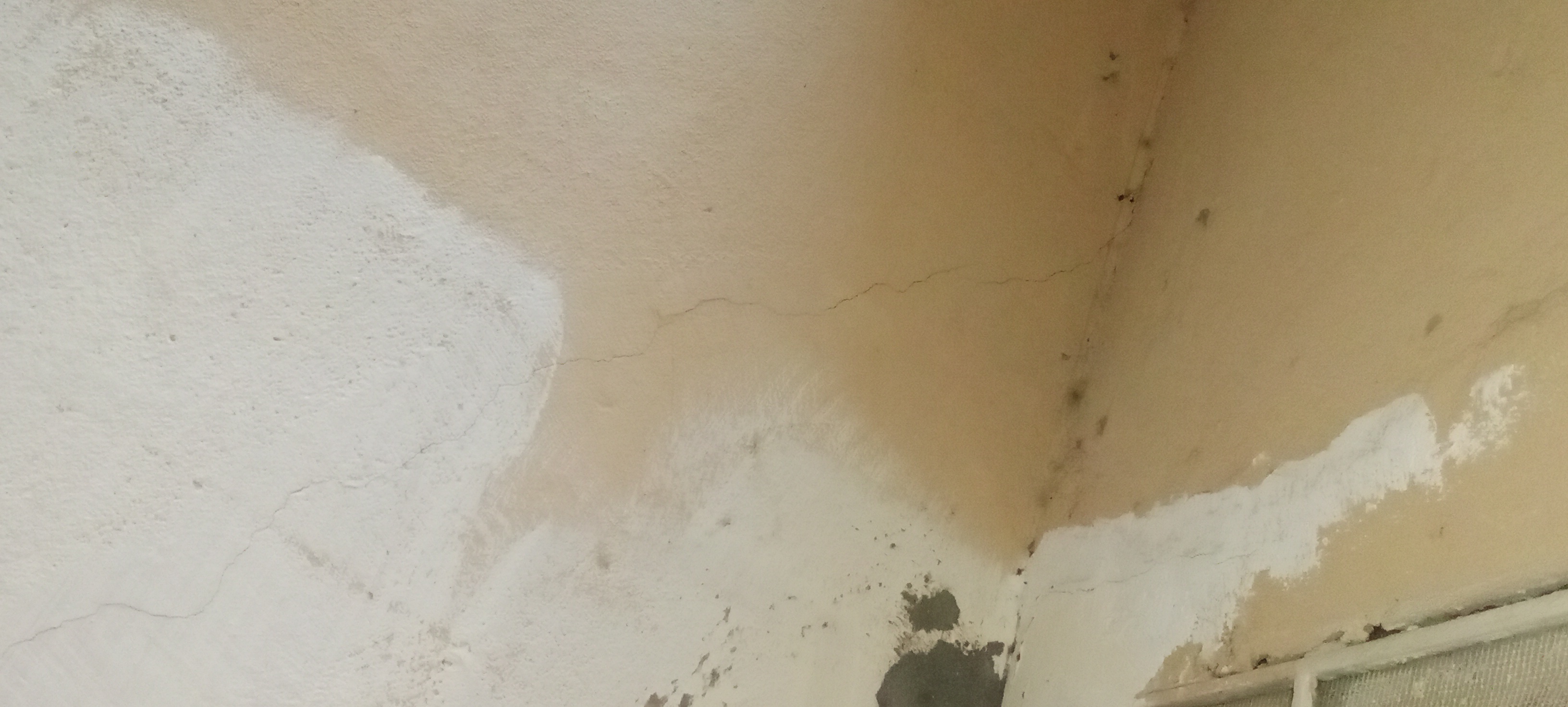

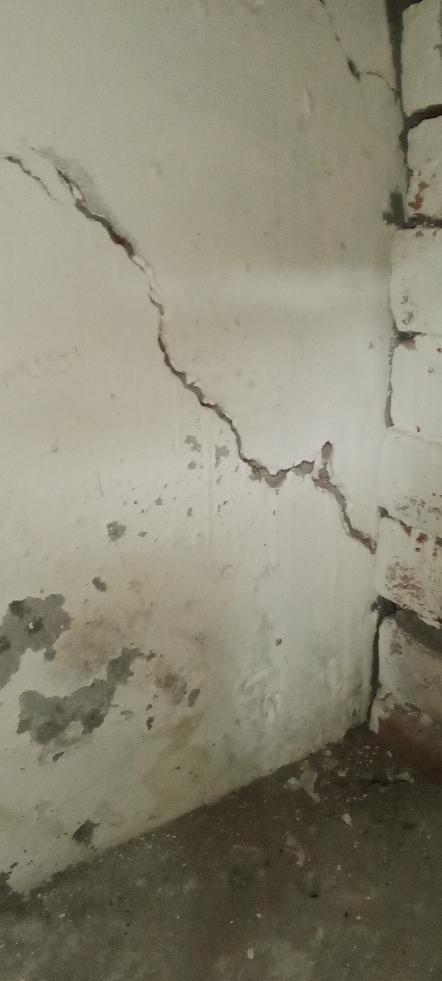

I have noticed the brick walls cracks in internal walls of my house. The cracks are on the both side of walls and at some places these are very high and can be seen. Some are moderate and some minors. Please can anyone suggest whether these are life threating?
Need some structural engineer
sir ji yeah to plaaster ka crack maloom dayta hai
kisi eik large section ko chissel karwa k check karwa layn agar brick crack ha tou pata lag jai gathe PW @tajammal84 has a independent top for house construction you may raise query there as well
Seems like foundation is not correct, or moisture/water flow/reservoir near the foundation. You need to solve that issue first. Then repair the plaster by gypsum+white cement mixture
are these fractures top down or bottom up ?? that is critical question before any Civil Engineer can guide.
