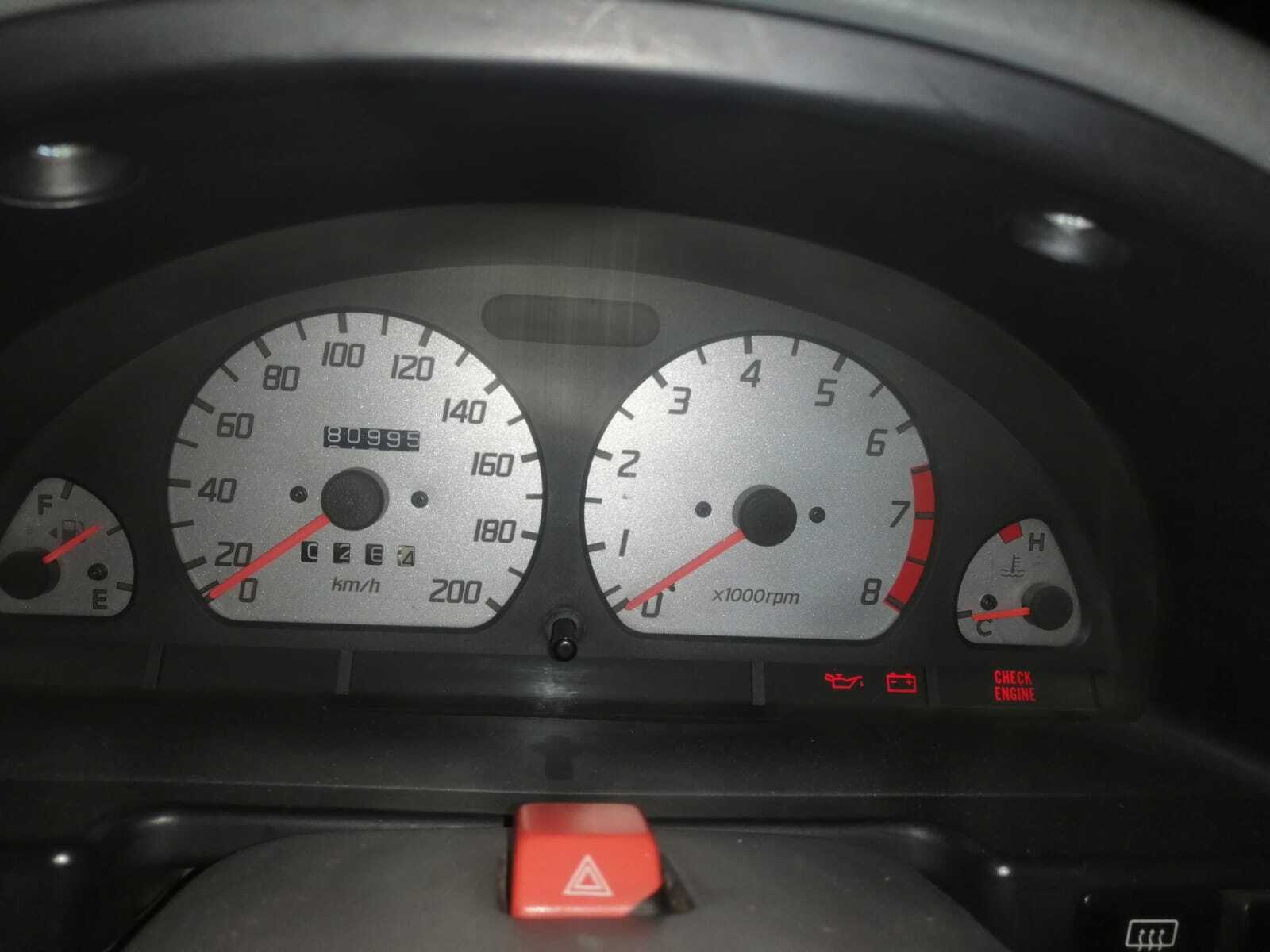

oil pressure is low (possibly the oil pressure switch or oil pump malfunction) (1st sign from left)
Generator Malfunction battery not charging (2nd sign from left)
3rd one is CHECK ENGINE LIGHT - connect scanner and perform diagnostics.
check for engine oil via dipstick
check for generator belt if it is present
Try to Start the engine if it starts, let it idle for 10 seconds 1st 2 lights shall go off, if not, -shut down engine. Try not to attempt any stupidity, contact workshop with scanner and perform diagnosis.
