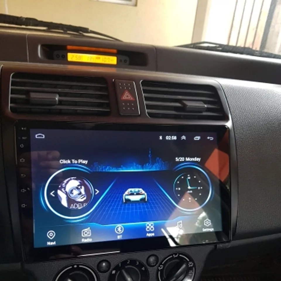

I did not change head unit to Android because those available in the market are Chinese and I've heard that their sound quality is not good. I did not go for an aftermarket head unit such as Pioneer, etc. because that would be in duplication to the OEM unit already installed, and I wanted the stock look.

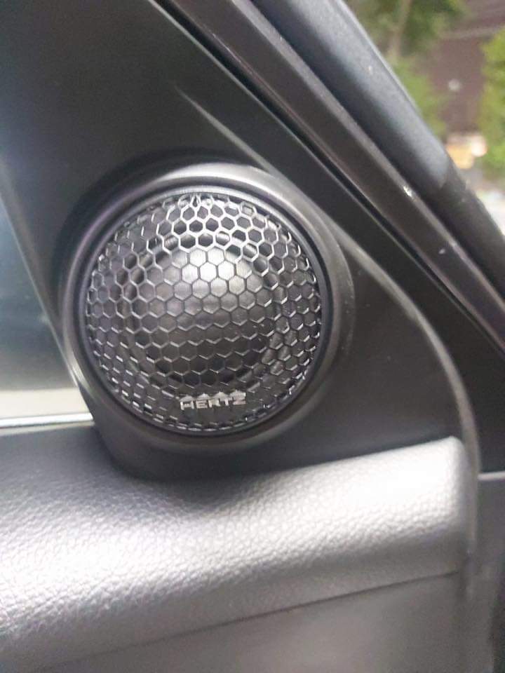

So I just changed all 4 stock speakers and also added 2 more speakers (without amp, and using the OEM head unit). Makes a massive difference to sound quality.
