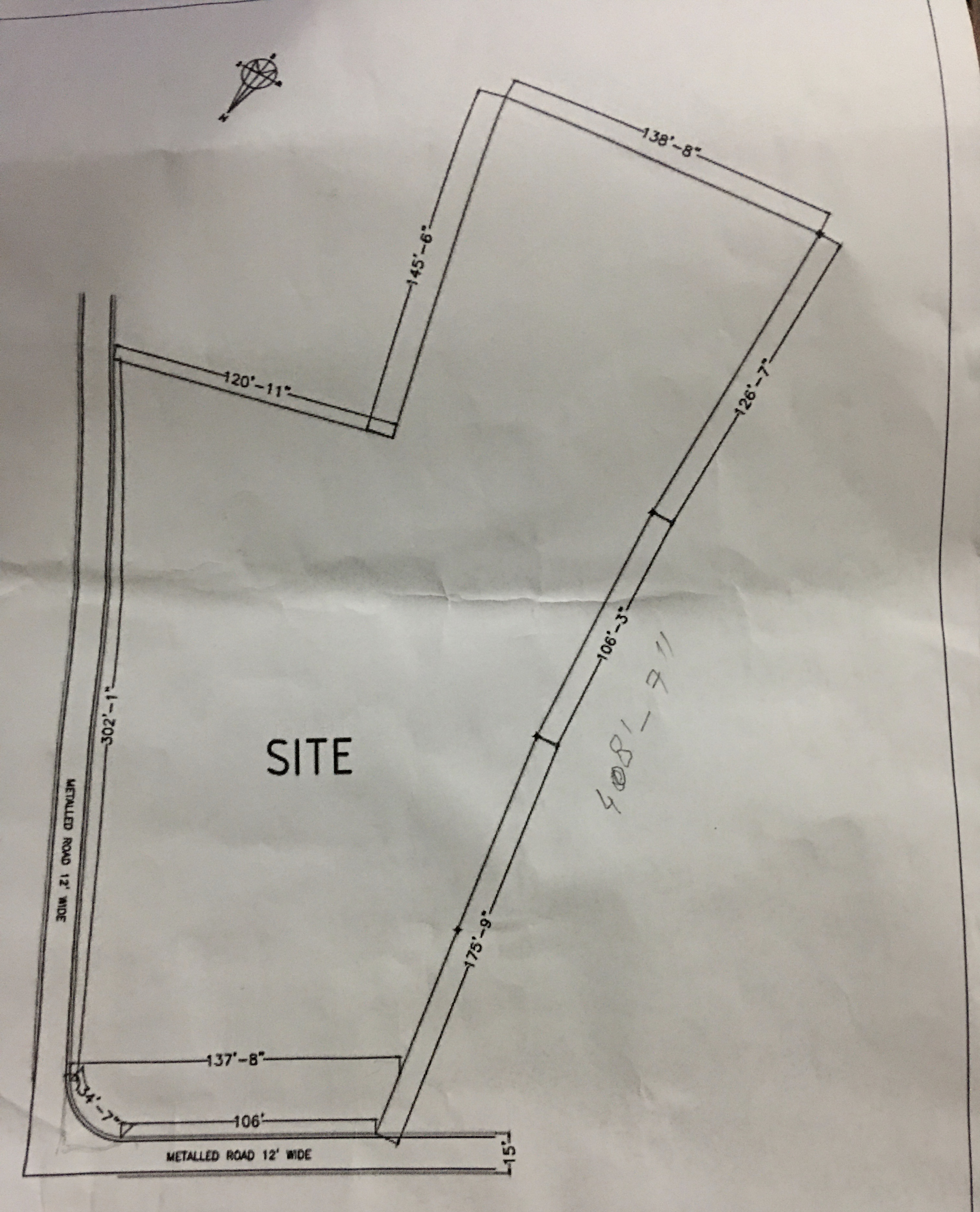

Can someone please help? Thanks!
@Tajammal84 can help
Is the right side a straight line? Are the corners in the top 90 corners?
Yes, there are corners there.
Bro we can see there are corners. I am asking if the corners are 90degree corners or not.
Yes, bro the corners are 90 degrees.

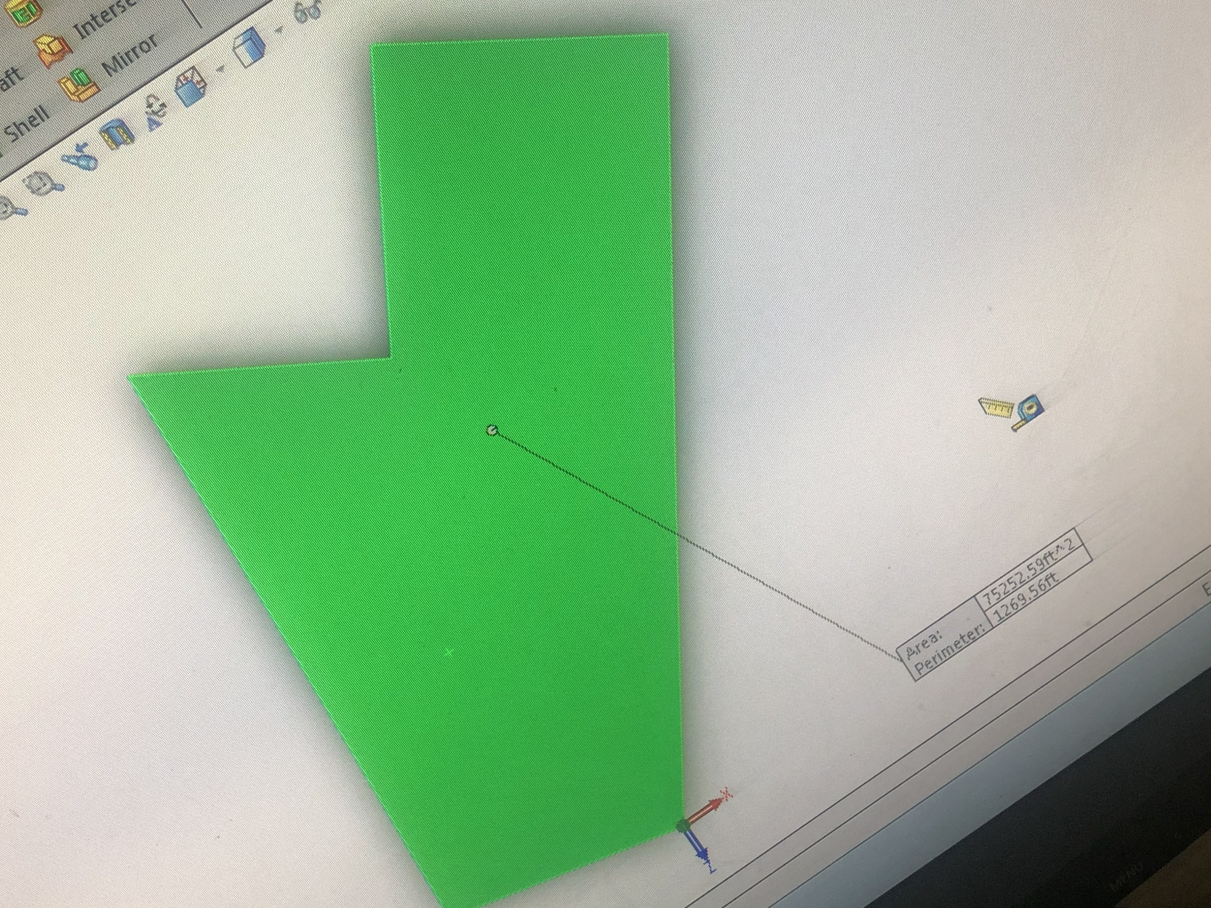

Ok bro i will try to use Solidworks to check the area. I will post results shortly
Assuming the corners are 90 degrees and assuming the right boundary is a straight line and assuming the figure of 34ft7inche is a 45 degree straight measurement and with multiple other assumptions the area turns out to be 75250sqft. Keep in mind the drawing is poorly made and i have assumed a lot of stuff the actual figure can be somewhat different
Thank you very much, umair! I appreciate the help
Which software is this that is used?
Solidworks. Developed by dassault
