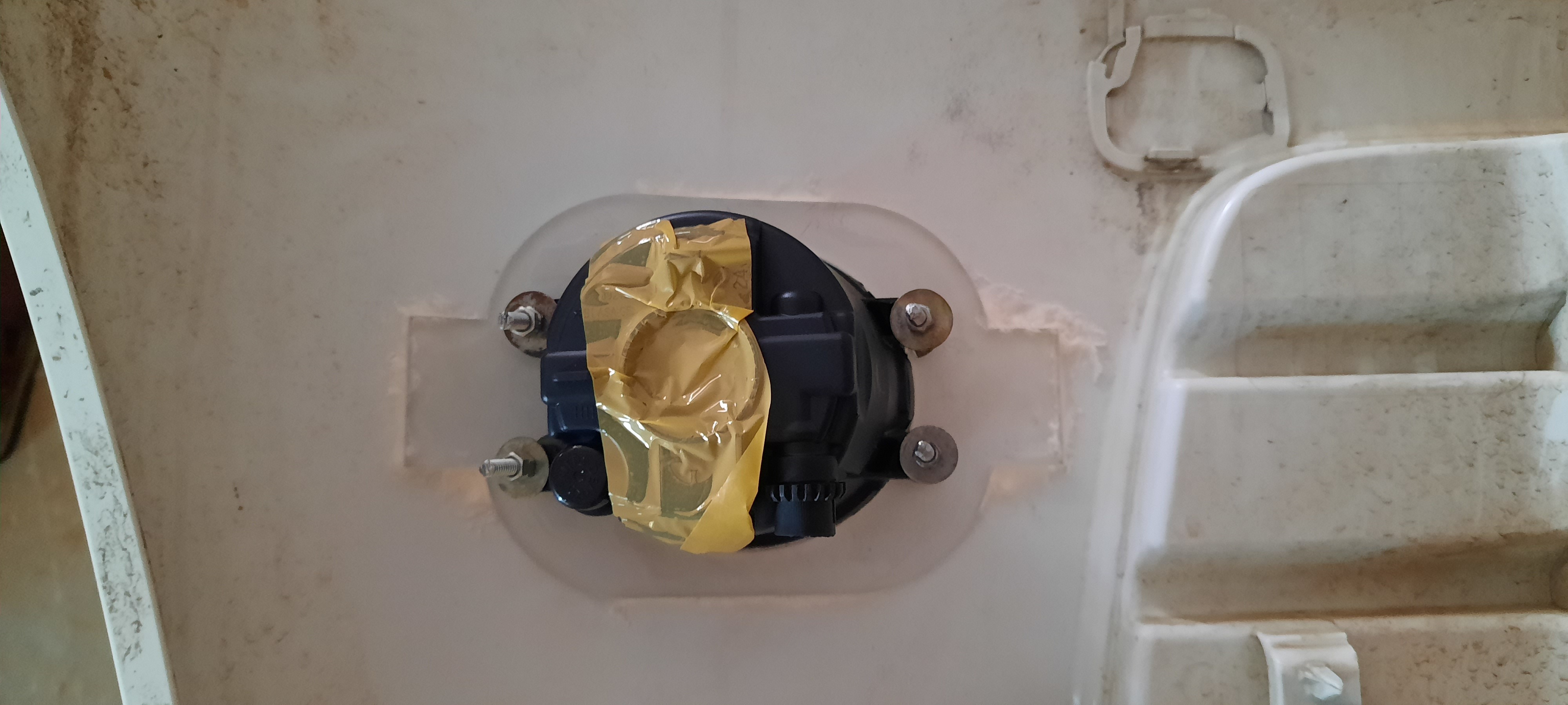

working on bezel aswell the swift one didnt work so thinking of making 1 myself lets see what happens .
done ALHAMDULILLAH will do wiring in the evening and post the results with pics in the night IA . π€
ALHAMDULILLAH done with the project MA just not looking good working perfect aswell .
next step bezels will sort them out tomorrow as the car looks ganji ganji

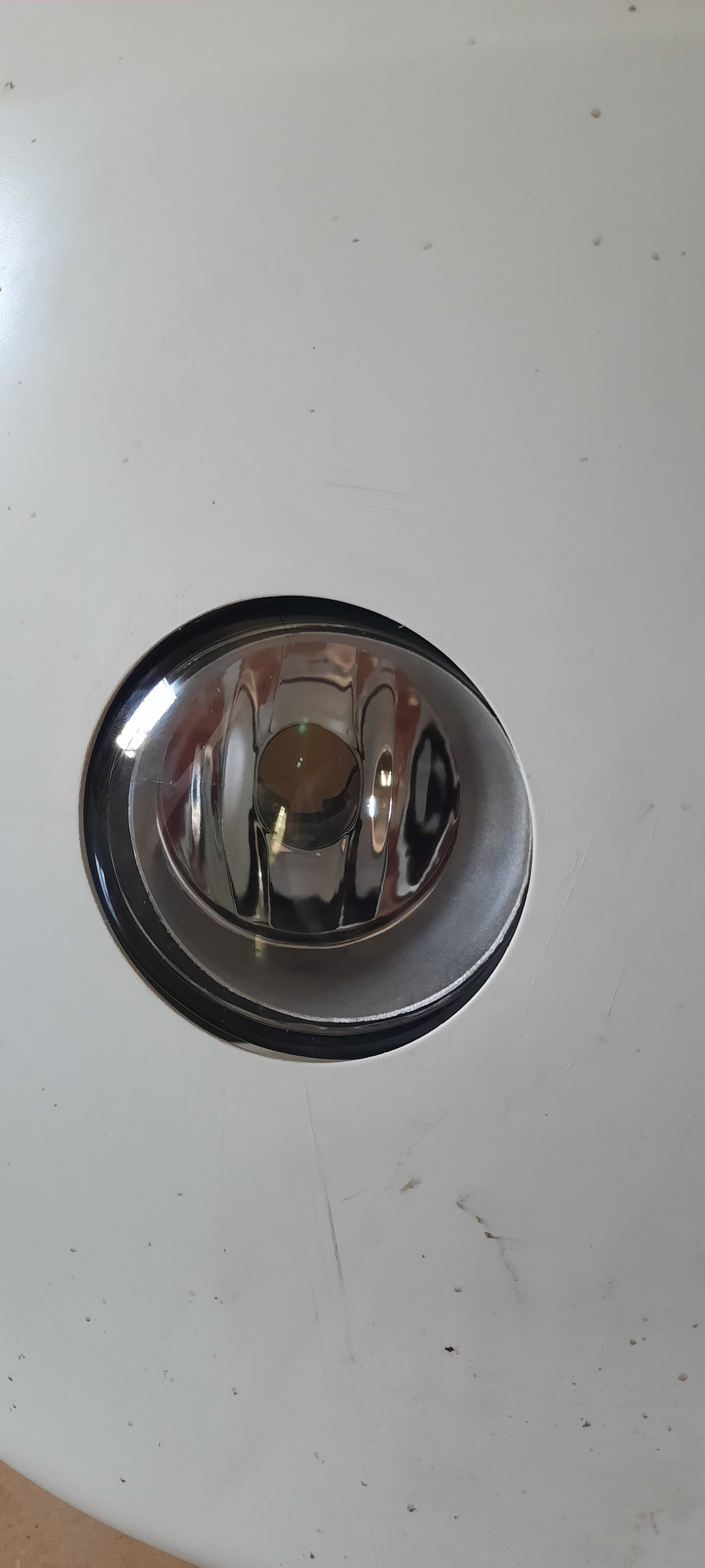

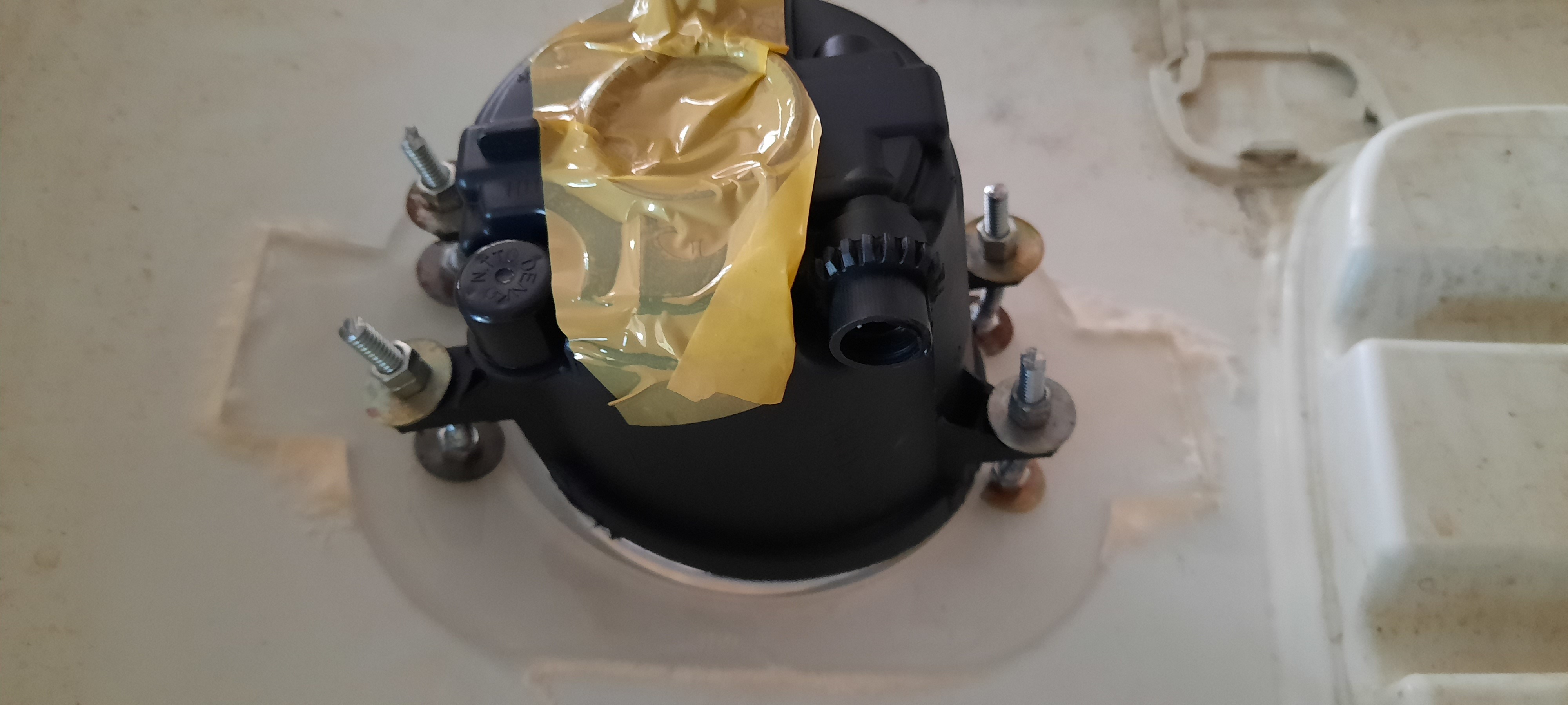

IA will install the rings tomorrow sorted them aswell , and yes i noe i dont buy anything until i inspect it physically . and yes there was alot of gap when i tried to install suzuki genuine fog light these are the pics for reference but the toyota fog lamps sorted it all .

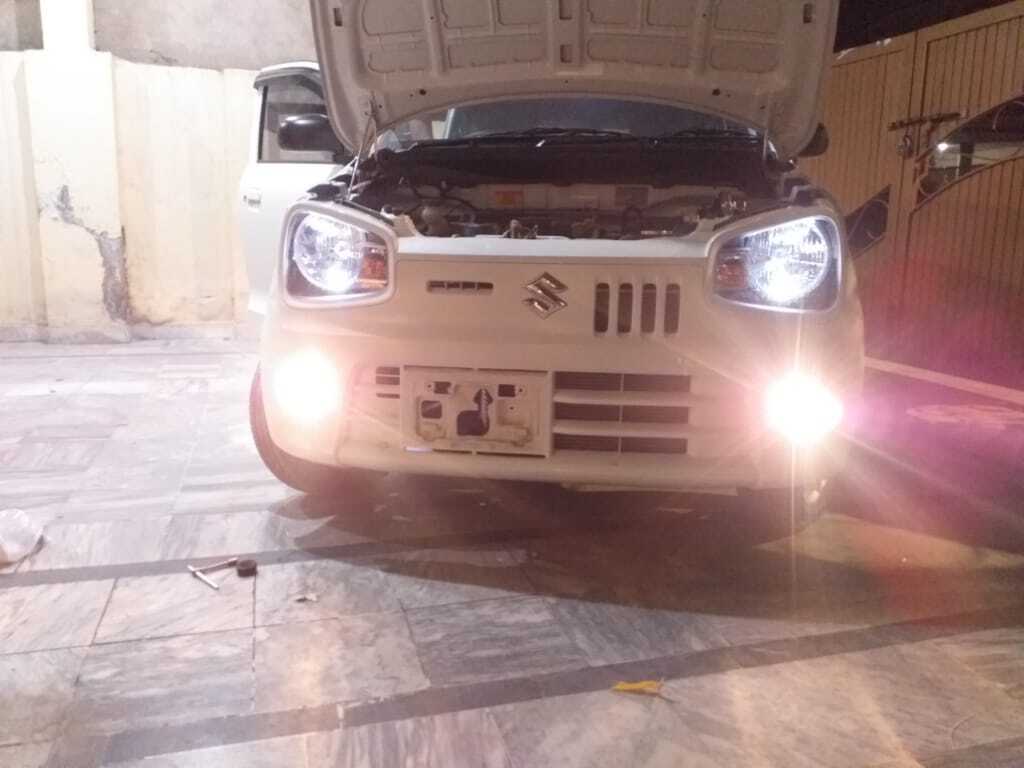

still there is slight adjustment that needs to be done other than that the lights are working perfectly fine
and dil pe pathar rakh k bumper kata was thinking k if i fail then i will simply install the lights and wont use themβ

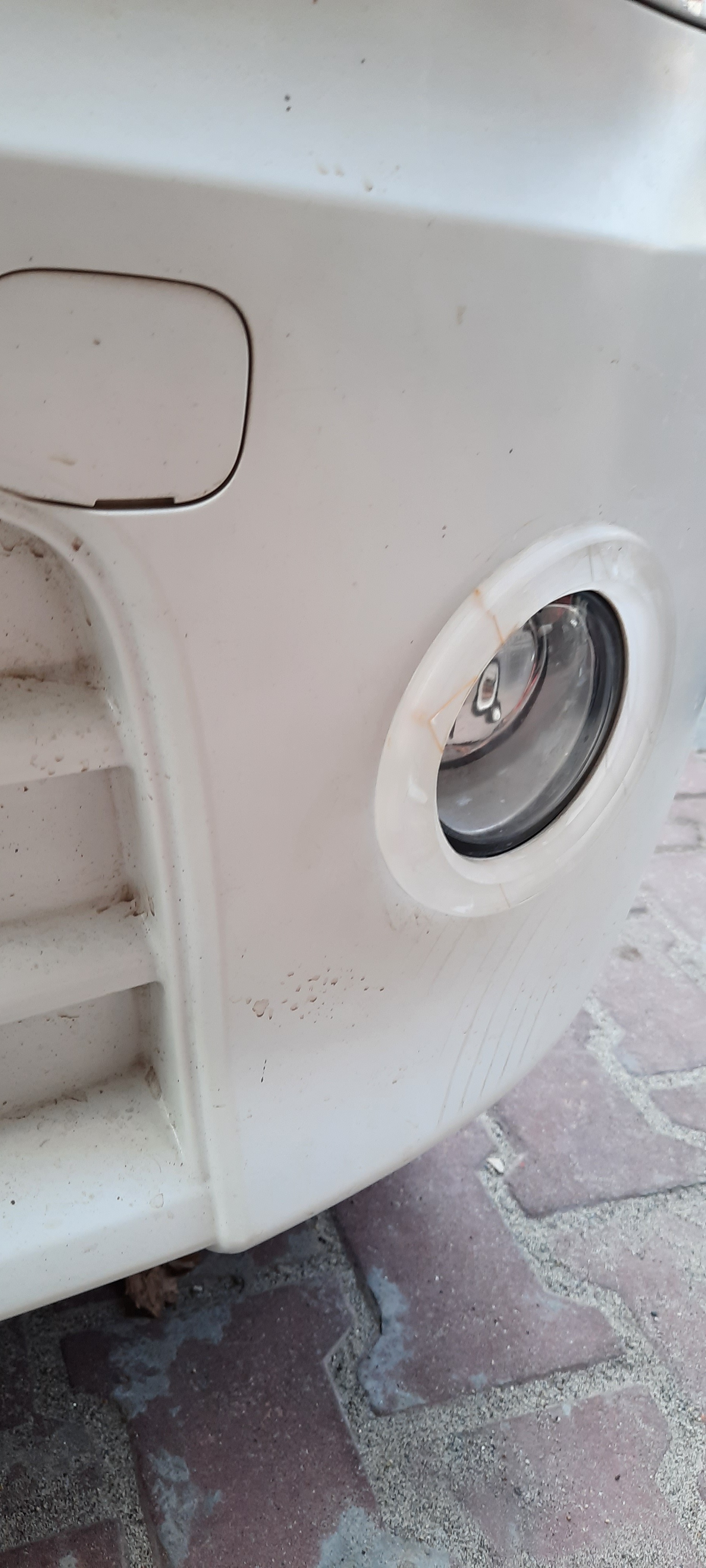

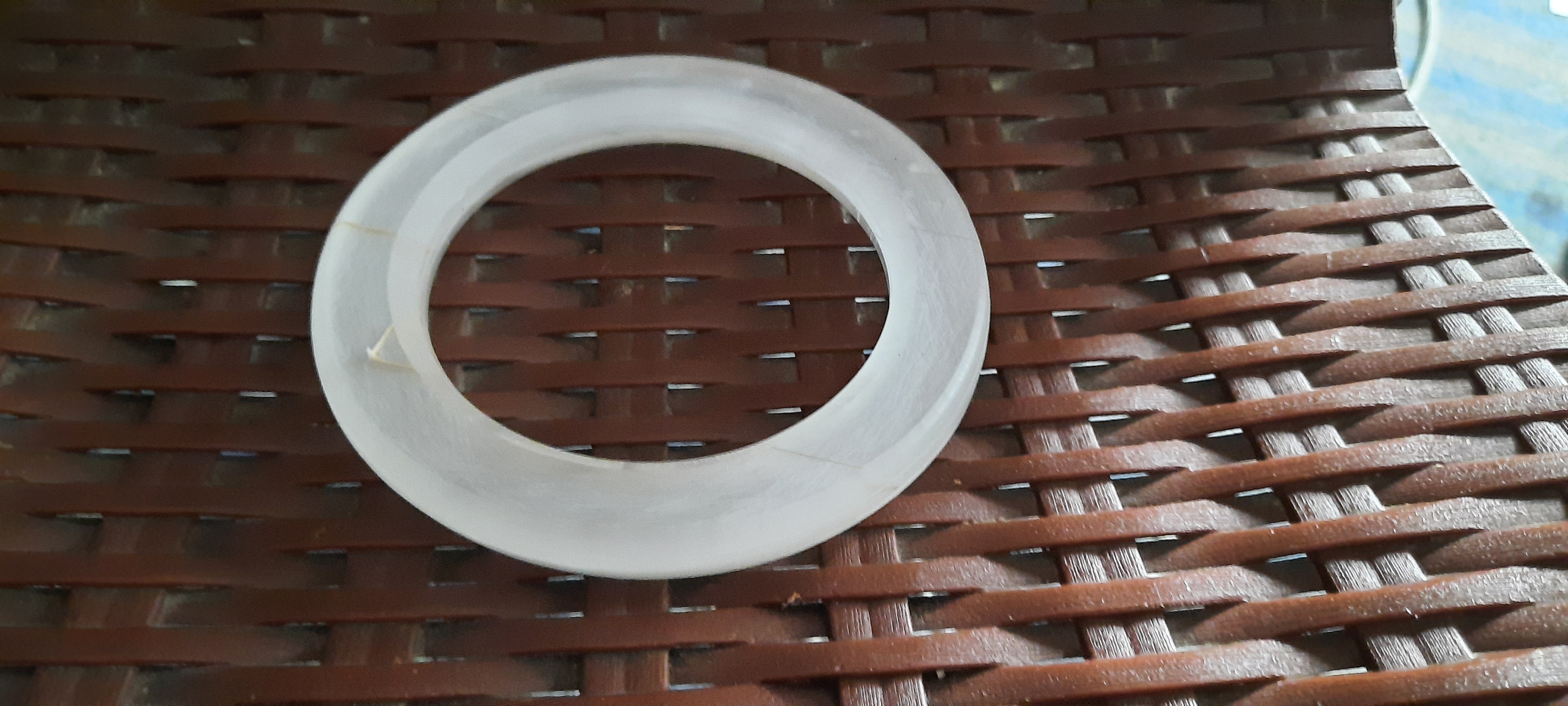

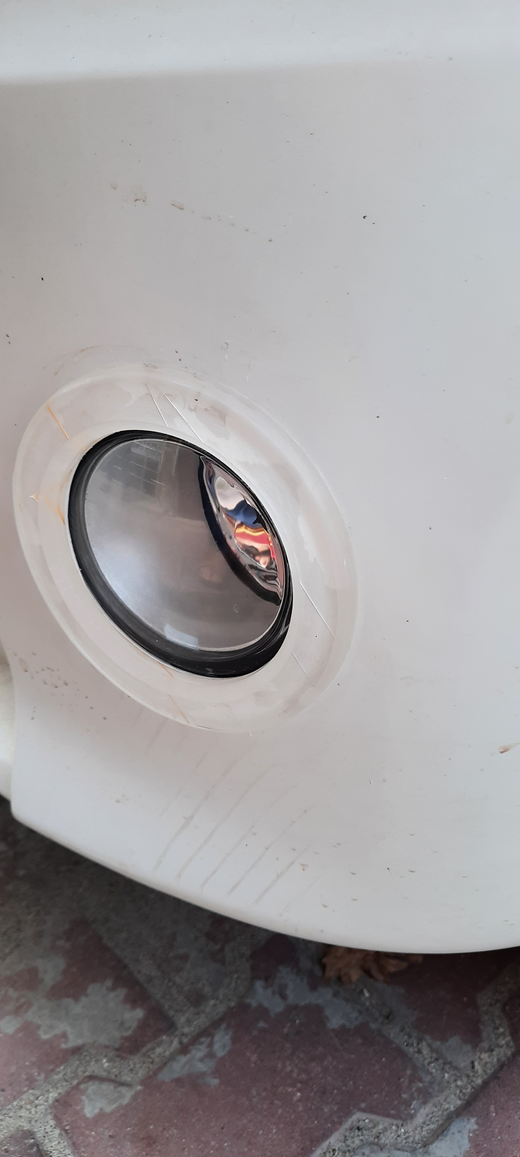

got the bezels , made thm from 8mm acrylic used a router to smooth out edges will post pics of them now thinking about their installation should i use screws some epoxy or super glue ??
will post new pictures after the bezels get painted will wash and wax before posting the pics π»π»π» so this thread is finally come to its end , and this crazy idea started when a brother posted a picture and inquired so here are the results and yes you can install fog lamps in pkdm alto with little bit of patience and technical knowledge π€π€ peace .

cost break down 3500 fog lamp kit with wiring and button3000 for fog lamp brackets including acrylic bezels500 for the hole saw kit i had to purchase it seperate200 for hardware, super glue and some baking soda no labour as i did all the work my self at home so it cost me around 7000 rs +- 1000 .

Thankyou , cant get enough time the bumper is still not painted hope will get it painted this month IA then post the final results also have order some h11 led bulbs so will post night results and light angle aswell .
