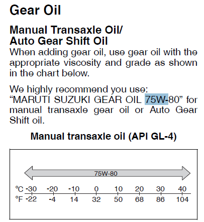

Dear as manual suggested use below mentioned grade oil Suzuki genuine Oil (SGO). Change the oil completely and see if issue still persist or not.Moreover I am surprised to know that Szuki is suggesting Zic Oil . Change the dealership if possible and diagnose the issue before transmission breakdown or engine has to bear wear and tear at higher rates.

change to fully synthetic gear oil 75w-80.
u can get kixx and zic fully synthetic gear oil with the above mentioned temperature range.
Please use GL 5 grade gear oil
