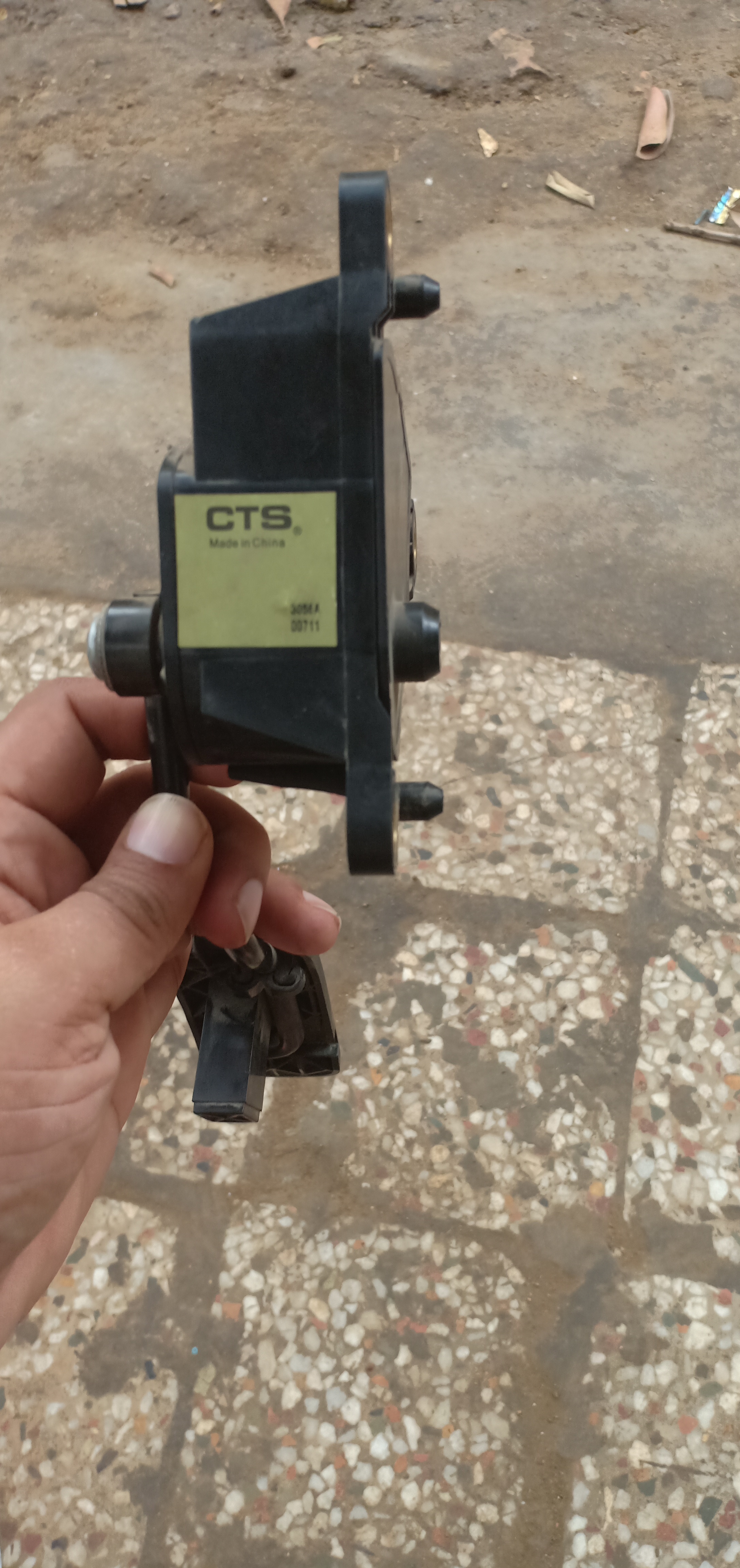

My Nissan AD 2007 starting acting little funny. The accelerator would not be smoothly working in speeds below 60Km/hr.
One day I was driving along and suddenly engine check light came on and accelerator stopped responding, but the car was running in idle. I turned off the engine and restarted and car worked fine after that.
Next day I got the car scanned and it showed the P2138 code for APP (Accelerator Pedal Position) sensor. The fault was reset and it didn't show in second scan. But still car not running smoothly under 60km/hr.
As I drive on long route, I try to keep my car in best possible condition to avoid being stranded on road where parts/mechanics are not available. Any idea where in Karachi can this issue be corrected? From the web search it seems I should get the APP sensor replaced as it is now acting up.
