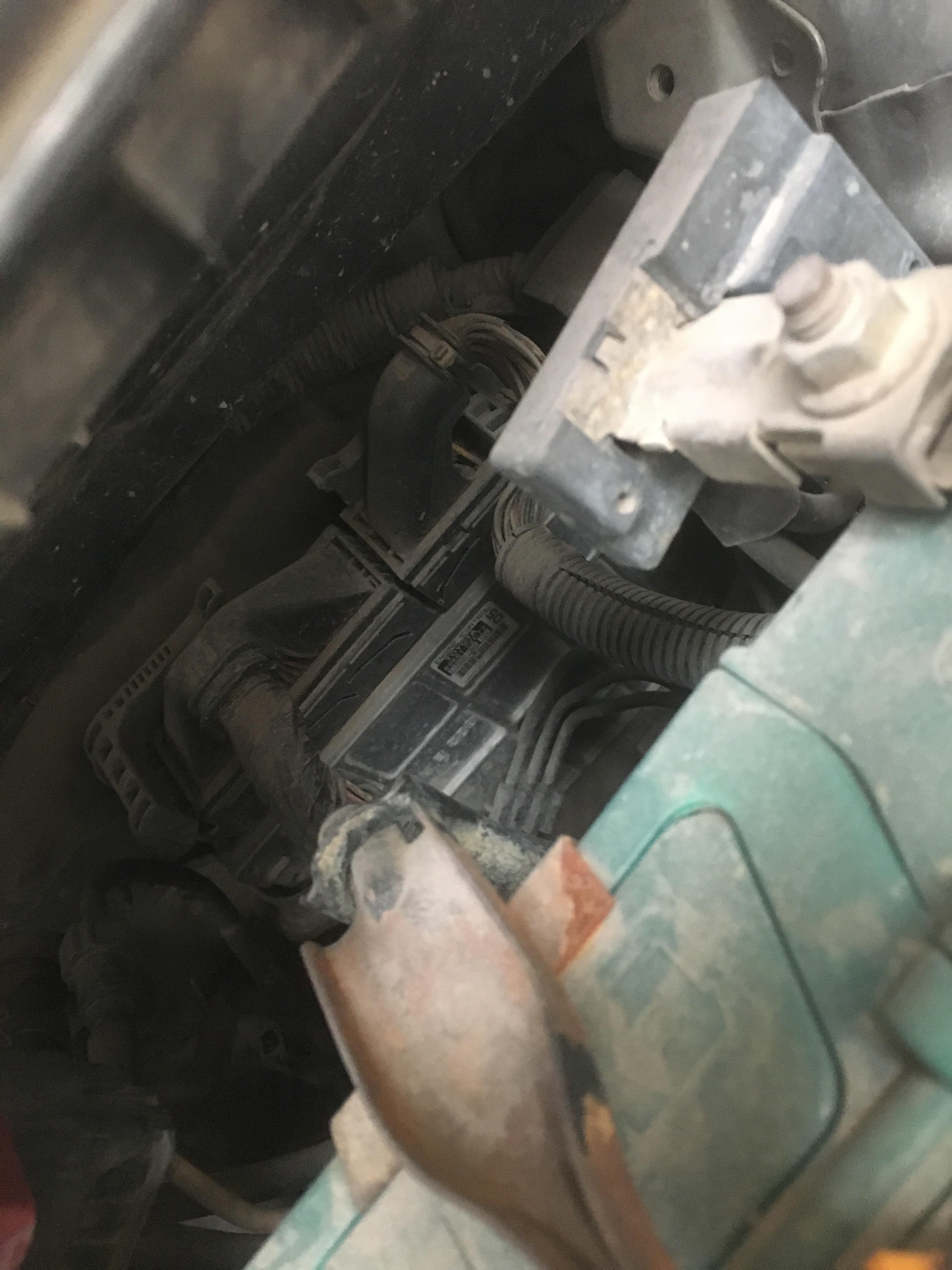

Gii bhai there is a seperate relay and fuse in for ecu. But those relays remain off until ignition switch is open. And there's also a memory wire in ecu which is directly connected to battery. Usually efi cars batteru drain due to that if they remain standing for long. Try removing the terminal when you leave you car at night.
Ecu itni jaldi kharab nae hota and for what he's asking 6k?
