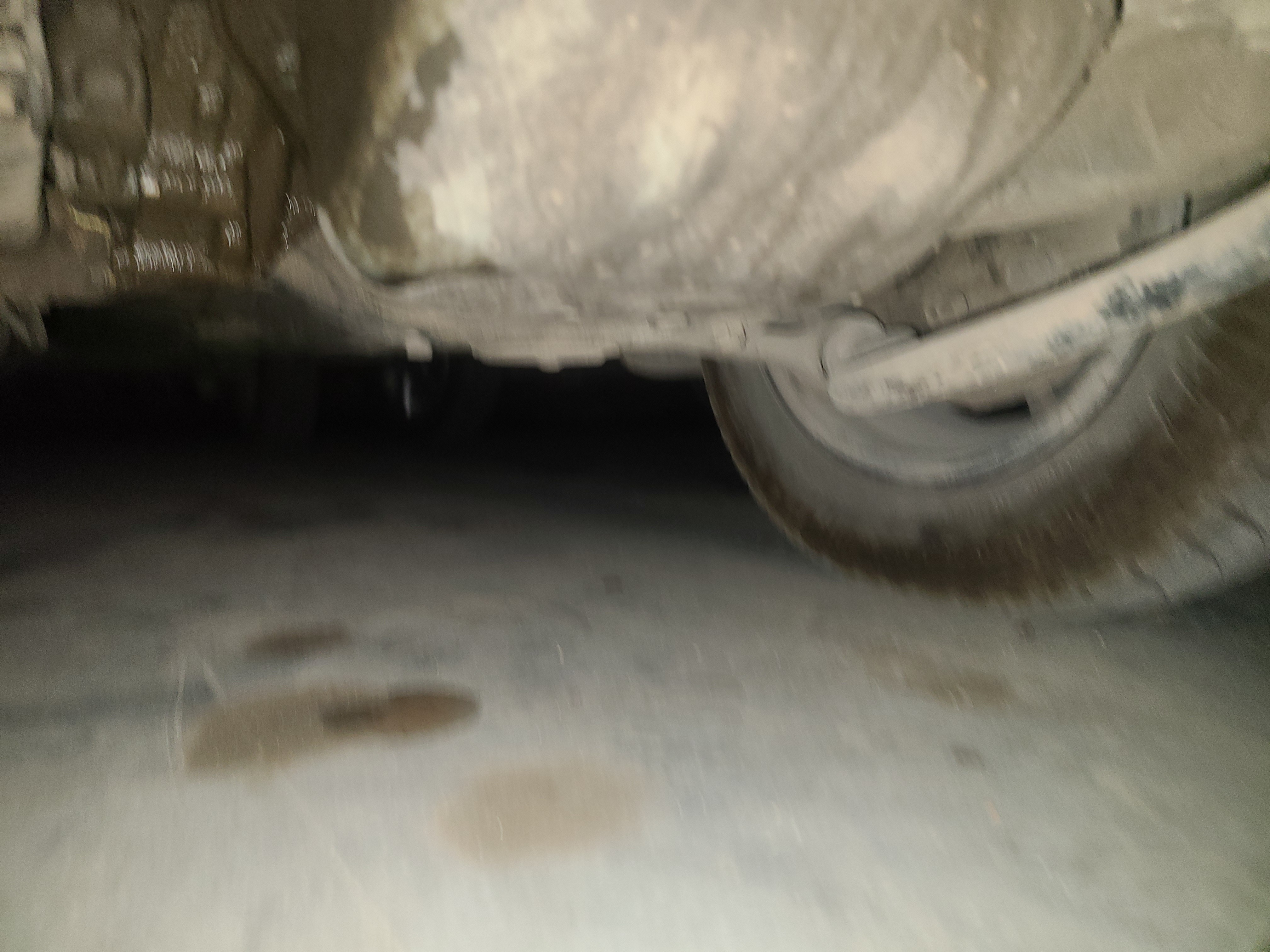

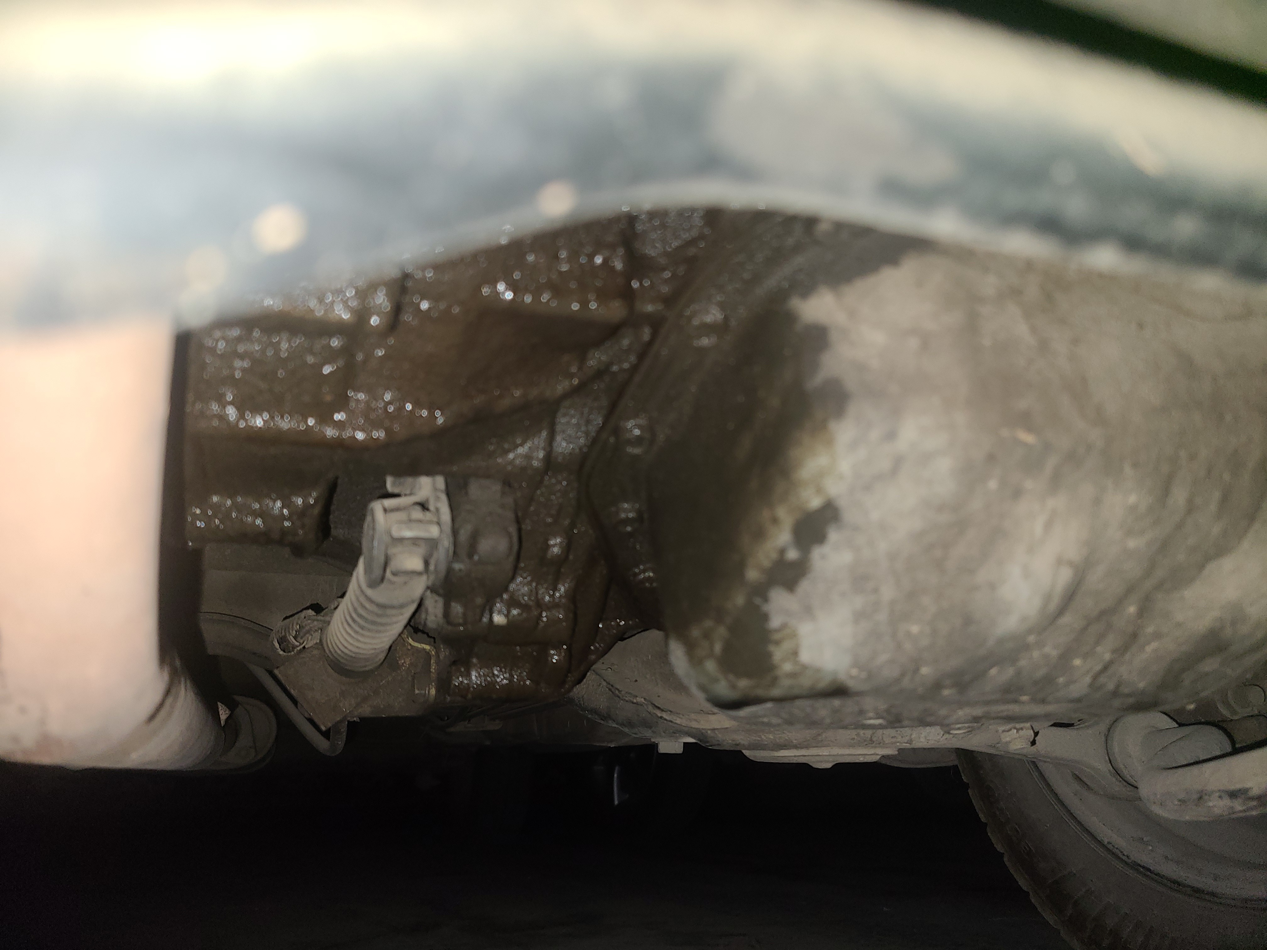

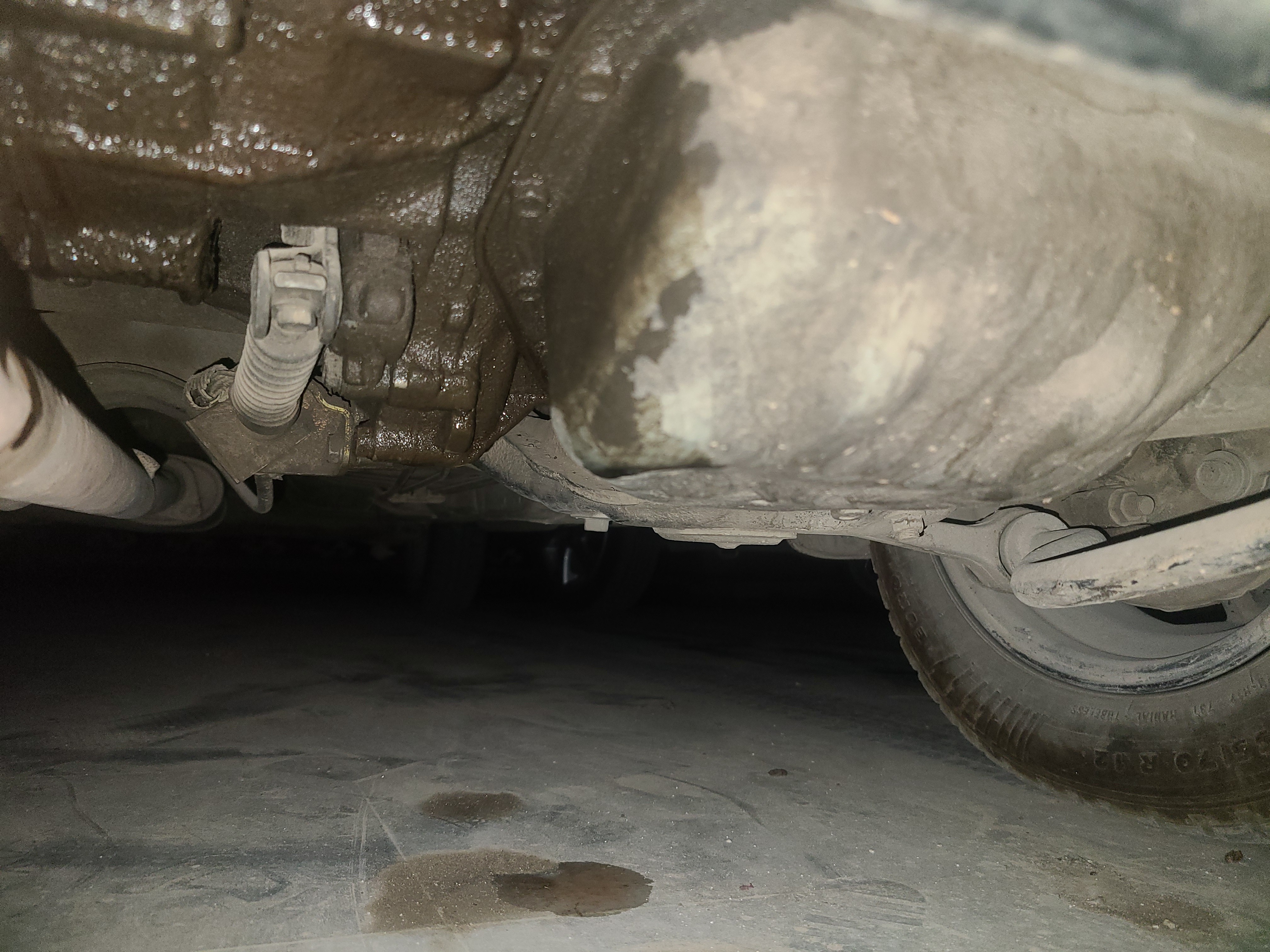

Hi everyone. There is some leakage beneath my cuore 200 model..the leakage is under left side (not drivind side) when parked. Can some one tell me is it gear oil leakage or something else.
Seems like gear oil. Gear box seals need to be checked
the severe dampness seems engine oil from flywheel hub seal leakage. You shall visit a reliable workshop to resolve the issue carefully. Parts cost may not be high but labor charge will be significant if charged by hour. Buy Only Genuine NEW OEM part.
You are in Karachi right?
As @horticulturalist and @Moderator said, could be one of those...
Check engine oil level if ok then it is gear oil....
And while doing this work change all possible seals...
No in islamabad. Thanks
Thankyou.
Thankyou
Then visit, any of them @rajaatta @dani_kk @spectra
Engine main oil seal leakage
Thanks
But oil level is okay. I m continuously checking. How to replace it? Is it laborious
No need, here to help
Then get the transmission oil level inspected possibly it's the old oil And dirt accumulated over the years
yes it look gear oil leakage same problem of my coure how much it costs you to fix and what parts you have replaced?
