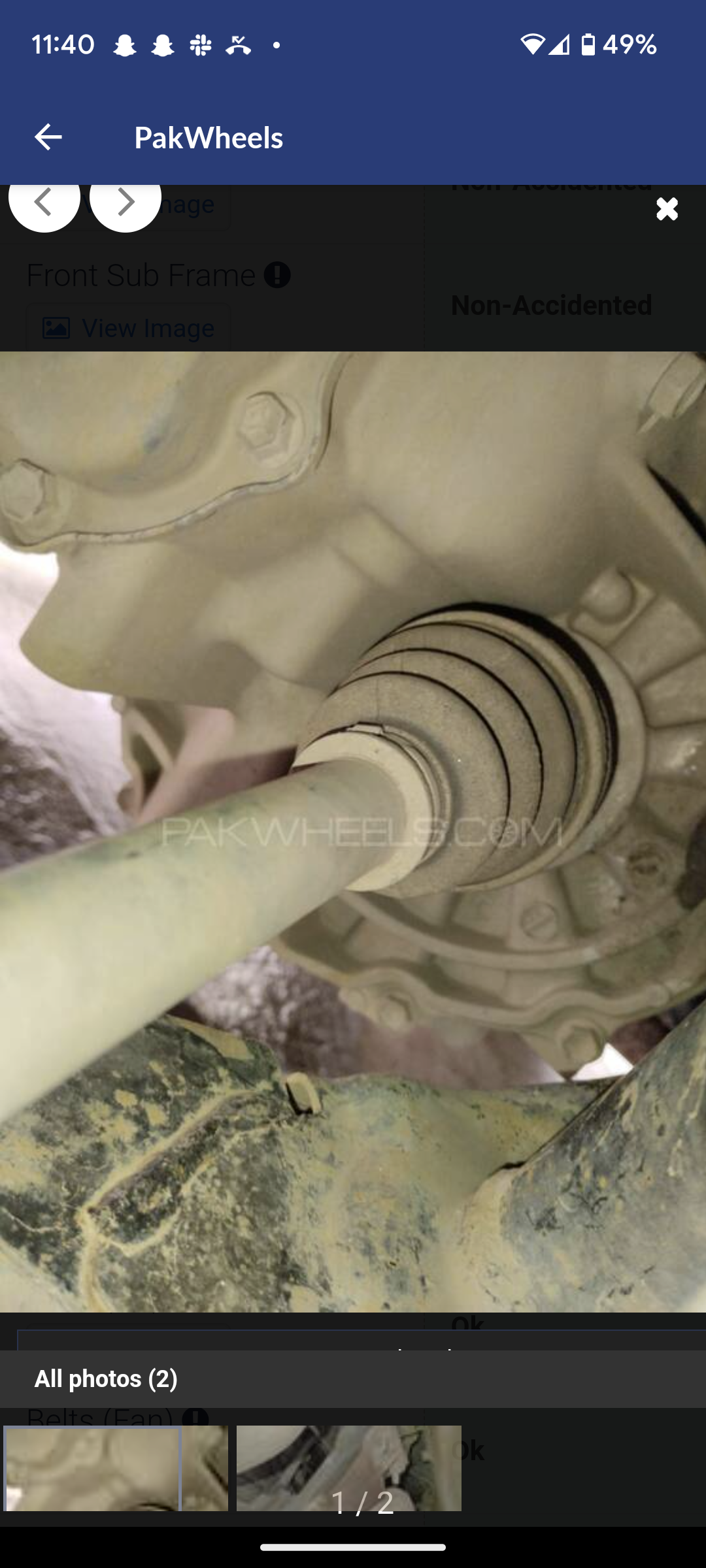

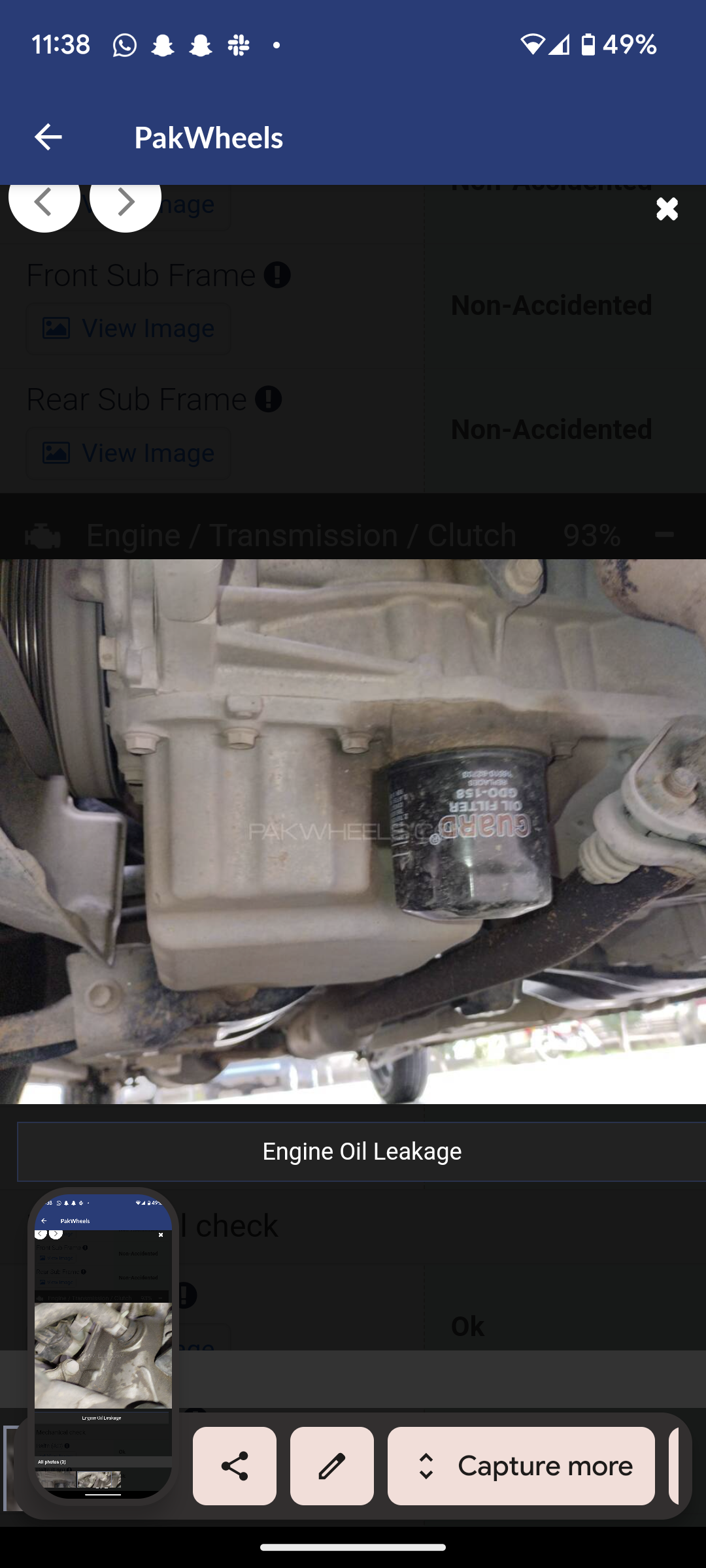

Got my 2016 Wagon R inspected and report says there's oil leakage. I don't see any visible oil leakge signs on the floor in my garage however I can see the seepage on the components. How big is the issue and what needs to be fixed here
discussed same thing with a pakwheel employee on seepage marked carhe said we dont have an option to mark residue hence have to mark seepage(only option available) seepage doesnt necessarily mean oil is in dripping state
Is this something to worry about? I have attached the images as well.
its in residue stateyou can either fix right nowor fix when actual seepage starts.up to you. nothing urgent
