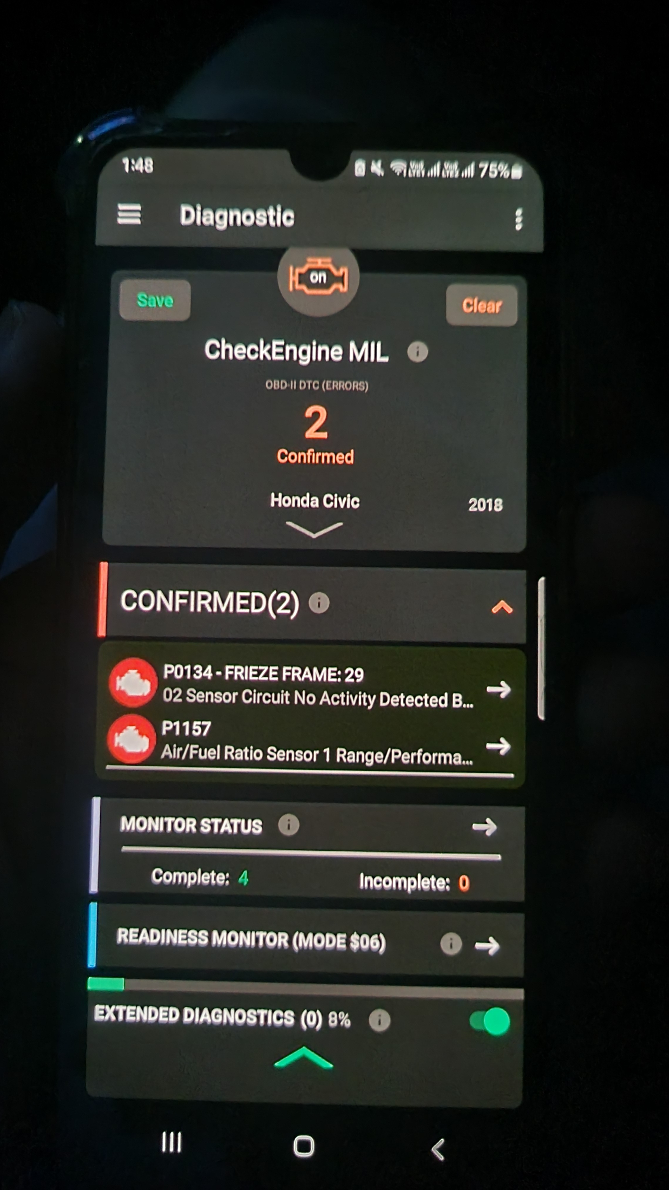

I need your valuable opinions and expertise regarding an ongoing issue with my Honda Civic 10th generation. For the past two years, I've been facing a problem with the oxygen sensor frequently malfunctioning, and unfortunately, changing the sensor hasn't improved the situation.

- There are persistent error codes related to the powertrain, suggesting a wiring issue.
- The air-fuel ratio sensor is also showing errors occasionally.

Now, I'm at a crossroads and need your advice. Should I proceed with the head gasket replacement as suggested, or do you think there might be other underlying problems that should be diagnosed first? One thing to consider is that I'm from a small city, and I'm hesitant to take the risk of opening up the engine without a clearer idea of what might be wrong.
