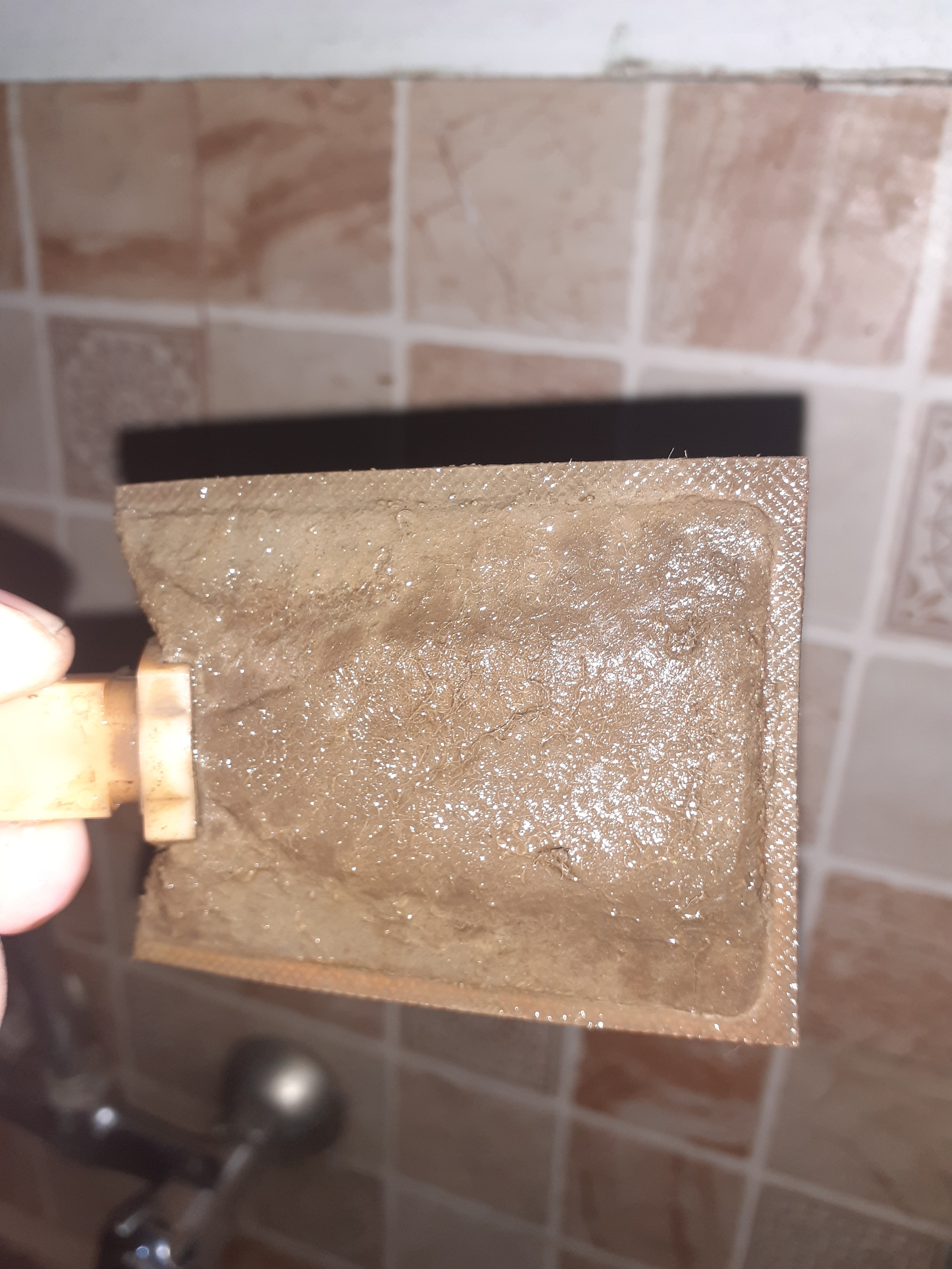

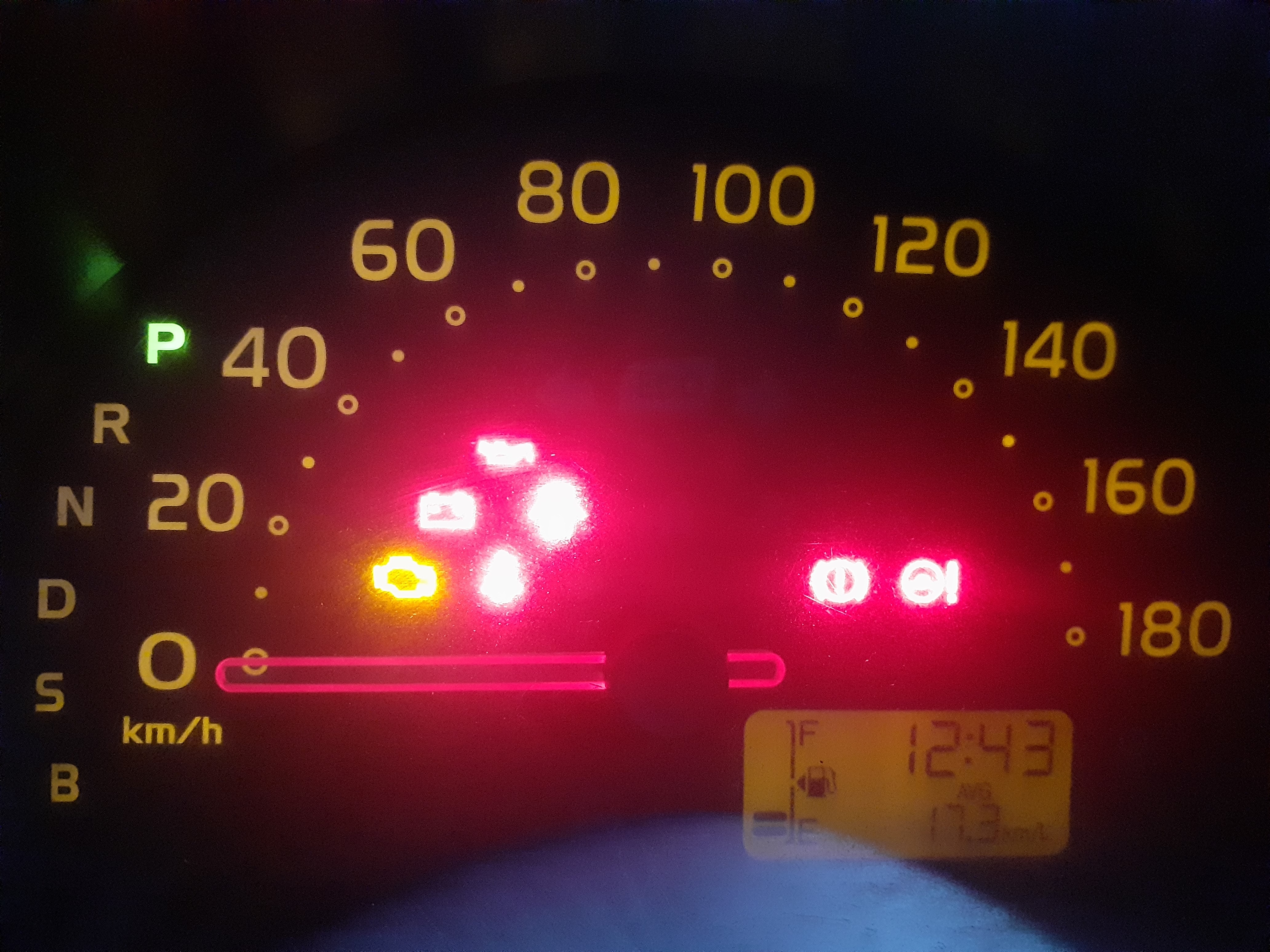

The fault was p0171 faulty oxygen sensor since from 3/4 month's. There for 2 oxygen sensor were replaced an the average of passo 2010 droped from 16.5 to 13. Pcv value change. Oil grade reduced from 10w 30 to 0w20. Air filter changed but the fault was in fule filter. Clogged fule filter changed with kabli and the fault removed. And now the average is 17.4 on gt road.

The problem was in fule filter full chocked replace with new one.
fuel filter can be sourced new, scrapyard item will bring back the issue after 4 - 5 tank usage.
You are right but new filter not available in my city (attock)

This is not the filter, its the prefilter, the actual fuel filter the big plastic cup around the fuel pump.
Brand new is about 20k from toyota
Yes and this prefilter comes with fuel pump instead.
Holy! for corolla 1.8 grande its 8k from partscentral for the fuel filter assembly.

101600 km driven 2010 model passo an oil grade changed from 10w30 to 00w20
