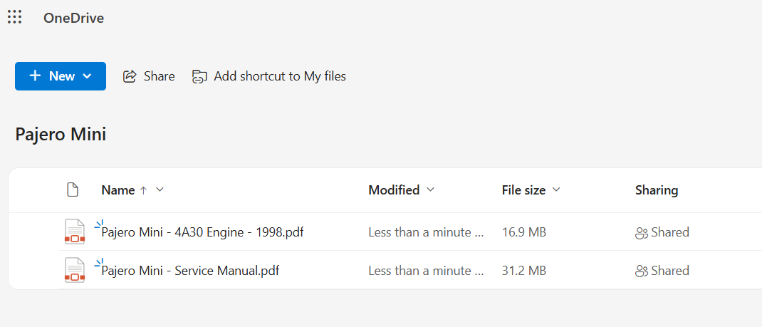

I am trying to find service manual and so far unable to find it. I found for Pajero IO but for Mini no luck
