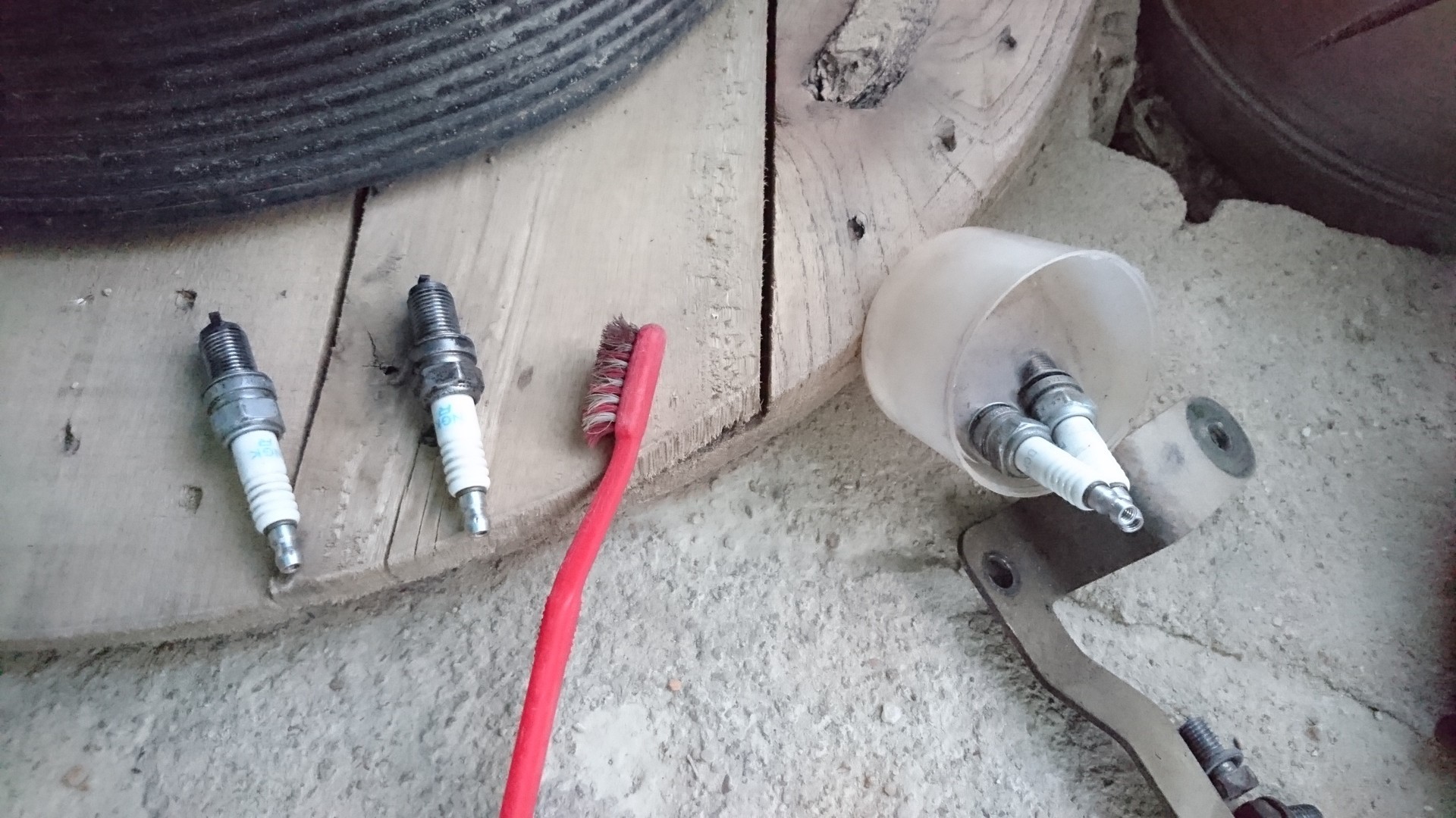

This is how spark plugs looked like when I took them out. This should be normal color / condition after 6+ months of driving. If there's black carbon on it, that means car is burning extra fuel.
This is after couple of plugs were serviced with acid wash and patrol. Also cleaned up coils and its wires.

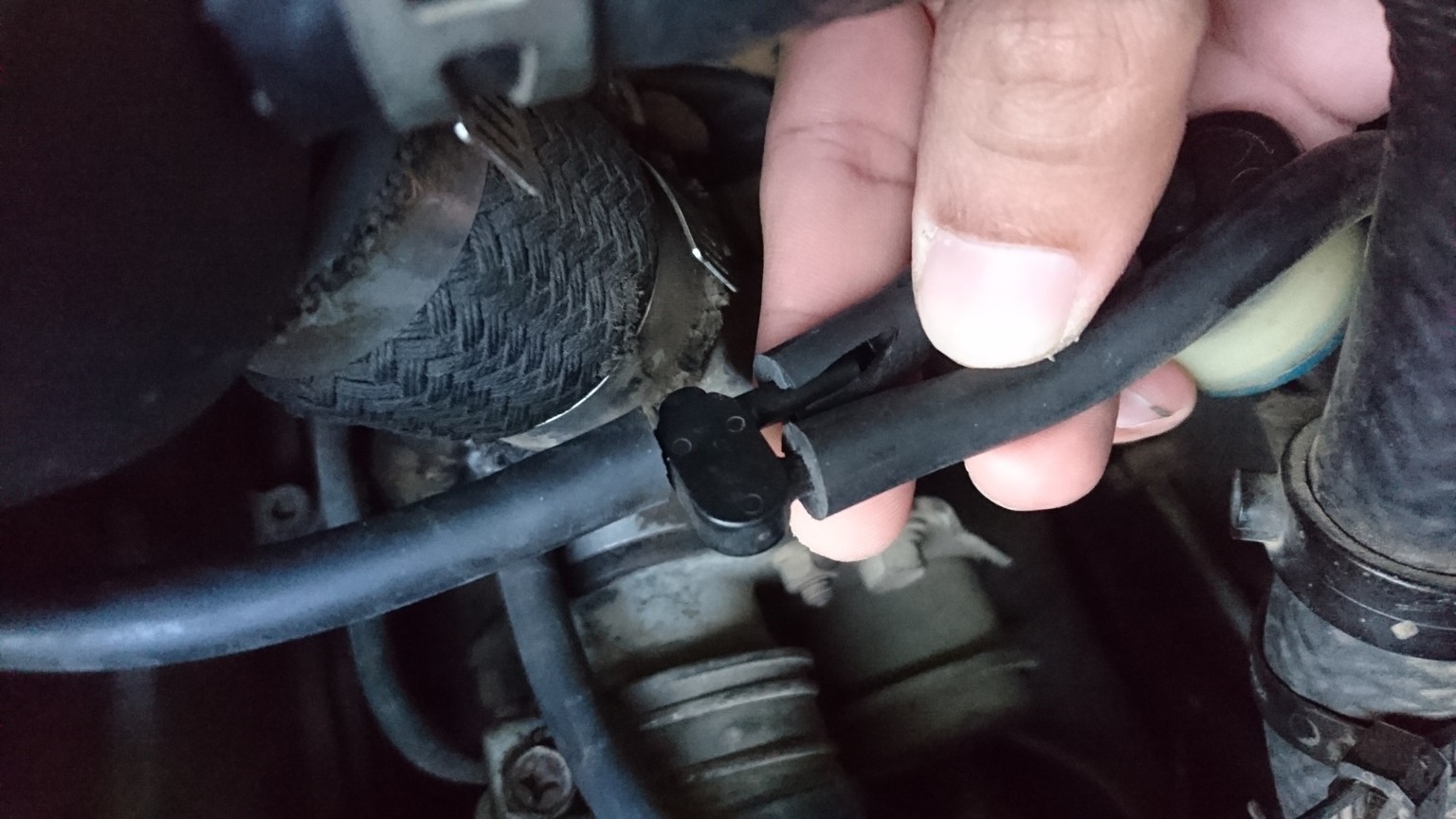

I tried to test turbo, which looked and sounded okay, then I started inspecting turbo vacuum pipes, and guess what? I found one little bugger had a small cut just at the spot it connects to one of the metal pipes. Also, these vacuum rubber pipes were loose on some attachments, just pulling a little bit, would take them out. Must be leaking pressure and making the turbo boost under-perform.

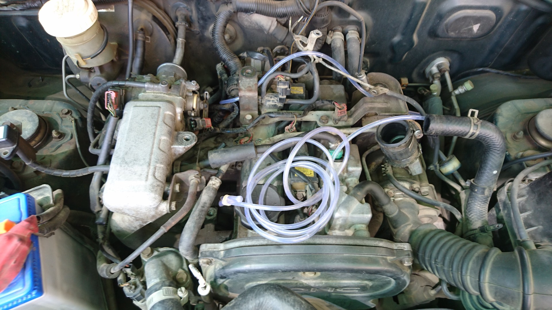

And this is after replacing all of them, it was pretty late, around 1am when I wrapped it up
Next day I took some more photos, this one shows how many total pipes were replaced, some were pretty loose and some were okay, but I replaced them all. Combined length of these pipes is around 11ft. 3 odd ones are, patrol pipe on injectors bus, PVC valve and water hose to turbo booster.
This is how that small vacuum leak crack looked in few of them
And day time photo, I've marked visible pipes so you get the idea where were these connected, there were some under intercooler too
So far haven't driven it after this 2nd service. I just did high RPM turbo exhaust gate open test, which is pretty solid. I see it opens at ~5k+ RPM and stays open, while previously it would do vibrate like motion, open close rapidly. Which makes it that was due to leaking of pressure from vacuum pipes.
