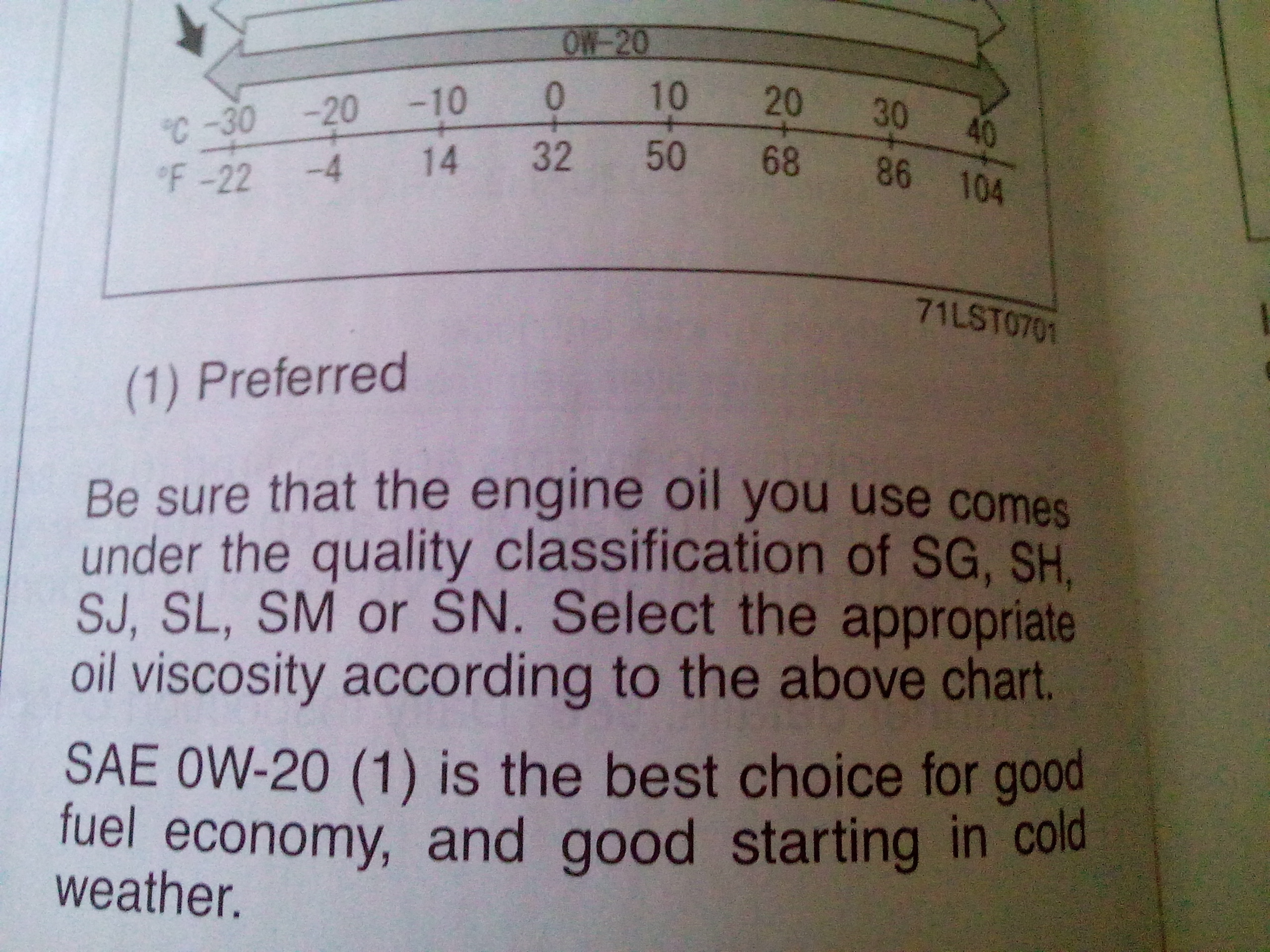

BTW, I have already posted the manual for Wagon R above and it said the 0w20 was the oil for Waggy and hence I raised the question to which oil to use as PS was recommending 10W40. But I was in doubt because that manual was for Maruati Suzuki, so may be I thought the difference was there because of the country. But as you have posted the manual from PS, I ought to accept it.
Anyhow, the question still remains:
My waggy as 70000km on ODO, so still I use 0w20? What about ling drives on motorways and hot temperatures in Pakistan?
