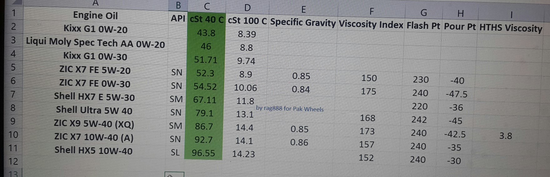

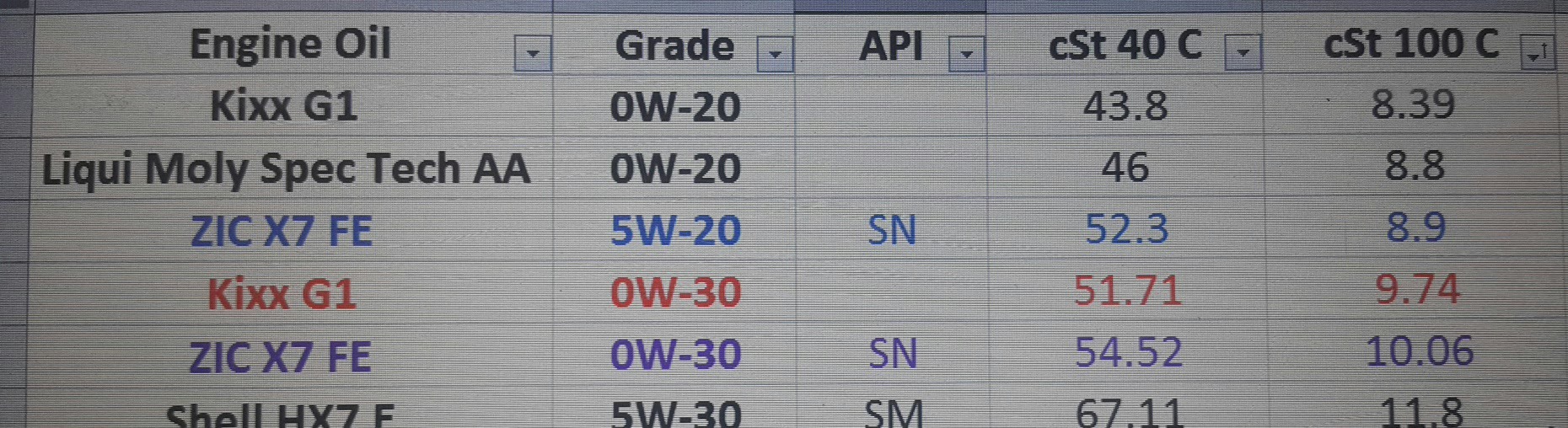

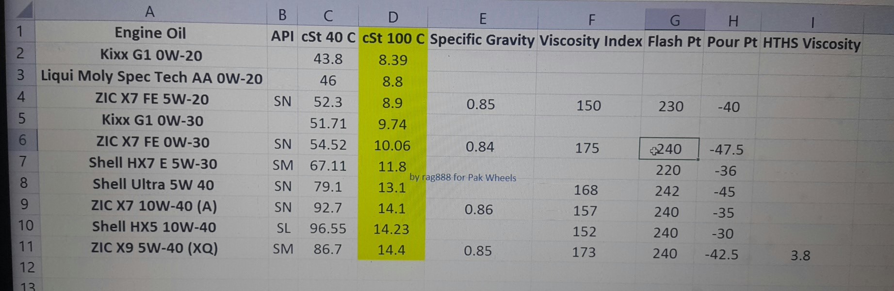

You took the right decision but again don't go for 5W also. Let's technically look why 0W is better than 5W or 10W.
Kixx 0W-20 viscosity at 40deg is 43.8 compared to ZIC 5W-20 is 52.3. Clearly 0W is better for cold start because it's thin when cold.
Now comparing 100deg viscosity. 0W's viscosity is 8.39 and 5W's is 8.9. This is just 0.51 difference which is absolutely ignore-able. So you can say that 0W is better for cold start and when engine is hot, both oils have almost same viscosity. So always choose 0W oil.
