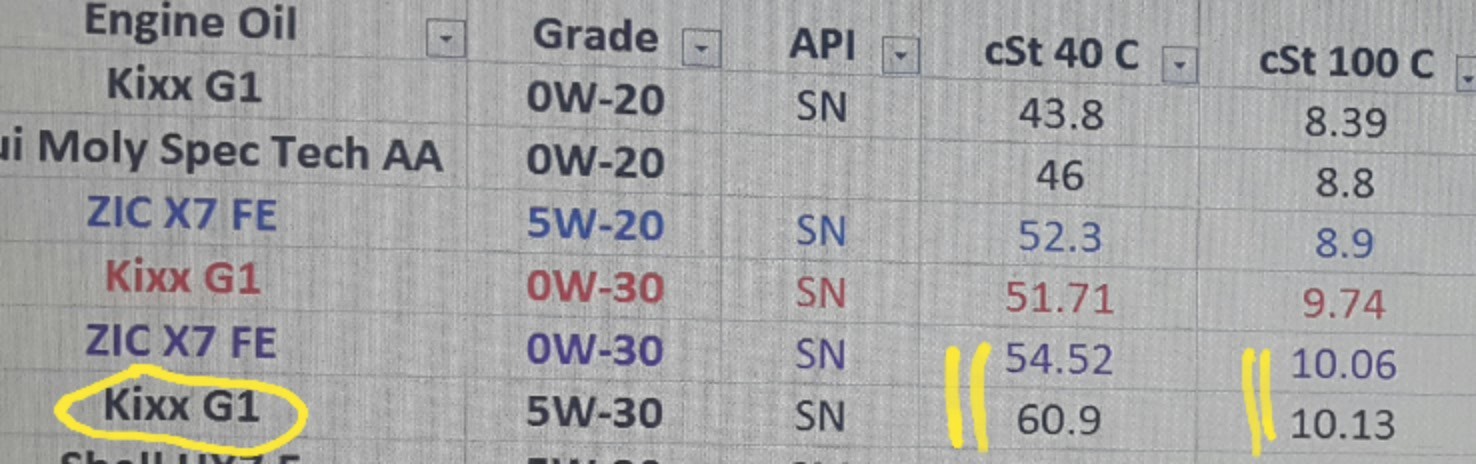

So I think I would be sticking with Kixx 5W30 for now. Primarily because it's available in 3L packing (dont want to buy something in 4L - no utility of leftover oil). Second, as my Waggy is already having 70000km on the ODO, don't want to use 0W20. I could have gone with 0W30, but none is available in 3L packing. Also, difference in viscoty between Kixx 0W30, Zic 0W30 and Kixx 5W30 can be seen below.
As seen above, not much difference between Zic's 0W30 and Kixx's 5W30, so going for Kixx 5W30.
What do u say?
