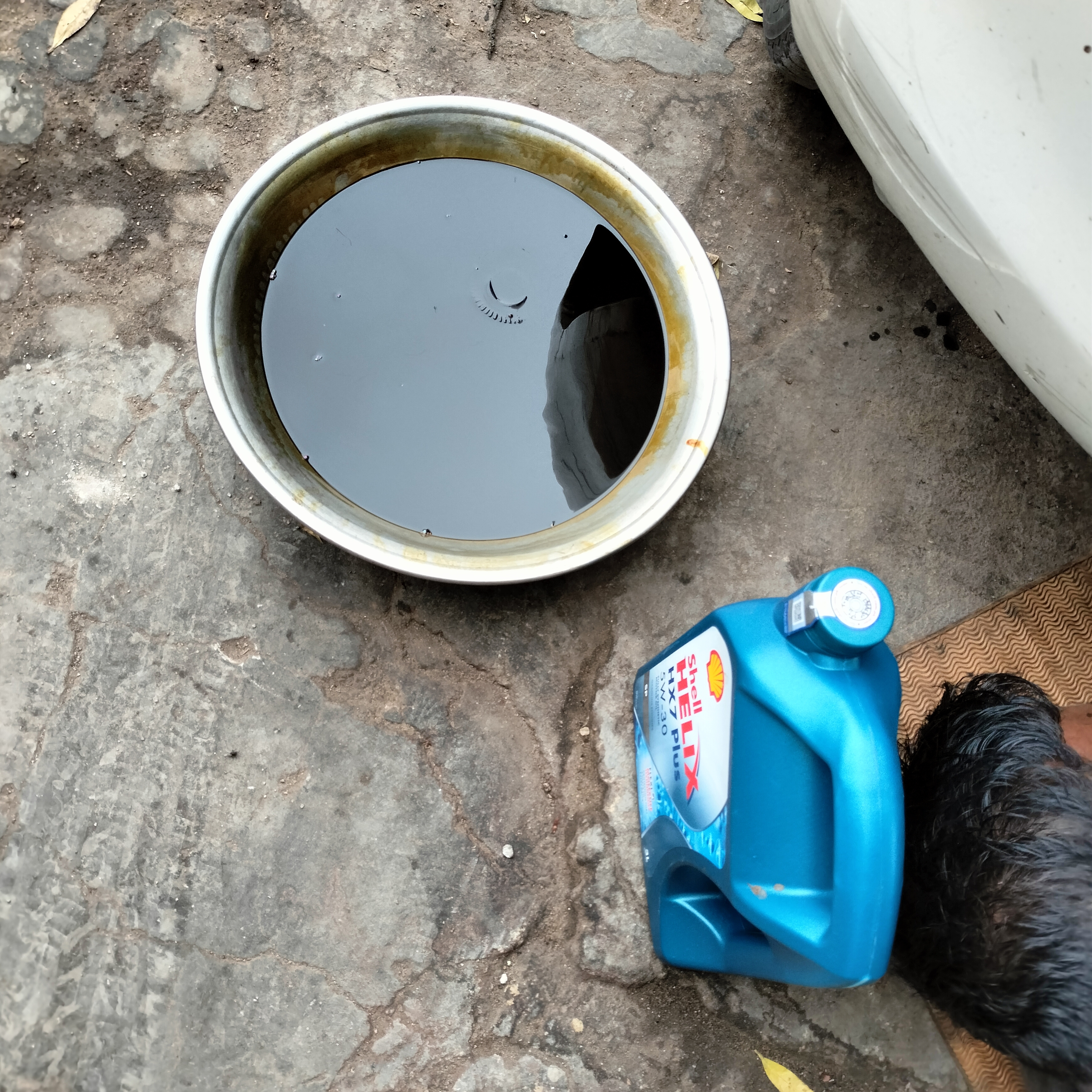

Today it has been 2 yrs since i changed the rings and piston of my passo 2012 bc it was consuming oil, every thing is fine till now no oil reduction till today using shell x7 5w30 fully synthetic oil Jameel autos highly recommend, irshad bhai is gem person
