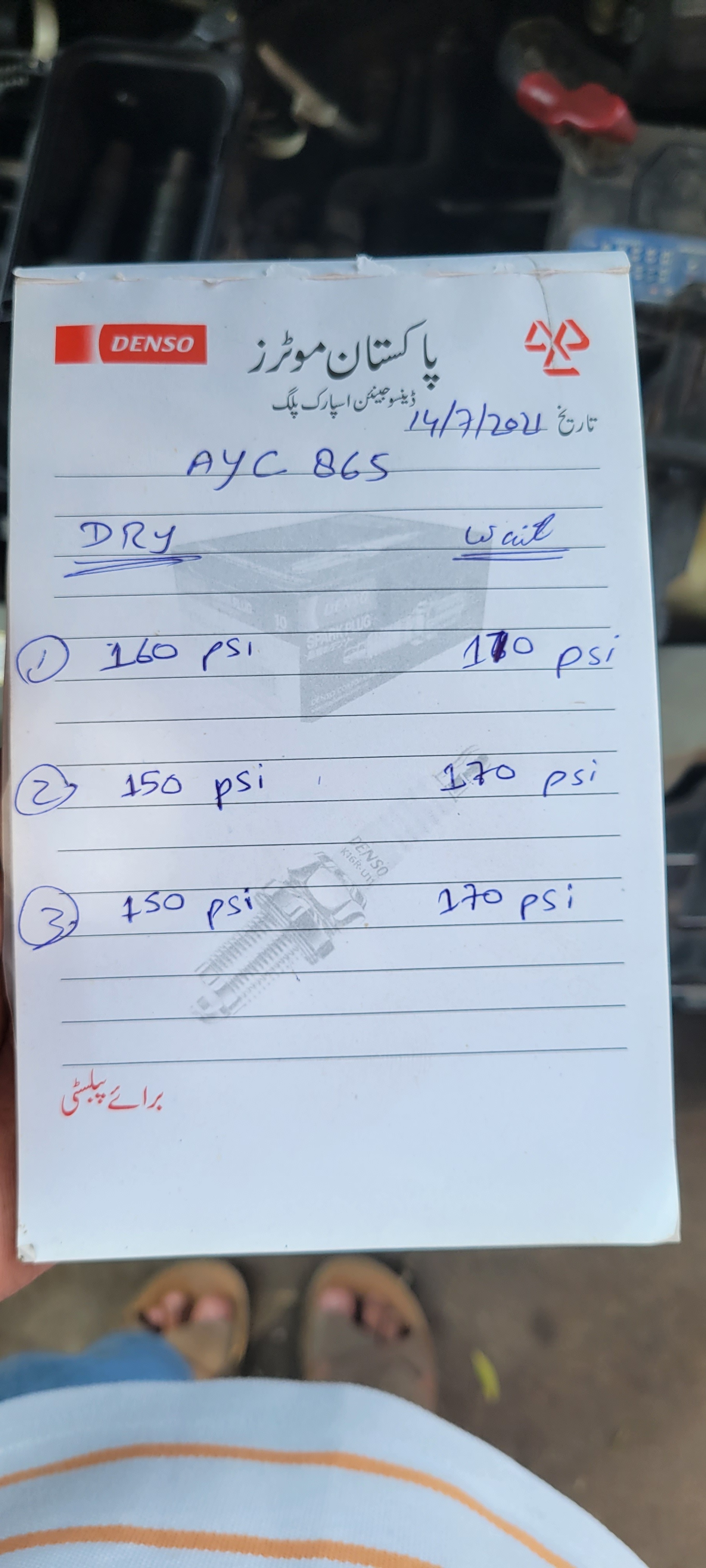

without doing a compression test, overhauling an engine because USTAAD said so is very unwise. Being a PW for 6 years you have high edge over any ustaad, you can read write and discuss your problem here.
i assume thermostat valve is also missing from cooling system.
vibration could be from multiple reasons. bad ignition coils, bad tappets, faulty throttle body.
