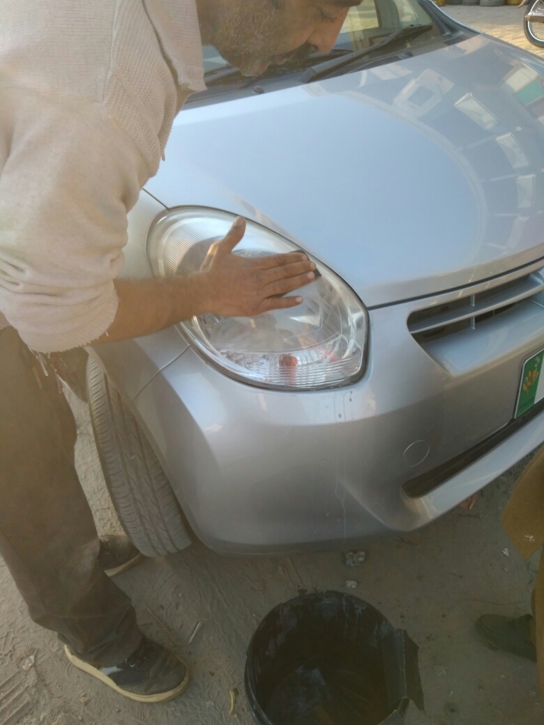

took the car to 2 different bumper/headlight guys.Both said they have to take the headlights out of the car to work on them. i had very bad experience with one of my cars, i dont let anyone touch factory settings of my cars headlights after that.

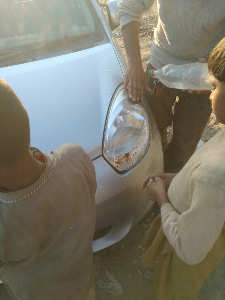

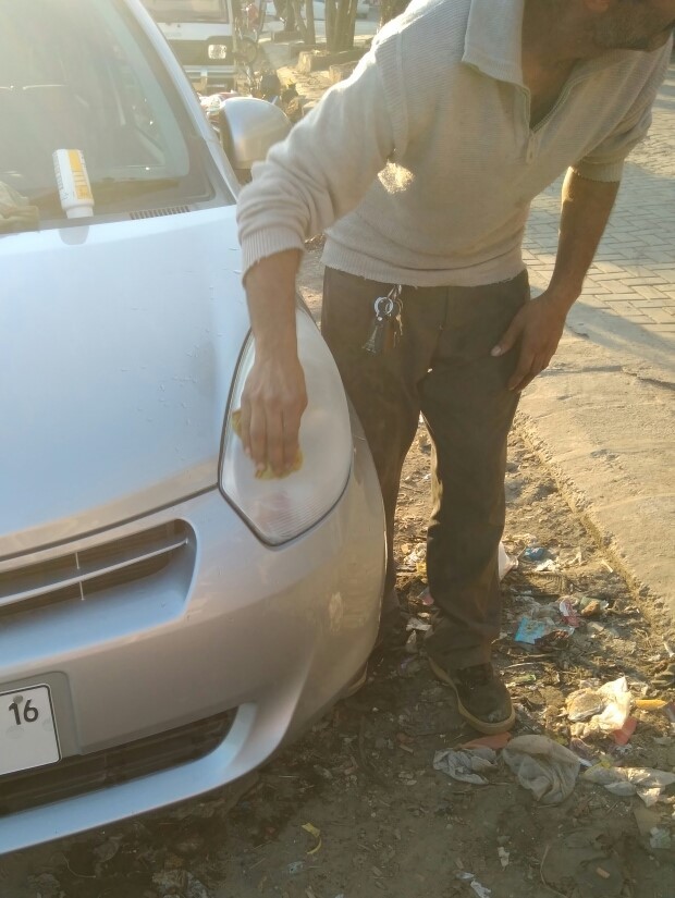

anyways finally found a guy who said he will fix without taking the headlights out
sand paper with water used
imported cutting cream(silicone based)

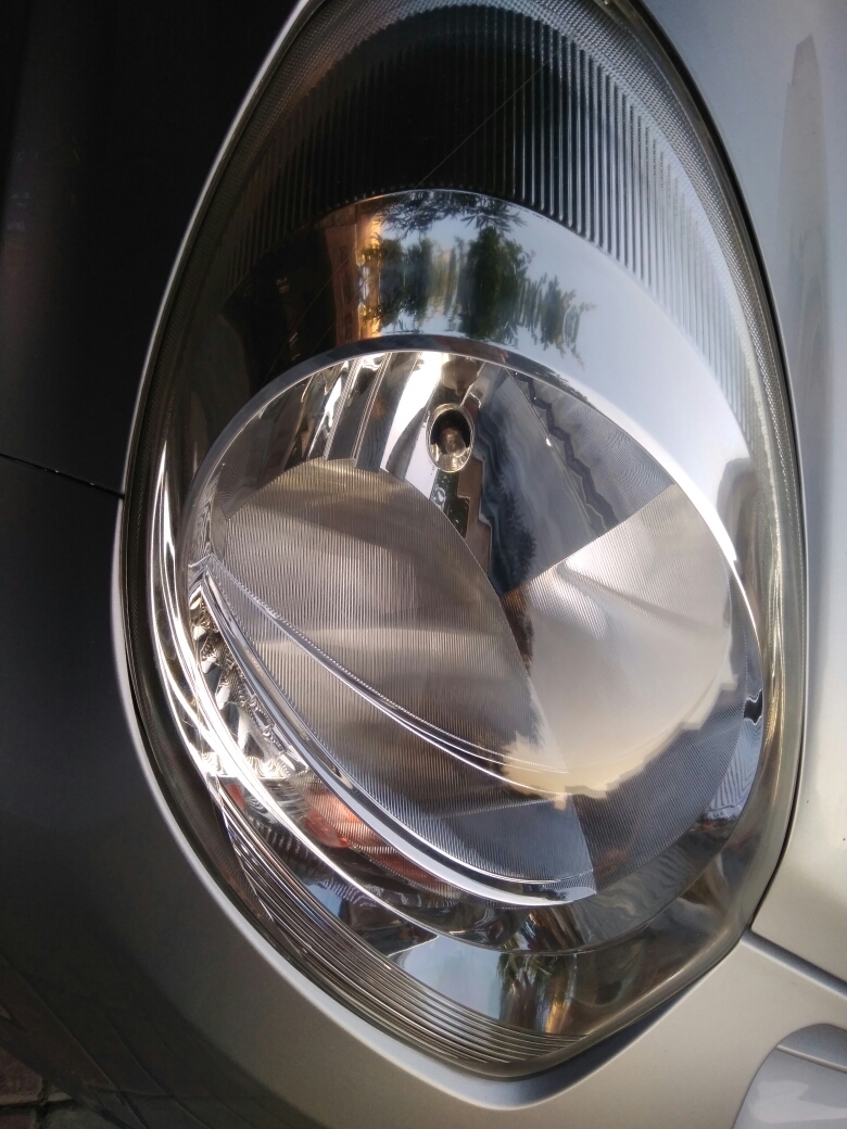

results are infront of you guys
cost 500
