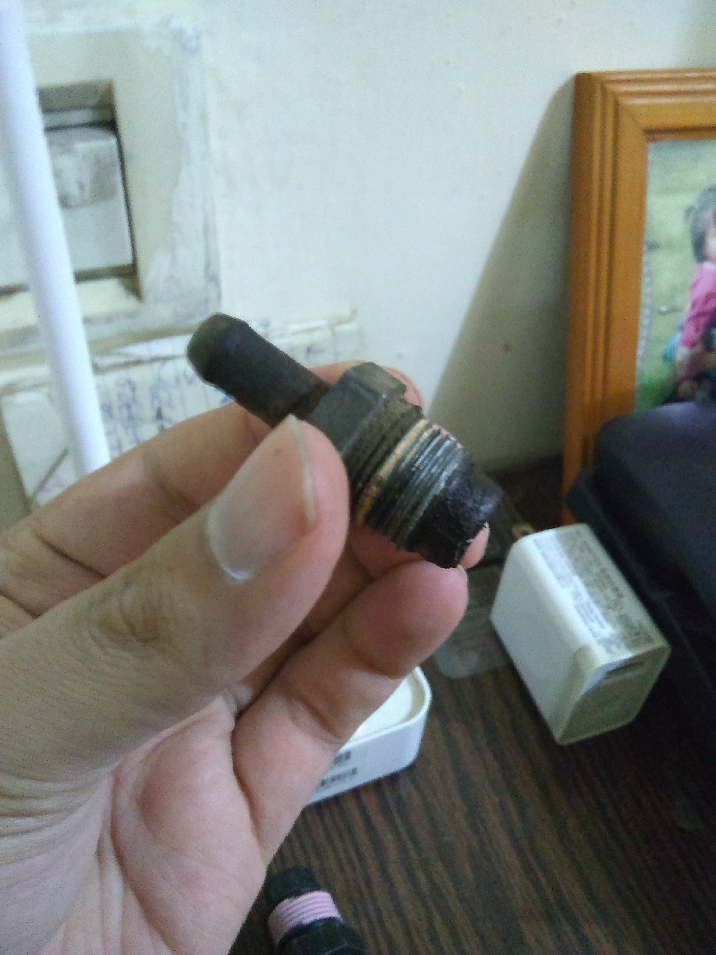

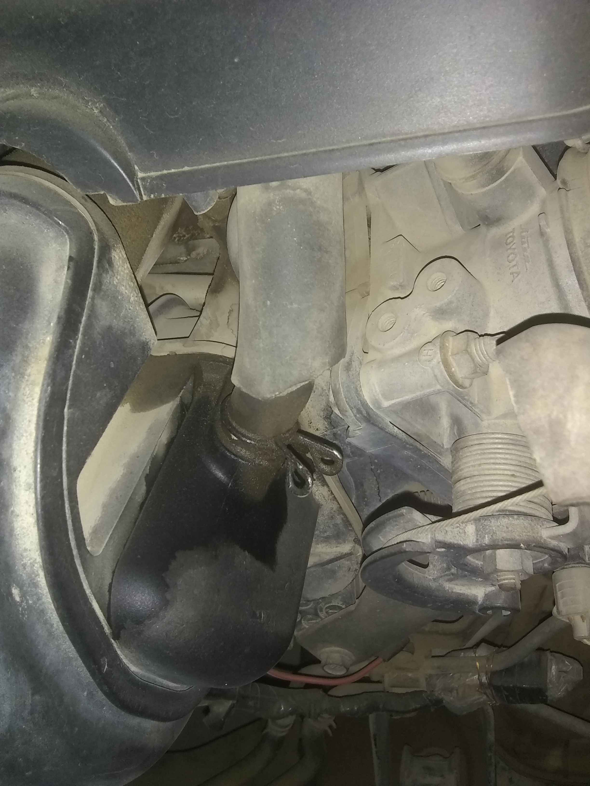

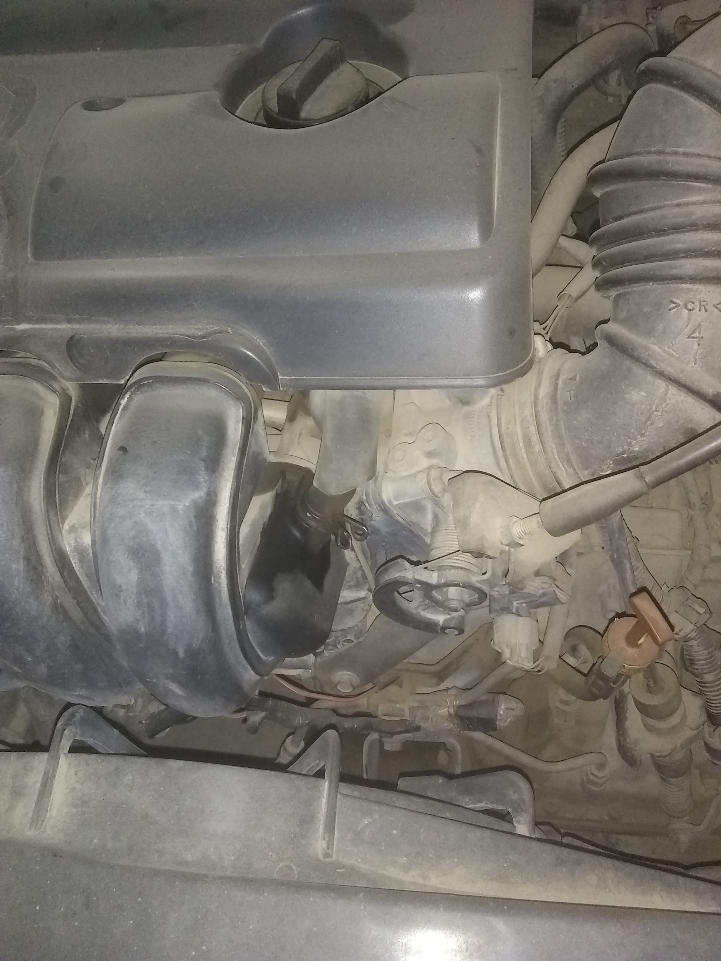

I noticed some oil build up around vaccum hose coming from PCV valve
You didn't change pcv with a new one?
Unplug your pvc valve and se if rattling noice is coming when you shake it.if not then change it with new one because its not much expensive.and if rattling noice coming from it so clan it with carb cleaner and give it some time to dry and then plug it again. @mohsin-212

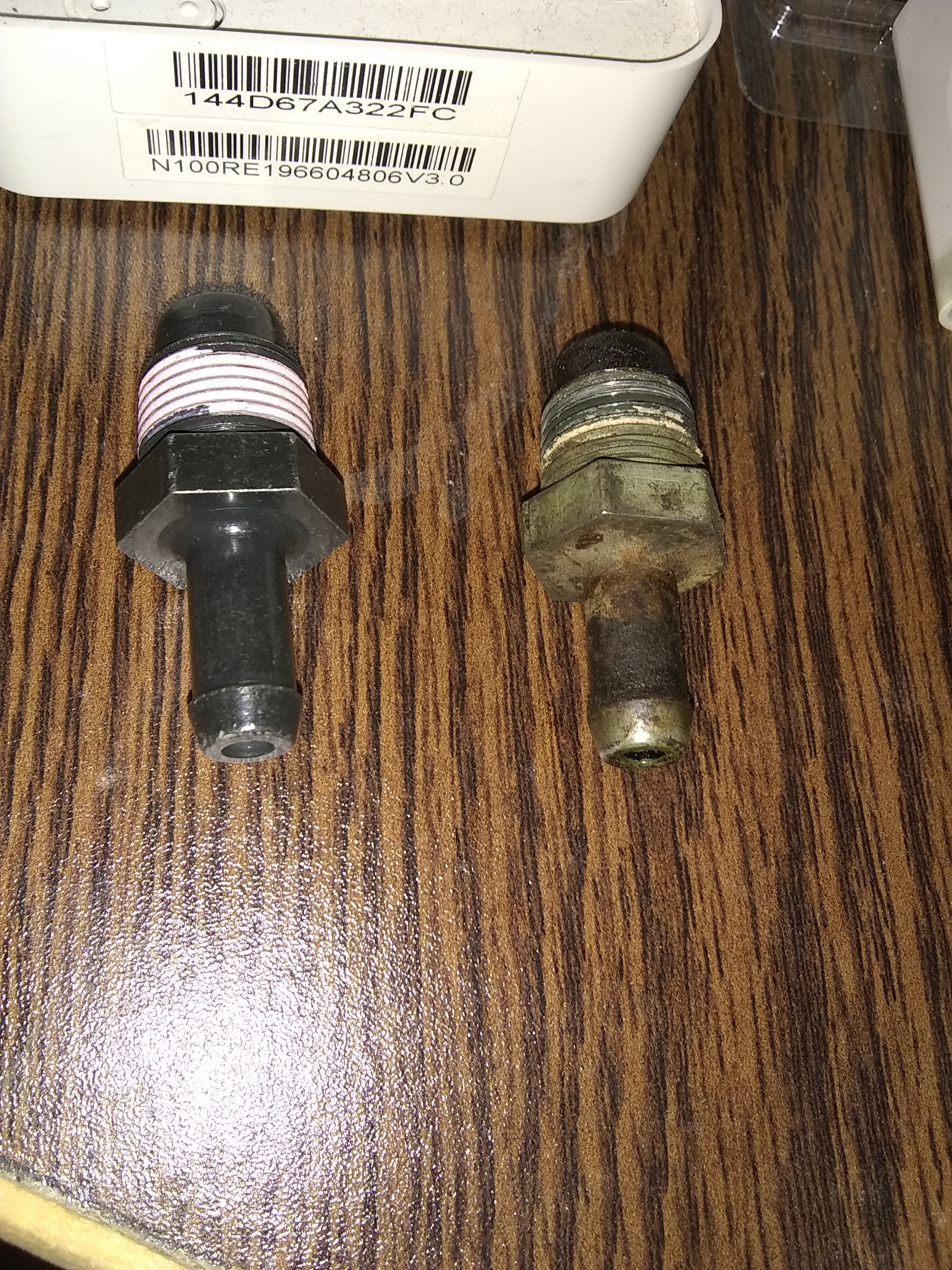

@haseeb.basharat Sir pcv for Toyota A series engine can work with Z series engine or Z with A series? Because it's purpose is the same. So what's your thoughts on this. If I can't get new one for my 4afe can I use a new pcv of 3zz, 1nz, 1zz if it's the same size?

i think some suzuki ones will also fit, get a picture of your pcv
You can buy it from a suzuki parts shop, i believe efi cultus one will fit.
