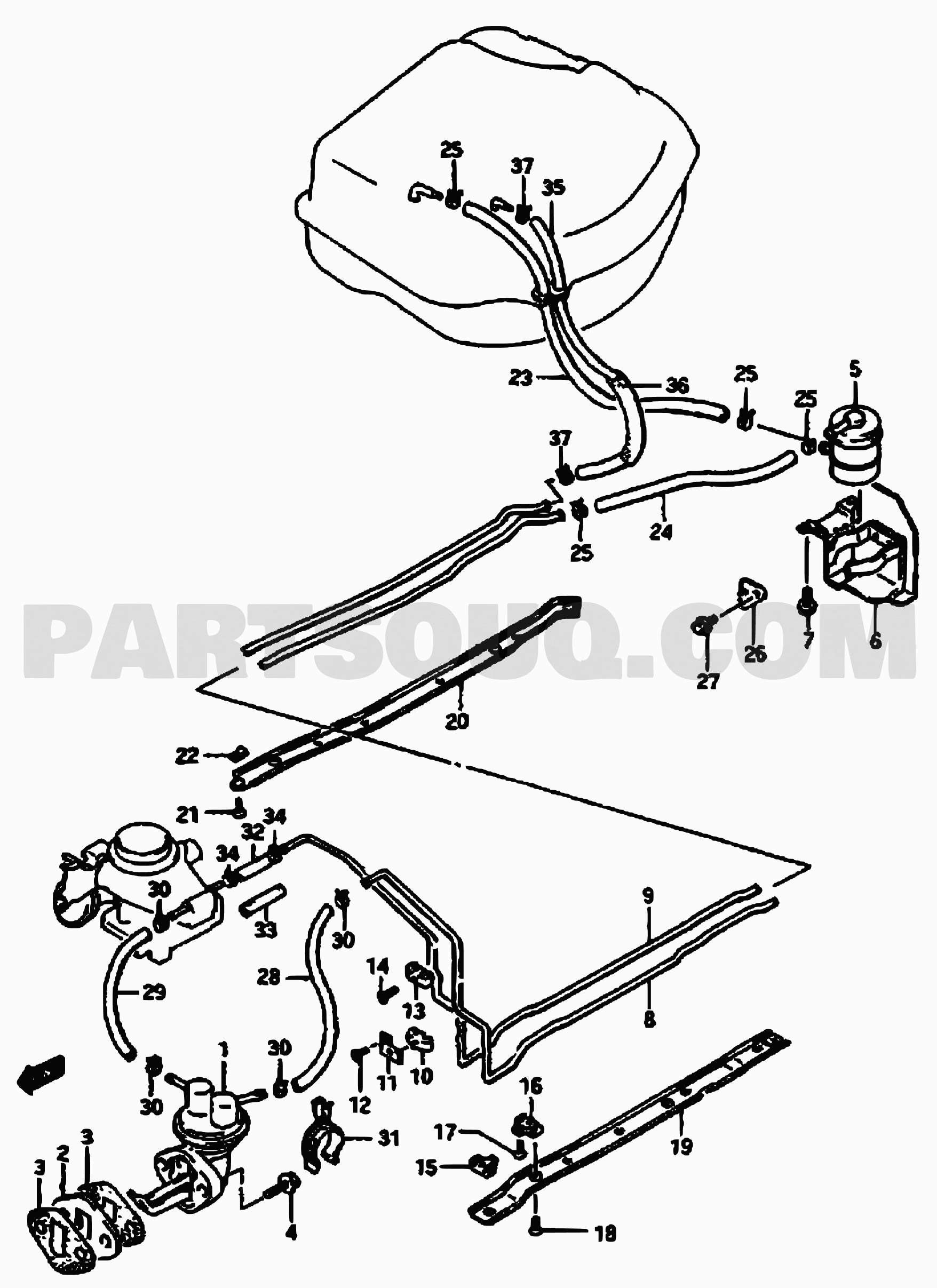

Roll on windows, close external air vents and drive the car if no smell is coming then it meas the fuel is leaking from engine bay and get it examined. it could be from carburetor or from fuel filter.
If the smell is still coming when everything closed then do the following:

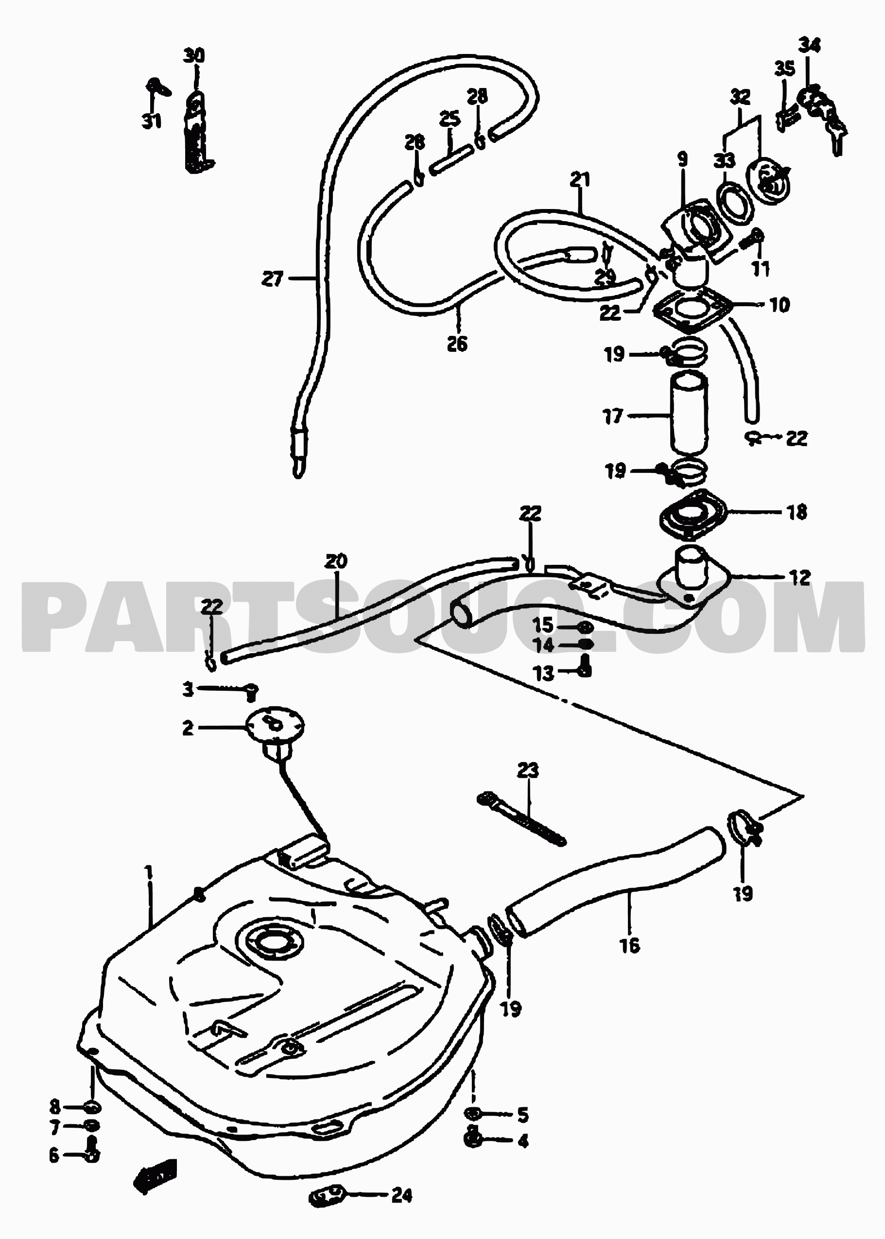

Replace all the fuel hoses (complete set including the rubber ones and the metal ones) i mean change the loop from the filler area to the tank.
Also take out the tank and inspect the area where fuel gauge is fixed. this also leaks petrol due to worn out old seal. get it sealed properly.
