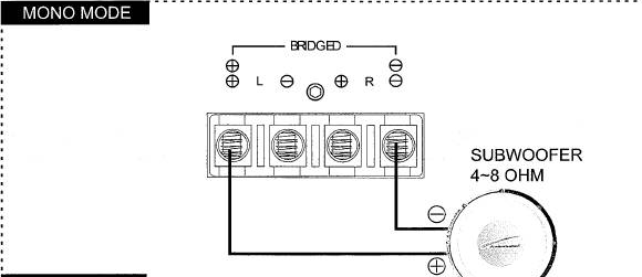

Since this amp is giving 800rms @4ohms in bridged mono. so can i connect my 308D4 sub in bridge for 400rms @8ohms? since the increase in ohms from 4 to 8 will divide the rms output to 400 instead of 800?
