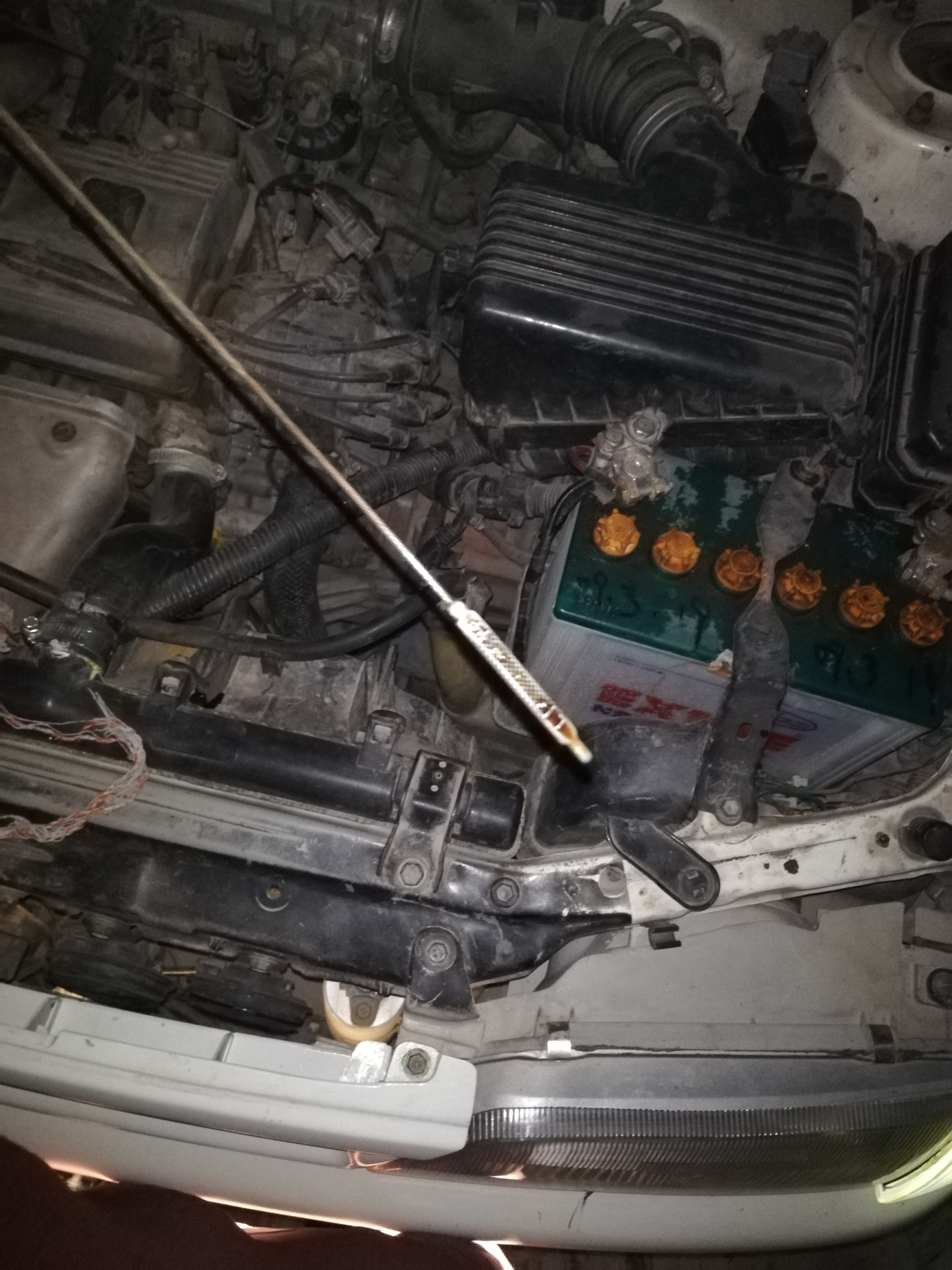

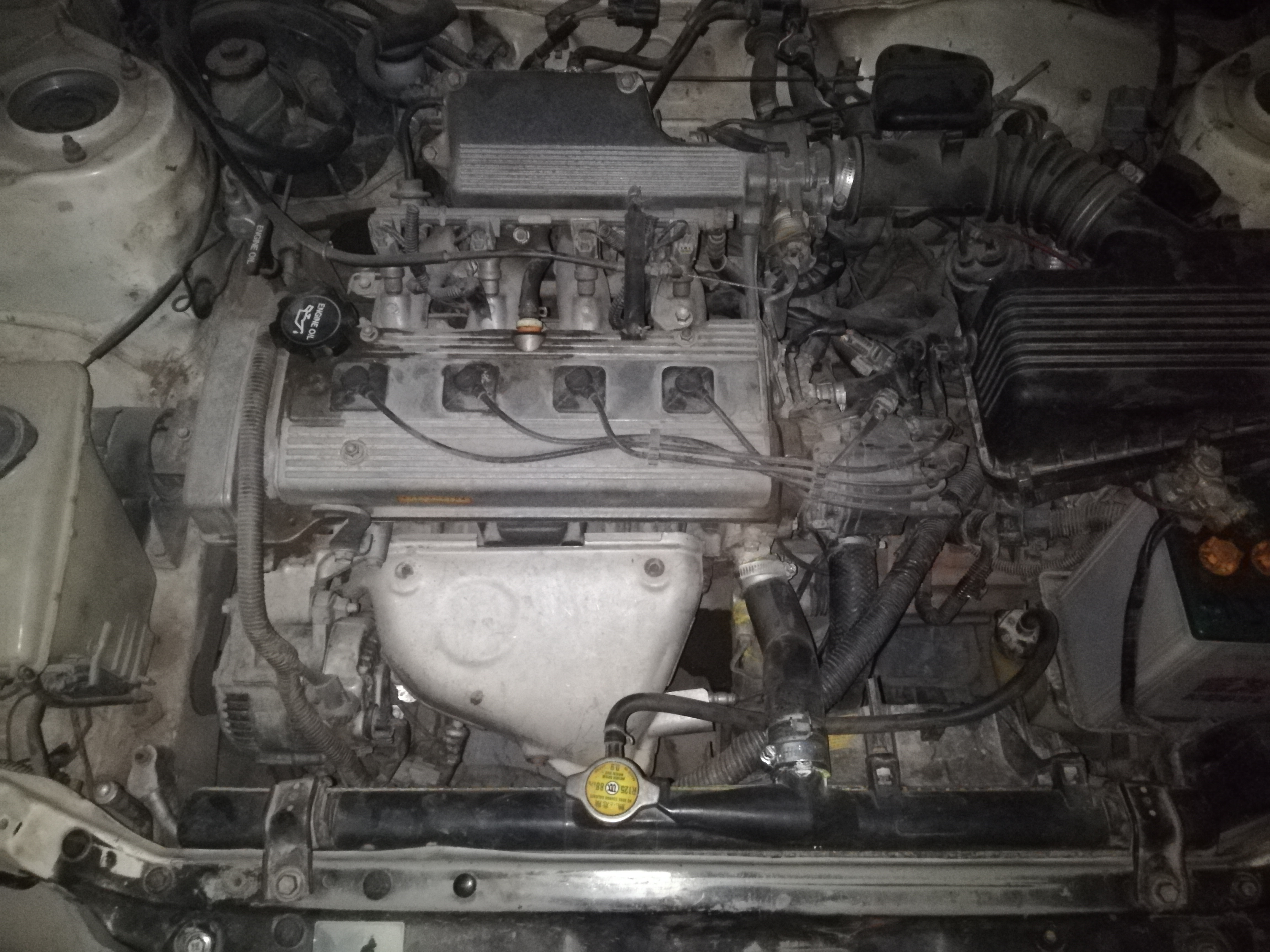

Blue smoke is coming now from silencer
Pani ni ha.
Gari original japani hai ya engine swapped hai ?
Swapped.just like your car
Gari bohat jaldi heat ho jate han
Engine ki internal condition kafi khrb lagg rhi hai. Sludge build-up hai kafi ... Knsa oil use krty hain ap ? 20w-50Baqi blue smoke to rings kamzor honay ki wajah sy bhi ata hai.
Oil kamm kr rhi hai ? Rings weak hain phr to ...
Havoline engine oil 20 50
Phr apko pehlay to properly wiring krwani hogi engine ki. Saray sensors wagera connect krwanay hongay. Kafi kharcha hoga & saath mai rings bhi weak hain, valves bhi weak hongy bcz ap ny cng use kiya mostly.
AP Kya suggest karta ho ab.engine assembly .
Apko 10w-40 use krna chahiye tha ... Abhi I think apko engine rebuild krana parayga ya phr rings change kranay paraingay.
Half assembly bhi apko 60 - 70k tk milaygi.
