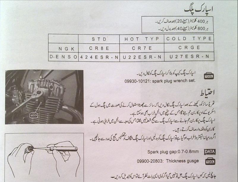

Hi all.I've recently bought GS150SE. I've been meaning to upgrade its spark plug. I wanted to know if I can use NGK CR9EIA-9 ( LASER IRIDIUM) plug in my bike?
No you can not use it because its not in company recommendation...search your plug in Ngk CR8xxx range...I have installed NGK G-POWER CR8EGP in my GS150 there is too much notice able difference in performance...Bike pick up has improved a lot+vibration+knocking on high Rpms has gone...its price is around 500

ٱلسَّلَامُ عَلَيْكُمْ وَرَحْمَةُ ٱللّٰهWhat about NGK CR9EIX for Suzuki GS150SE.
ٱلسَّلَامُ عَلَيْكُمْ وَرَحْمَةُ ٱللّٰهWhat about NGK CR9EIX for Suzuki GS150SE?
Walaykum ussalam W/RCR9EIX Did not used so can not share any experience ..NGK G-POWER CR8EGP is from company recommended series
