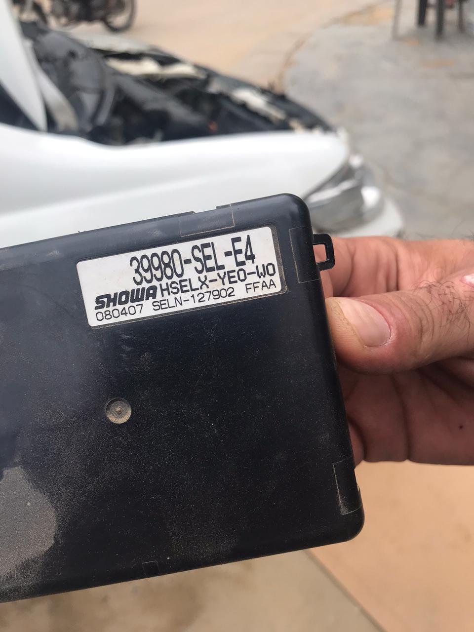

I have bought honda city 2006 last month i had EPs indicator light and steering got hard. Scanned it and cleared the error. Error was ' torque sensor(coil) 'Again got the issue after a week, checked with an electrician, he said earthing ka issue hai or usne ik extra wire lag di earthing k lie or kaha k sensor per load zada parh raha tha.Error again arised after a week. electrician said sensor change kara lein.. Or ik electrician is saying k assembly change krayen sirf sensor change ni hota kharab hojata hai.After clearing error 5 times and calliberation 2 times, i went to an electrician who changed steering plug placed inside bonet aswell as its Eps card (costing 10k).I am hoping k yeh error dubara na aye. Warna assembly b change karani paregi.....
