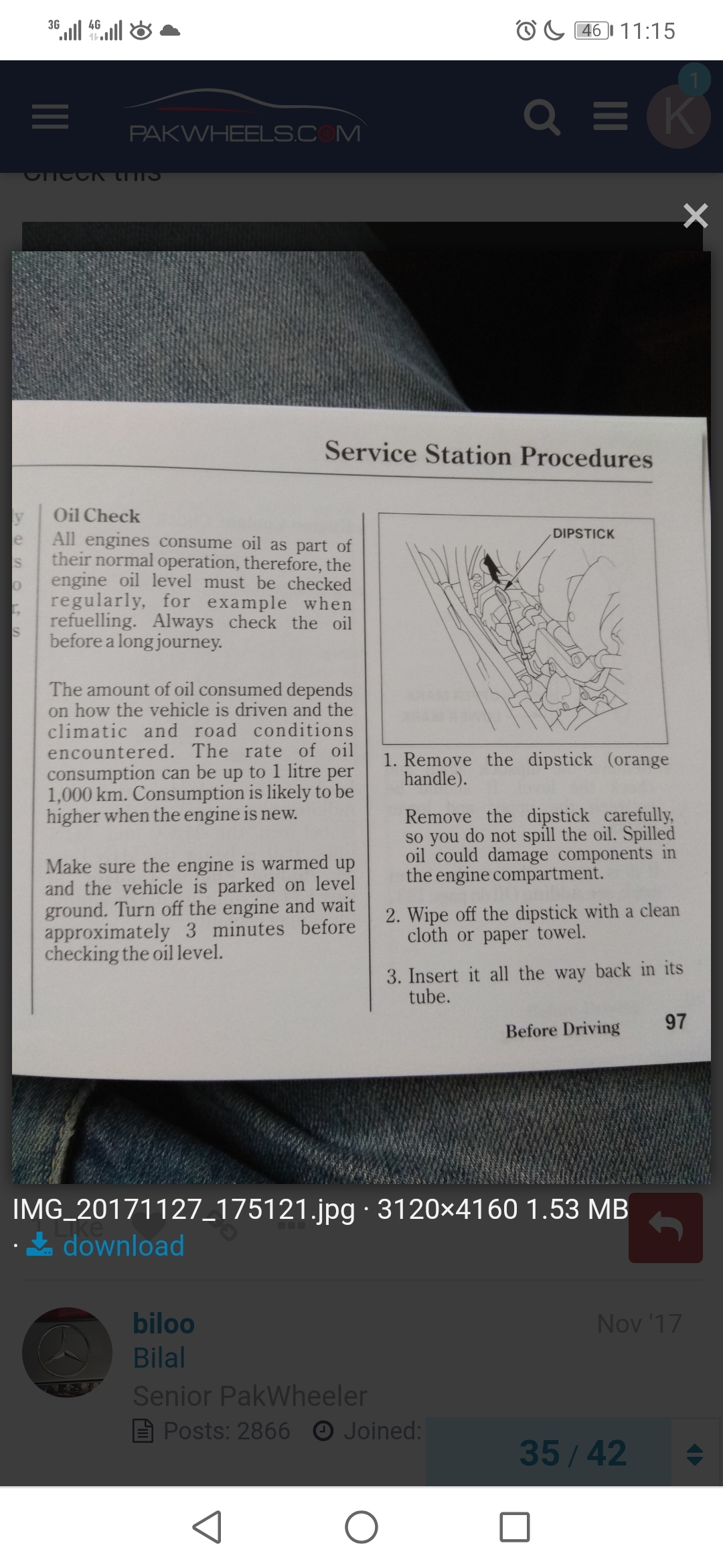

keep using 5w30does it give blue smoke at start plus honda has mentioned in 2008 upward models manual that slight consumption is normal
