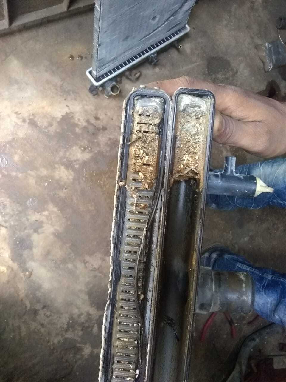

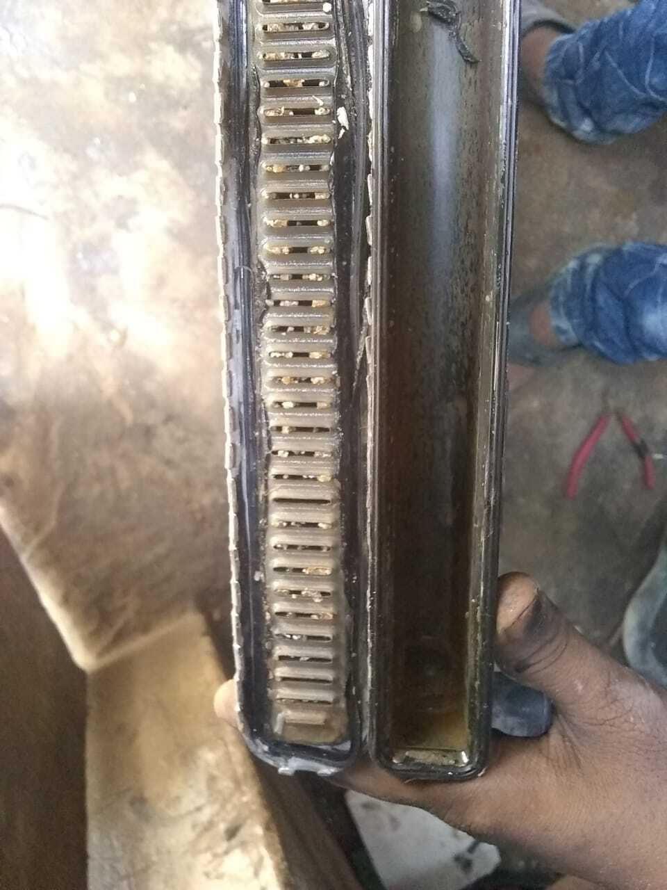

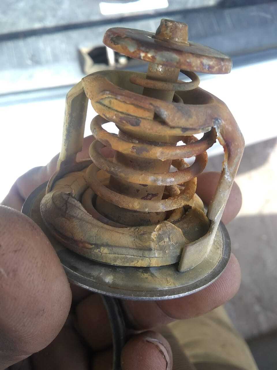

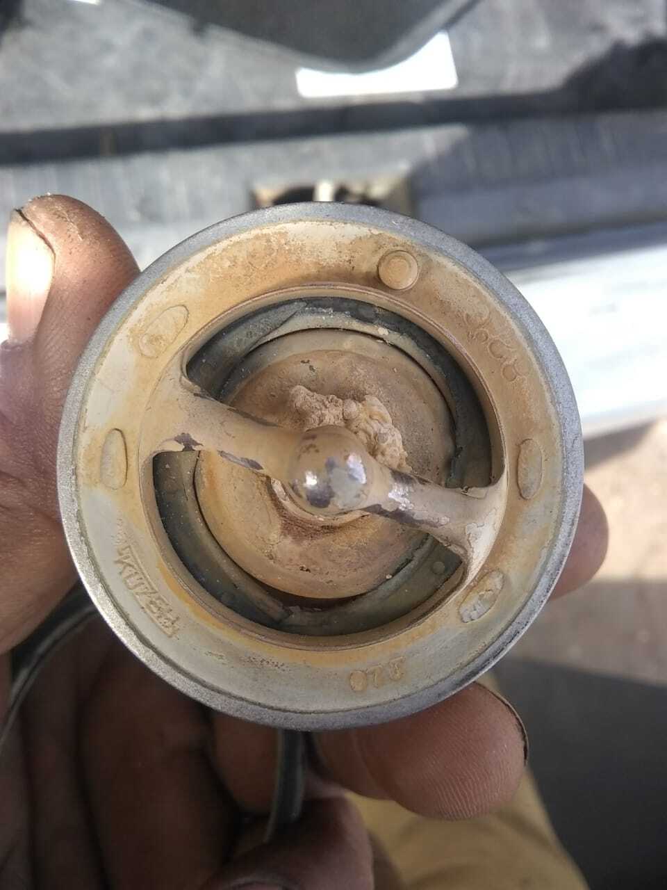

look what came out, pictures shared by car owner / snapped & shared by irshad ahmed

mr.ahmed performed compression test to which reading was 170 psi over all 4 cylinders. he changed engine oil to aisin 5W-30, Genuine Toyota oil filter & air filter. He noticed radiator single electrical fan on constant run. Found thermostat valve in this condition. Replaced genuine new, he also removed radiator which was apparently GOOD, but thats' how it was found. The return tank was having some kind of saw dust deposit having hairline crack and simmering leakage was present.
upon recommendation of mr. ahmed only radiator tank was replaced from a salvage yard.
