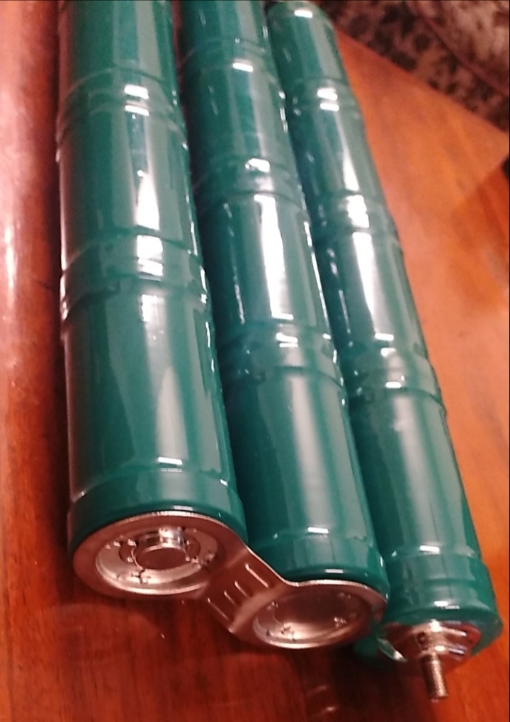

New modules fresh from factory is best option but very few people willing to pay price, at current dollar rate, 2lakh for aqua. I had some modules custom designed for this purpose nd fitted in few cars in my circle, nd they r working gud. Have a sneak peak. (My line of work involves with LiFePO4 batteries for purposes i cant write here)
8point spot welds to handle high currents nd keep module internal resistance low
