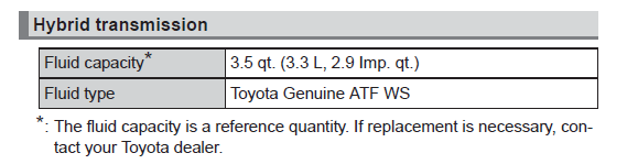

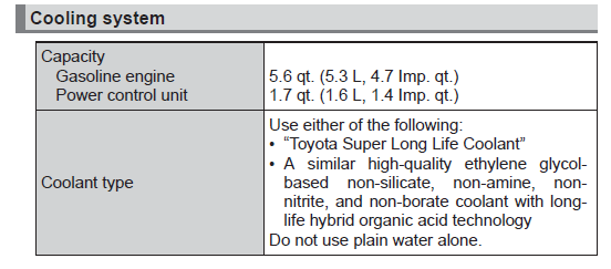

Does toyota prius coolant needs to be changed after sometime or not? Also which gear oil is best for Prius and after how much time one should change it?
Refer to your car manual, 1) Coolant needs replacement after certain KMs, mentioned in car manual2) Gear Oil also mentioned in manual.Below are the screen shots of "Prius C" manual. for reference only

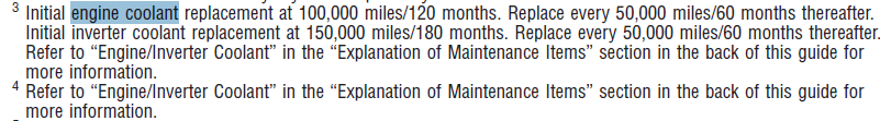

The manual of PRIUS C does show below screen shot of fluid typeBut not the changing interval From where did you got the changing interval please shareRegards
Its in maintenance manual, download link given below

Gear oil needs to be changed every 40k kms. Toyota genuine atf ws to be used only.
Hybrid vehicles have different coolant & CVT(A) , please check from user manual or locate using google.
