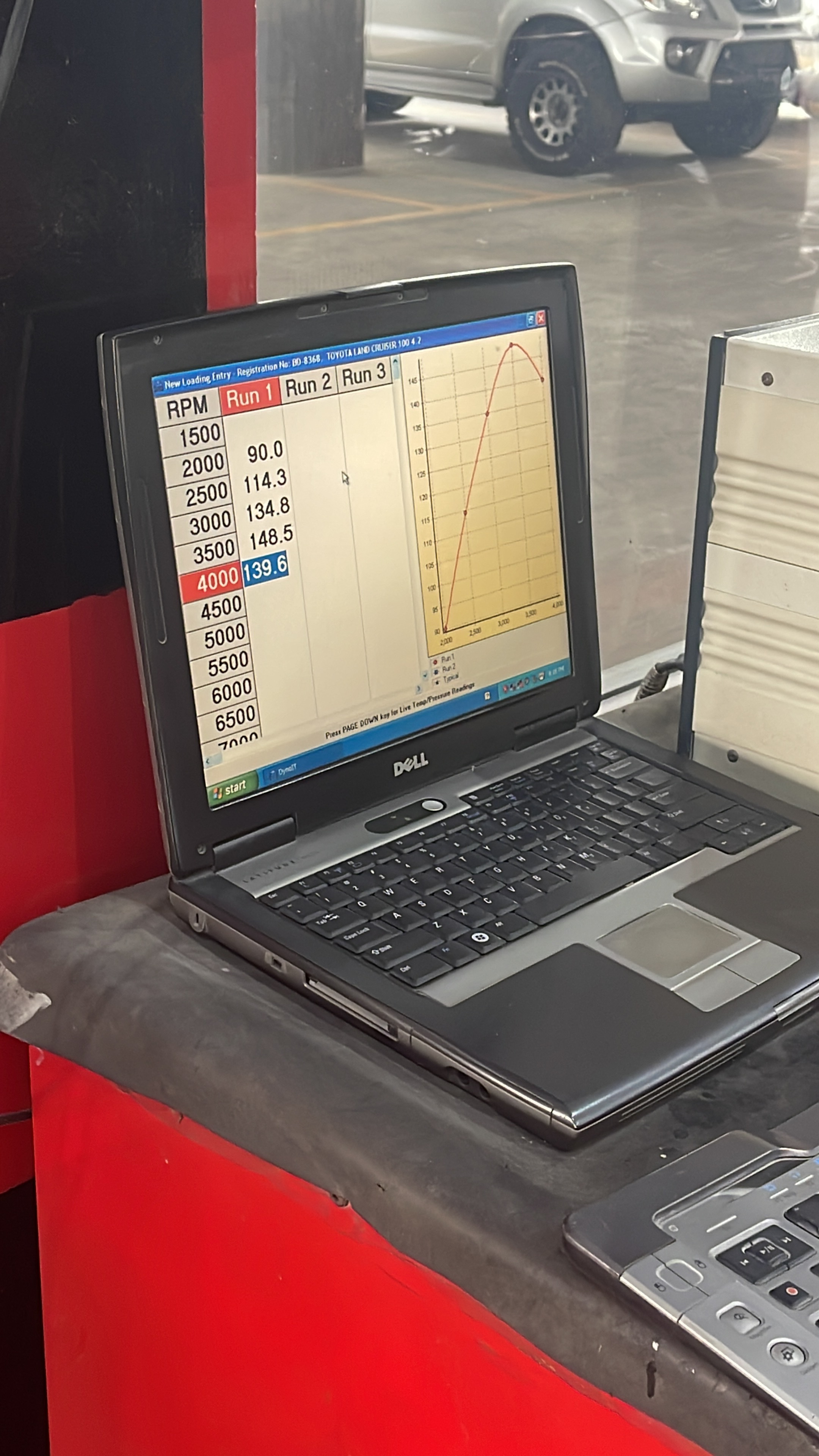

Day one we did Dyno test. The total HP was 148 at wheels and around 300nm of torque.

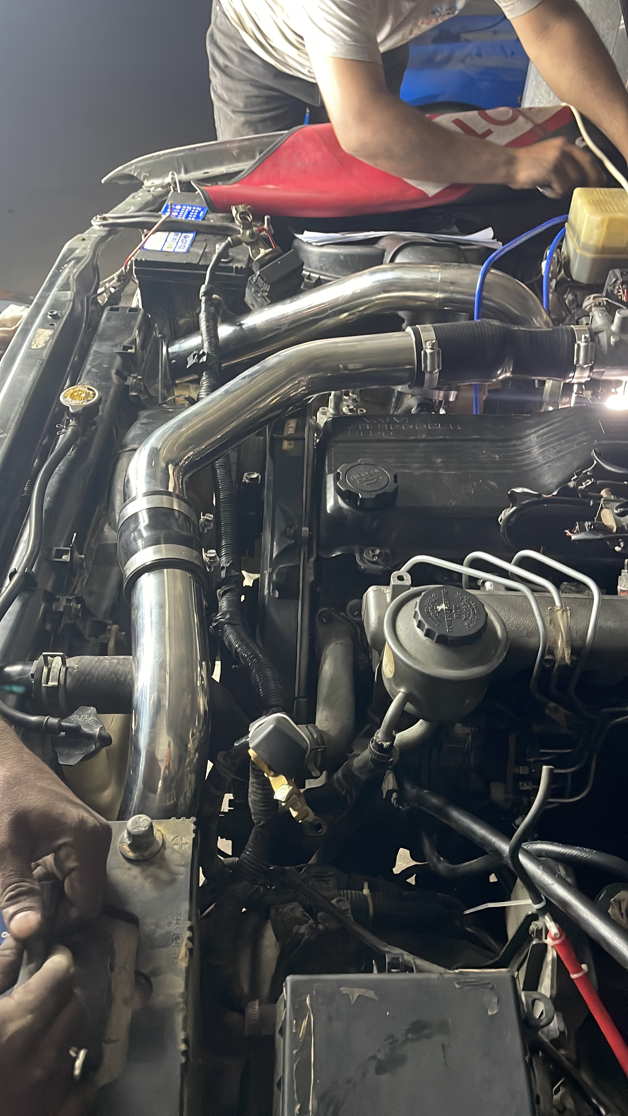

Day 4 The engine was started and holes were made to install intercooler. The engine was started after test fitting of everything.

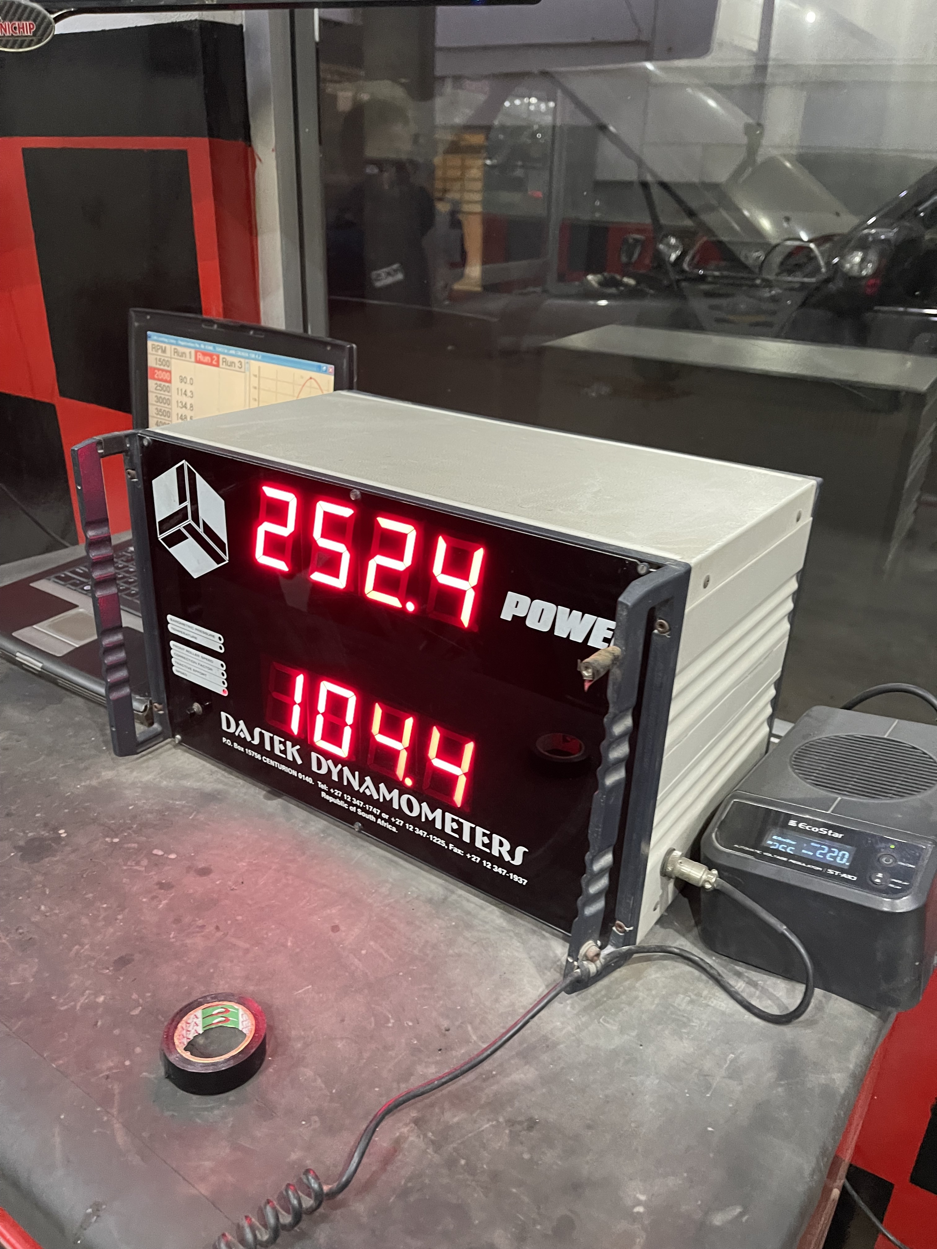

Back to Dyno and power was around 252 hp torque 600 nm.

All fittings were removed for final installation. The ac lines were in the way of intercooler so had to sacrifice refrigerant. Ac lines were removed and all fittings were finalized. Just to mention here turbo was bolt on kit so no issues there.
Day 6 the vehicle was off to exhaust shop for removal of muffler and Ac lines were rerouted by a welding shop at tariq road. The ac refrigerant was charged by a guy at tariq road MS autos. Very well done.

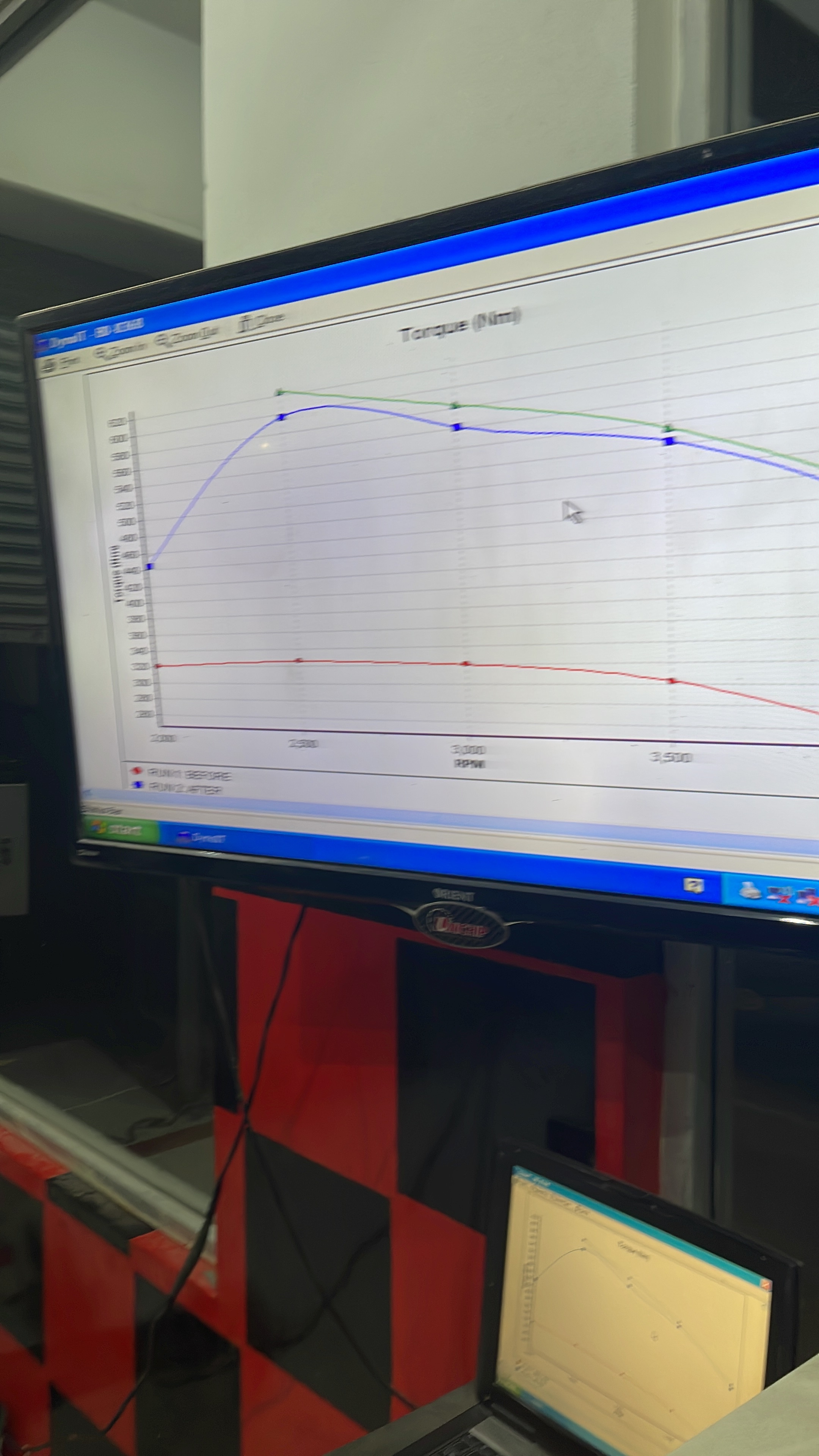

The vehicle is back to dyno final tuning was done as the transmission is not upgraded the power was limited to 277 hp and 620nm of torque at wheels. Unfortunately i did not caputre the Hp but here is torque graph.
The vehicle is different beast now although there is around 50 to 60 more hp to be gained but currently transmission slippage is limited factor.

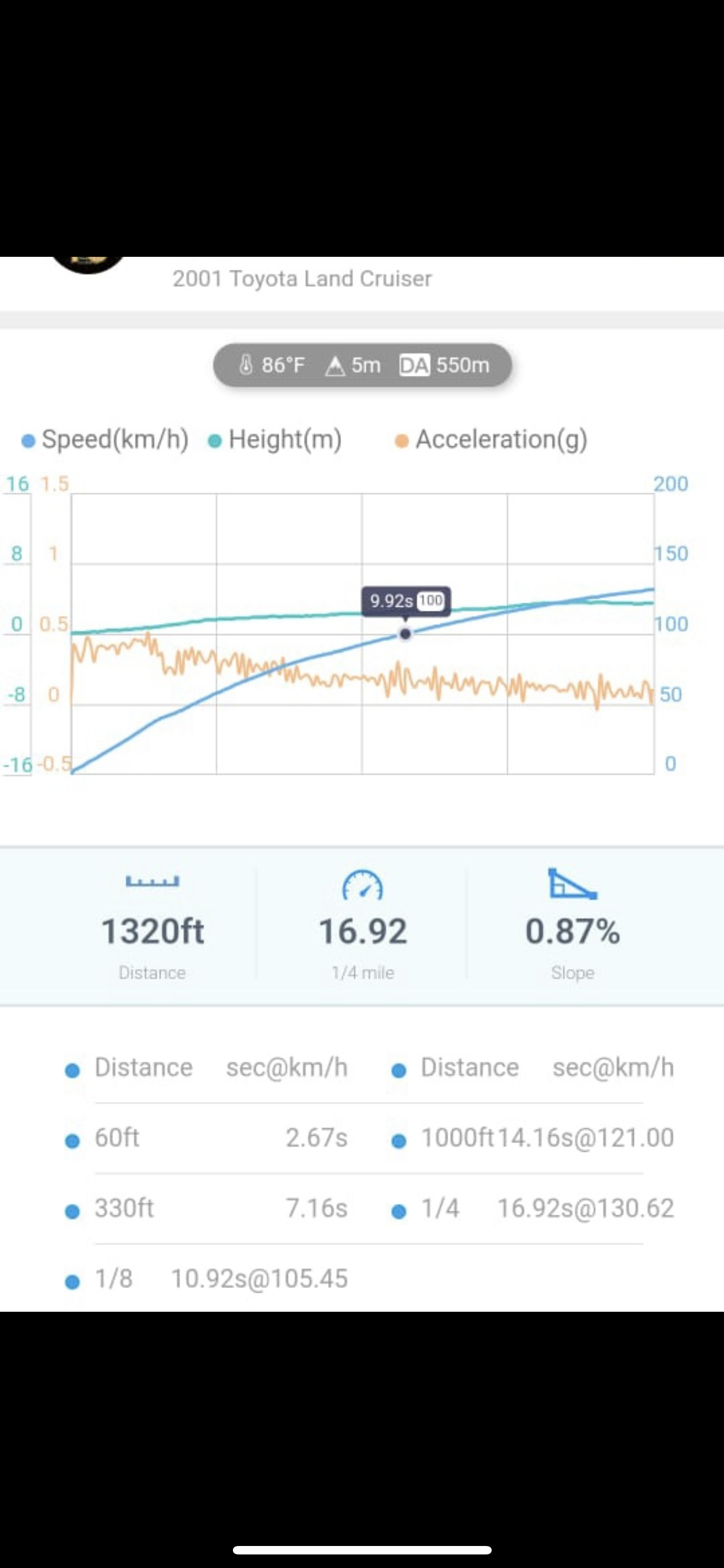

Here is 0 to 100km time and quater mile.
