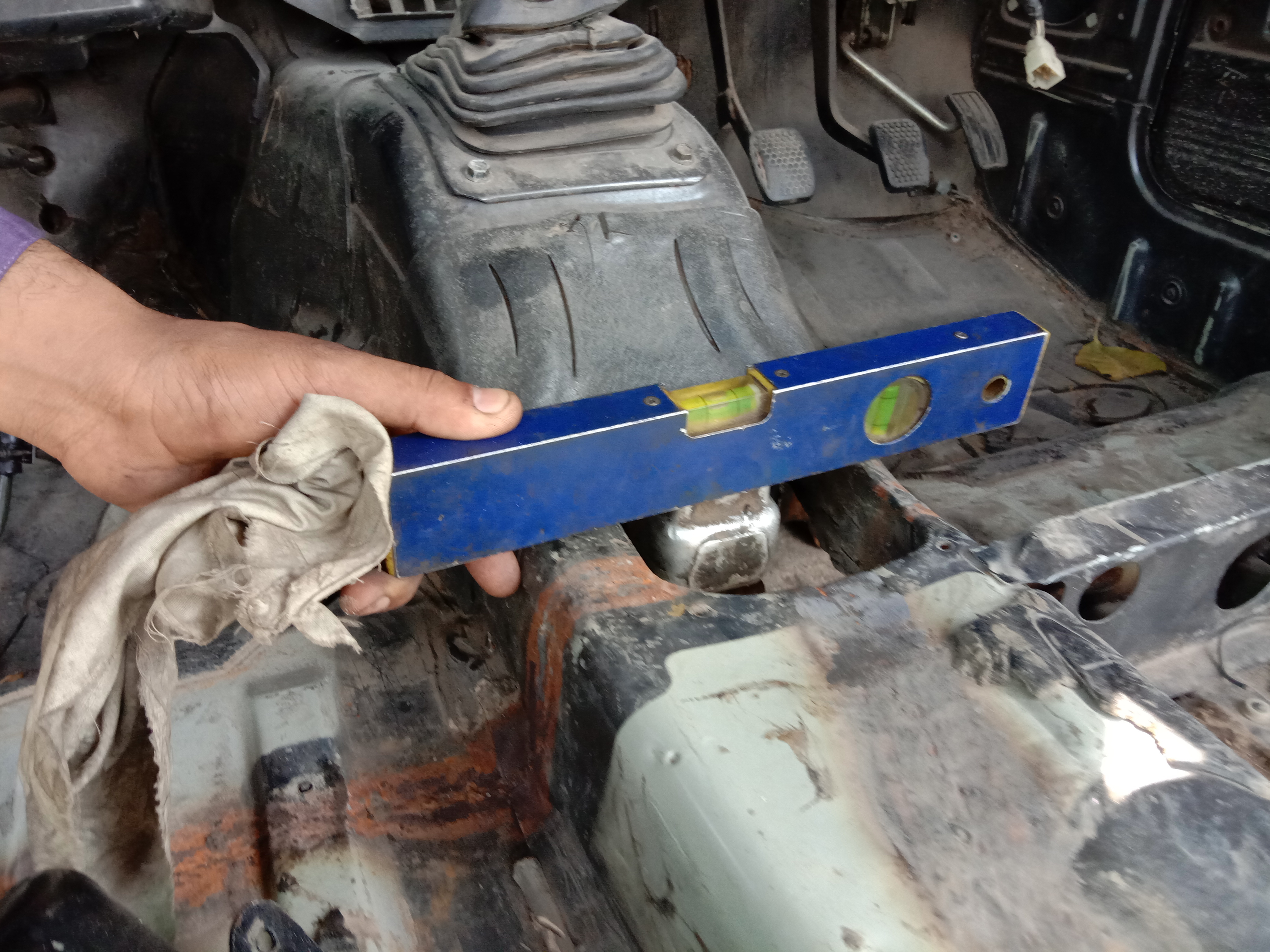

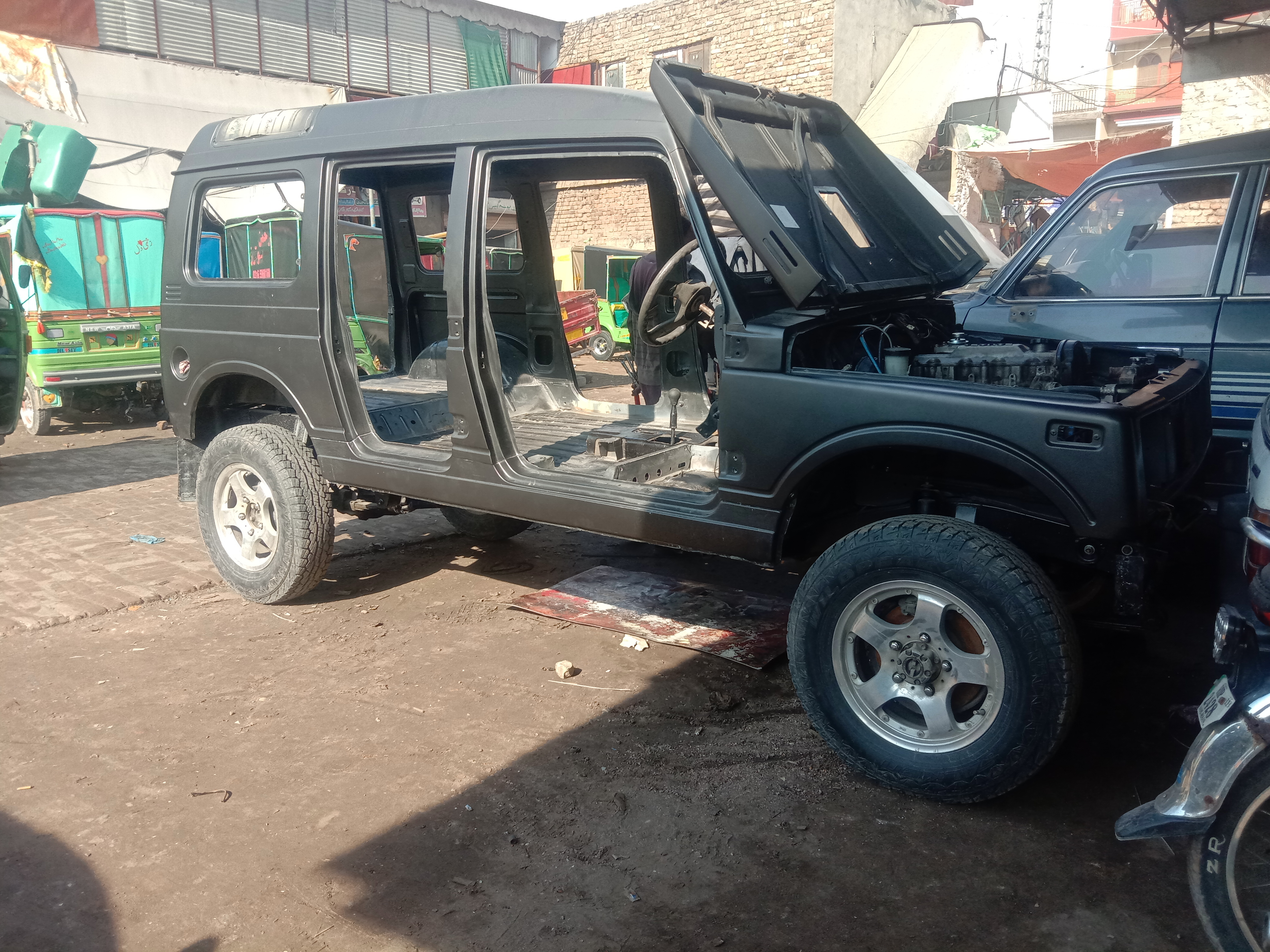

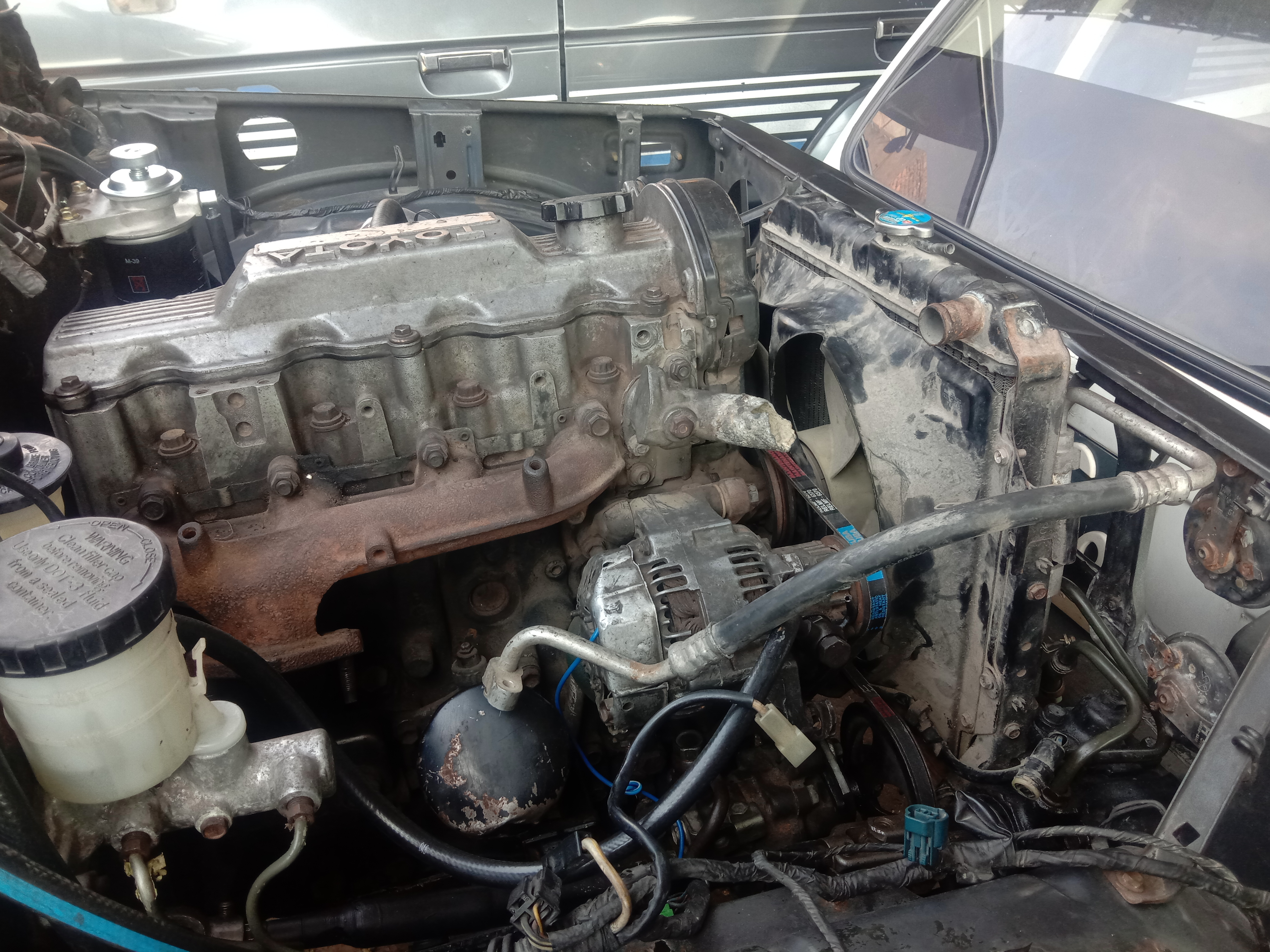

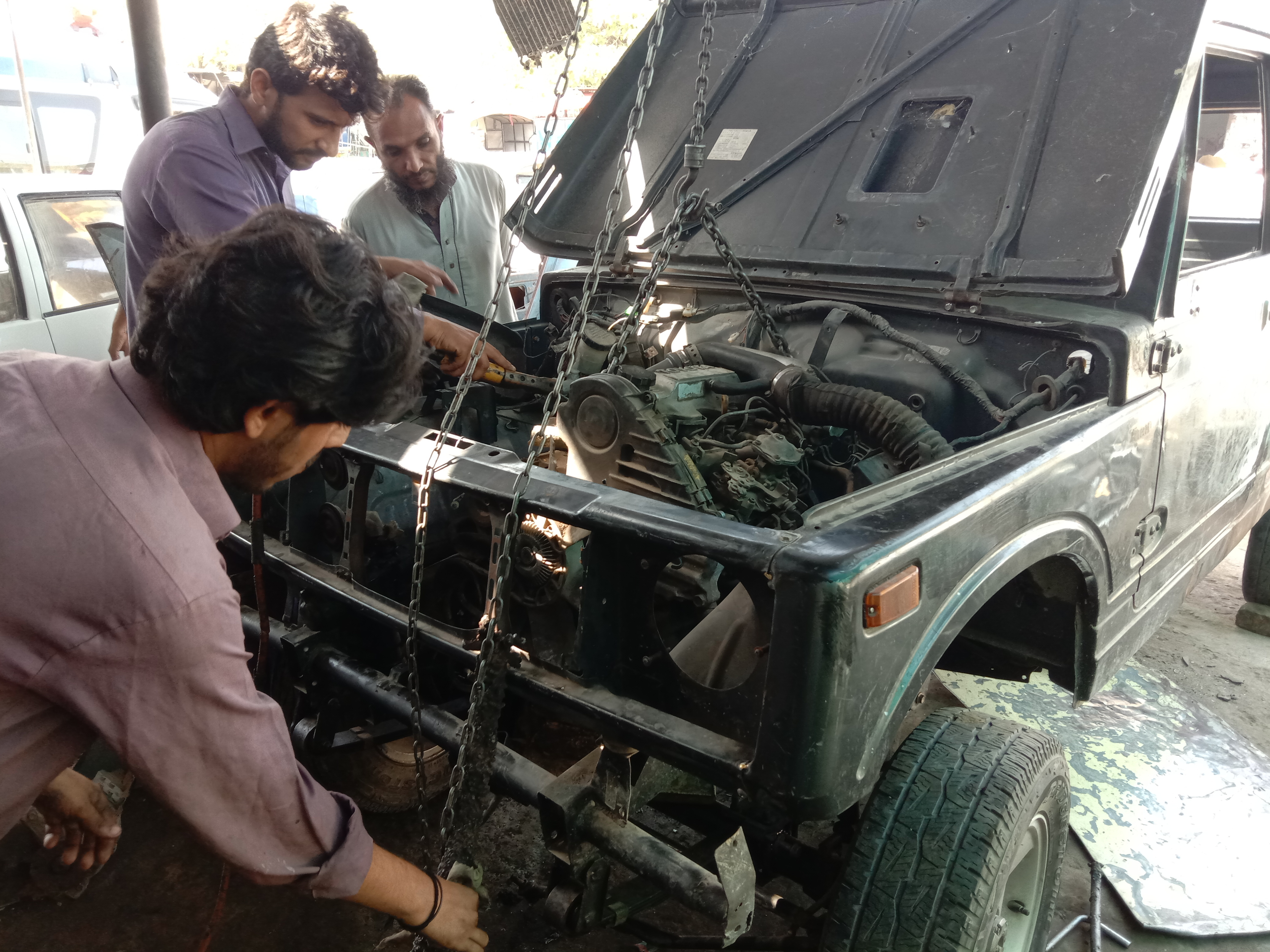

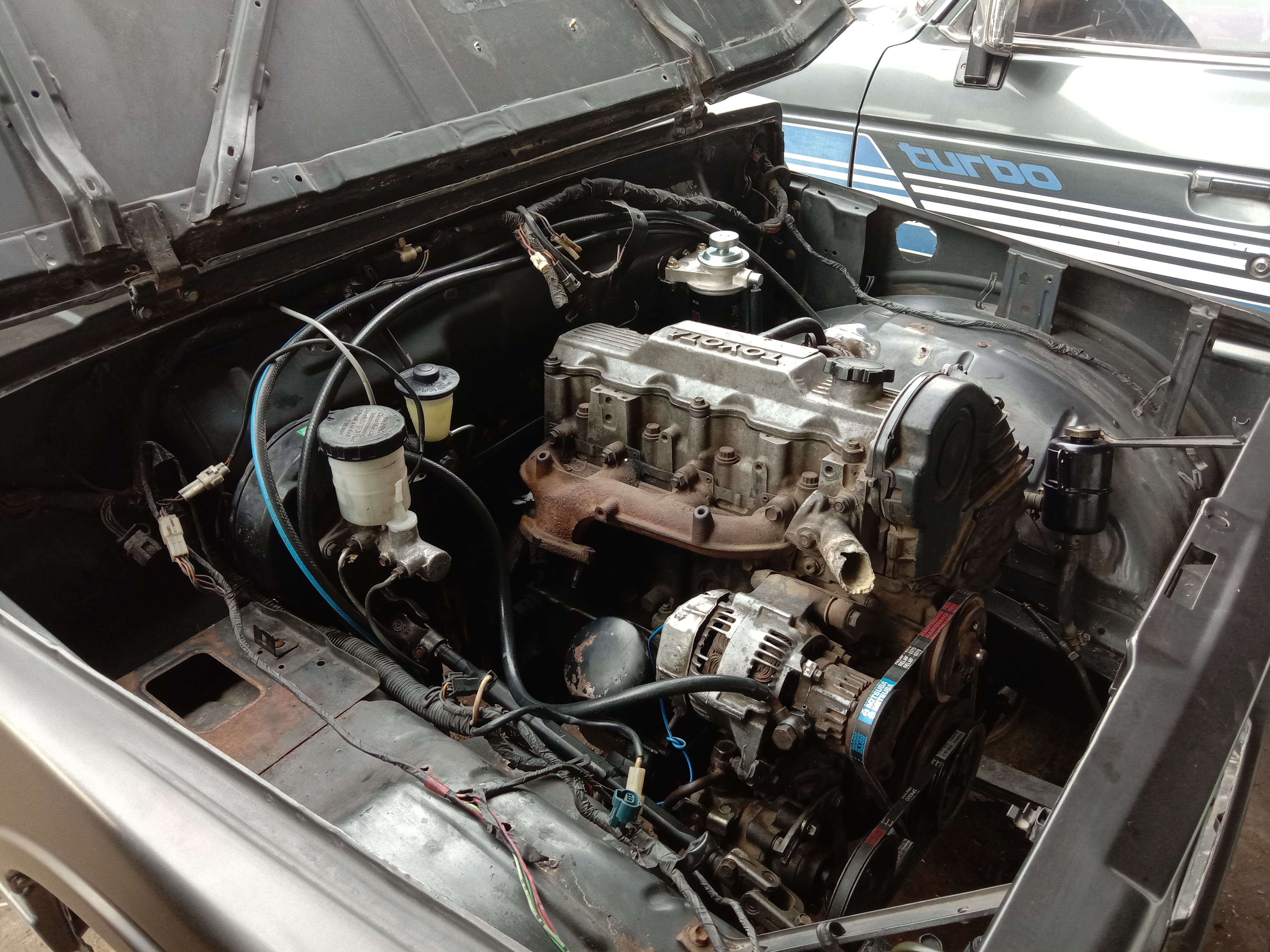

The gear box area needs to be widened to accomodate the diesel gear. Normally ppl do it by hammering but we decided to cut it and than properly expand it as per the gear.

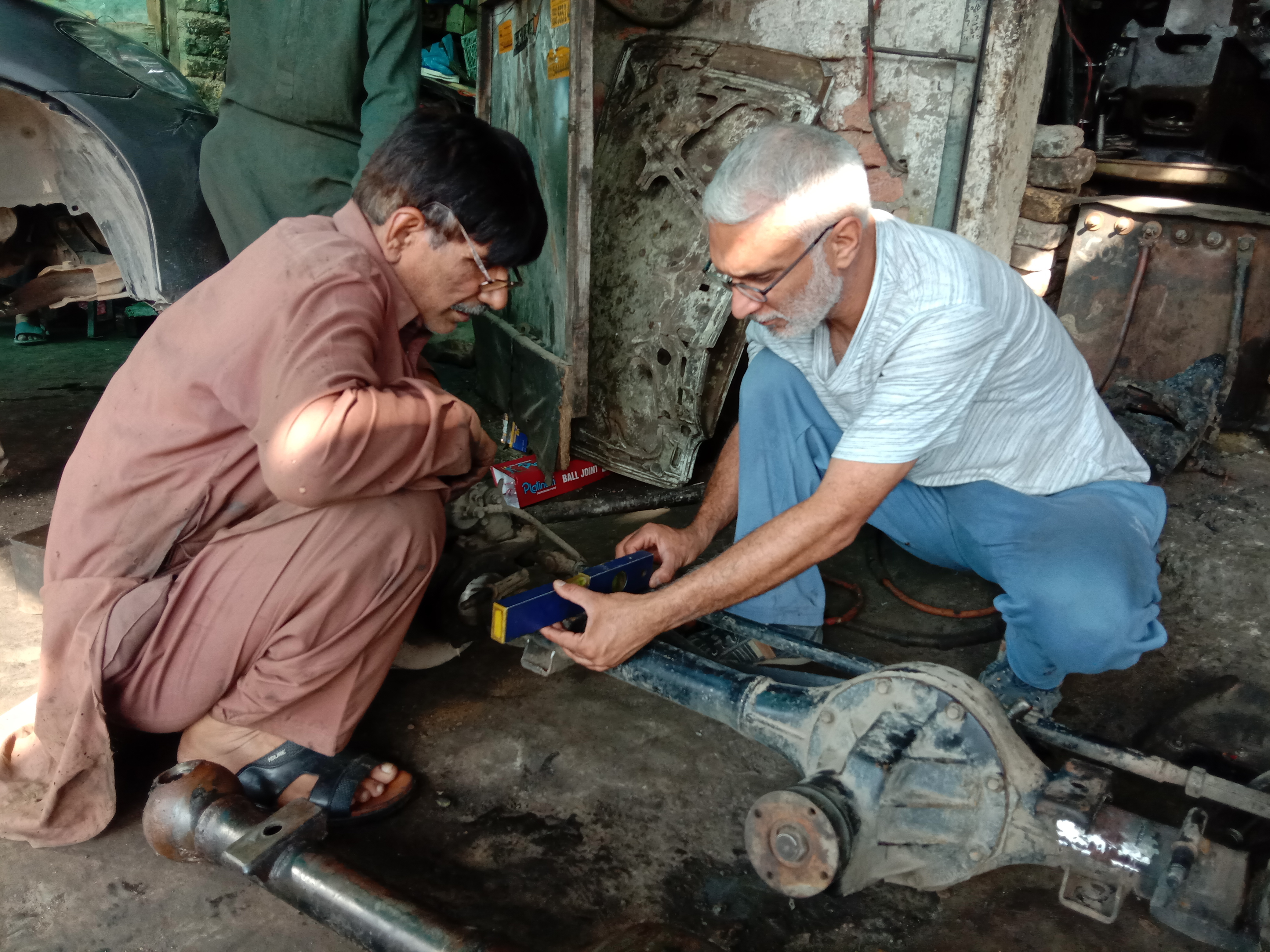

Did the spring over axle today. The degrees were kept stock to avoid any geomatrical issues.

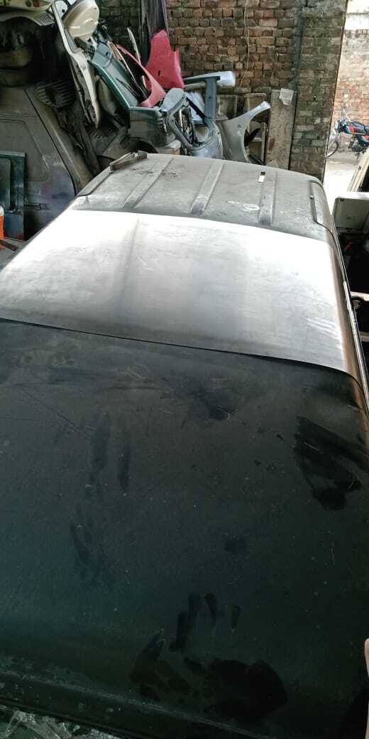

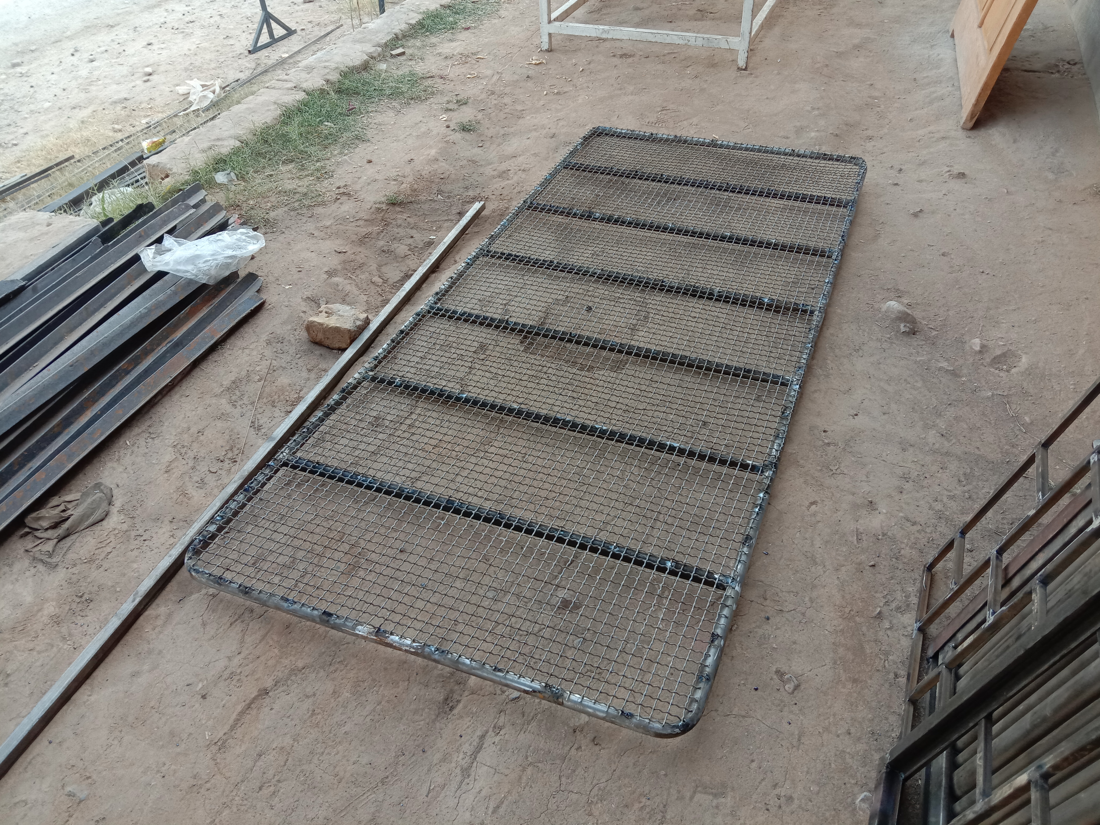

A new land rover style roof rack to be made

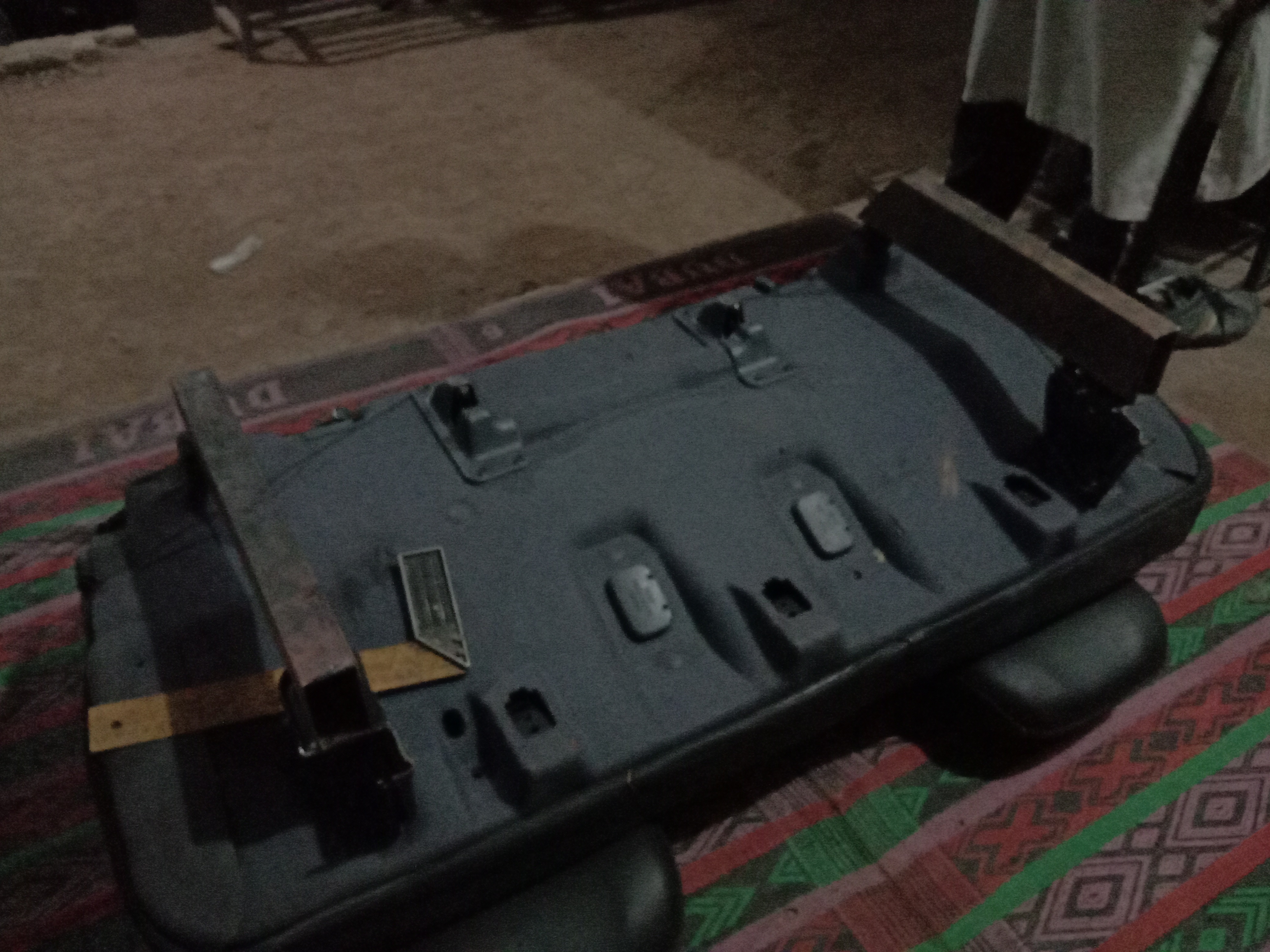

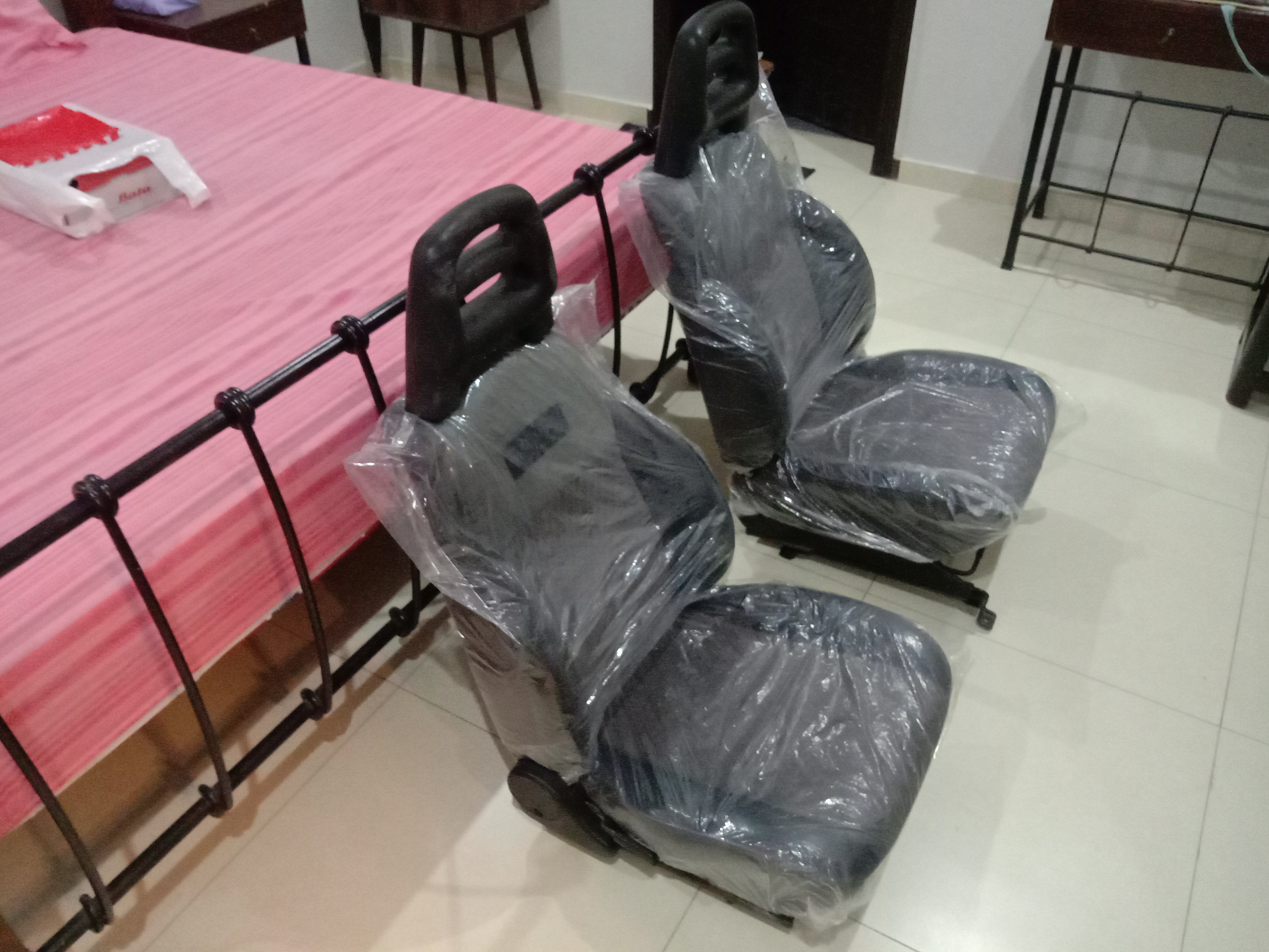

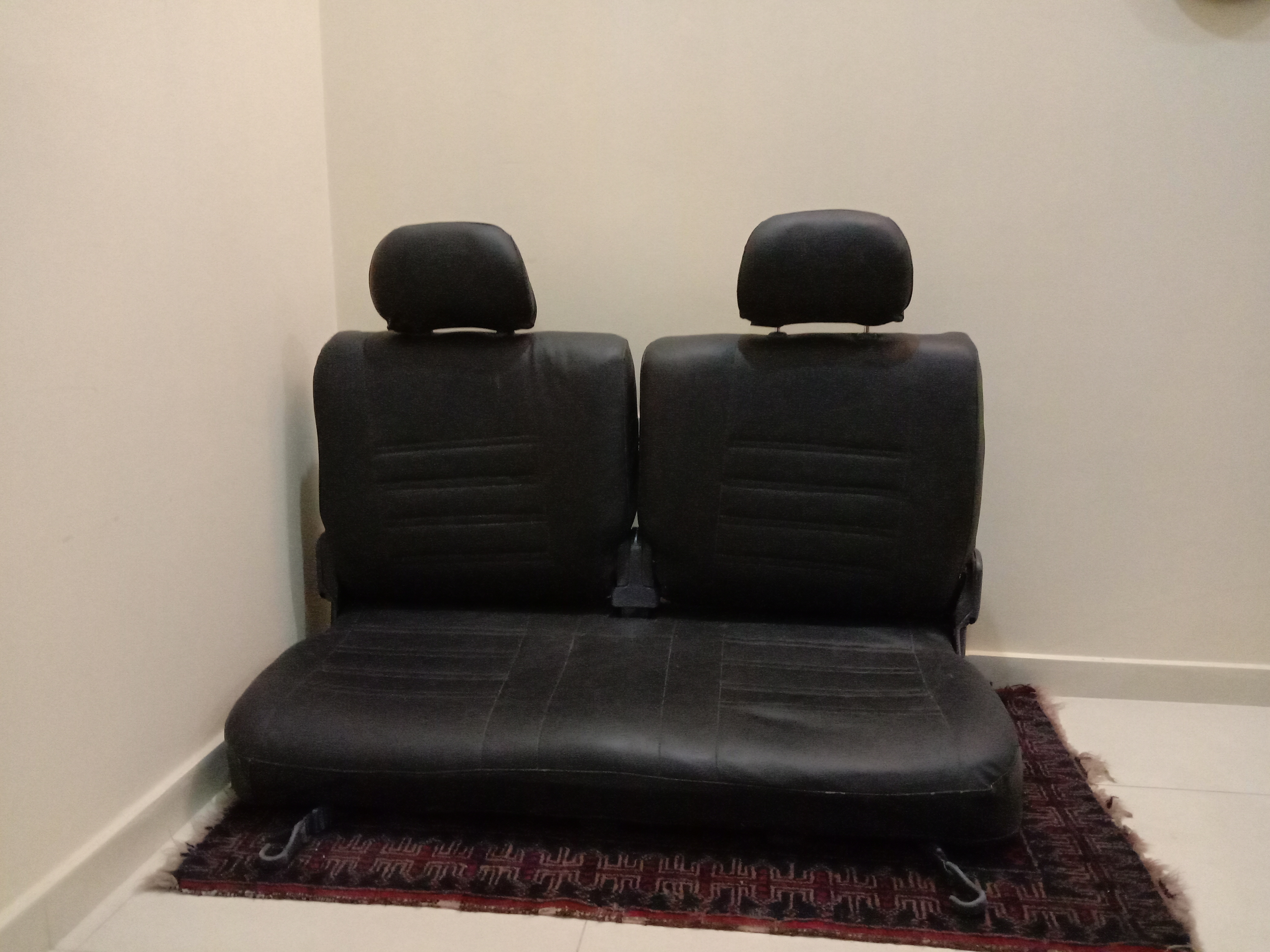

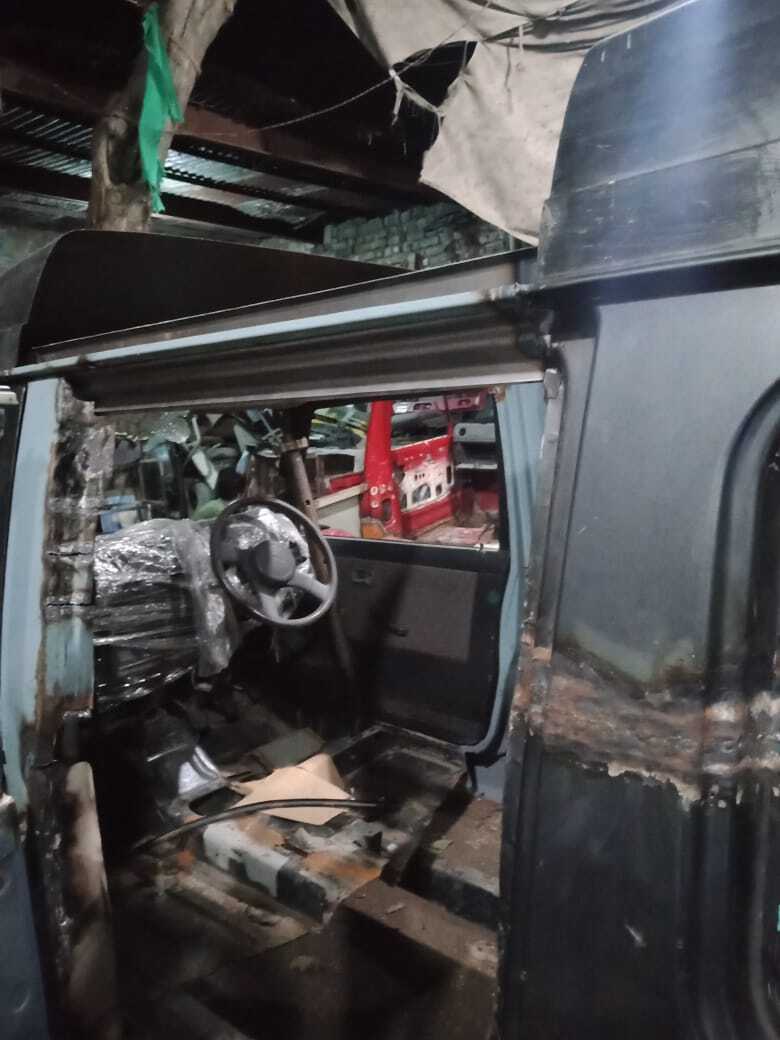

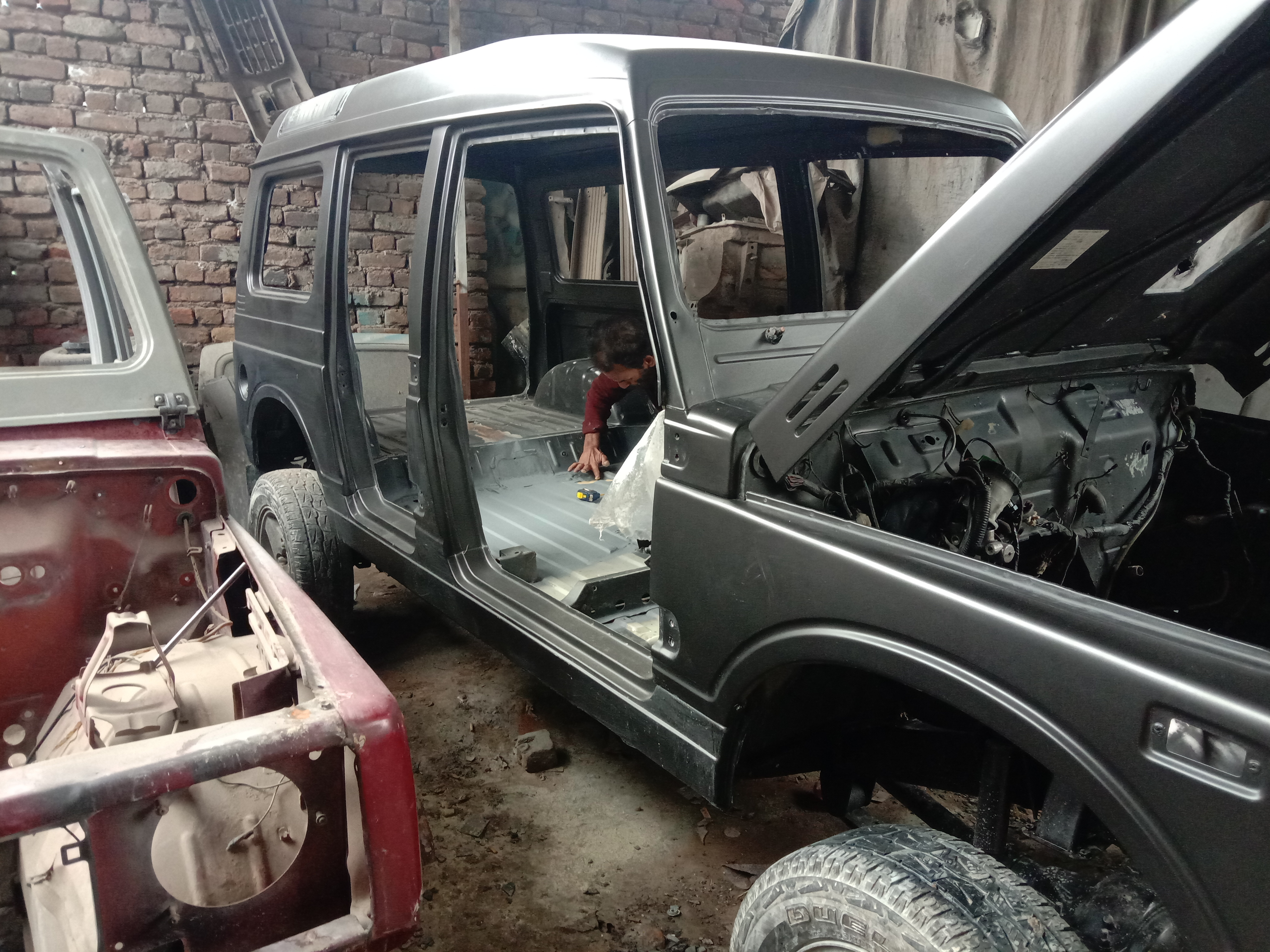

Before and now. The available space inside the cabin was 47". So the prado seats needed a little alteration .

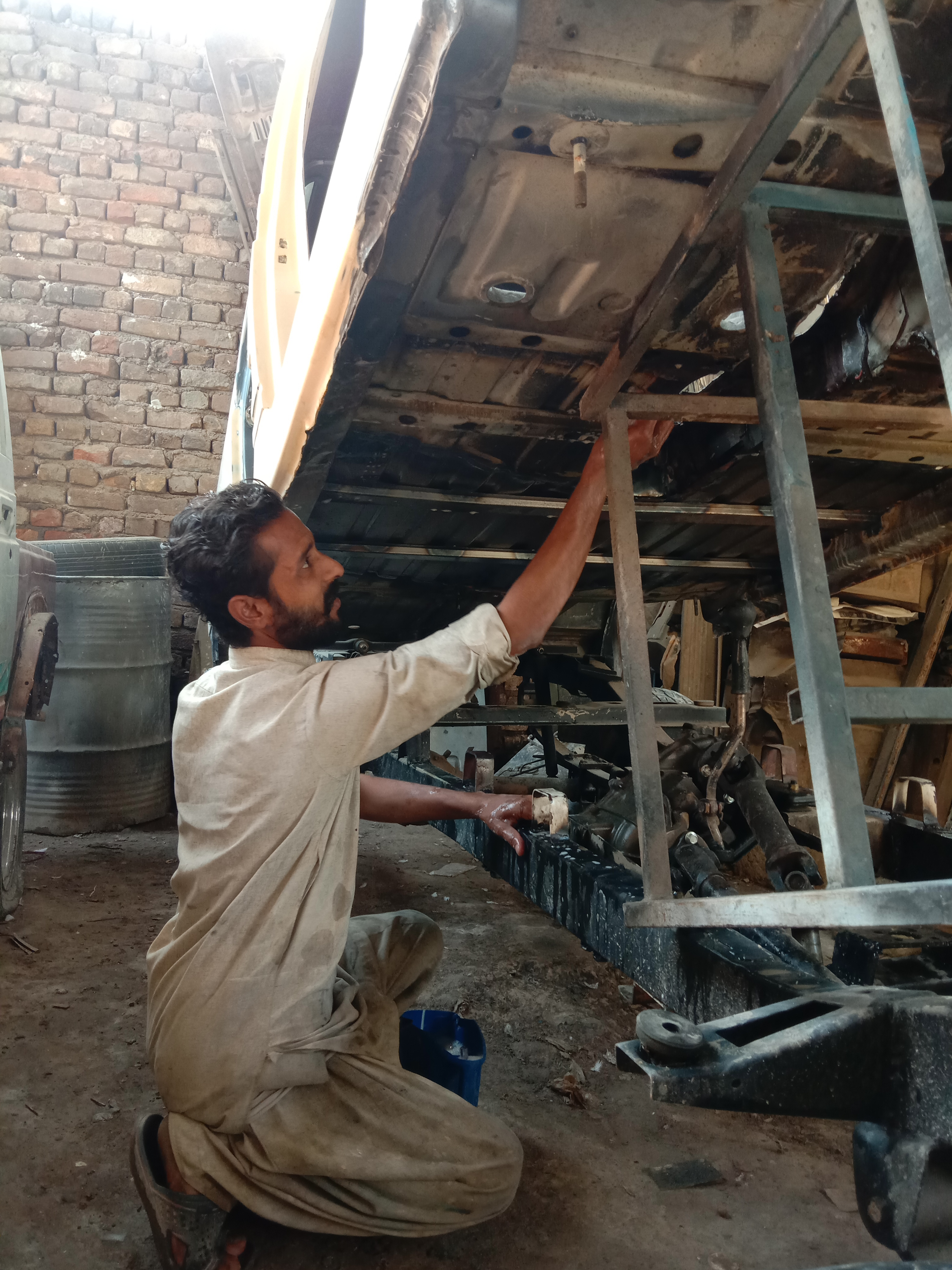

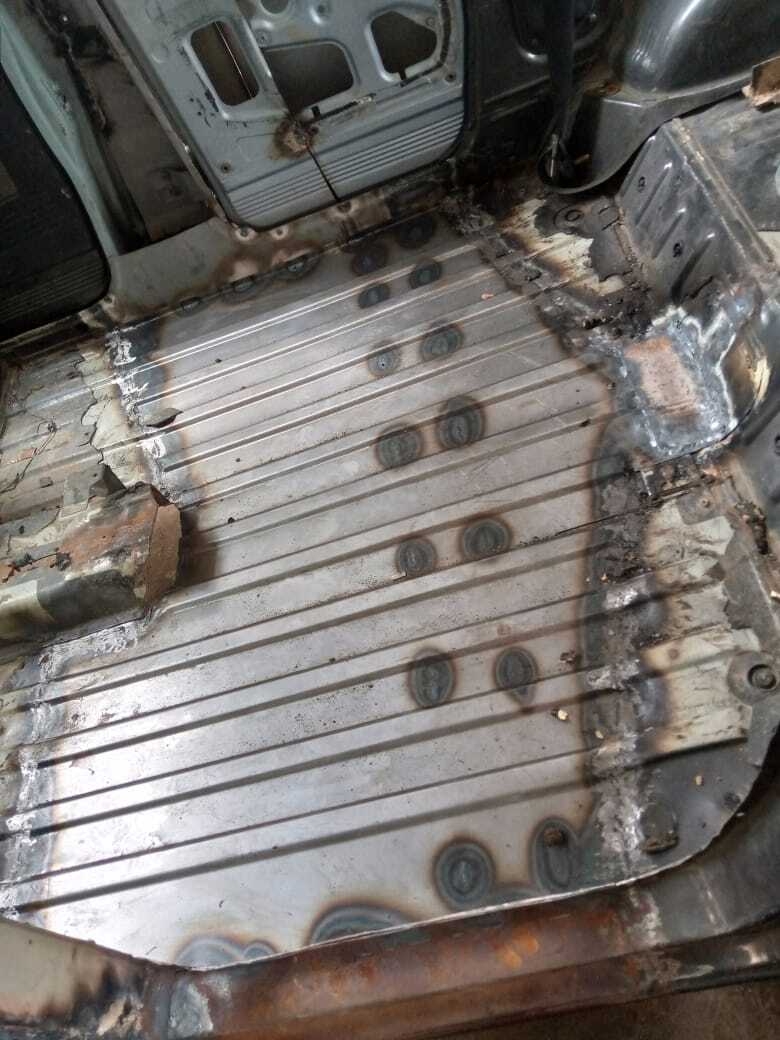

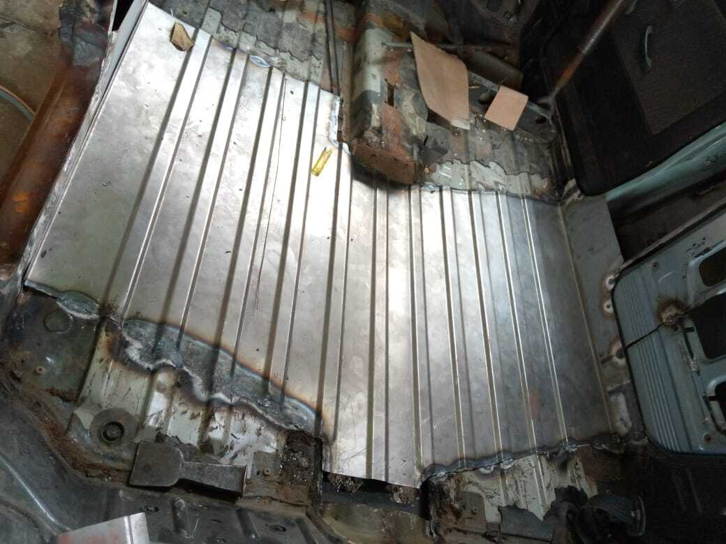

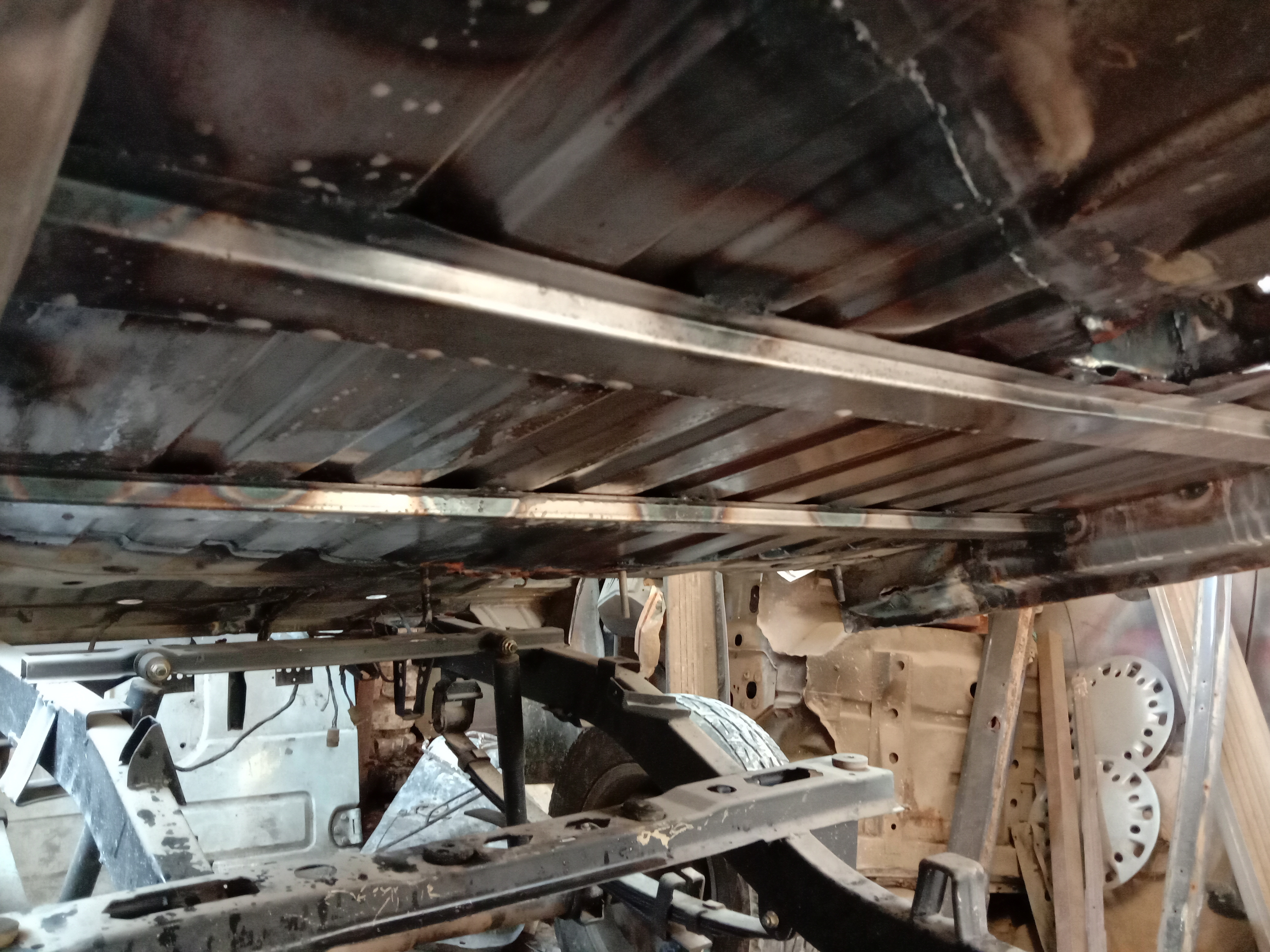

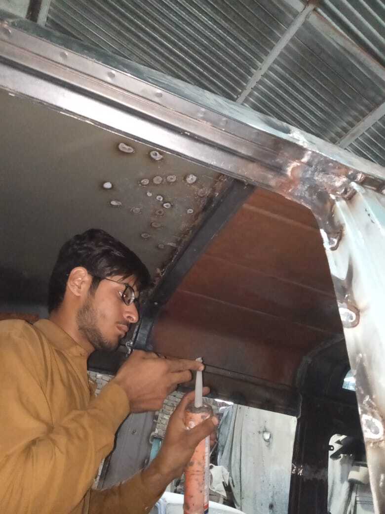

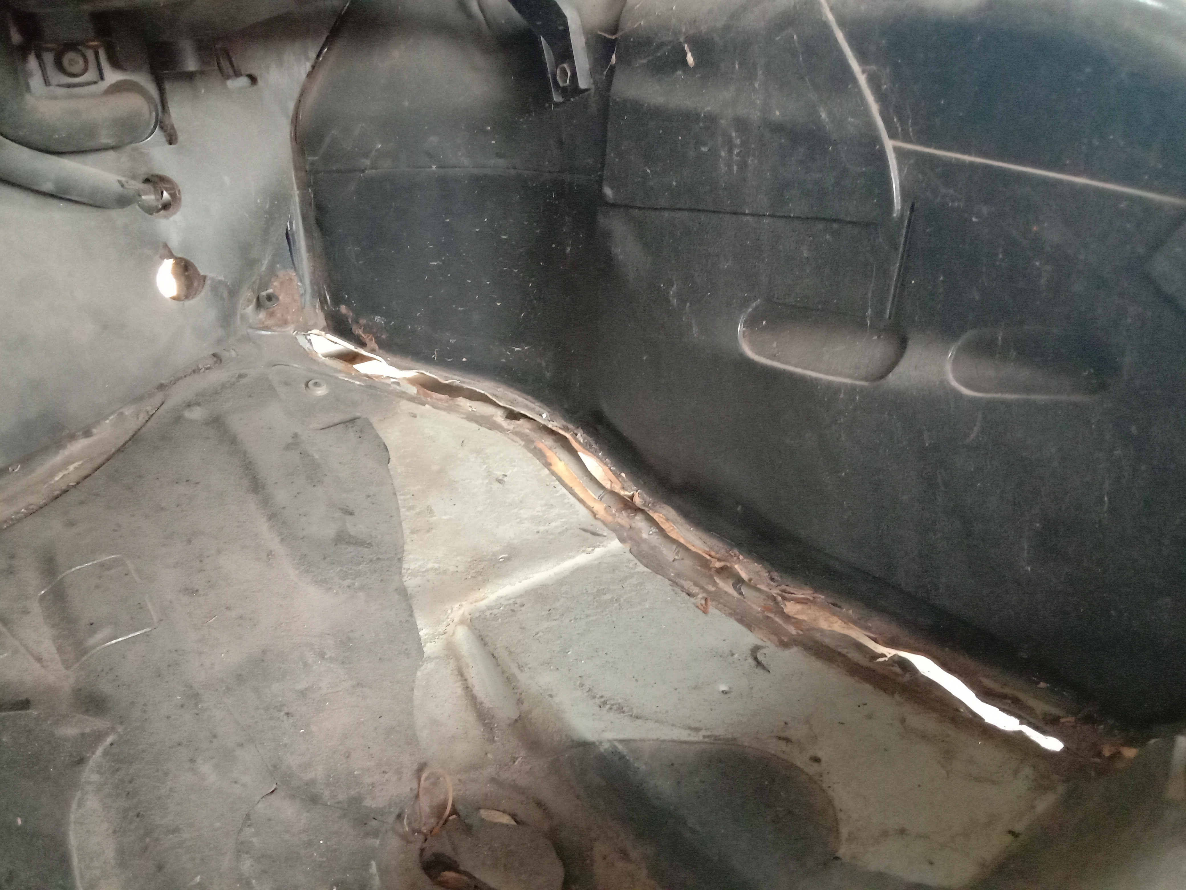

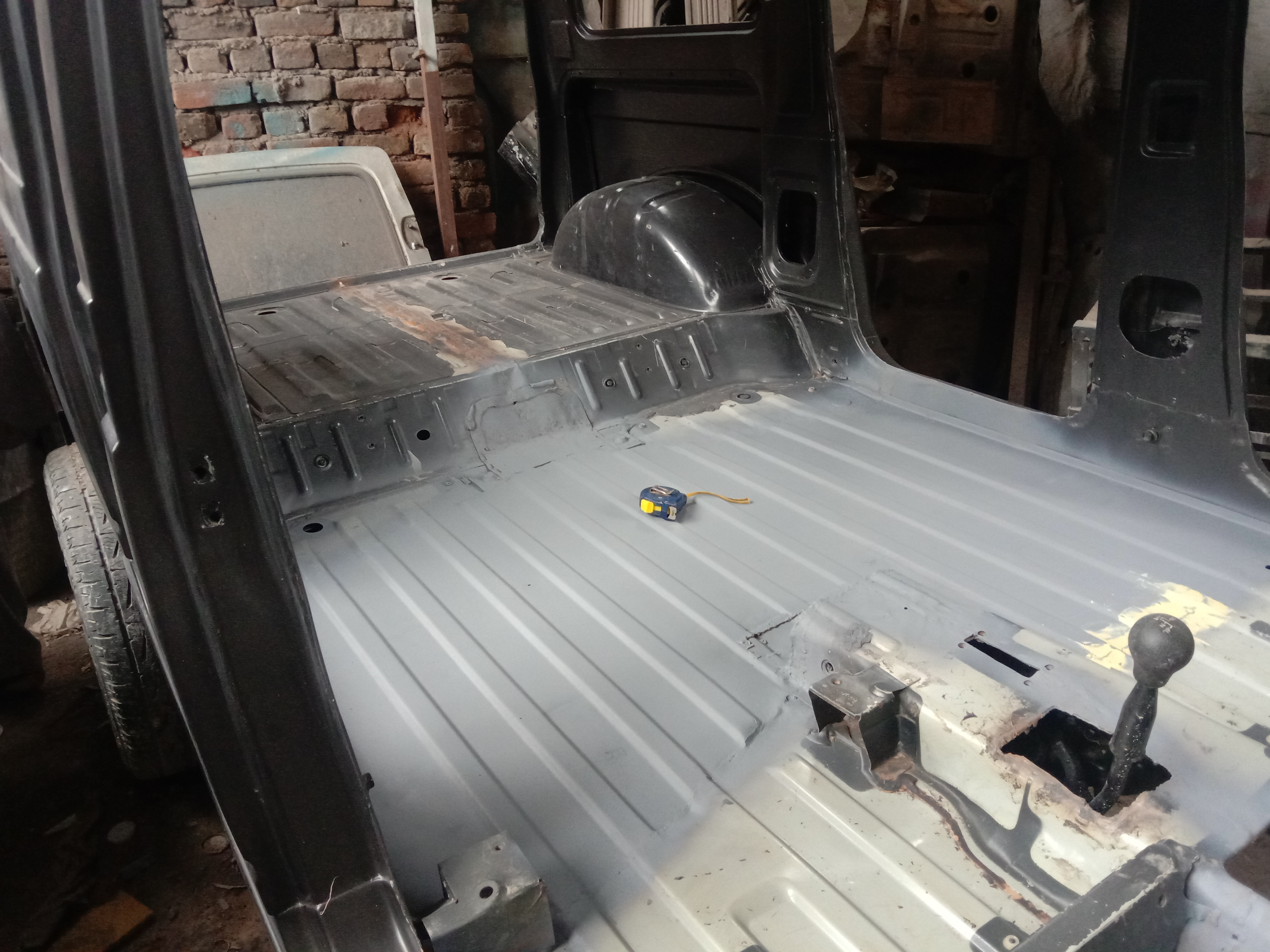

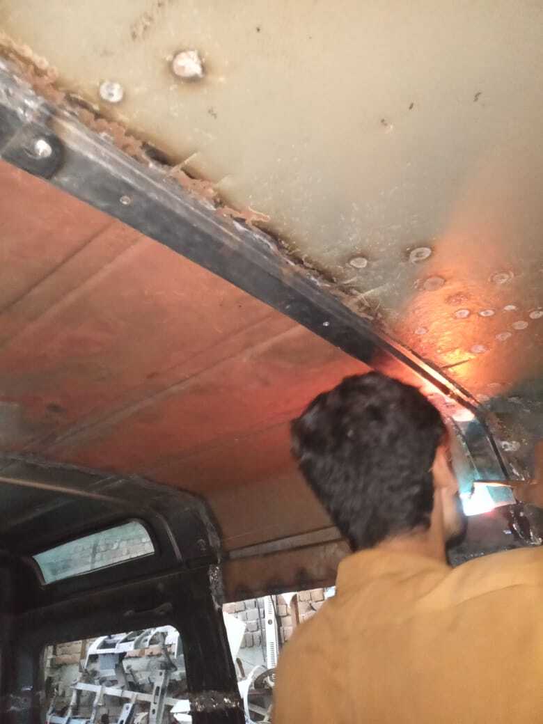

Rubber coating under the floor in progress

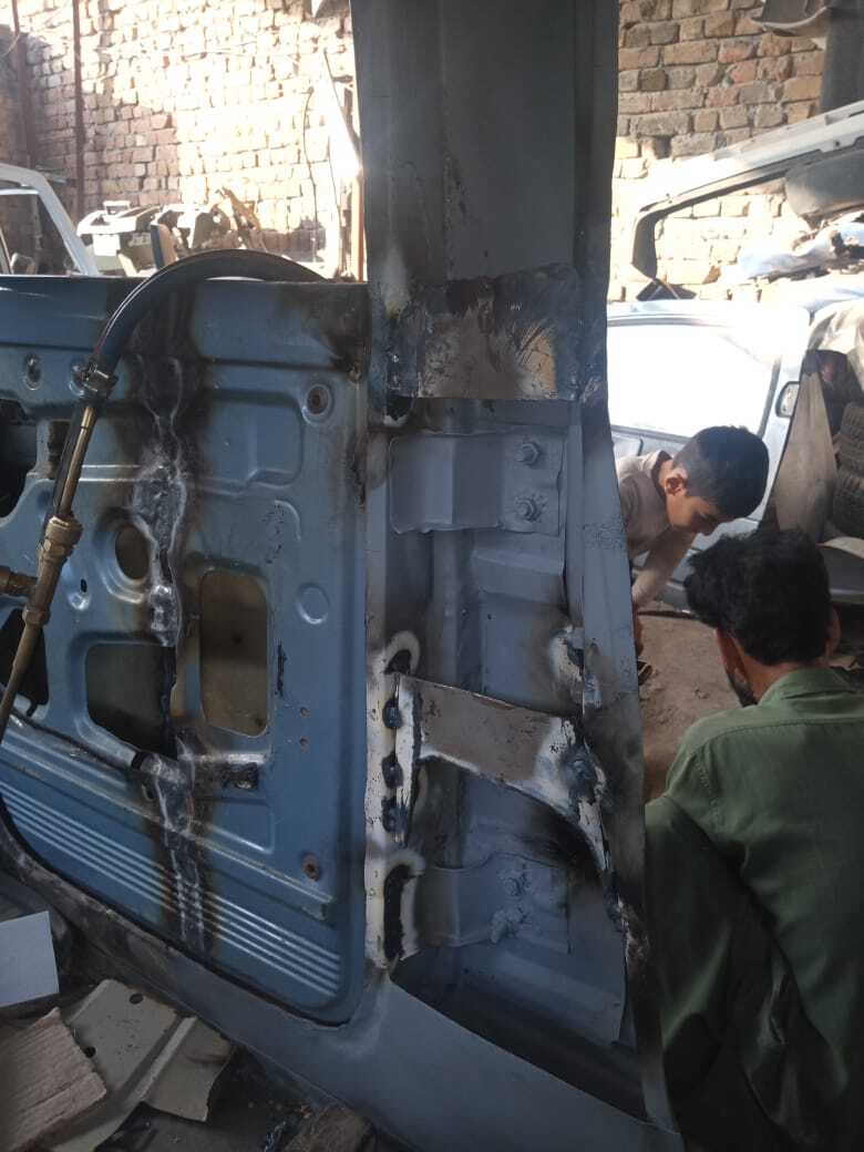

i would suggest to use 'Rustoleum" anti rust primer over all welding & surgical implant joints. coat all such points / spots generously before any other protective coat is applied.

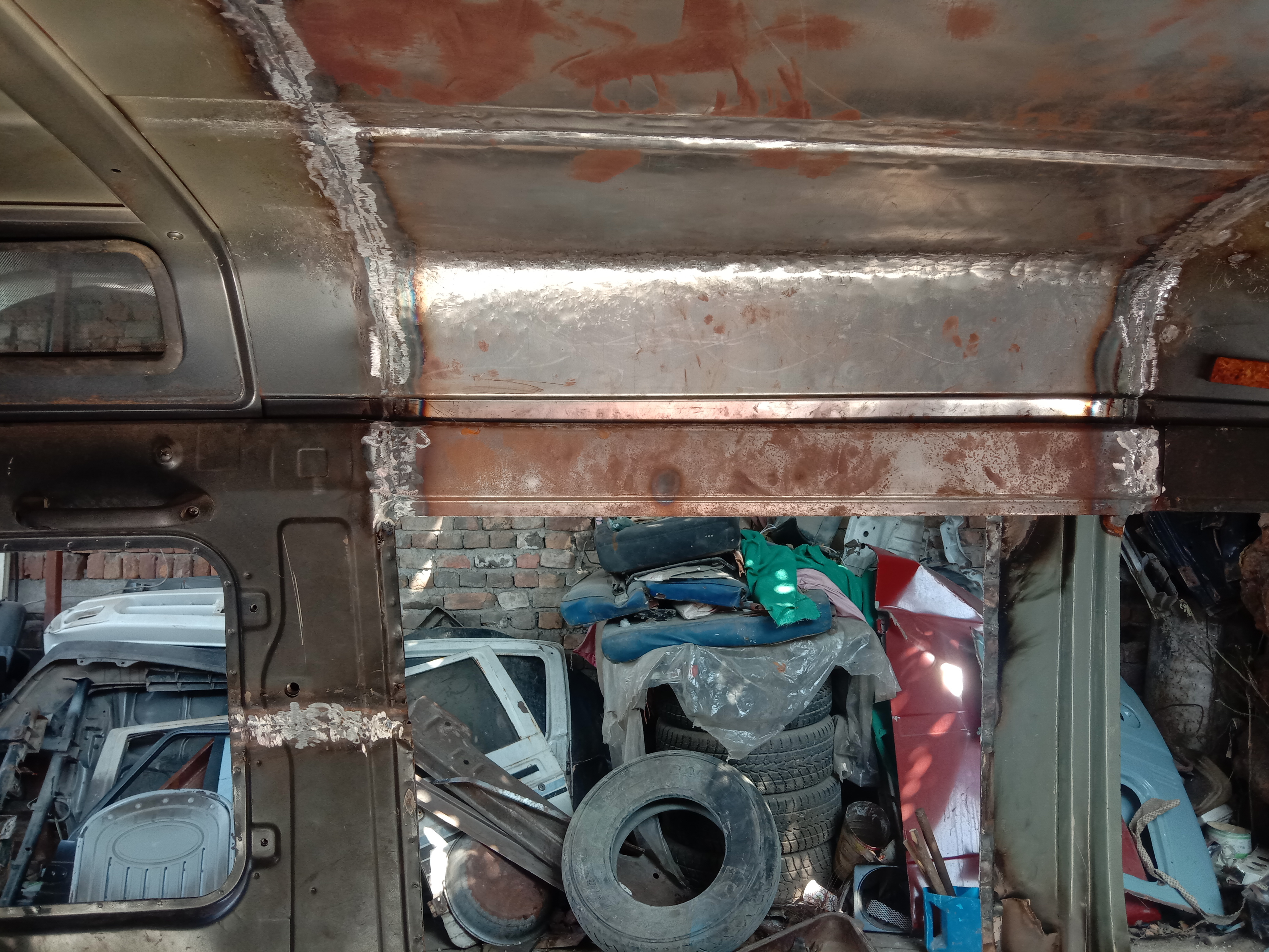

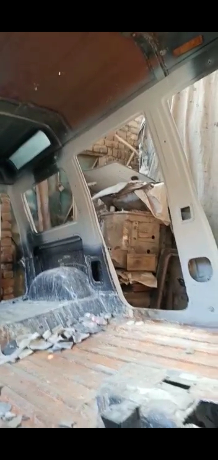

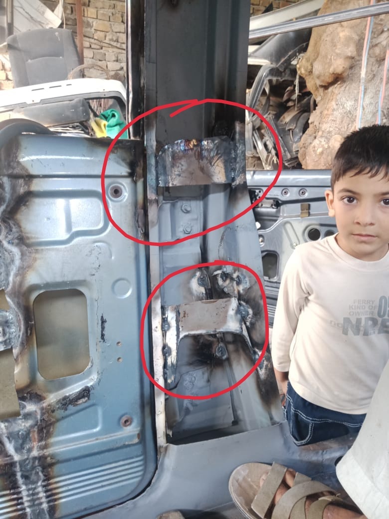

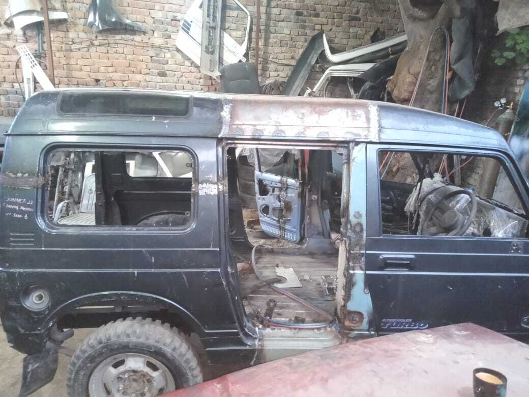

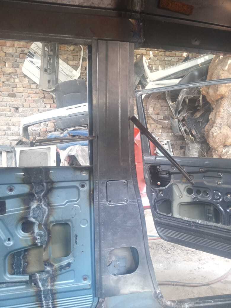

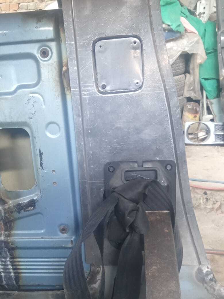

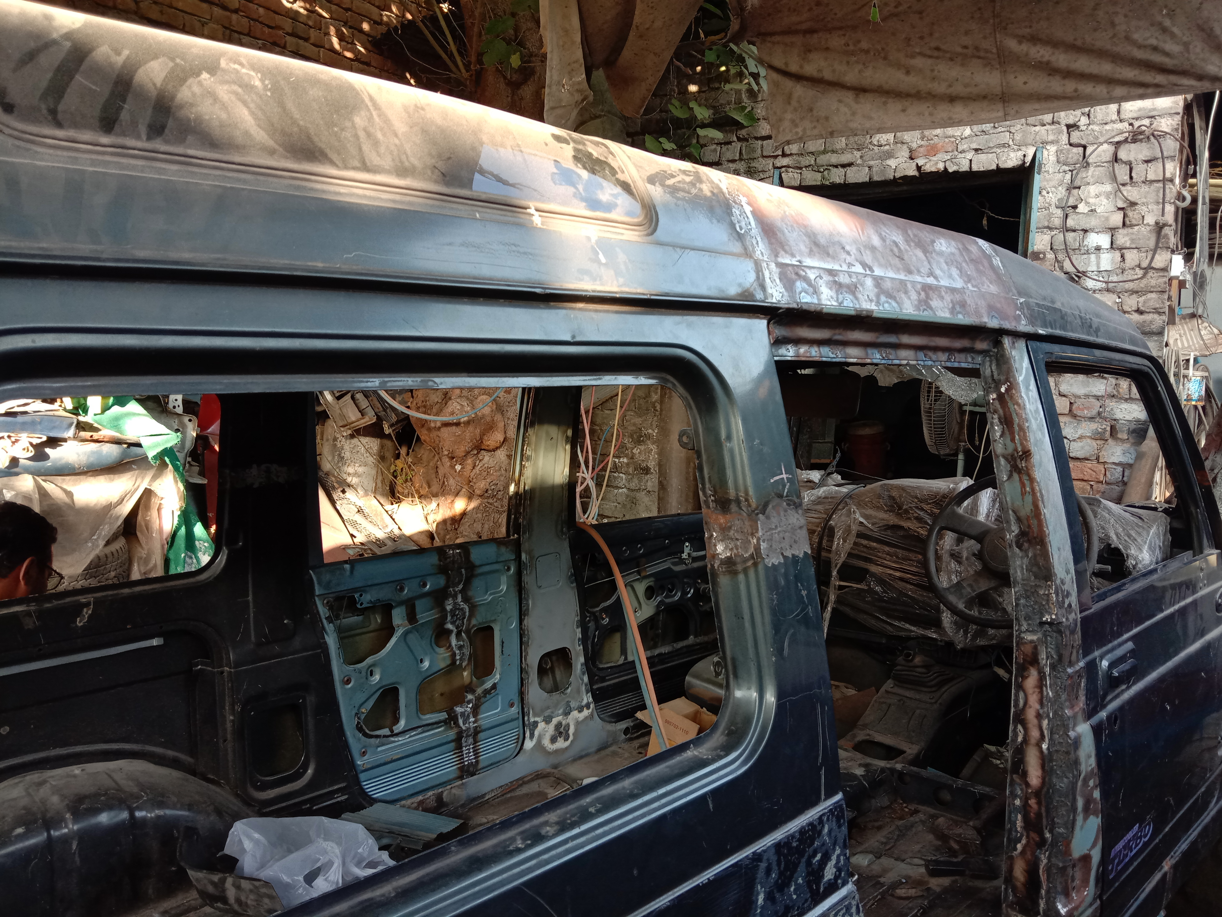

The rear pillor

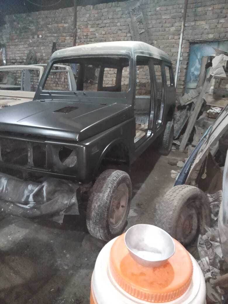

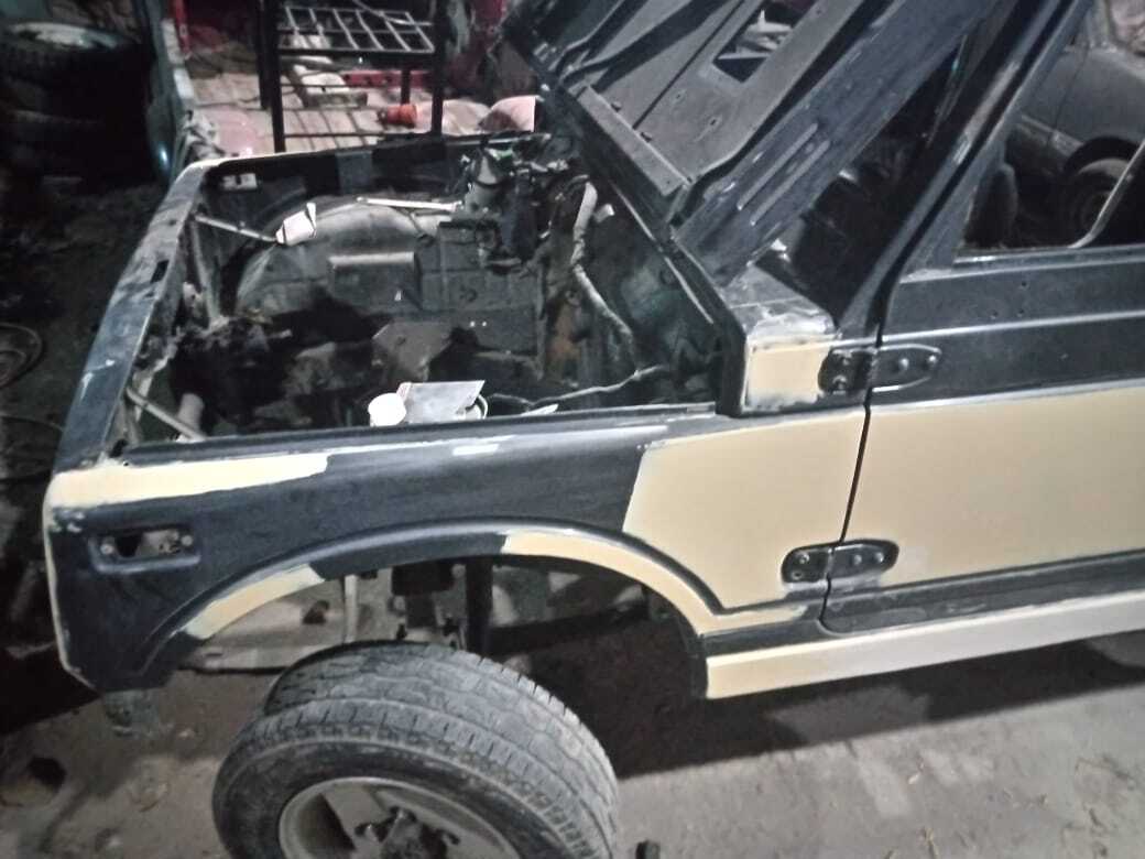

Astar applied

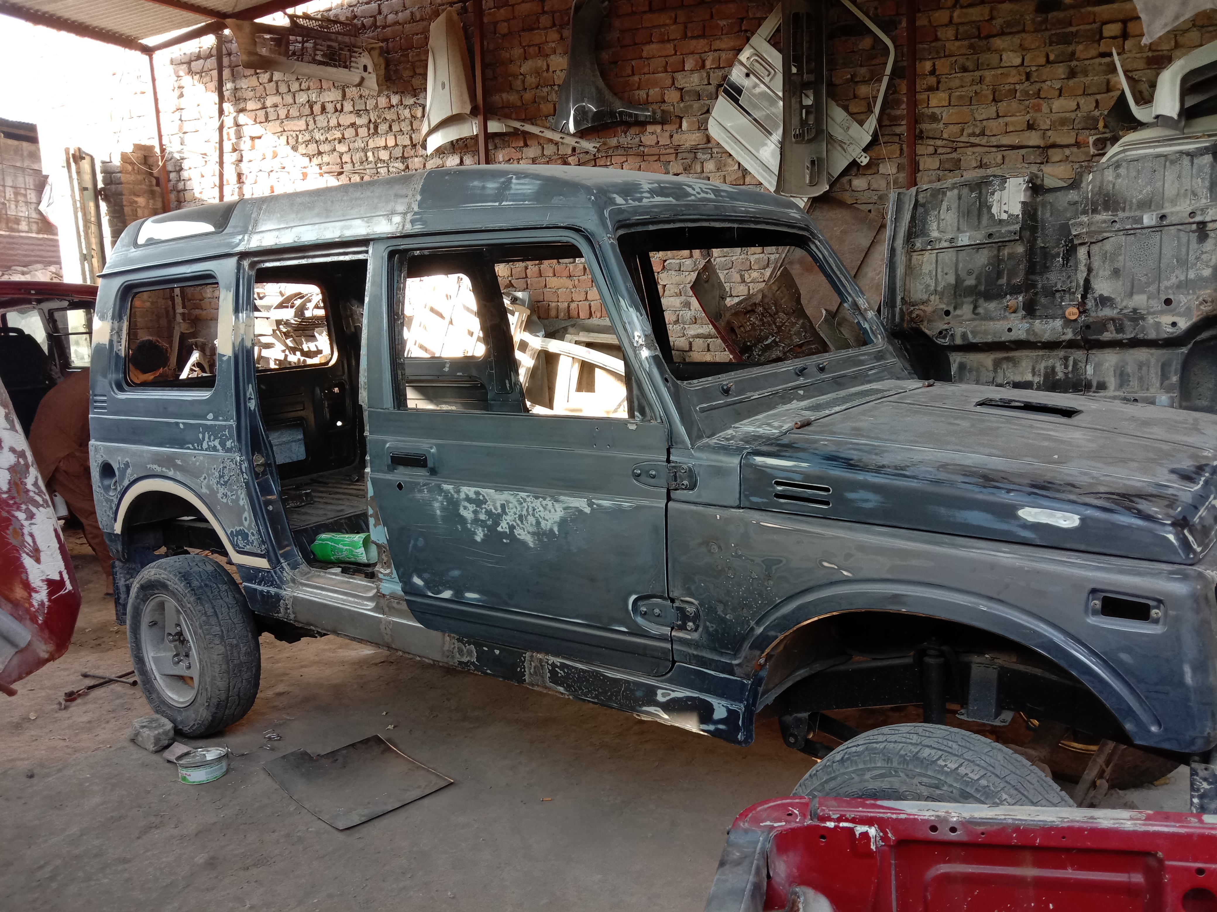

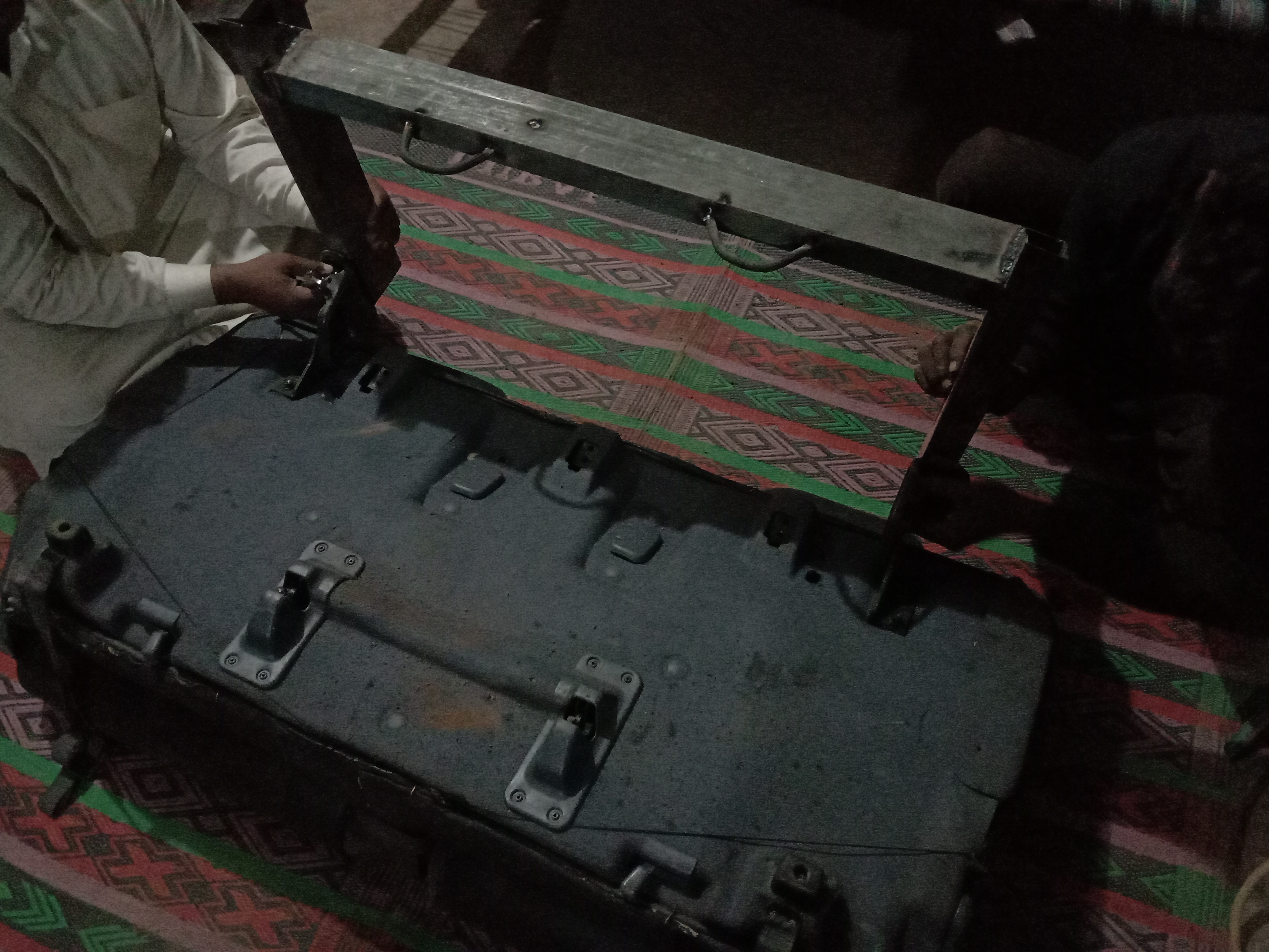

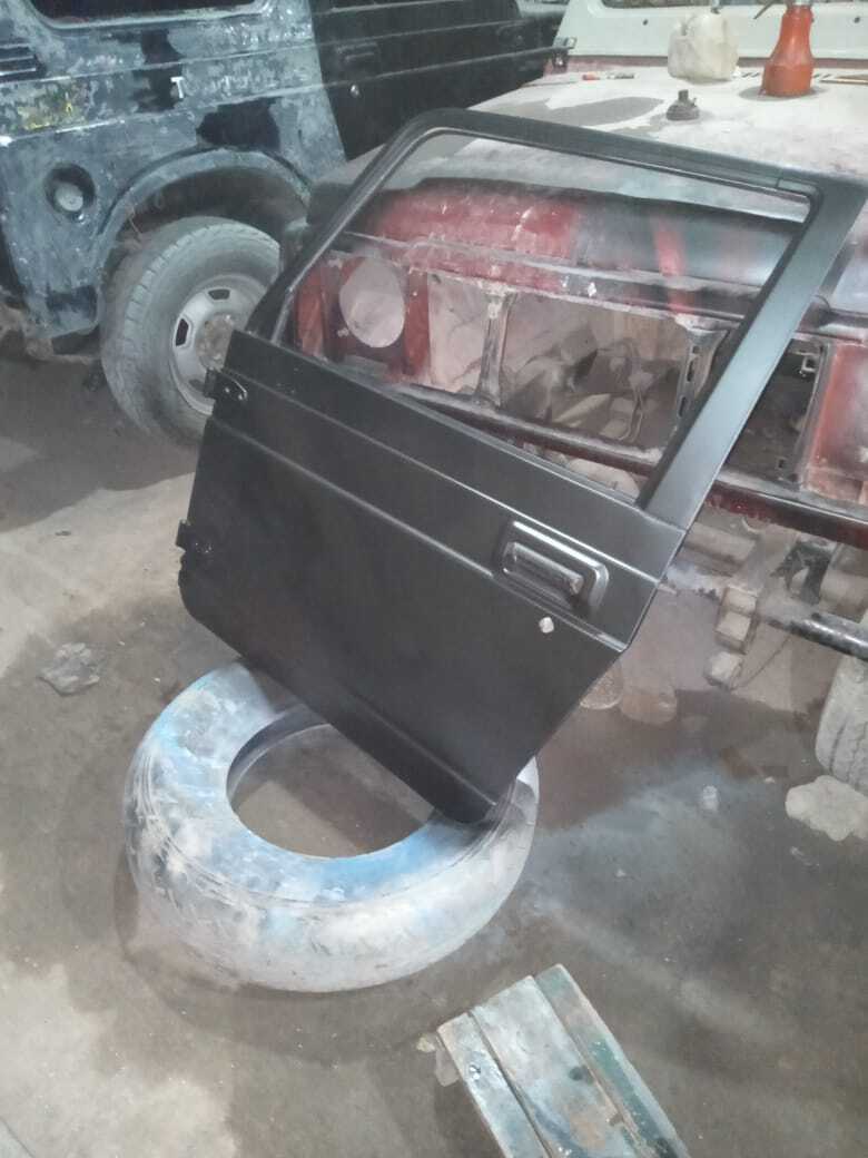

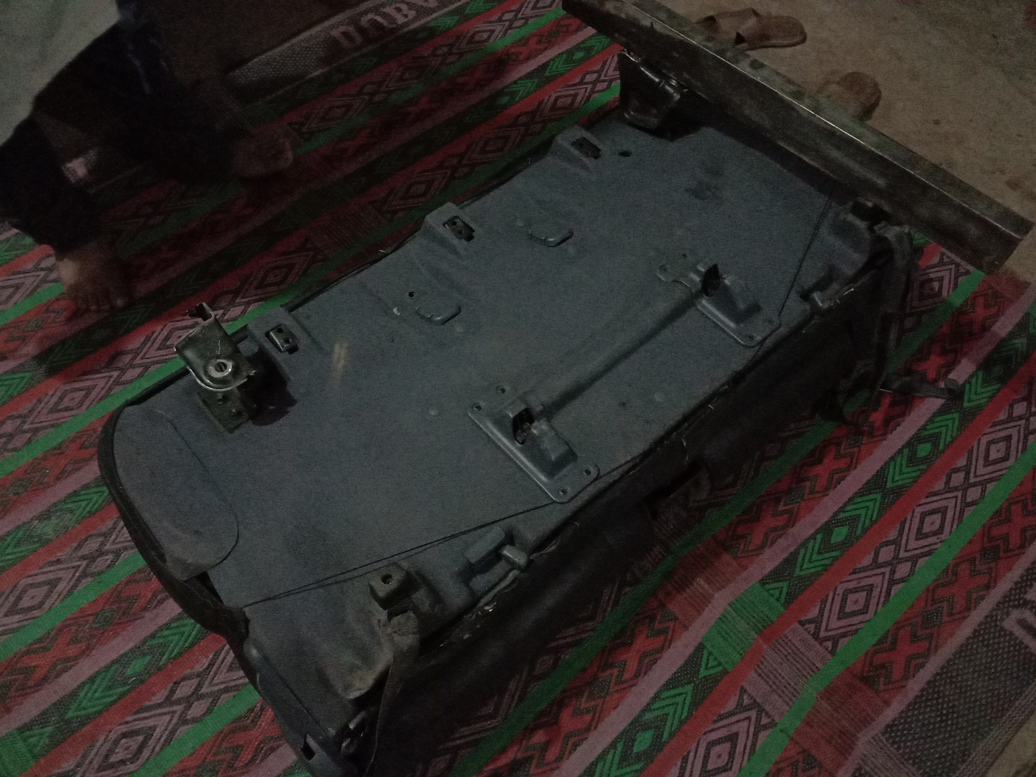

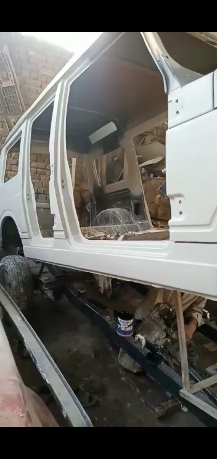

Making base of the rear seat of my 4 door jimny.

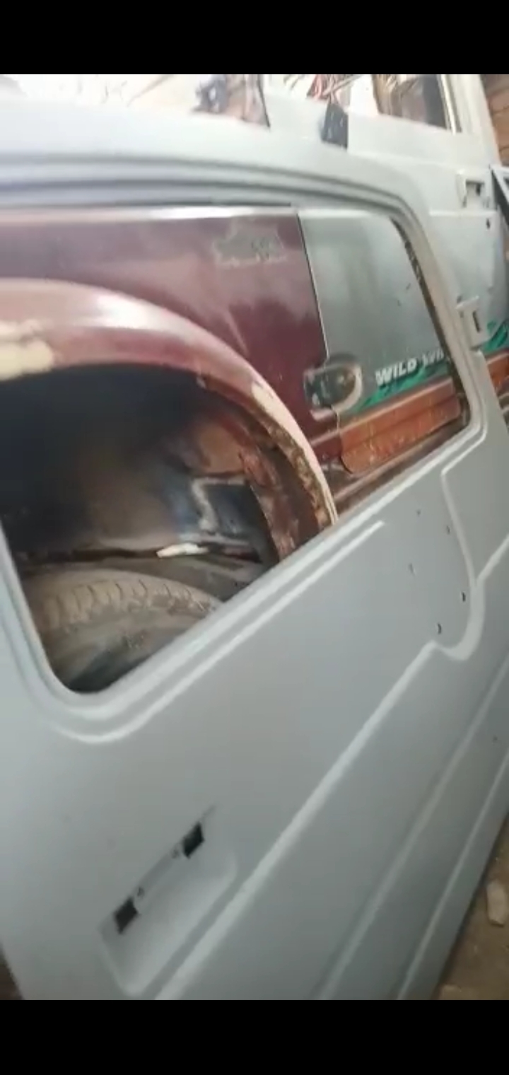

Covering before paint done
