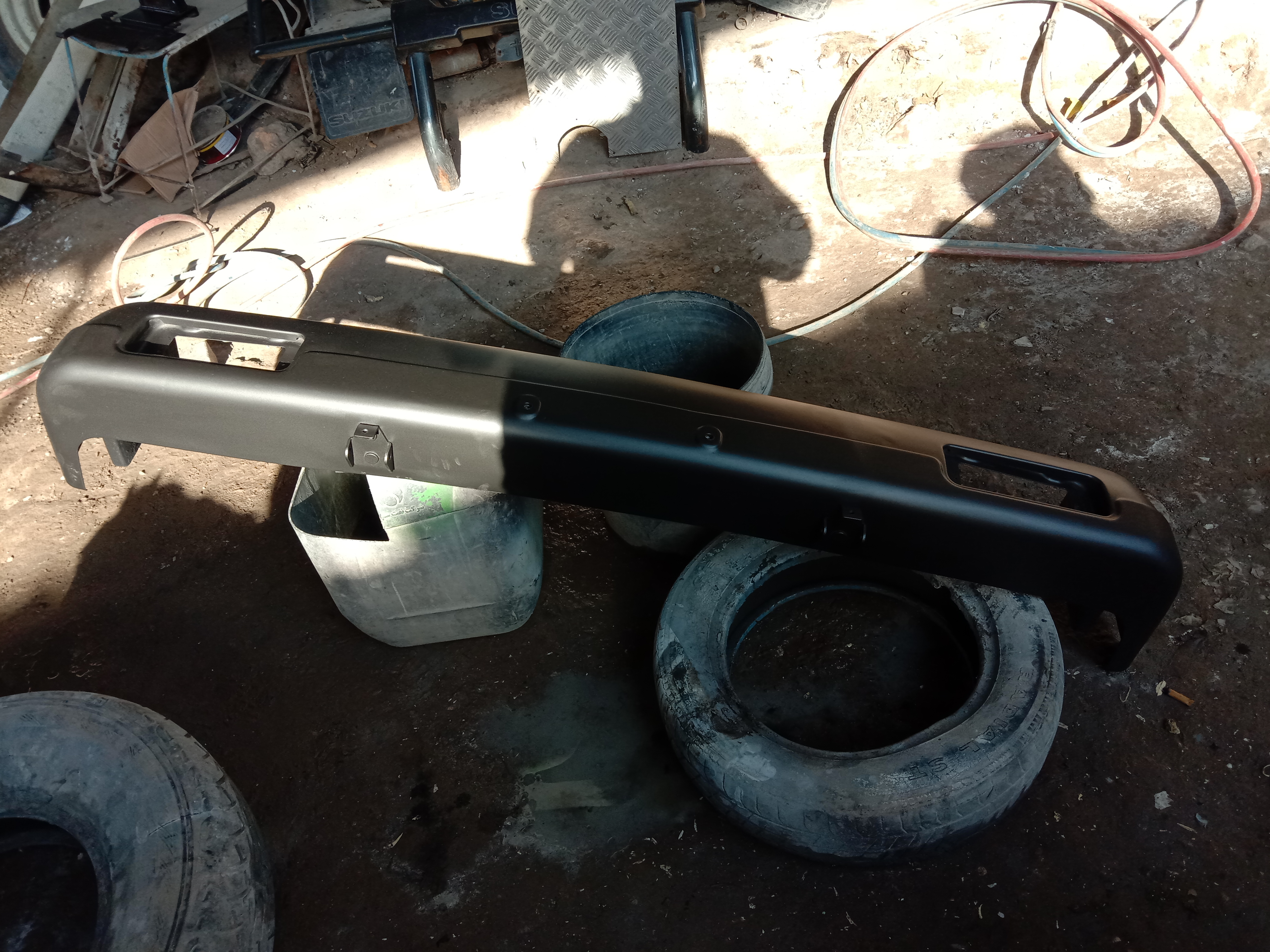

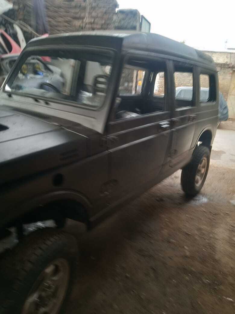

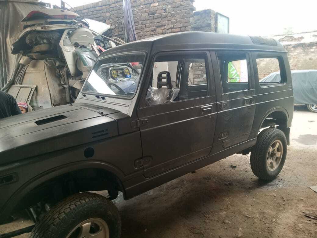

Before the final coat
Have u left it this high intentionally?
This is coming out really nicely Mashallah.
Yes. The long wheel base demands more grpund clearance. Did the spring over axle. After fitting seats and accessories, the height will be lowered a bit.

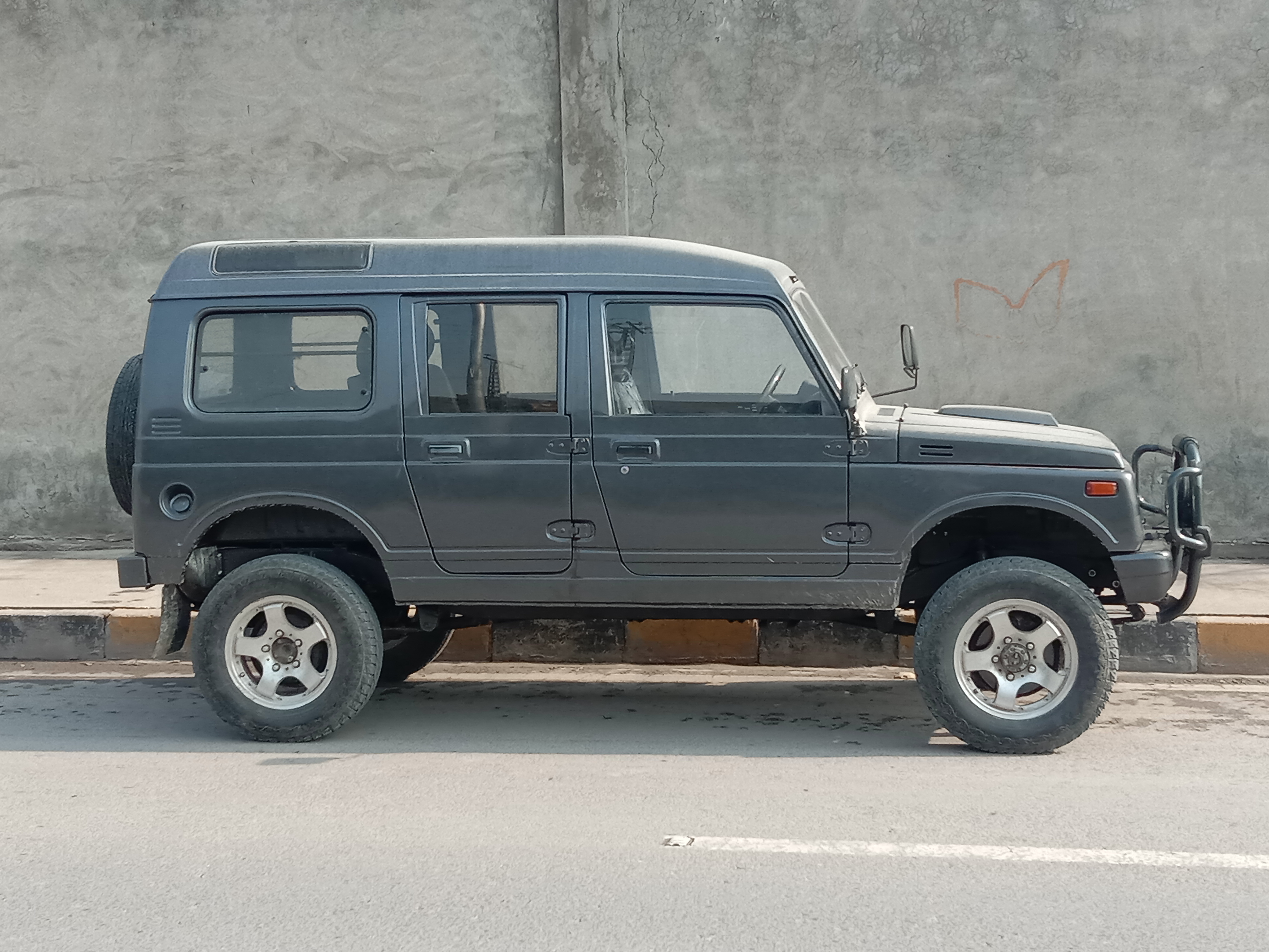

The final touchups

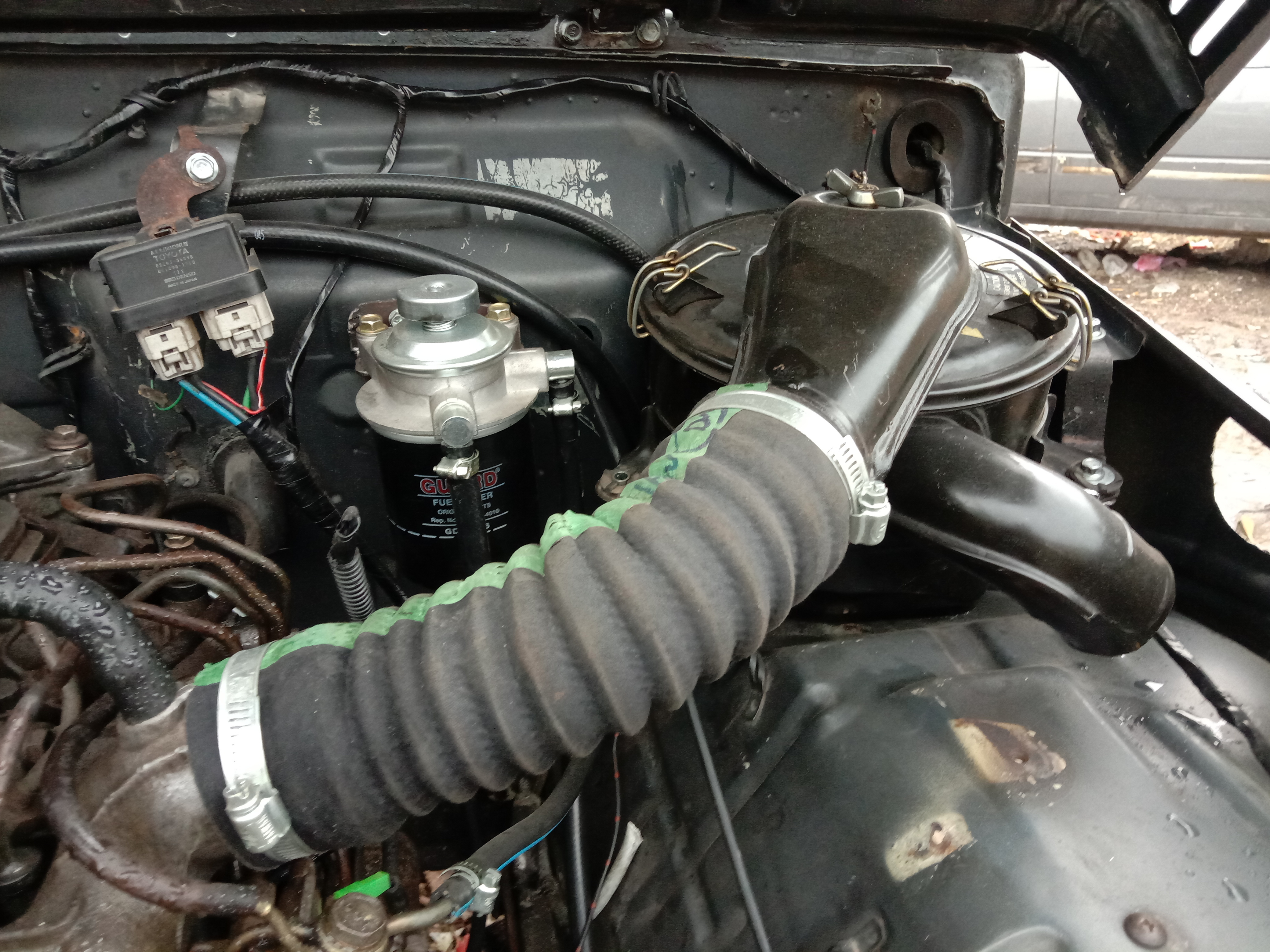

Noman bhai what is the difference of weigh between stock engine and 2C Turbo, I mean how are you planning to deal with "nose heavy" problem in mud?
Big difference. Petrols r better in sand and mud but the extra power of diesels halp in coming out of the problem area. Overall reliability wise i had to take this decision.

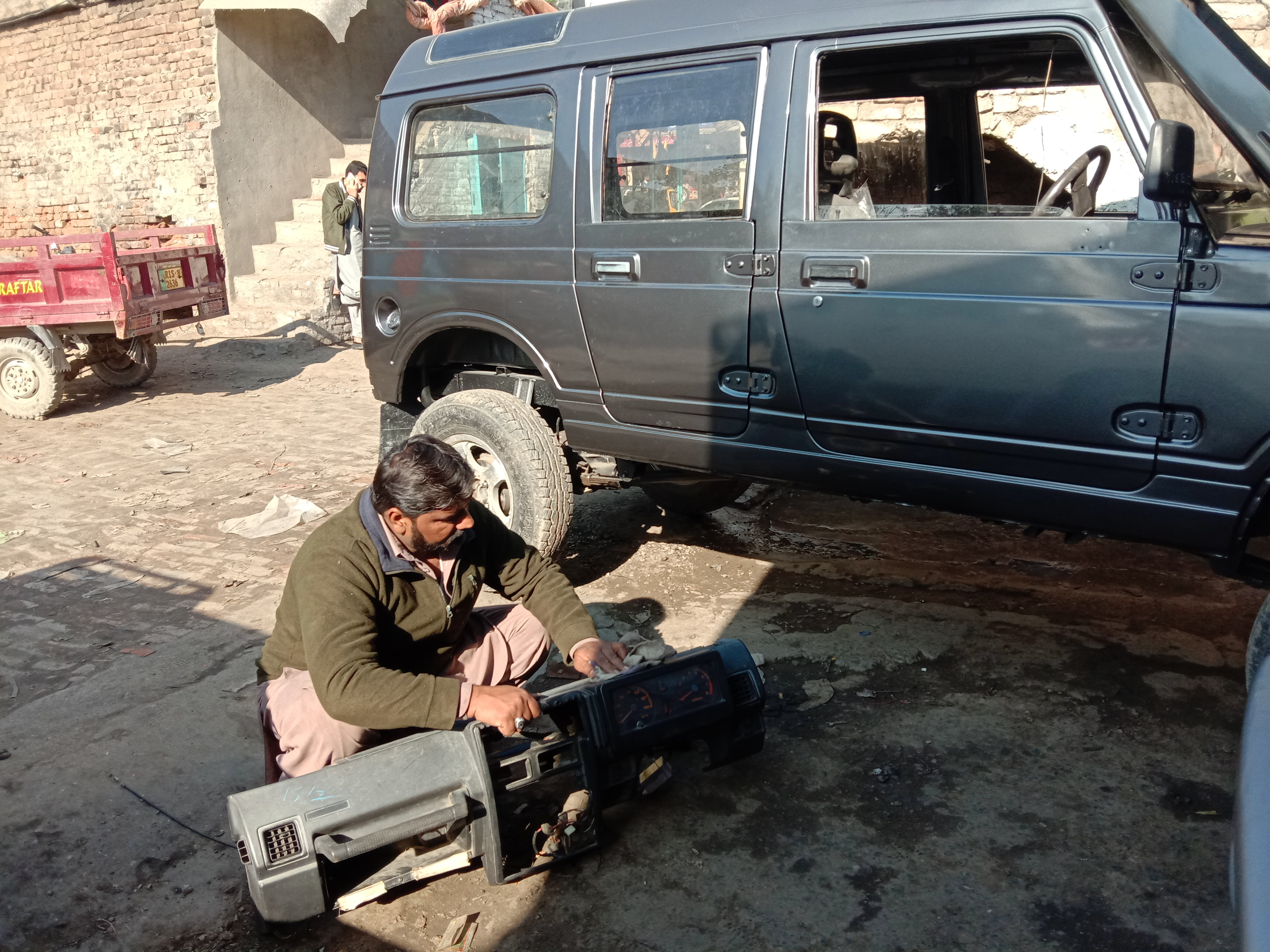

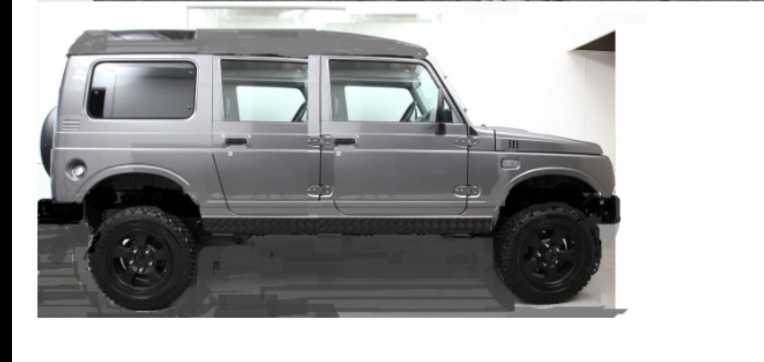

My photoshopped sketch on laptop and the final product.

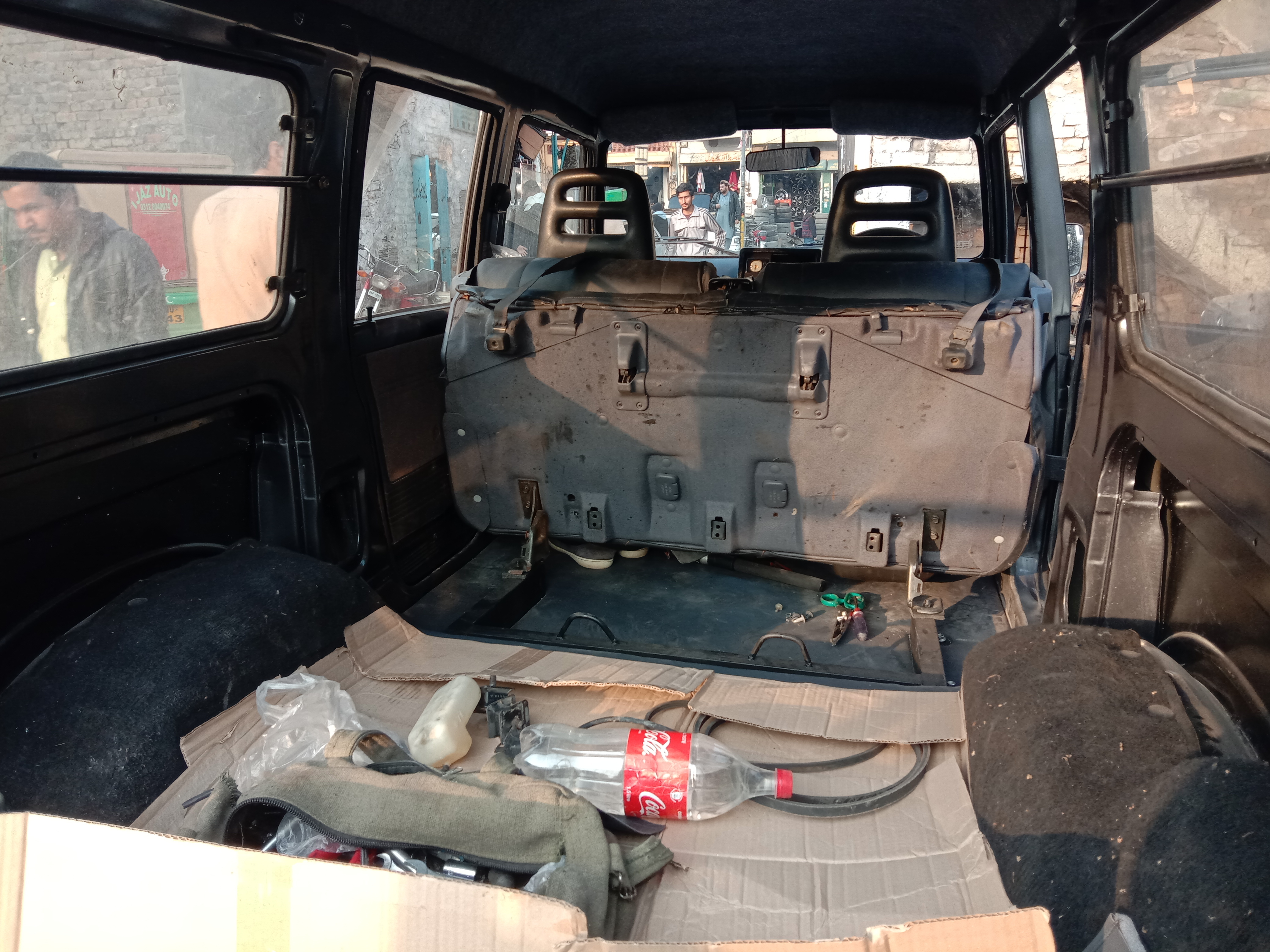

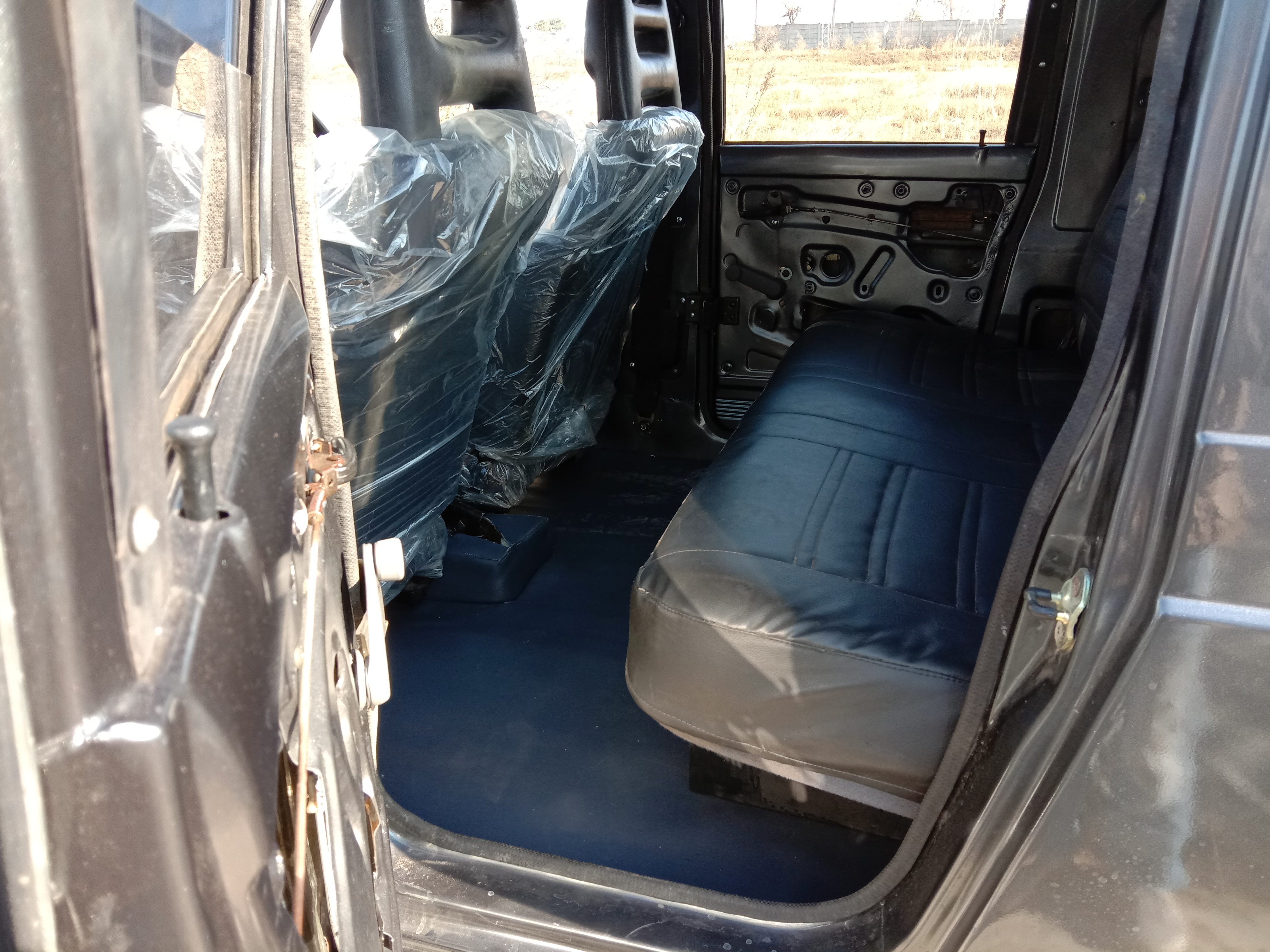

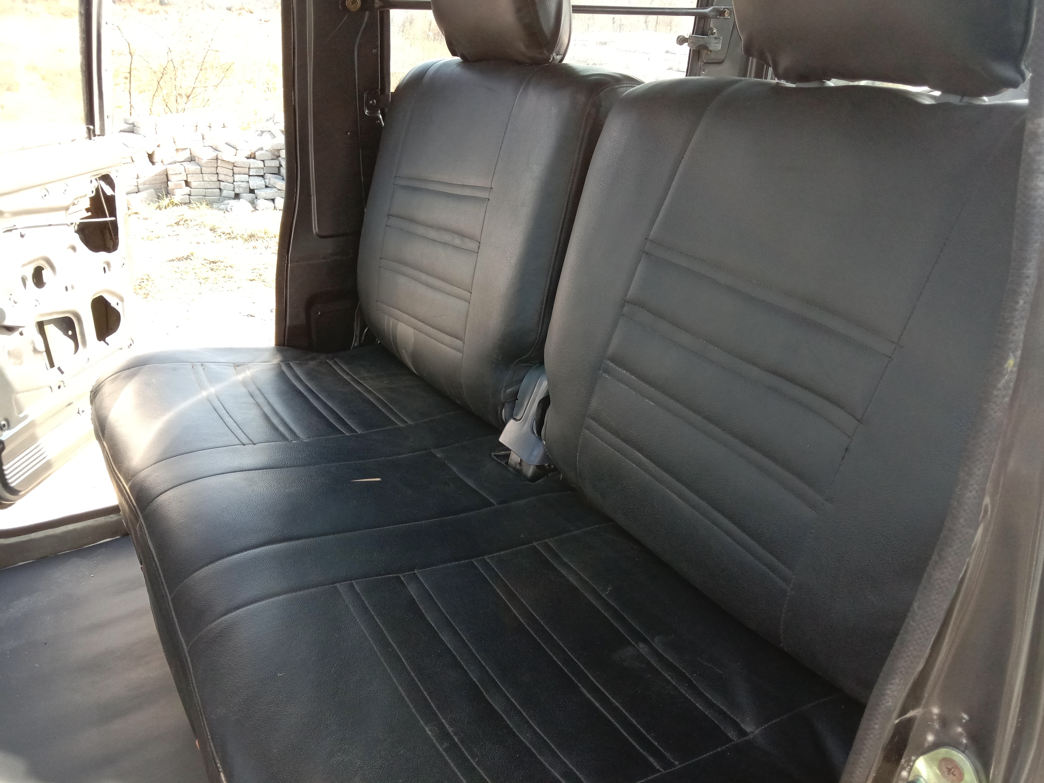

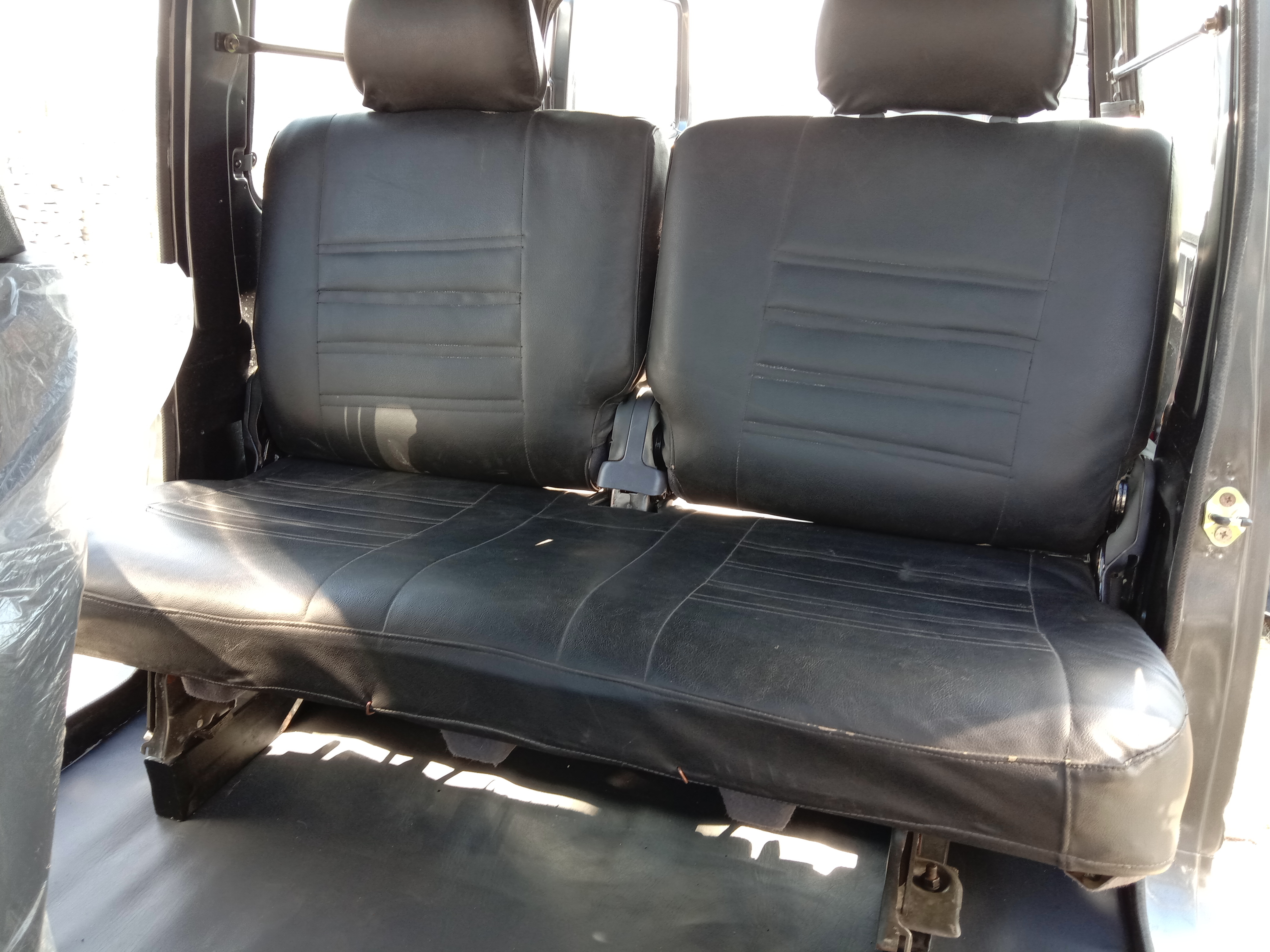

Perfect, can you please share the pictures of interior, cabin, seating etc as well if its ready.

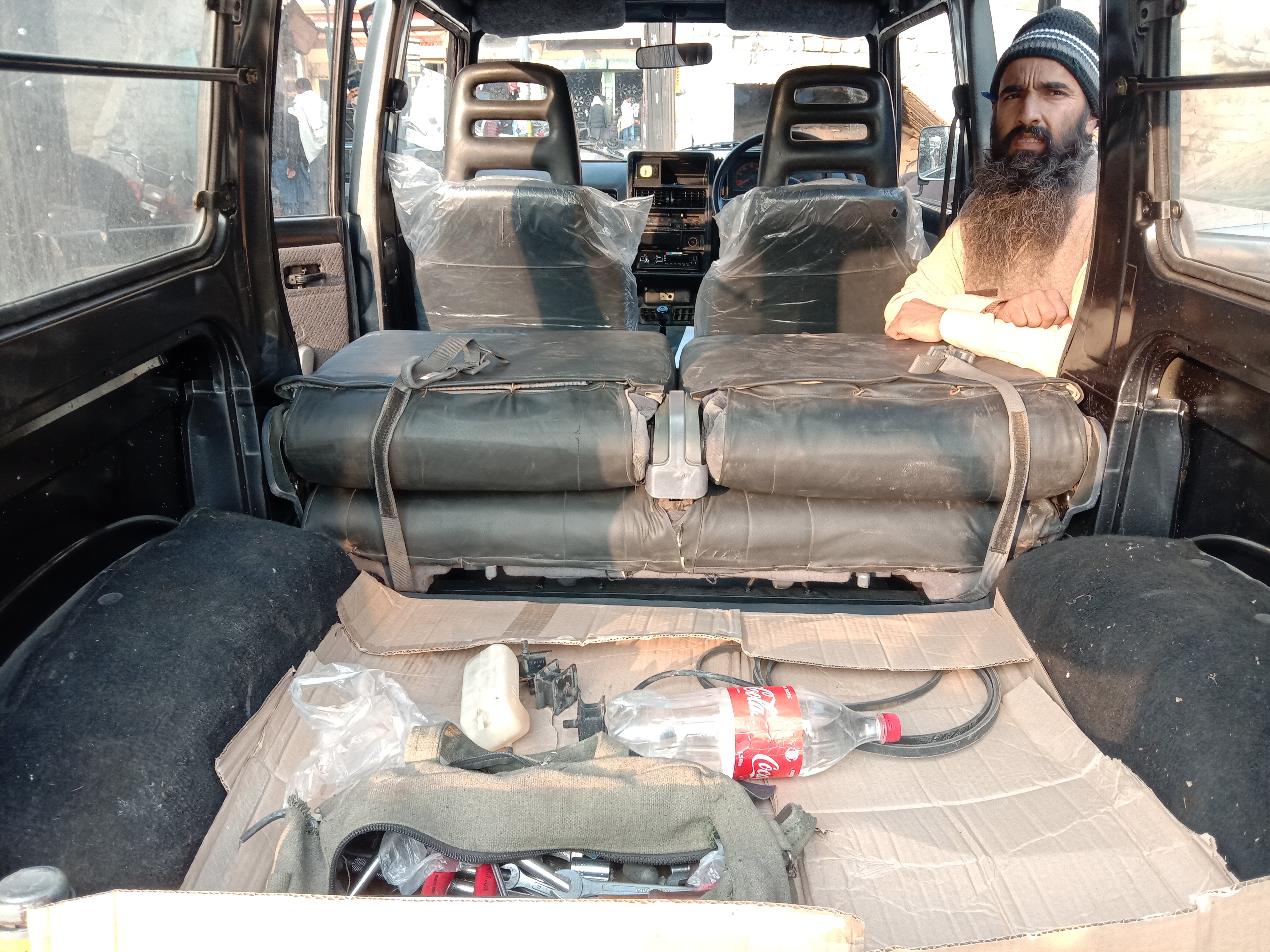

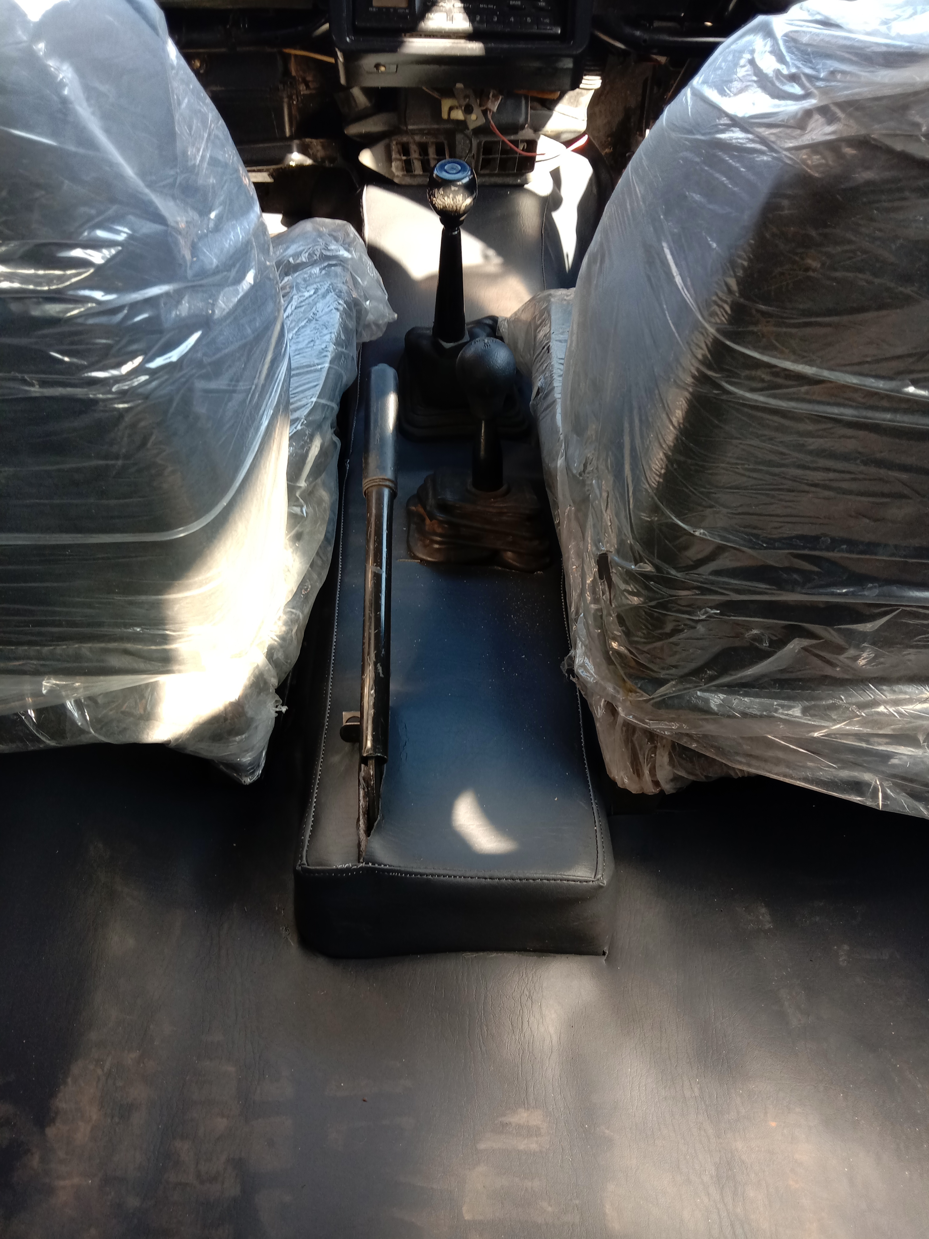

Perfect, so you managed to fit the prado seat finally. Noman bhai Its quite obvious that objective of this project was to have a 5 door vehicle and ample space in rear end like Surf. What would be the main usage of this space?
Two front seats facing each other

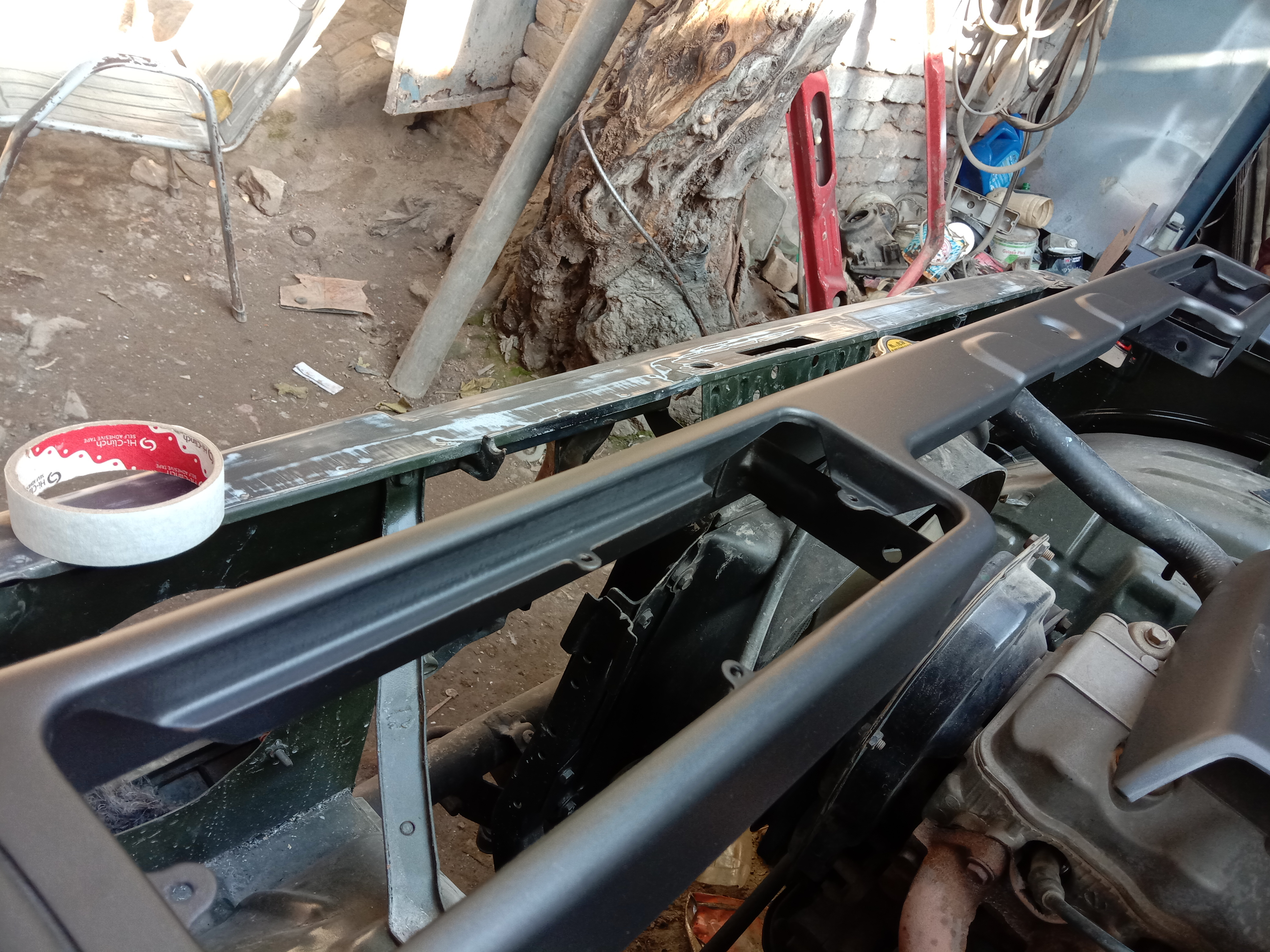

The new front sierra safe guard
