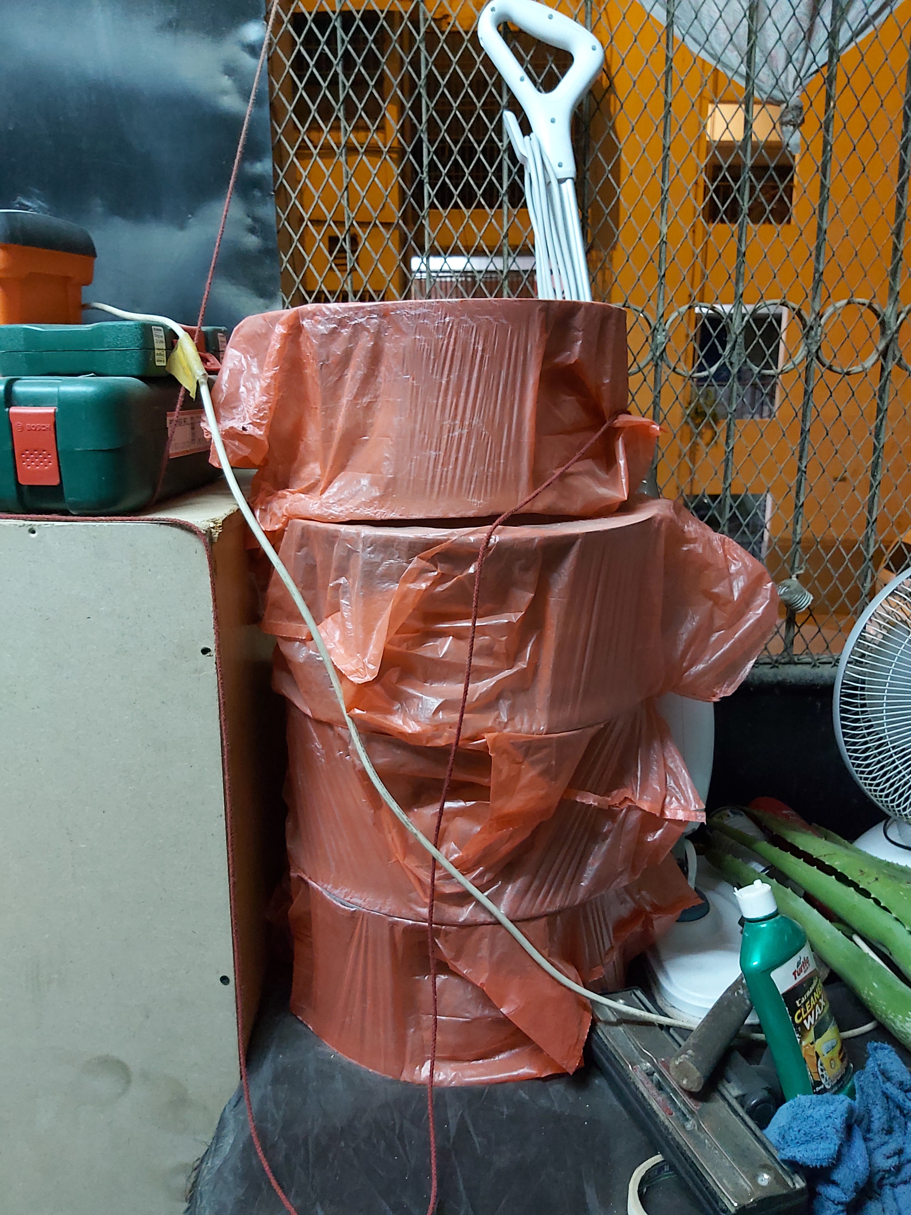

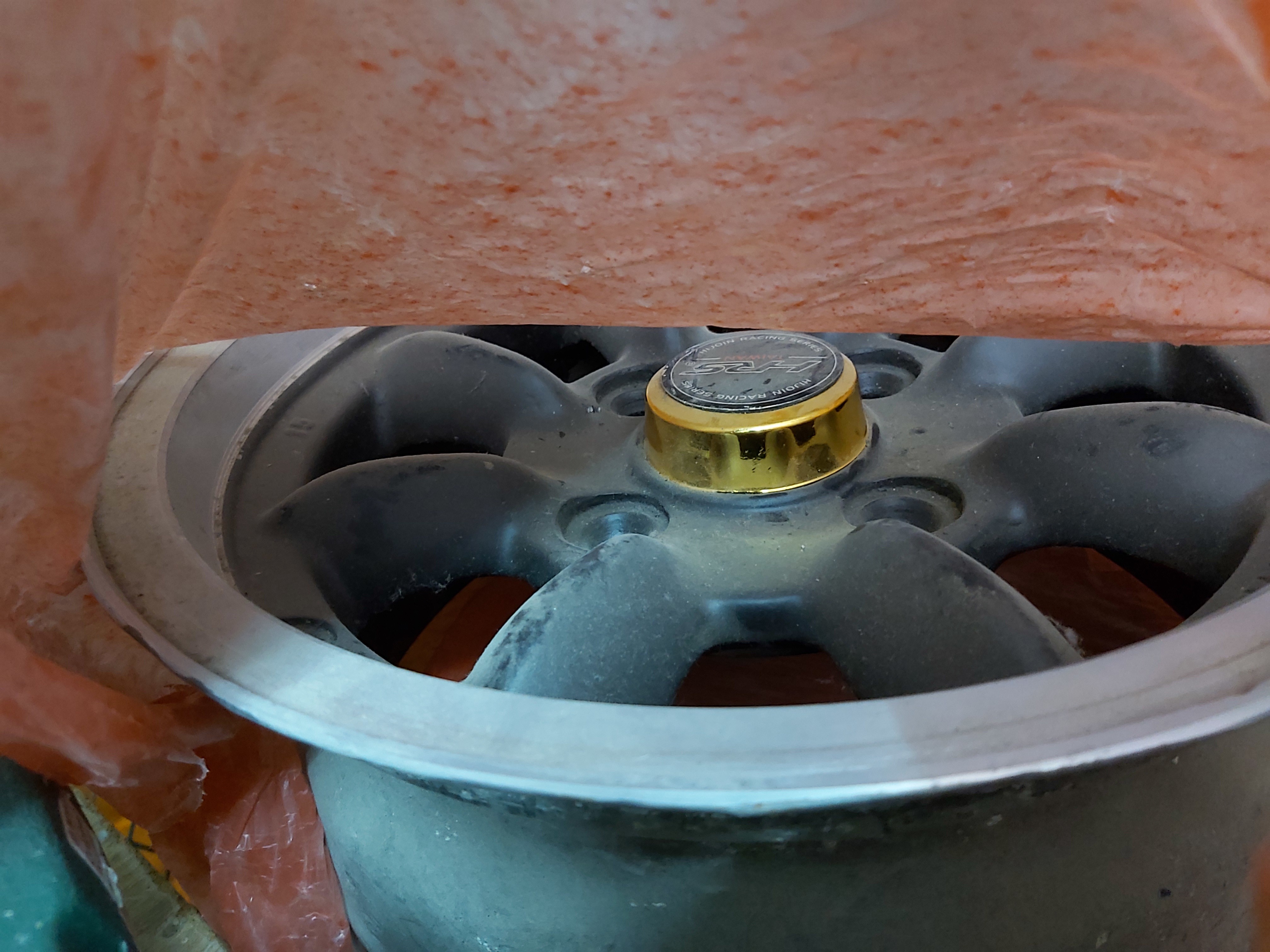

Luckily we got hands on set of 13" rims. Need to get the rims refreshed as I don't like the paint job done by the Rim seller.

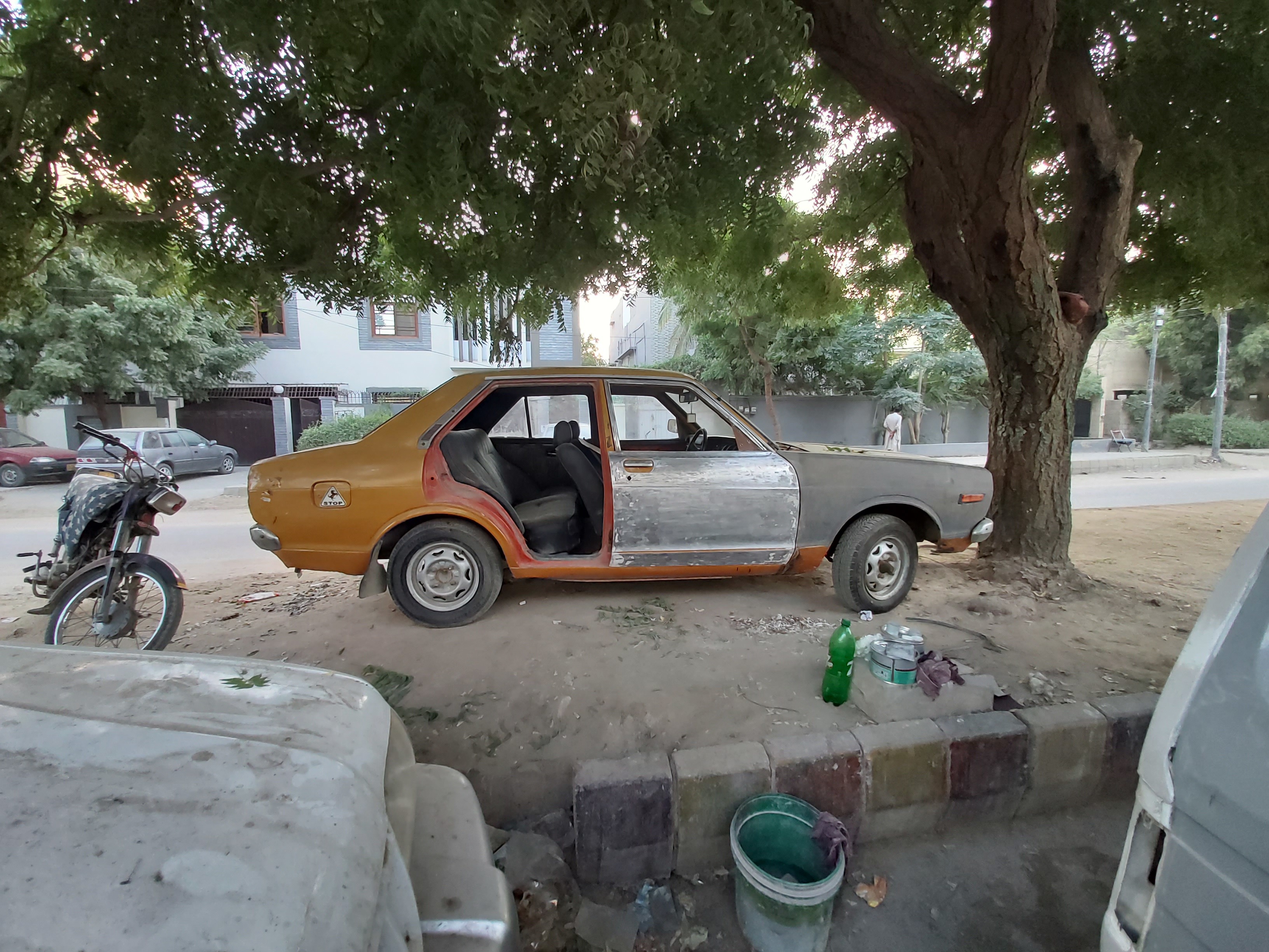

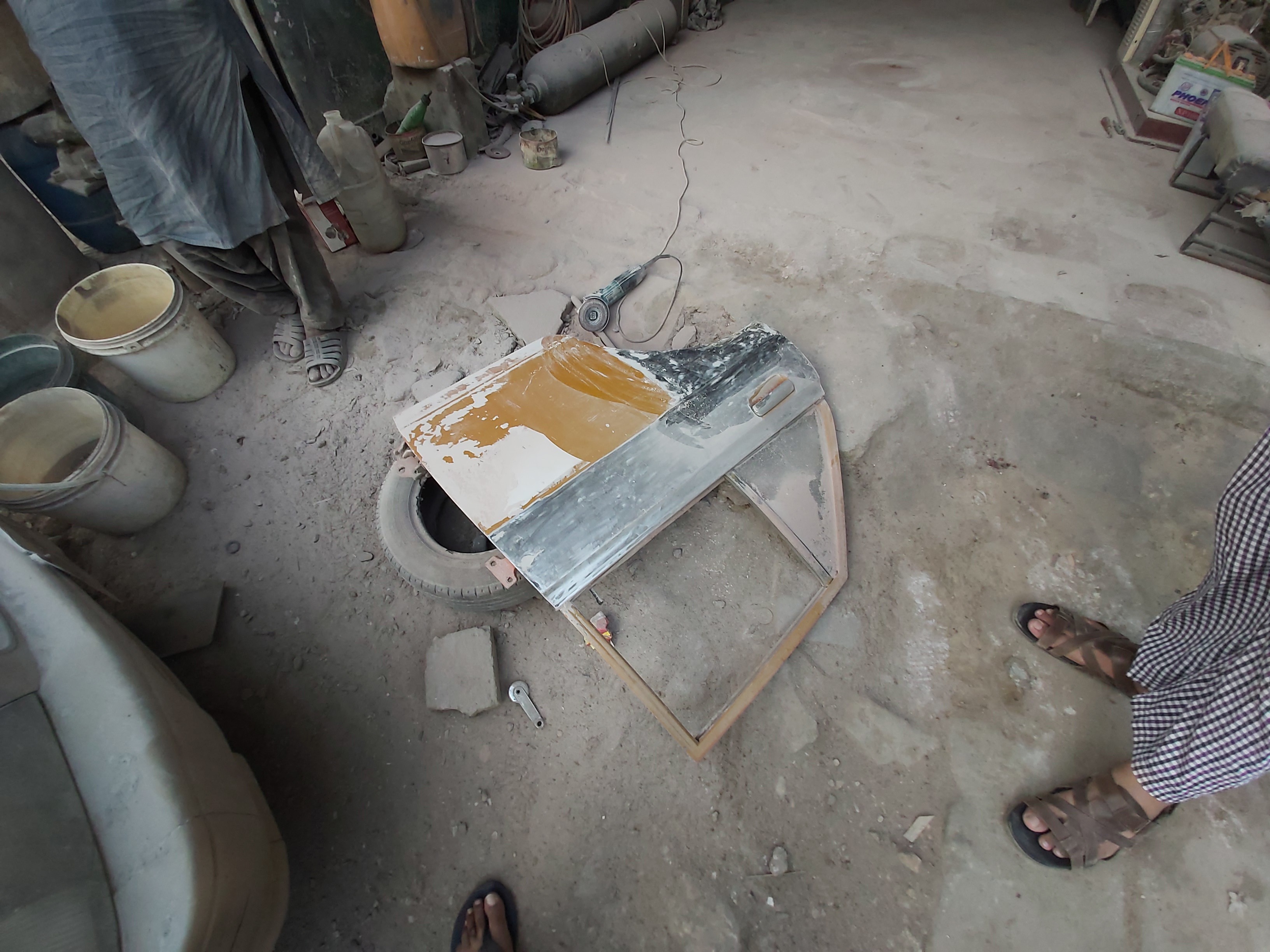

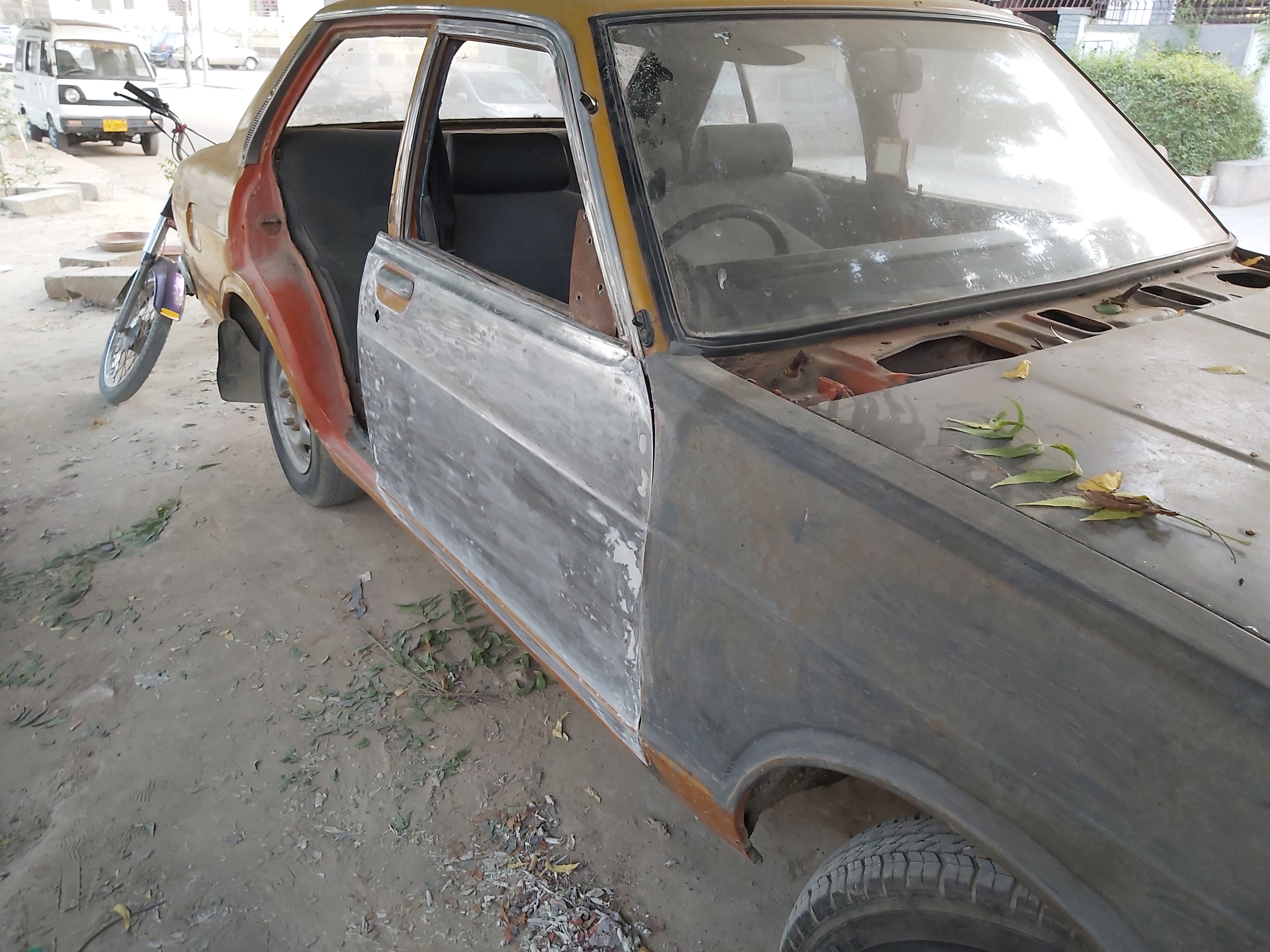

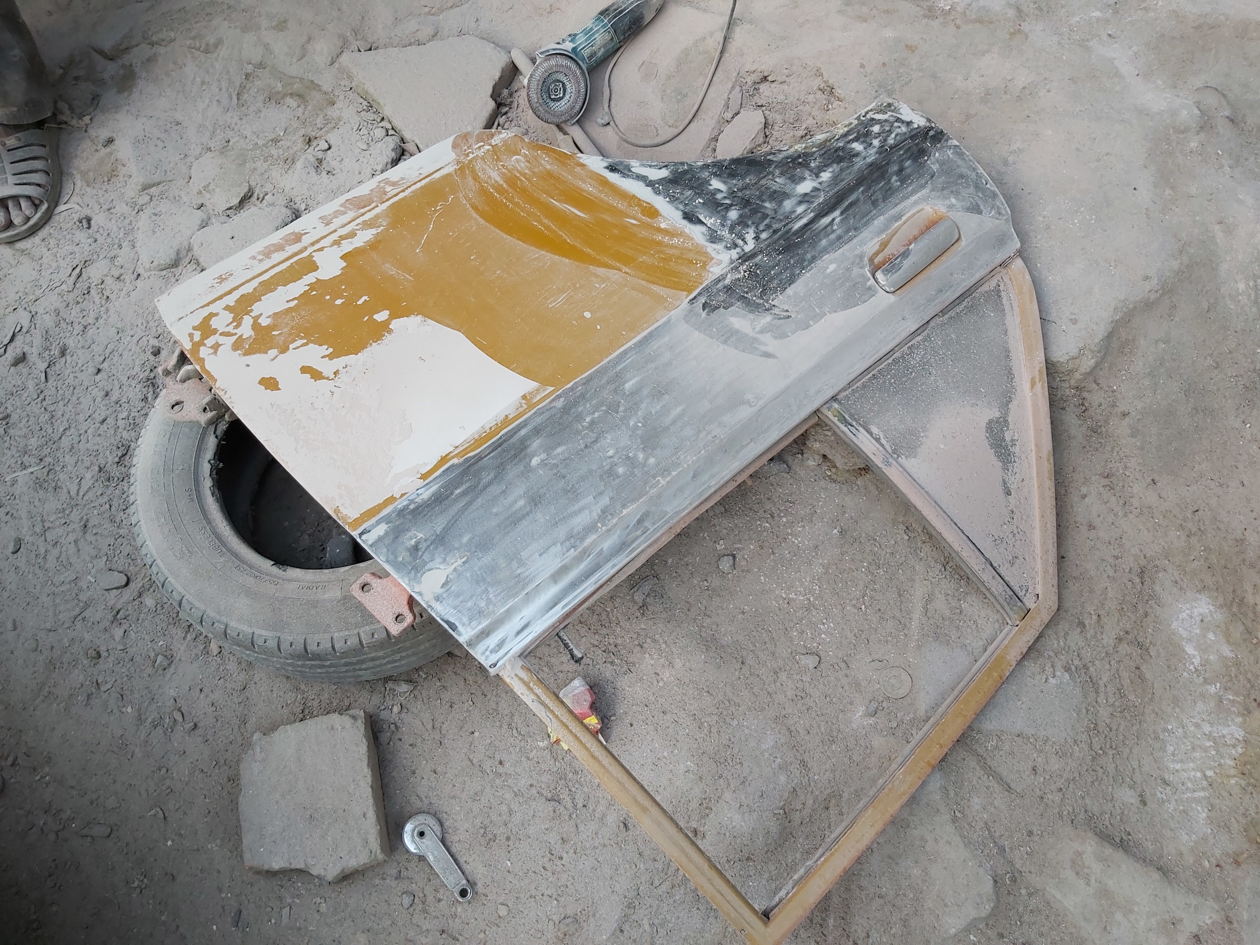

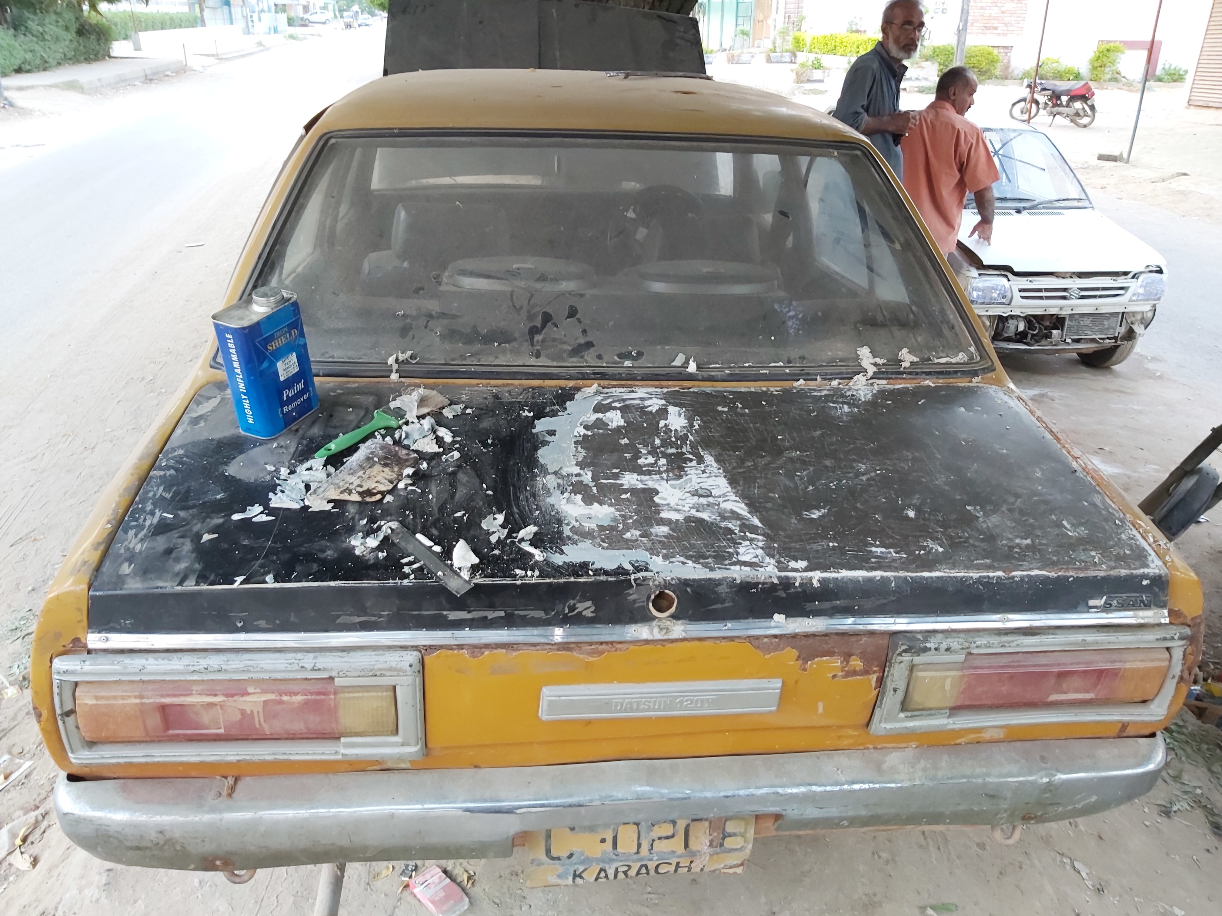

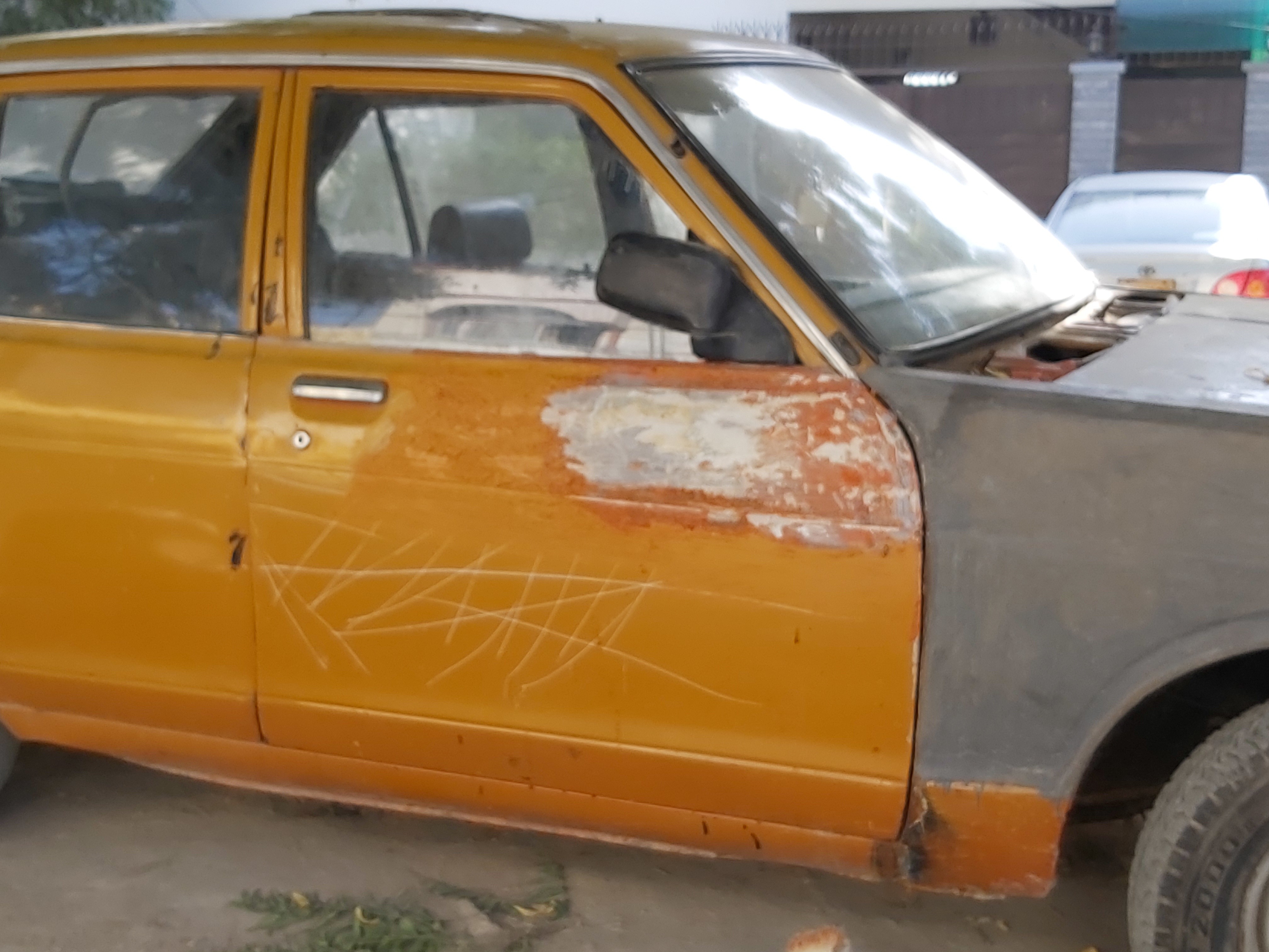

Denter is good and I also clarified him before the job that the car need to be fully scrapped inside out and by using chemical and/or grinder only. The car was painted in a cheap way last time so it was expected that there will be huge quantity of body filler on the body. So first he started with paint remover but later had to move to grinder to get rid of the filler.

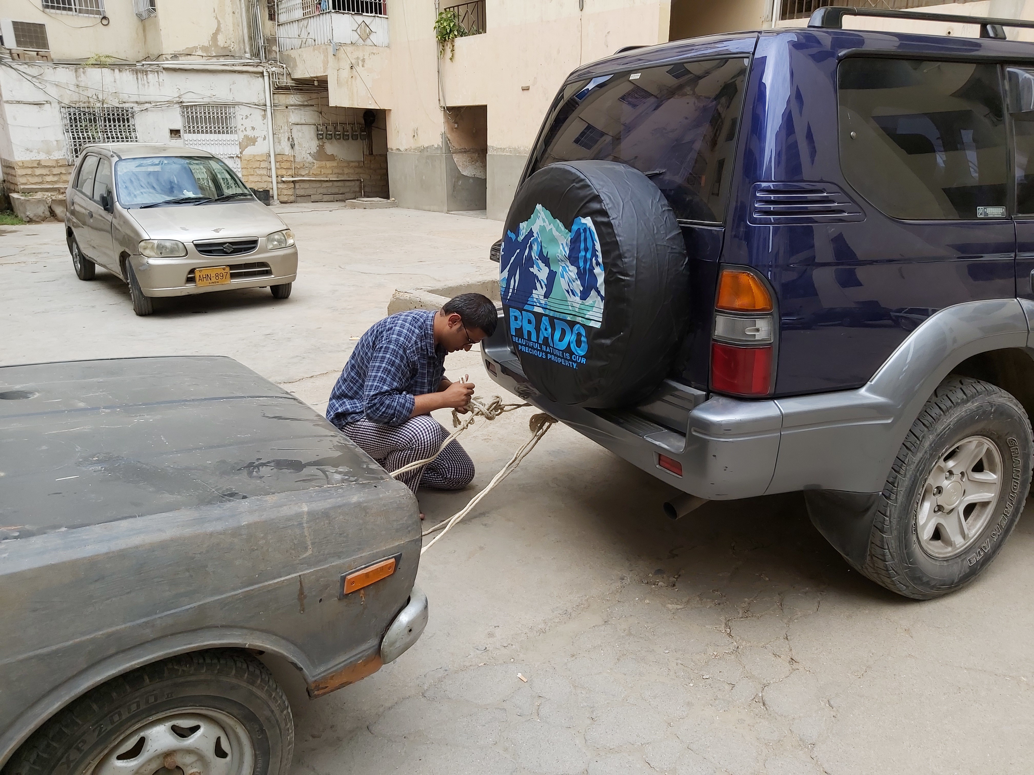

Everything will come off the car soon, actually I wanted the parts to be removed as step 1, but the denter has some different plan. He wants to finalize the three panels (front fender and doors) on both sides first and then move forward with removing all the other bits and pieces.

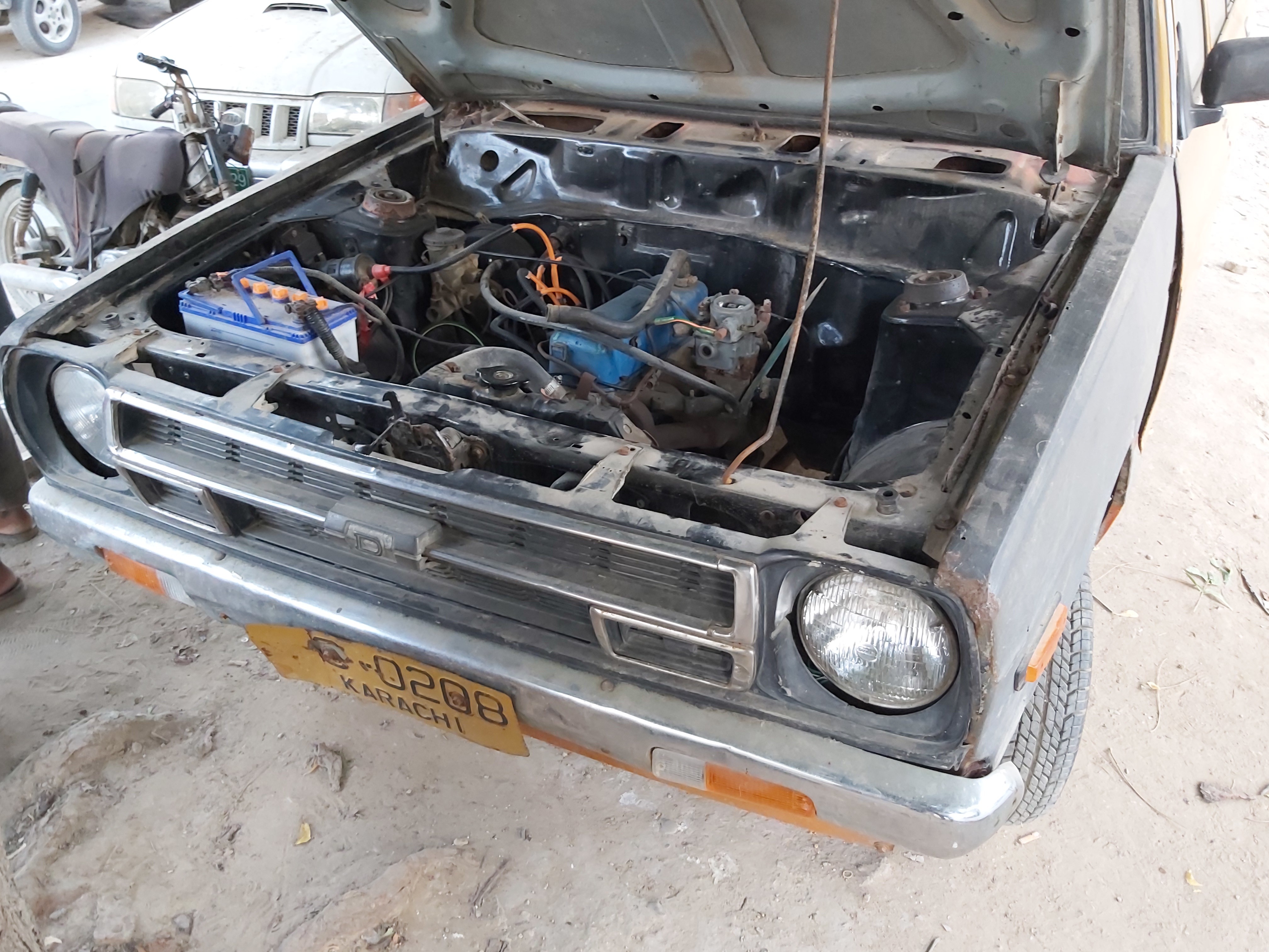

I think the battery location is correct, but still I will double check. And will try my best to take detailed pictures throughout the project.
