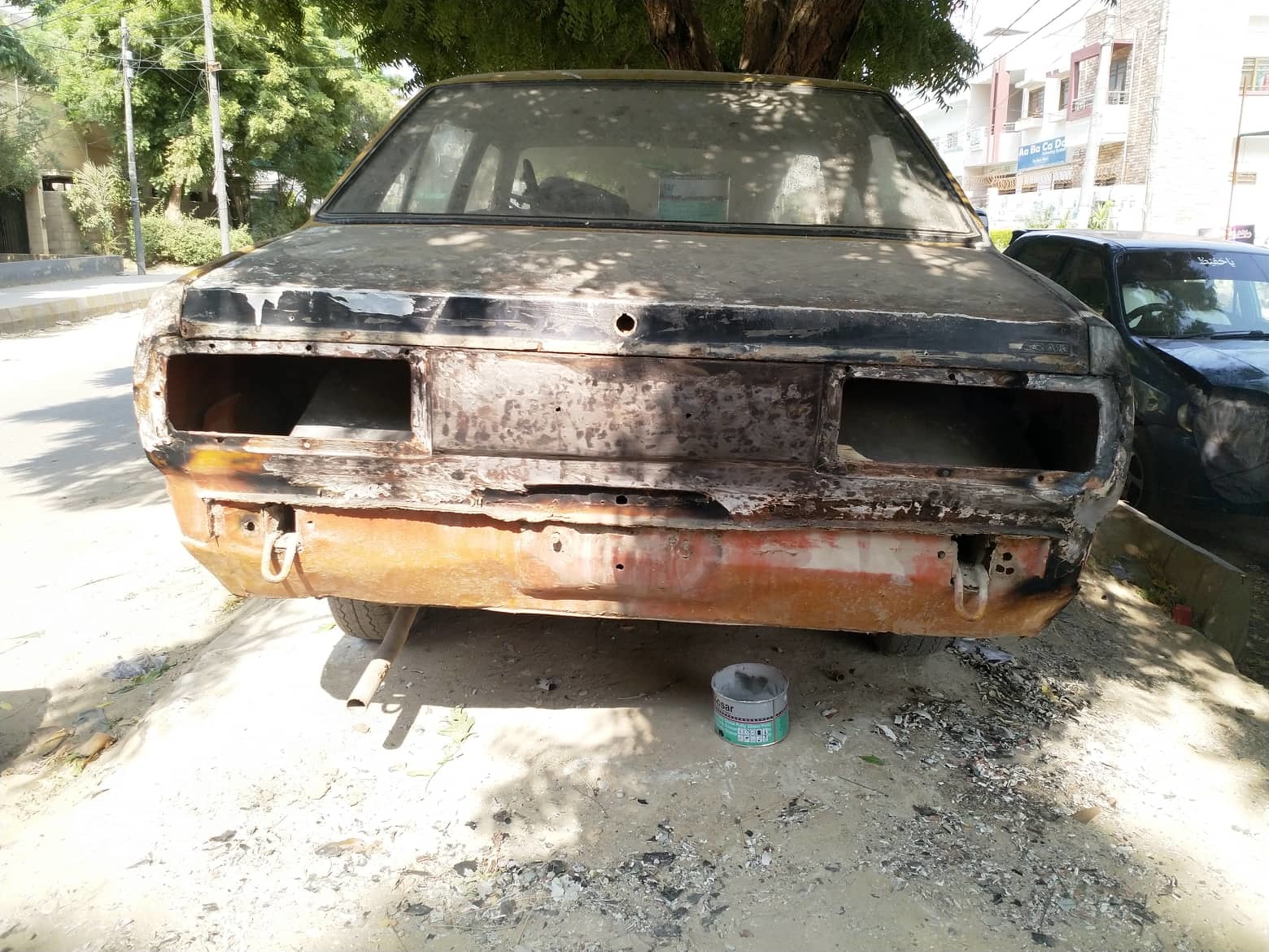

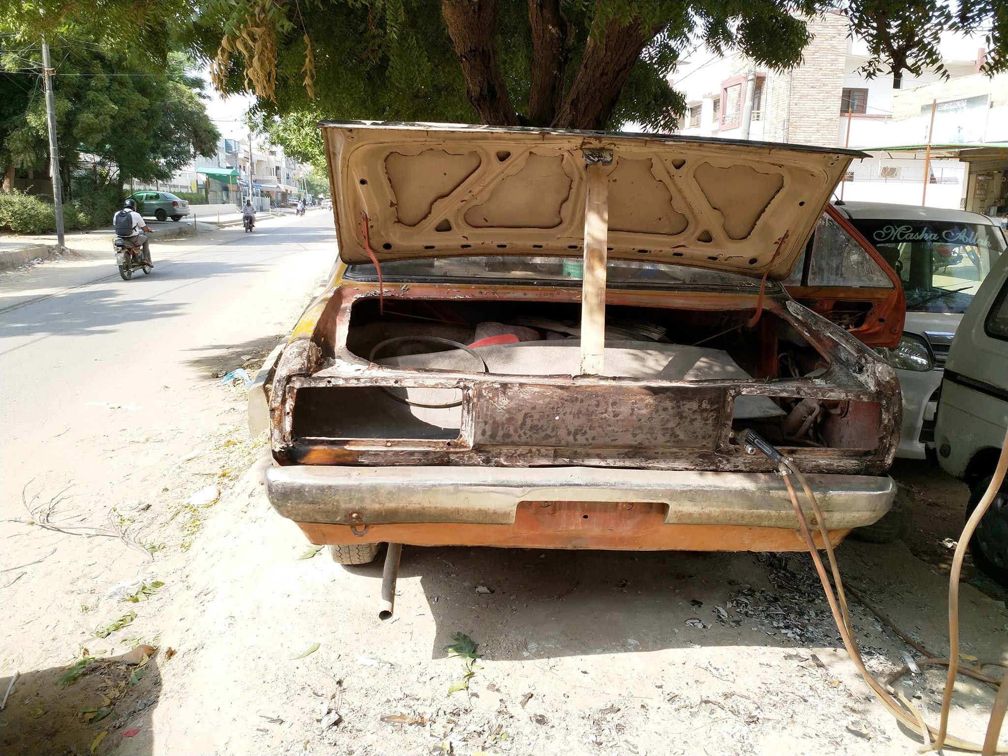

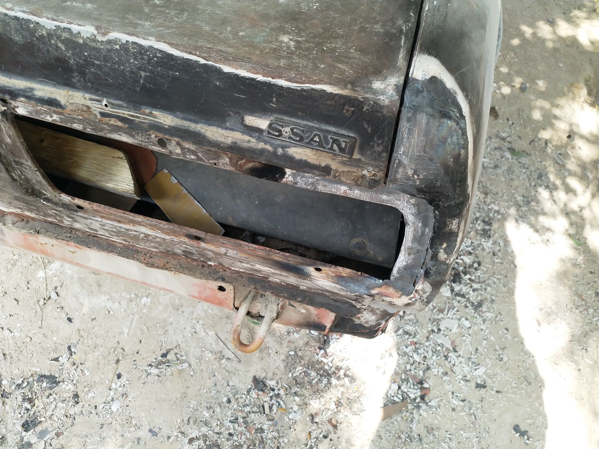

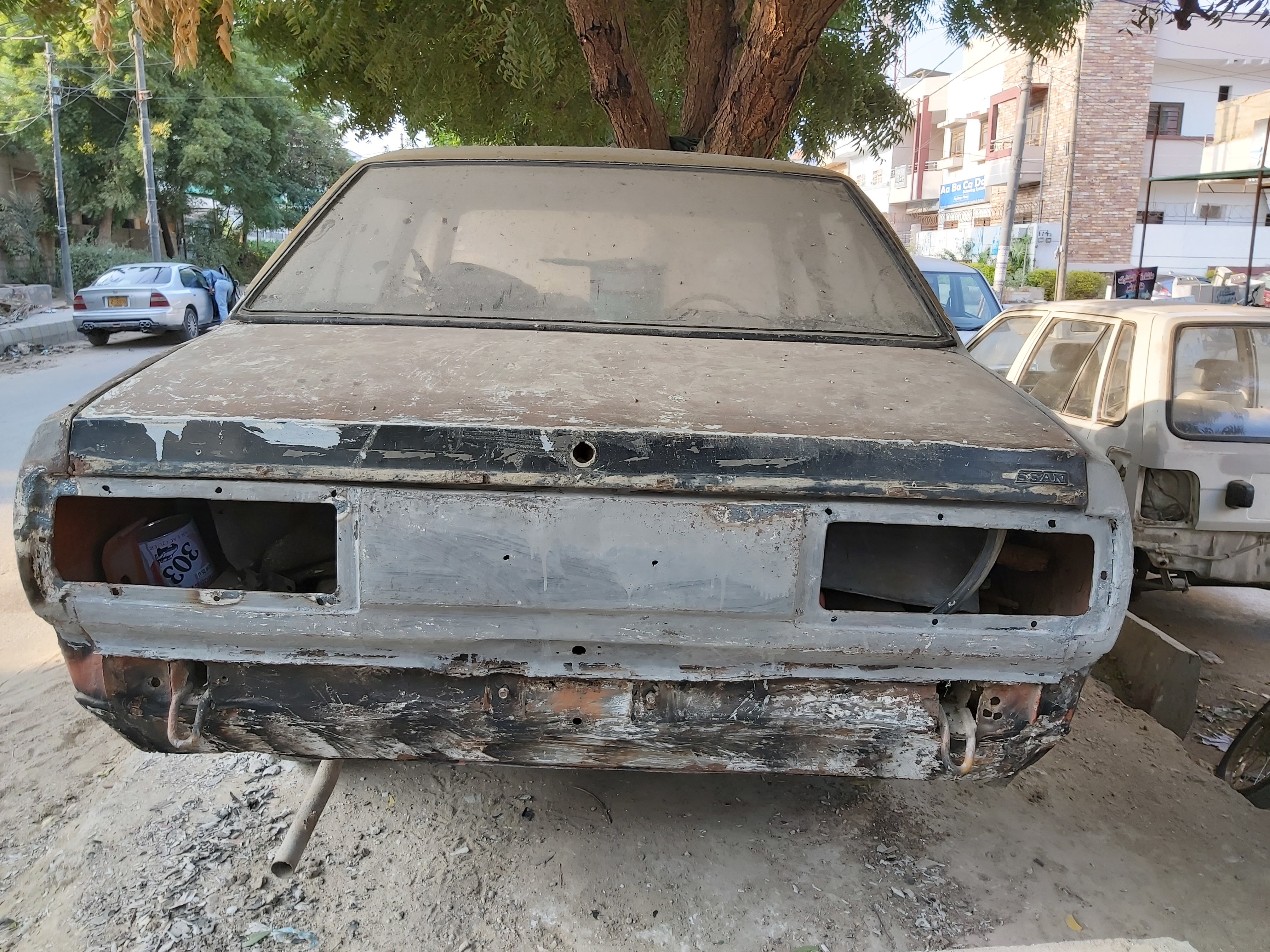

let the guy redo the body shell - if you have a separate paint person, make sure he talks to the guy redoing the body shell.

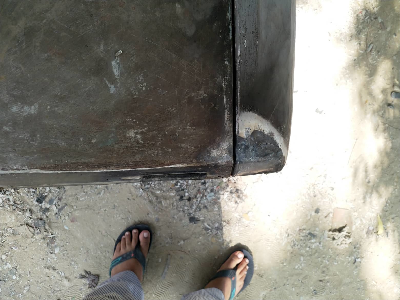

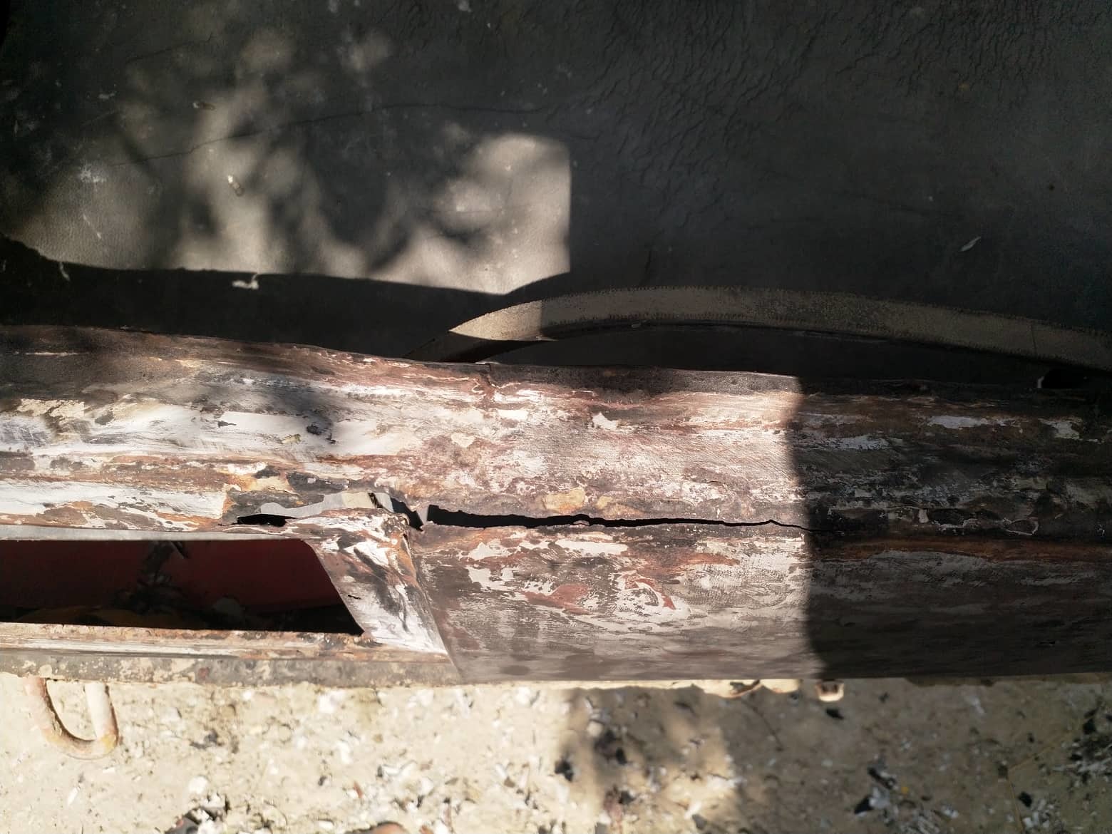

This nissan rusts from the roof pillar joints due to the rear glass rubbers shrinking and leaking - the factory used butylmastic compound beneath the rear glass to prevent this leak - same compound they used to seal the mudguards to the body. They also rust at lower seam panel of floor and rear face panel at the joints due to shrunken body sealer (age) and mostly diesel and oil paalish wali tasali baksh service. (but never greasing the ball joints and tie rods LOL)
