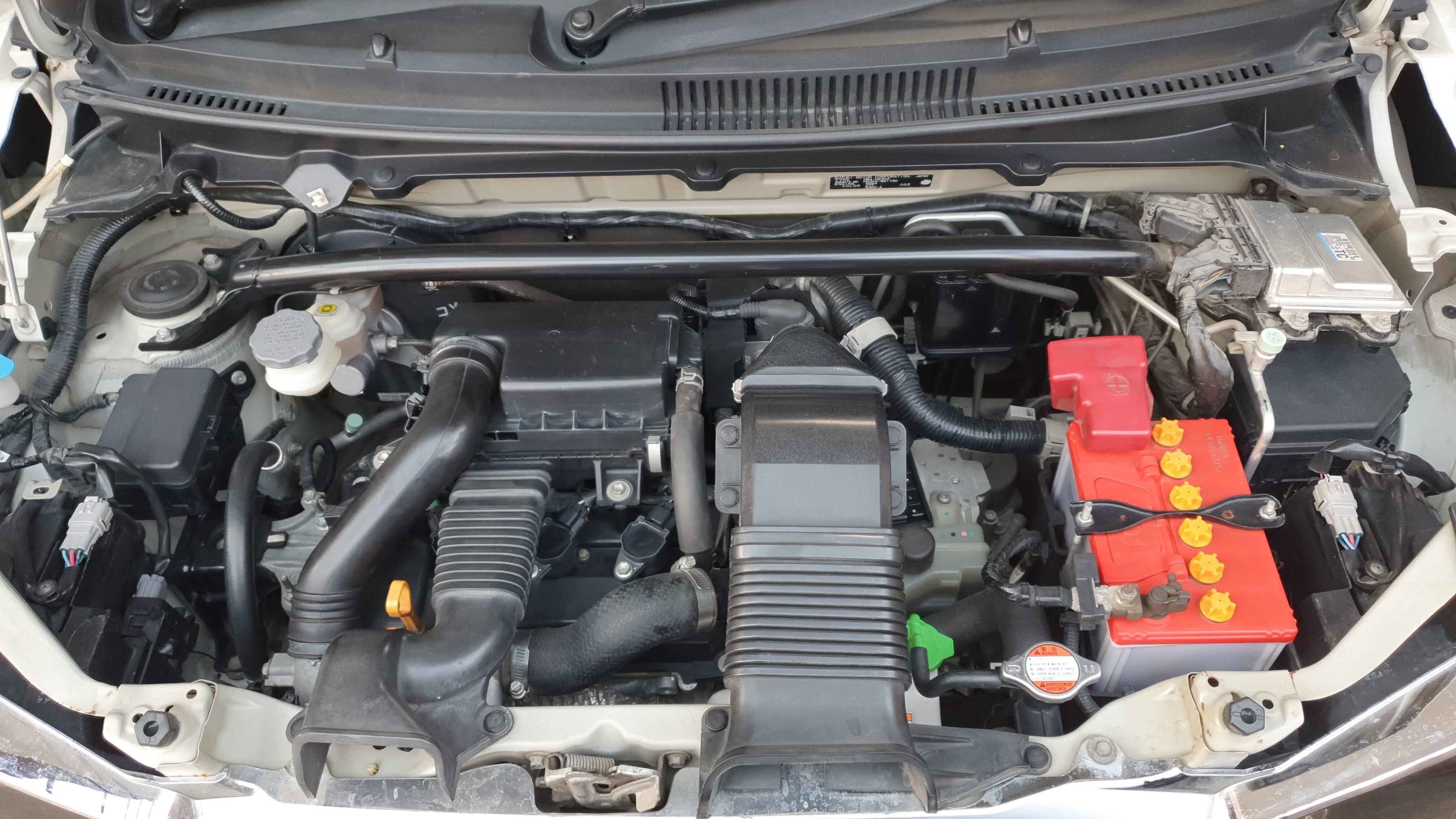

Attaching a few photos of the car and the engine bay, and awaiting replies. I'm situated in Lahore.
