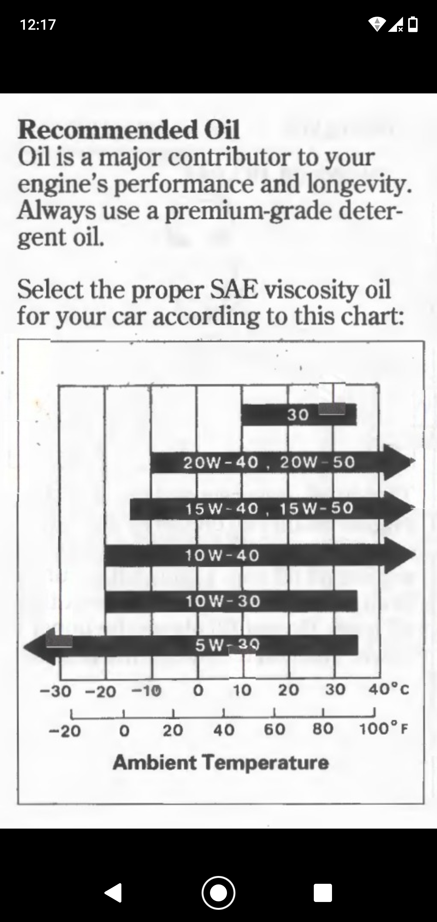

LiquiMoly is no magic elixir, it is good but the cost to benefit ratio must be considered. Total boht acha hai, aur aapko pumps se original milega aur price economical hai and it is API SN.
