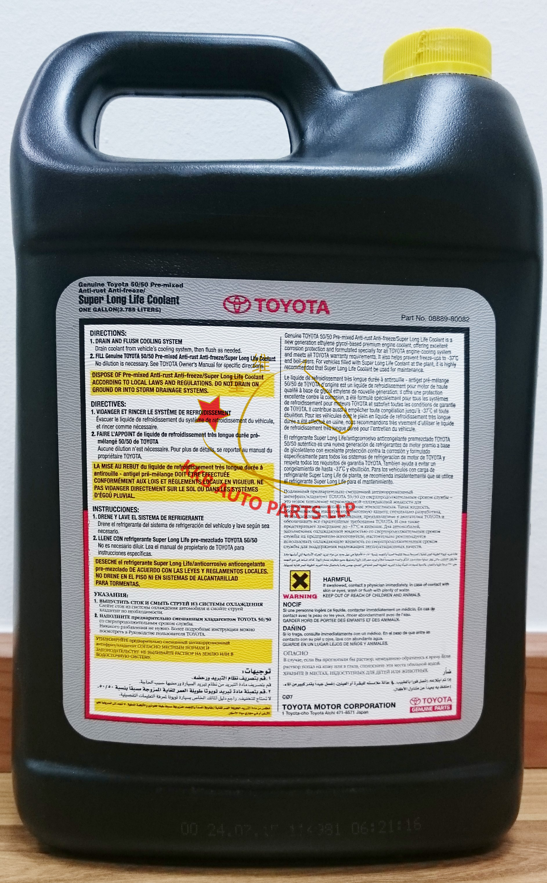

pack it up and fill with coolant - (make sure to burp it of any air). - The above self made bucket thing is good, as I just now fill with exactly half volume of the system with concentrated coolant and start the engine.
